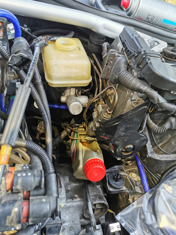

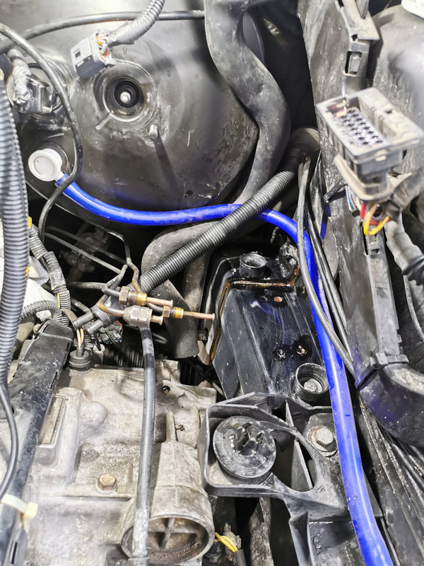

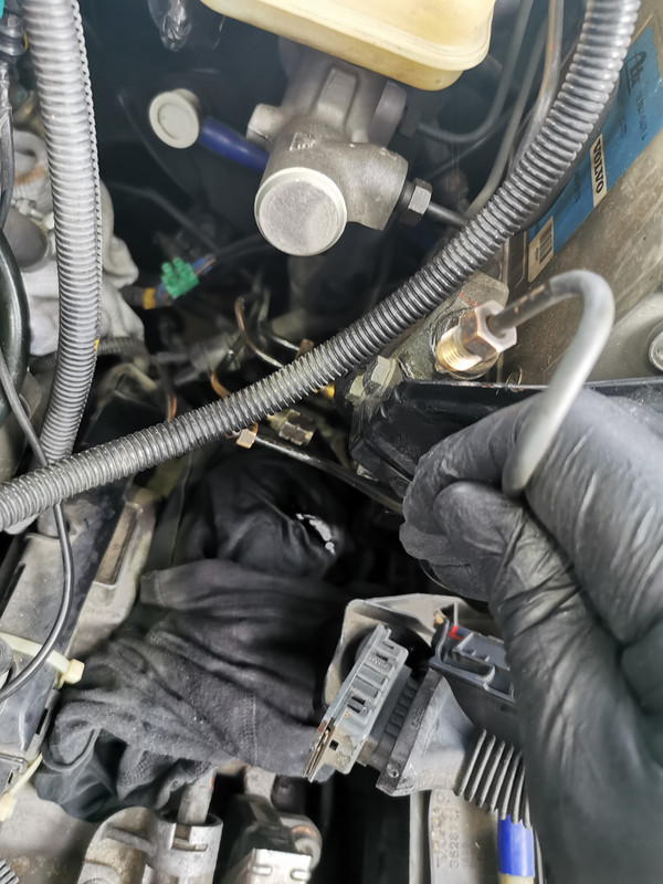

I removed the old abs unit together with the master cyl as it seemed the easiest solution to me.
Tips:
  • Remove battery, air intake, etc to have enough room.
  • You need 13mm,11mm,14mm wrenches If I'm not mistaken, at the minimum. Luckily I got a cheap set of brake line wrenches. They are all different sizes, I guess so that they can't be mixed up.
    empty reservoir first
  • You might need to remove a line from the fluid distributor first to have enough room to loosen the lines. it is pretty tight down there
  • remove top mounting of the abs unit
  • remove master cylinder and then you can lift it out
Cleaned up a bit of rust and fixed some of the wiring protection in the area. Today I installed the "ABS only" unit, bled it a little bit through the brakte lines on the unit. Pedal still has no firmness, I will need to do a full bleeding. But, so far everything just plugged together, the Connectors are all the same. I had to swap the reservoir, as the remplacement was from a manual (has a plug cut open that goes to clutch cylinder)
Next steps will be to reinstall Air intake partly, battery and do a full bleeding of the brakes and then hopefully no warning lights. For now I just disconnected the TRACS switch... still unsure if it will need more. I checked the wiring diagram, but it does not tell me how the computers decide to set tracs light or not. I will see I guess.
some pics
The infamous TRACS unit with 4 lines
reinstalled/replaced, doing a little bleeding
850 T5-R '95 auto Image
