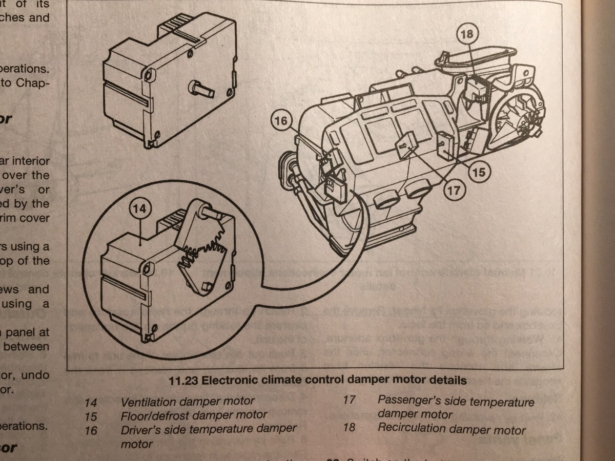

@jreed posted this screen cap from a Haynes manual, it may help with nomenclature.
I'm not able to orient myself under the dash from your picture, but the 200 codes seem to be for two distinct issues.
I'll pull my glovebox in a bit and see if I can figure out which motor is MIA.
All the motors are the same, a trip to a junkyard to harvest a couple wouldn't be a bad idea.
The broken bit is more challenging.
