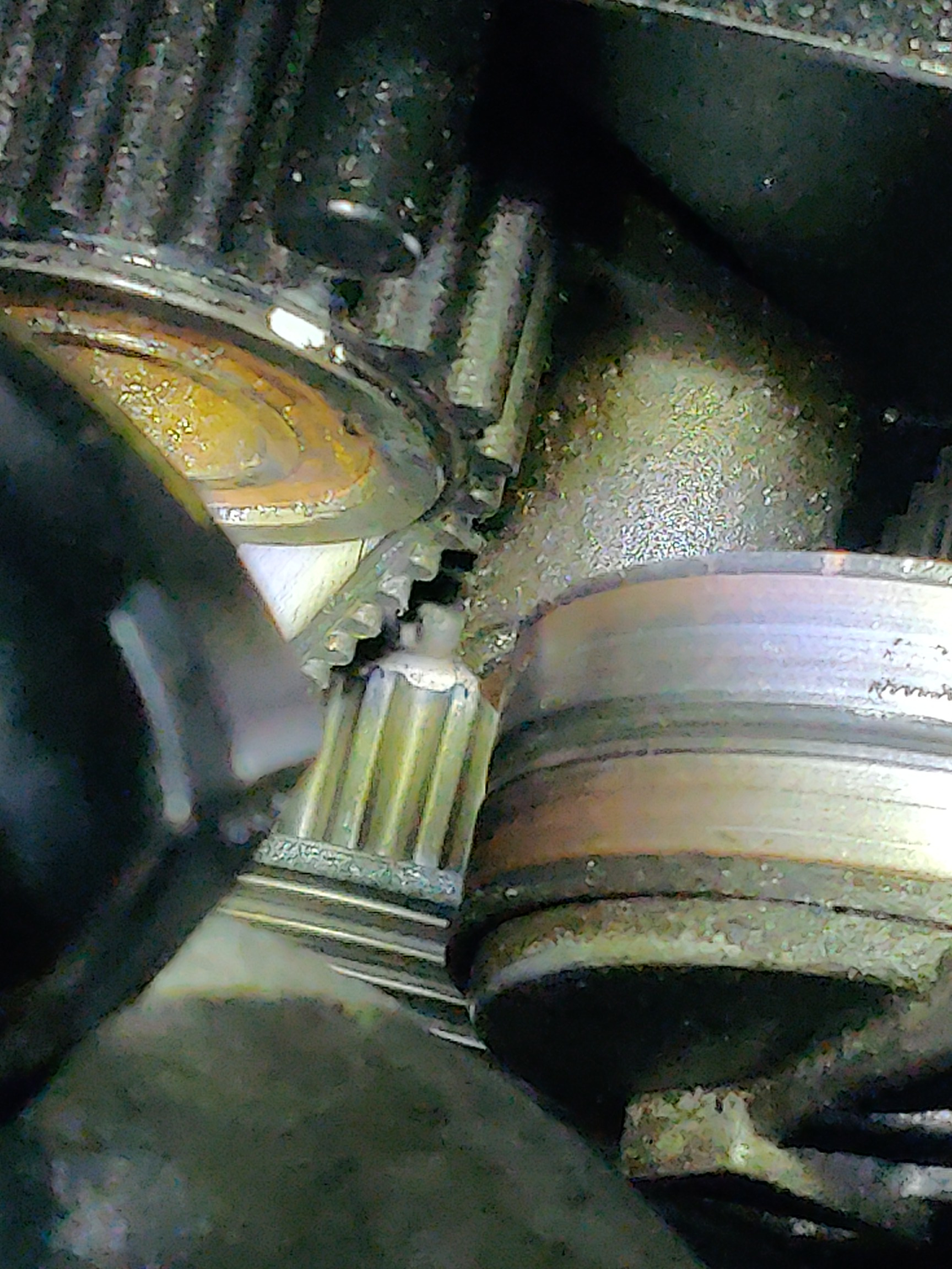

So in this pic, are things aligned, or does the crank need to rotate a little bit clockwise to the raised casting ridge ?
Re pic by Nevada
[/quote]

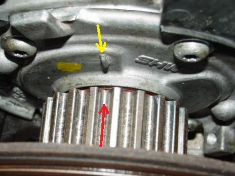

Yes, they're aligned. The timing belt pulley and serpentine belt pulley mount only go onto the crank one way - it's physically impossible to do it wrong. Those notches are the only marks on the timing pulley. I rotated the crank so the timing pointer on the oil pump is dead center in the tooth valley between the two notches.
According to the information I have, that's #1 TDC.

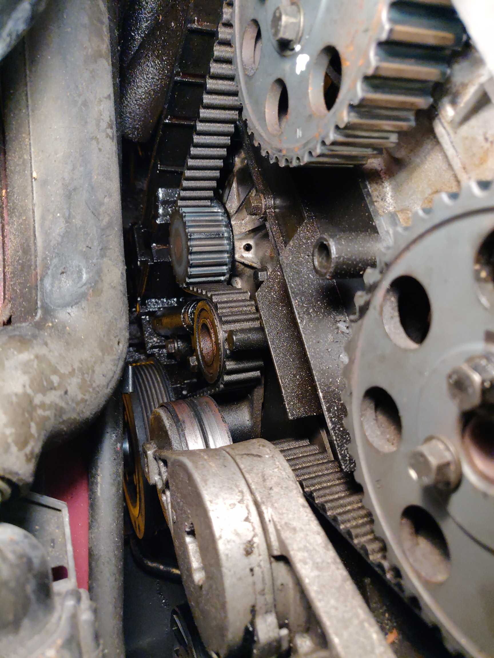

Nevada1906 wrote: 09 Oct 2021, 17:43Sufbug wrote: 09 Oct 2021, 17:35 Ok, I found the cam timing marks.
Having trouble finding the top dead center marks on the crank pulley.
Help anyone?
On the timing belt pulley, there's a tooth with a notch on either side. The red lines indicate the notches on both sides of the #1 TDC tooth. It looks like this:
There's also a raised bar on the pulley mount, which is in line with the TDC notch. It's the silver part in the picture.
Hope this helps.
Thank u
When you say -timing belt pulley-. Do u mean the crankshaft pulley-. Probably not......(correct me if I wrong)
Do u mean the gear that is to the right (toward the front of the car) of the water pump?
I have enclosed a pic.
Also, if the cam gears are marked and locked in, why do I care if the crank is at TDC? won't the crank stay steady when I take off the timing belt?
Also, coould I watch cylinder one (closed to the pass fender) to see if the poston is at TDC when the cam gear marks line up?
Thanks all...

Sufbug wrote: 09 Oct 2021, 19:32Nevada1906 wrote: 09 Oct 2021, 17:43Sufbug wrote: 09 Oct 2021, 17:35 Ok, I found the cam timing marks.
Help anyone?
Hope this helps.
Thank u
Thanks all...
Unfortunately, the picture you attached didn't show up.
I was paranoid and bought the cam lock tool the first time I changed the timing belt on my car, and when installed correctly it orients the engine internals to #1 TDC, so that's where the crank is when you remove the belt. There's enough friction on the internals that the crank should stay put while you work. That's why I'm speaking as if you're using the cam tool. I apologize if that's assumptive on my part.
There are three items that live on the crank snout: the timing belt drive gear, what I call the pulley mount, and the serpentine belt pulley. The timing gear goes on first, then the pulley mount and finally the serpentine belt pulley bolts to the mount.
On the timing gear, there're two teeth, right next to each other, that have notches in them. The crankshaft gets rotated until the valley between those two teeth sits on the timing pointer on the oil pump. Get it as close to dead center in the valley as you can.
What I would do is shine a nice, bright flashlight down from the top of the engine bay and rotate the engine until the timing belt pulley on the crank, pictured above, lines up and the cam pulley marks aim at the center of the notches in the front cover. You want to aim for the center valley of each notch, but getting it in the notch at all is okay.
Forgive me if I come across as condescending. I don't mean to be - I don't know how familiar you are with this engine and am just trying to be thorough.

Absolutely, no problem. And the thread mentioned by volvolugnut is precisely how I lined up my engine, and what I said to you about where to locate the crank. That extension on the front of the oil pump functions as a timing pointer.Sufbug wrote: 09 Oct 2021, 21:55volvolugnut wrote: 09 Oct 2021, 19:48 As I understand these engine, (someone correct me if I am wrong) the crank does not have a mark for TDC. The crank has a mark only for the cam timing.

You can't UNSEE the timing marks on the crank gear..and how they match up to the engine block. Which from reading , is the oil pump.
The marks are on the crankshaft timing gear ... The side of the gear CLOSEST to the engine block.
