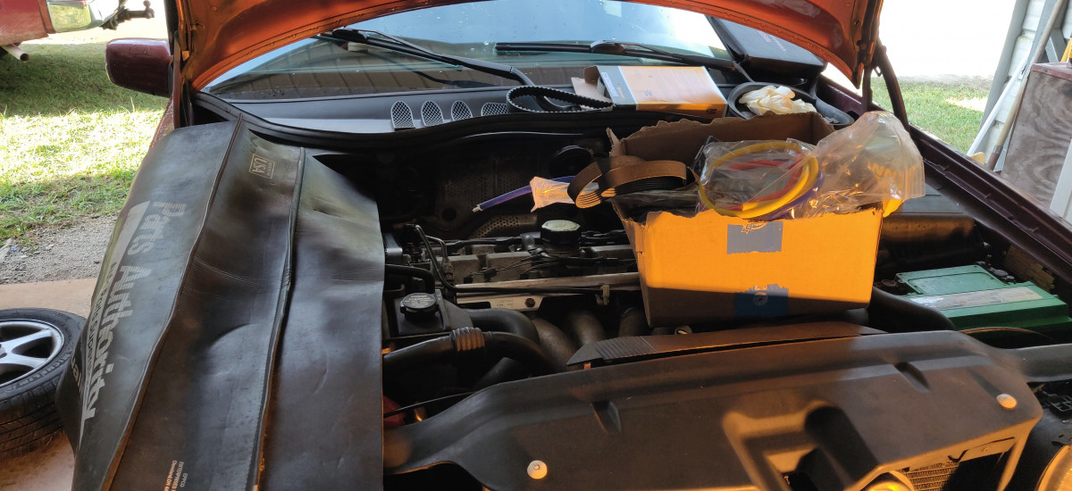

Packed up and ready to roll!  (Let the good times roll....)

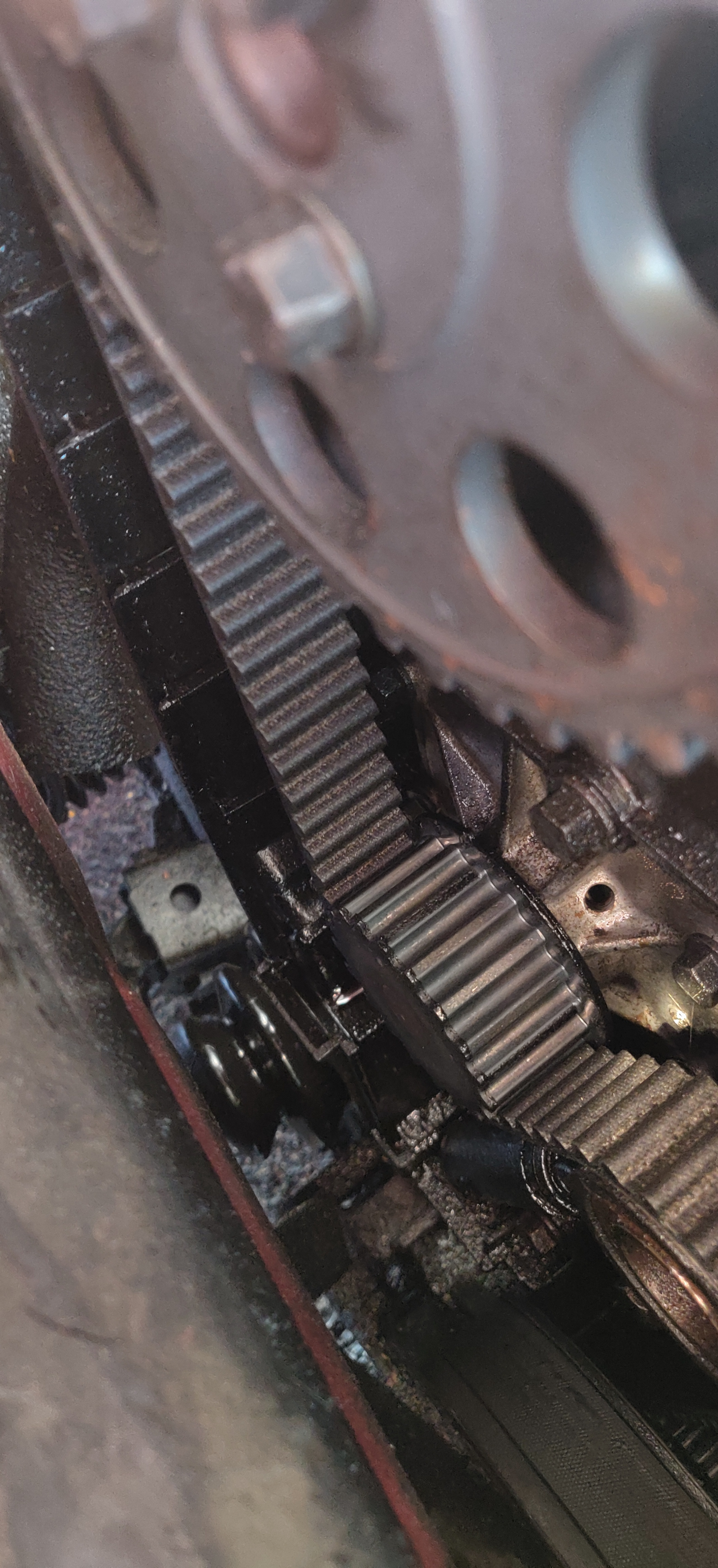

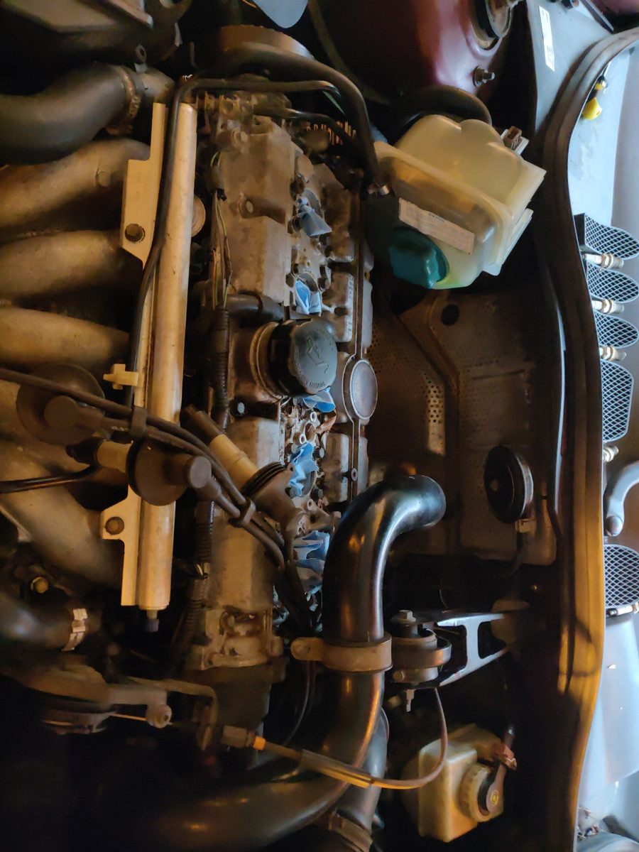

Doesn't seem too bad, but gotta fix that leak

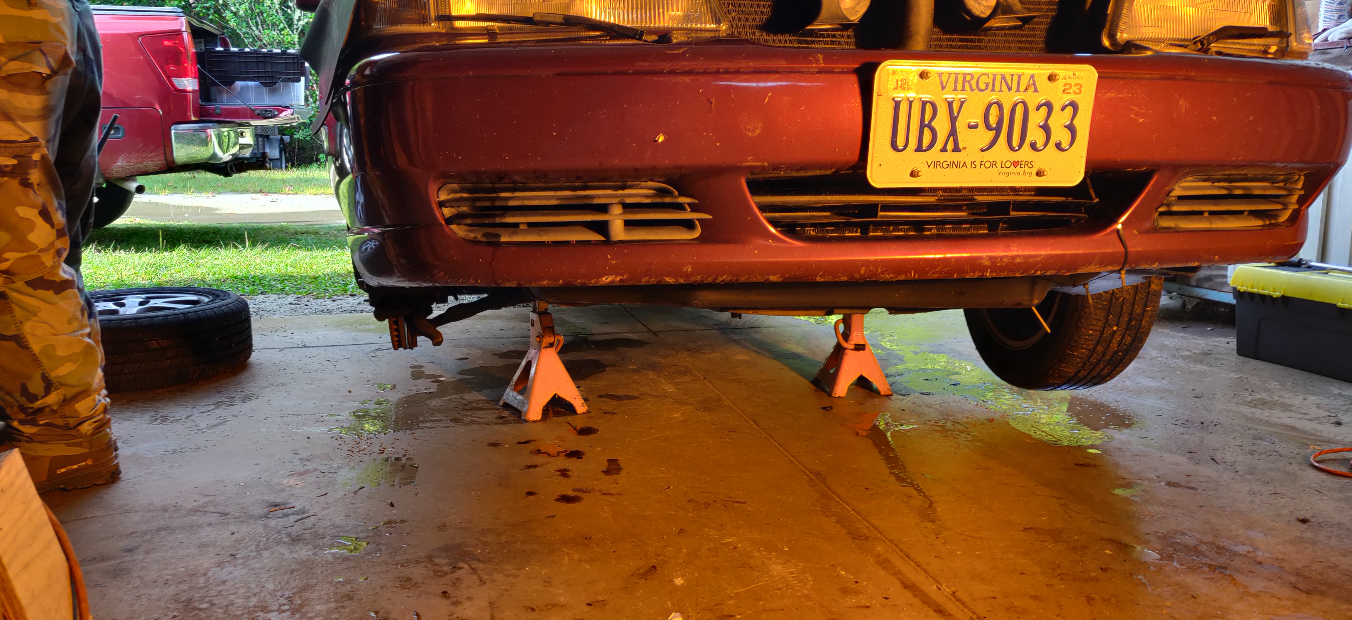

And we are in the air! --- gonna do the brakes as well and an oil change-and some other goodies!
Partsssss
Partsssss
Jacked up and chocked back wheels

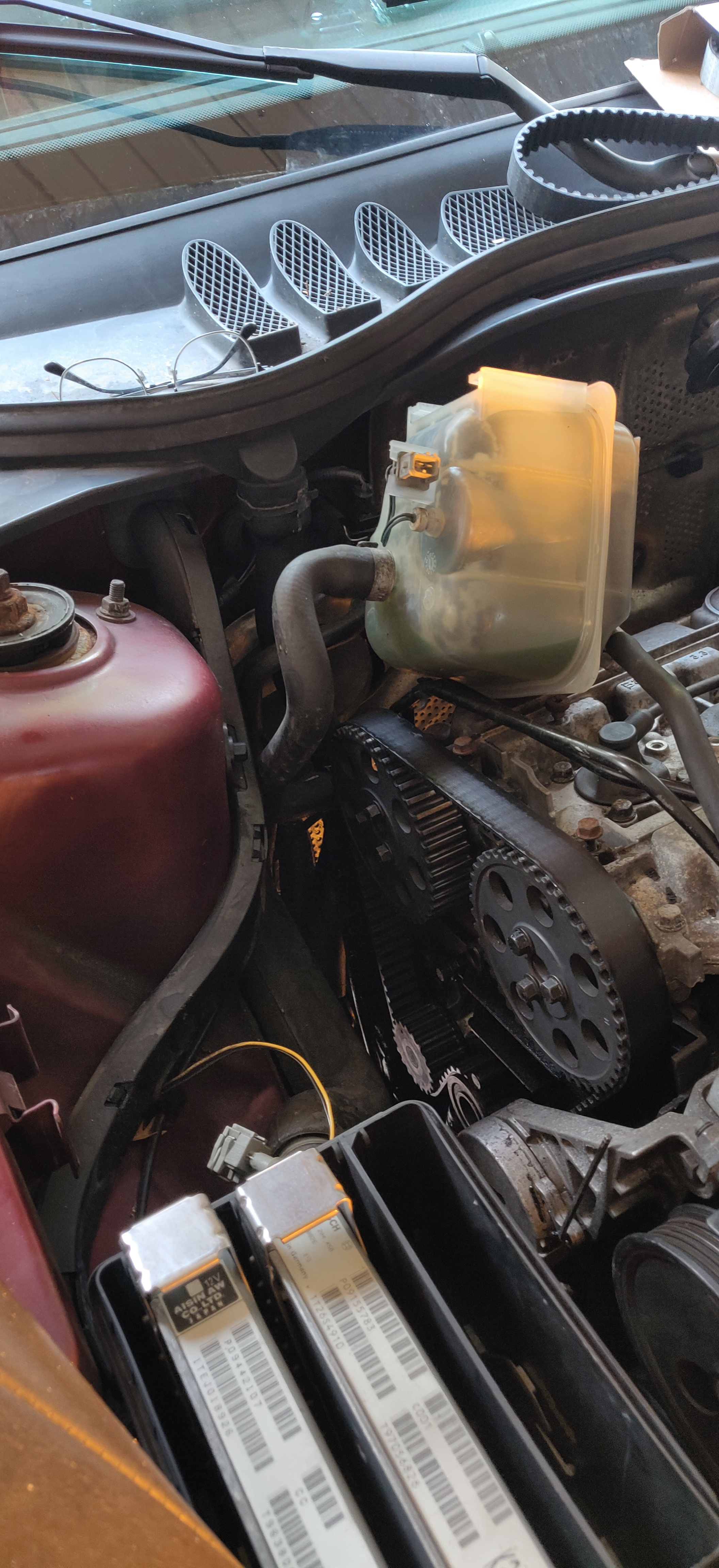

Move coolant reservoir
Remove timing covers
Move tensioner with 1/2 to 3/4 adapter
Pin tensioner in open position ( Allen wrench)
Remove access belt.

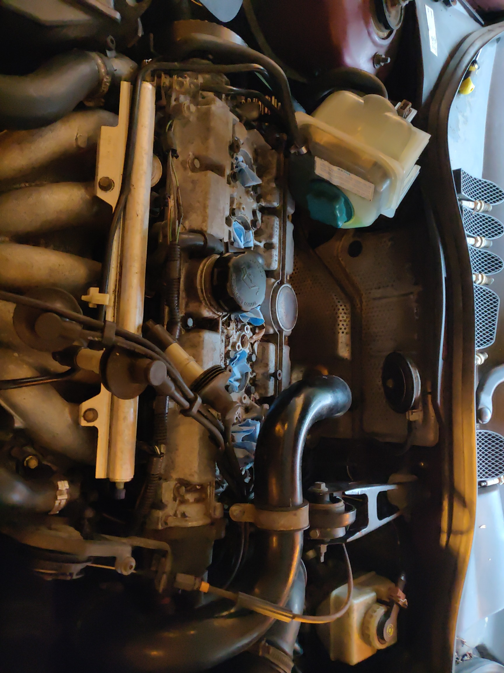

Spark plugs out.
Pass side cover pulled back (doing brakes too)

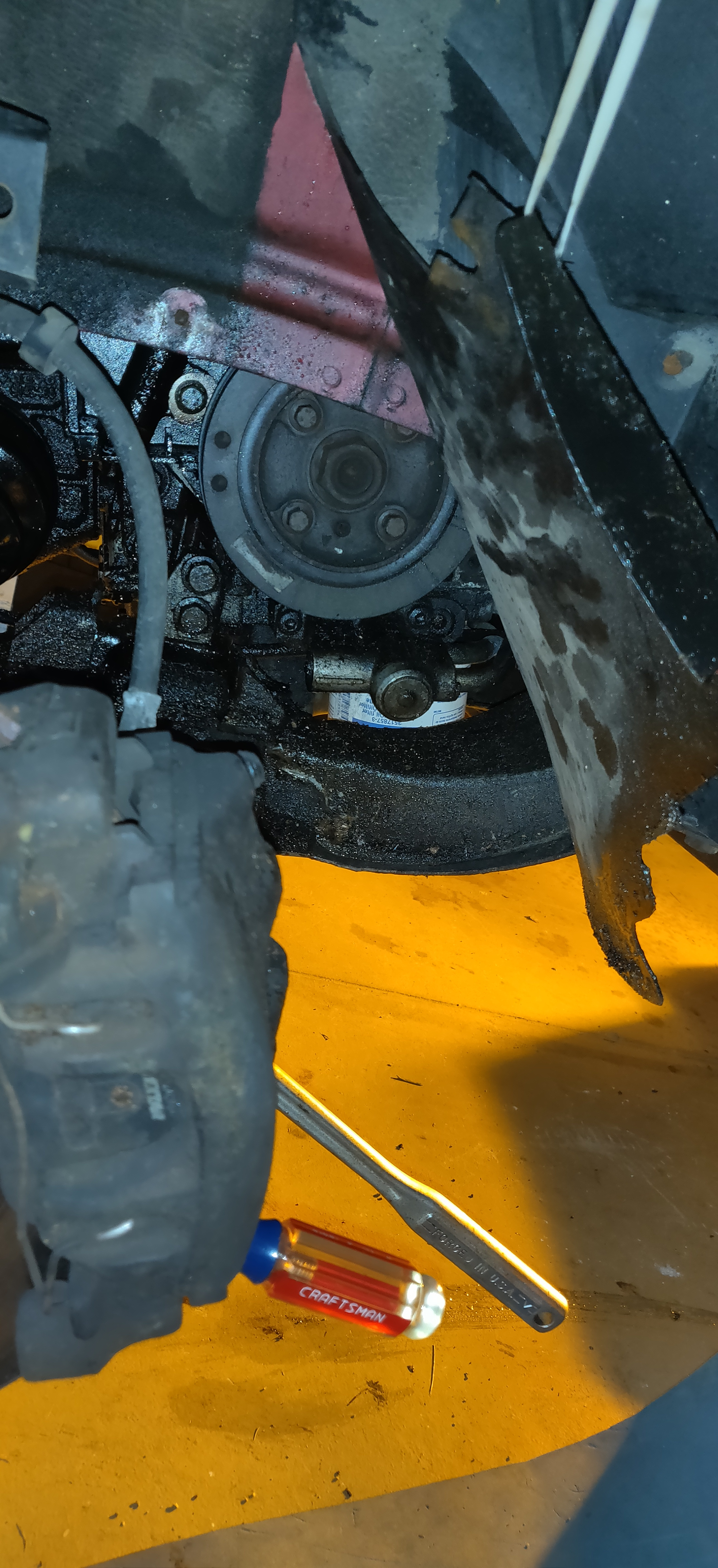

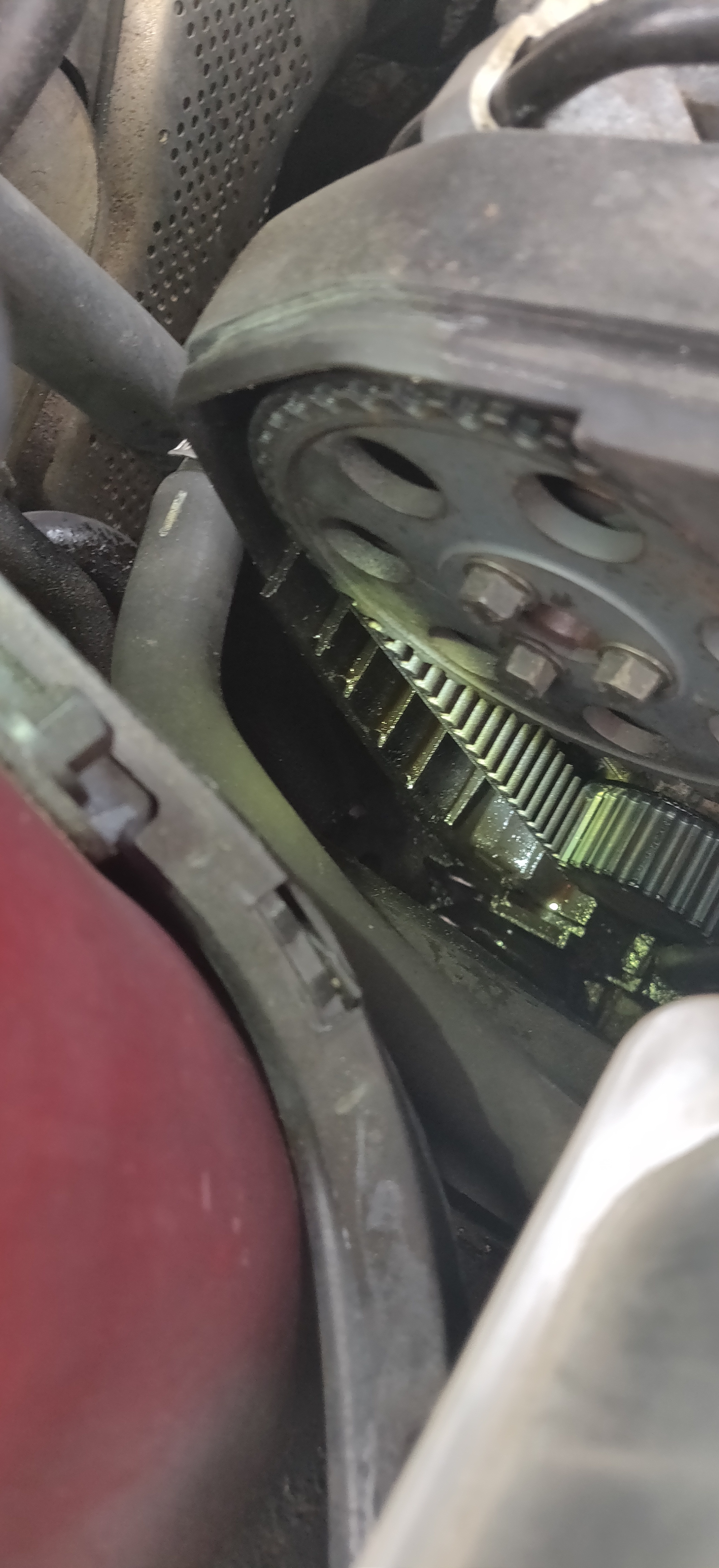

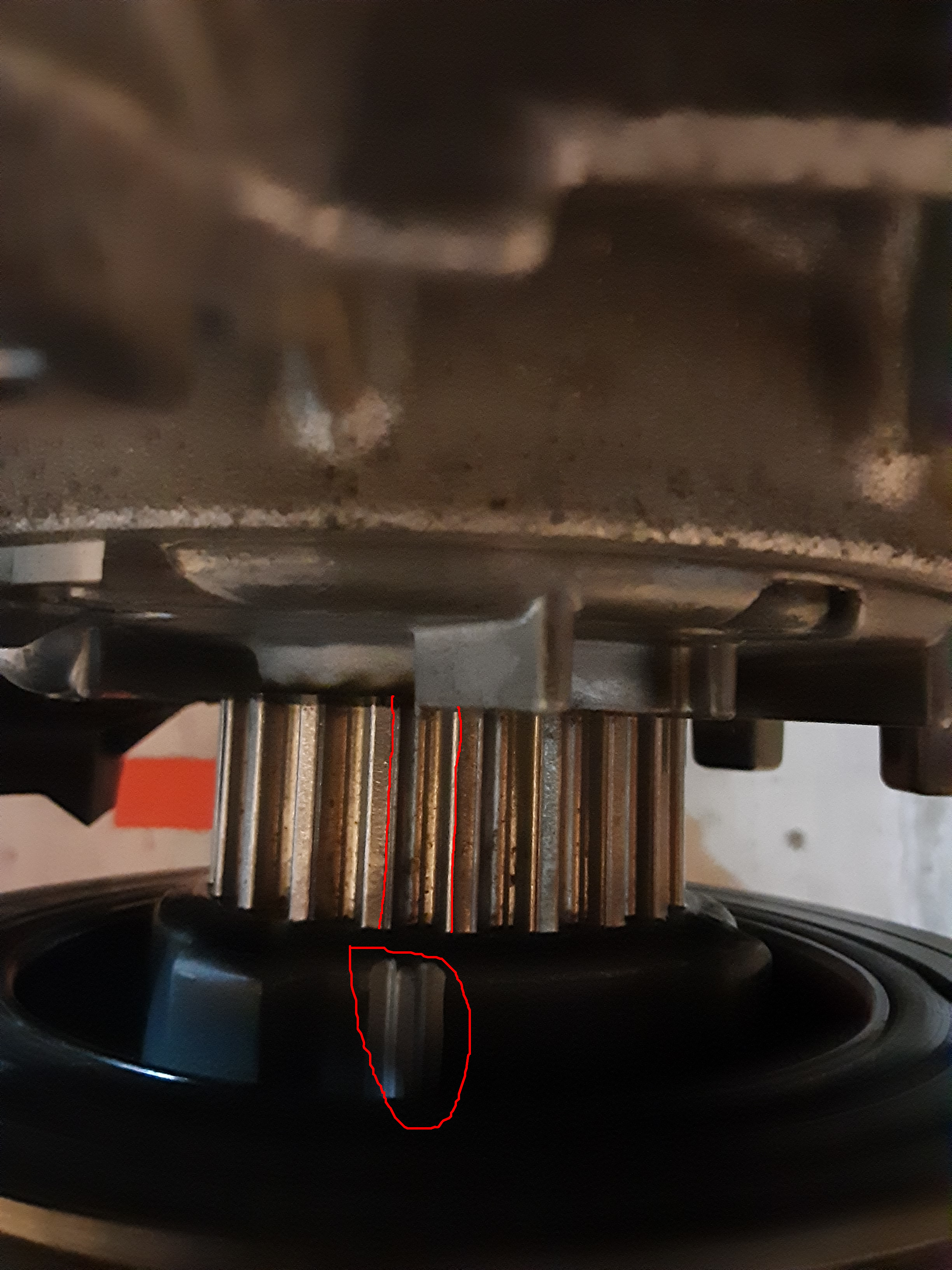

Ok, I found the cam timing marks.
Having trouble finding the top dead center marks on the crank pulley.
Help anyone?

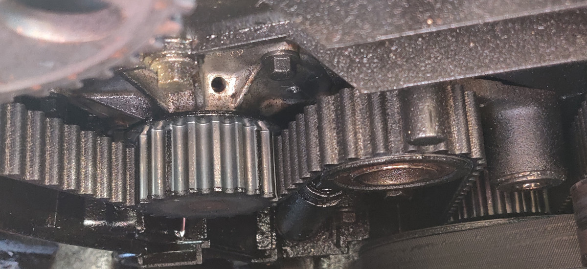

Sufbug wrote: 09 Oct 2021, 17:35 Ok, I found the cam timing marks.
Help anyone?
On the timing belt pulley, there's a tooth with a notch on either side. The red lines indicate the notches on both sides of the #1 TDC tooth. It looks like this:
There's also a raised bar on the pulley mount, which is in line with the TDC notch. It's the silver part in the picture.
Hope this helps.
Help anyone?
The timing mark on the crank pulley is notTDC , it’s a non interference mark
It can be either the scribed lines or the notches in the inboard side of the pulley teeth. You have to look for both on an old car that may have been reworked
If you set the cams to the angled mark the crank will be close enough to see the marks.

abscate wrote: 09 Oct 2021, 18:04
Help anyone?
Could you clarify? I'm pretty sure that's the mark for #1 TDC. It's not like there're any other marks on the pulley.
