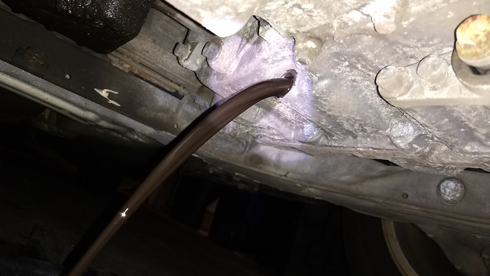

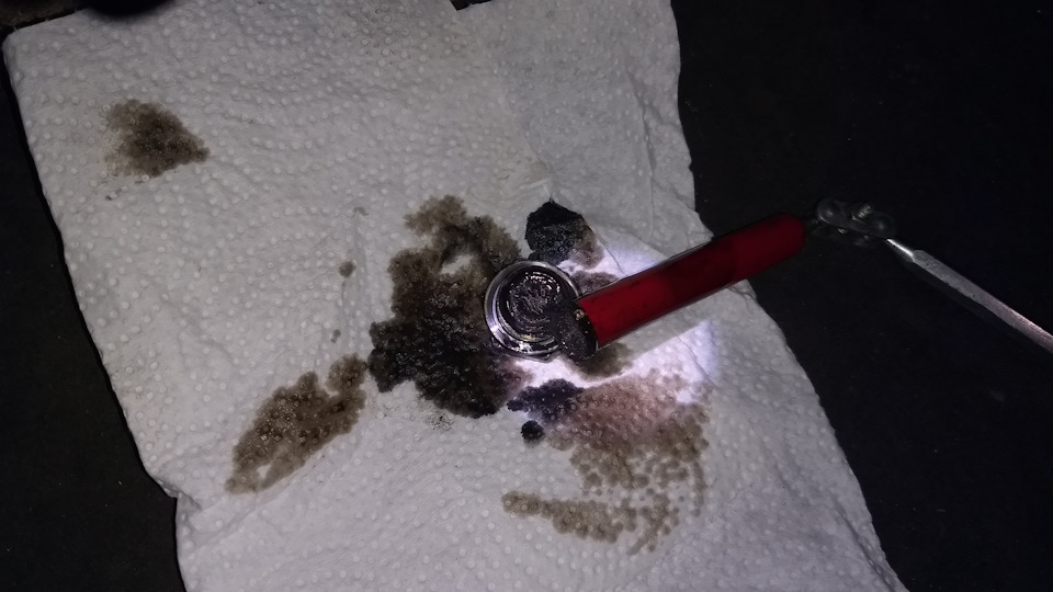

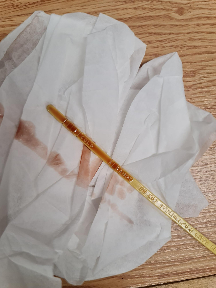

You said ATF looks good? Burnt clutches would result in a very dirty/sooty ATF, like that:
Plus the speed sensors would attract a lot of steel. Here my poorly rebuilt transmission was slipping only for 5 kms:

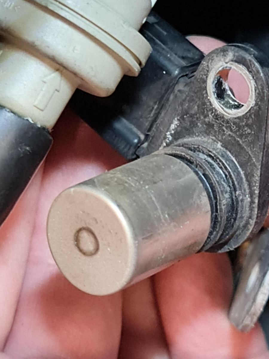

Status of the oil:

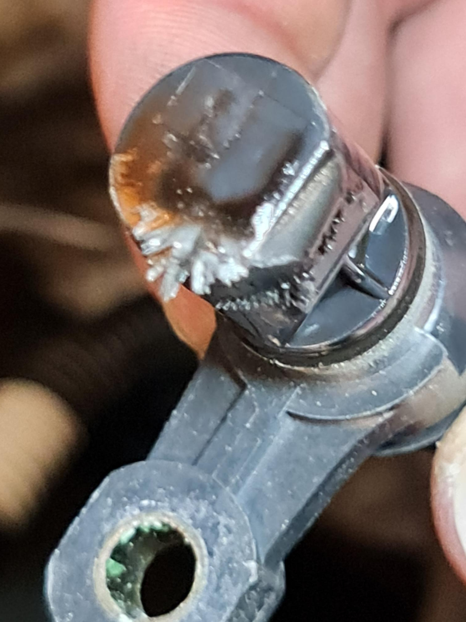

This sensor threw a ECM-5200 at me last week, but looks clean:
This sensor makes me a little bit more worried.

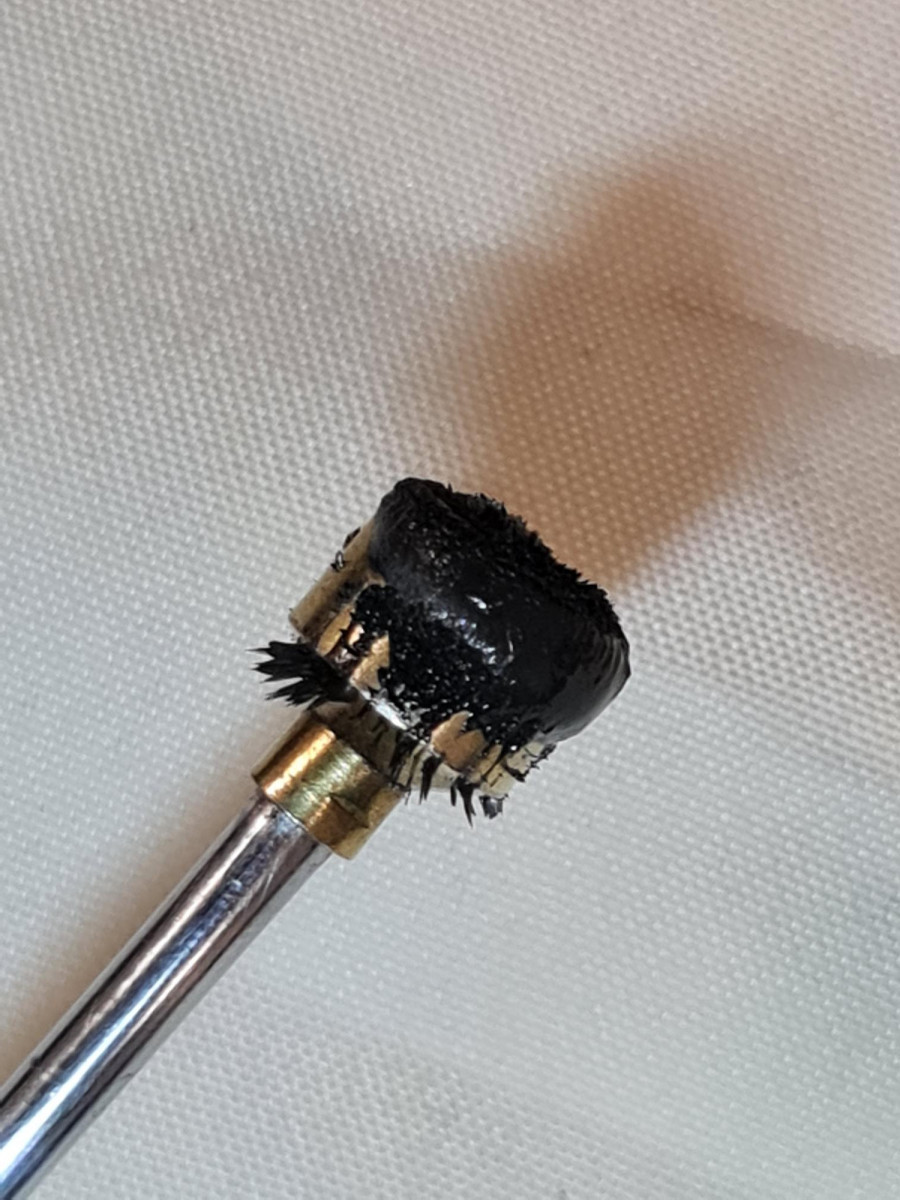

Magnet pen down the sensor hole.....

Is it input sensor? There's another one, located approximately behind ABS unit.

greffel wrote: 11 Oct 2021, 11:09 Magnet pen down the sensor hole.....
Ok, that is convincing. The transmission saw low oil pressure. Now, why did it happen? Is it a clogged filter or loose valve body connectors?
Unfortunately, the valve body got a piece of this soot.
