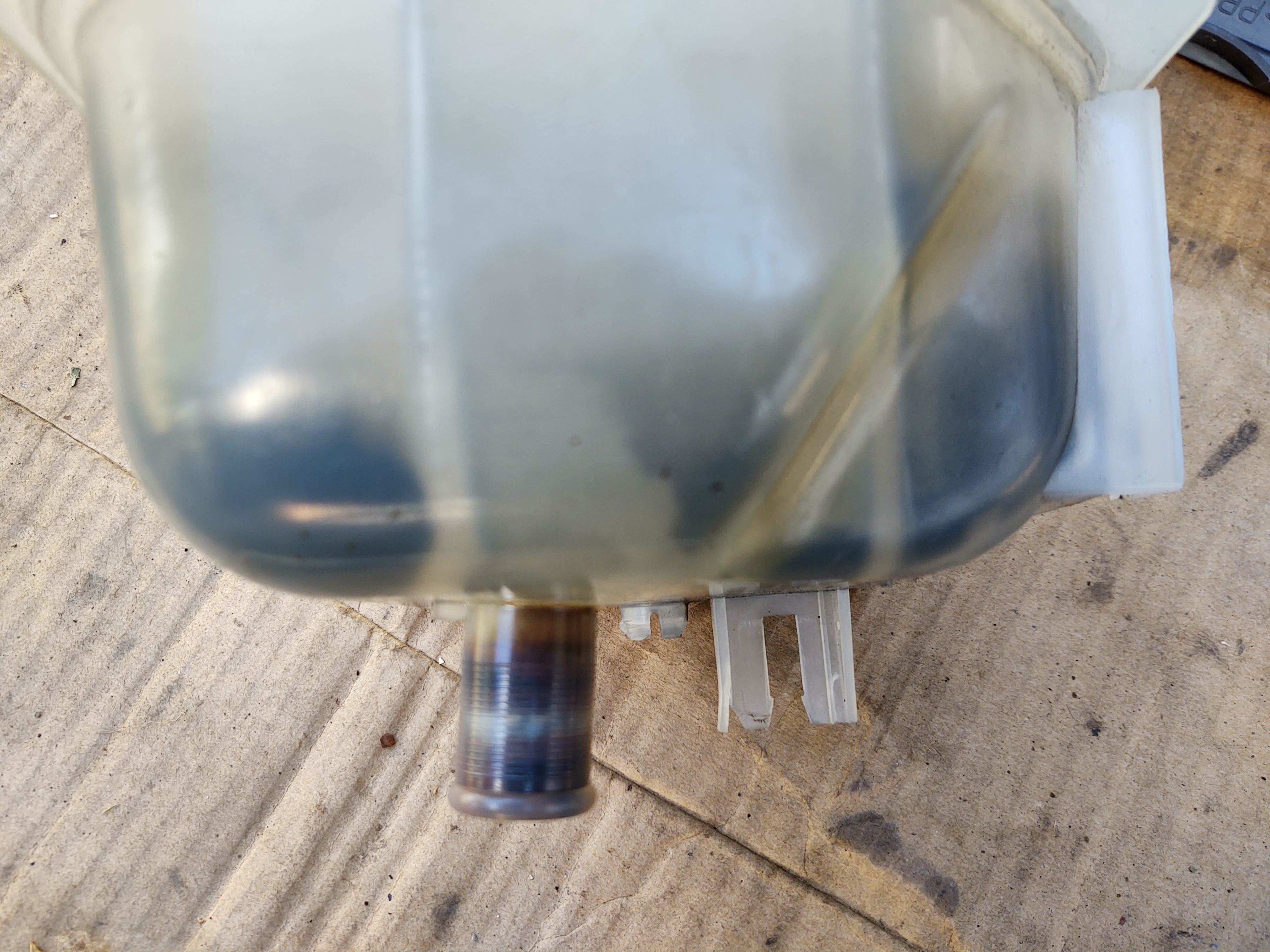

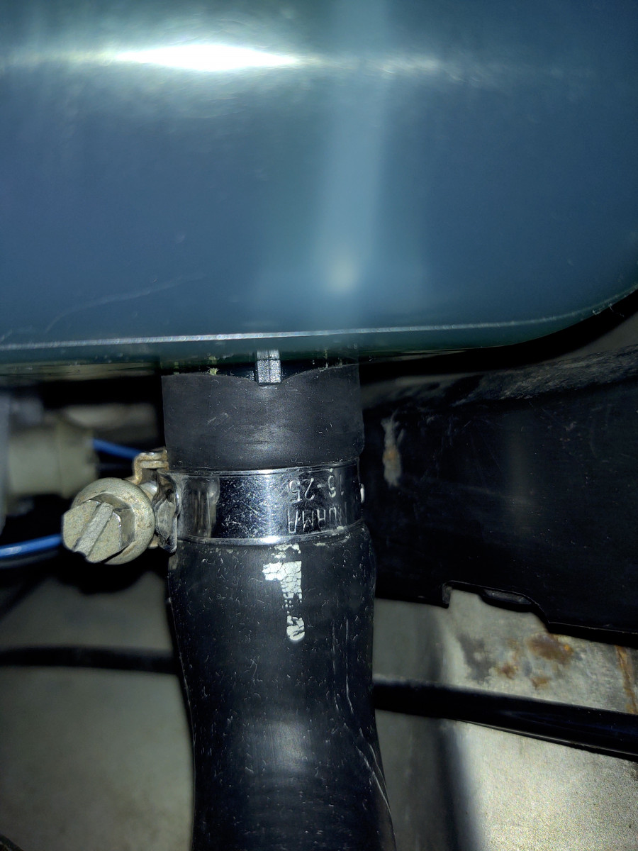

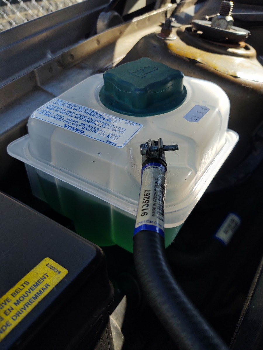

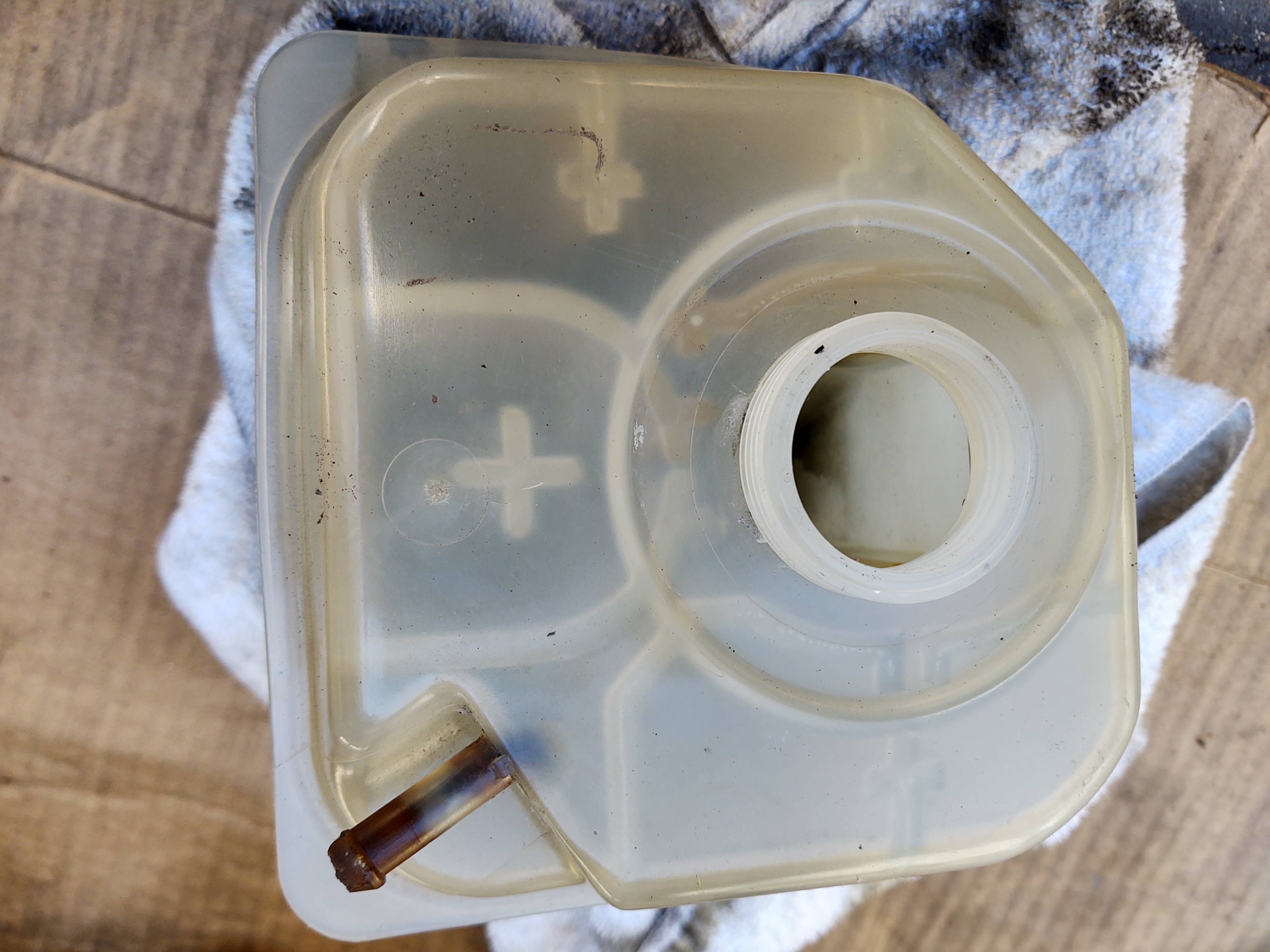

Quick update, the slow coolant leak under the reservoir was fixed after replacing the reservoir. I reused the old clamp. I did notice that there were many "hair lines" under the coolant reservoir nearby the bottom hose area. Bottom of the reservoir was very dark in color.
Old reservoir
Old reservoir
New reservoir
New reservoir
Old reservoir
Old reservoir

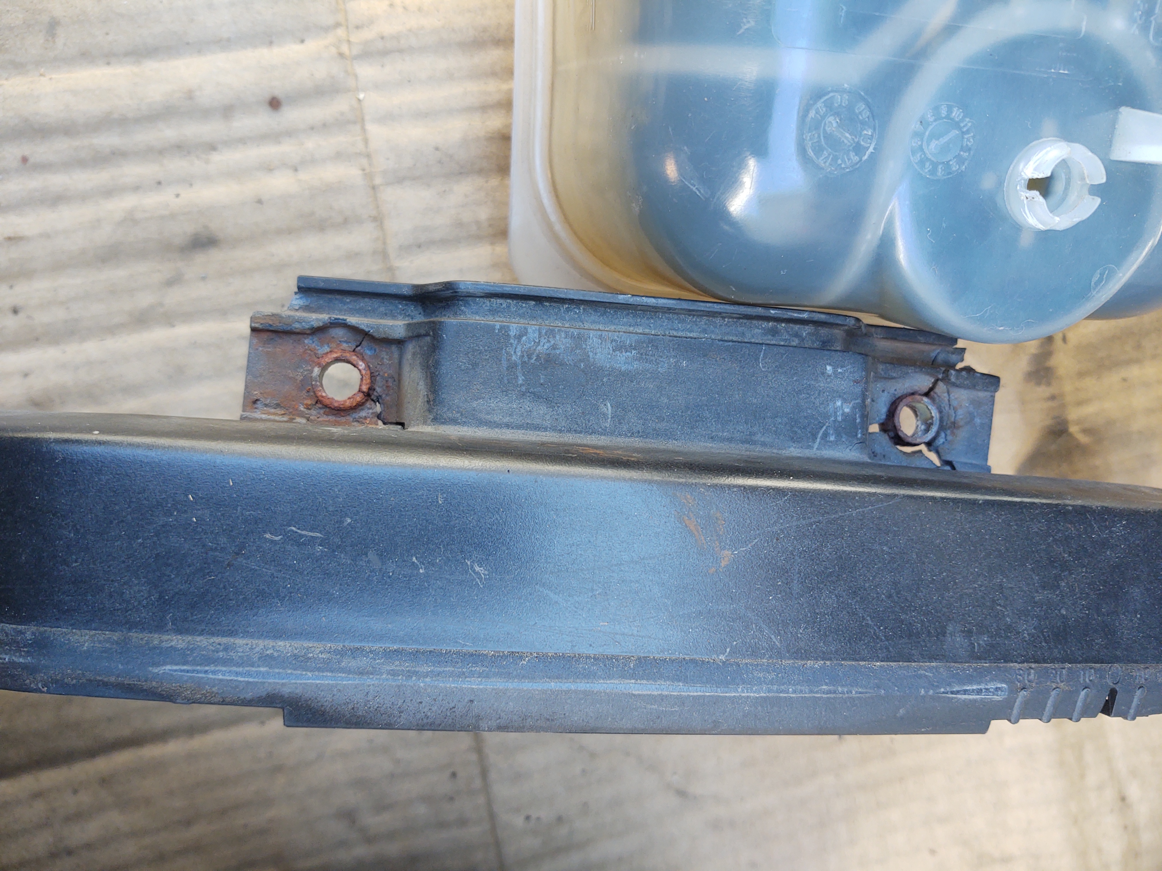

With the old coolant reservoir out, I also replaced the cracked timing belt top back cover - the one next to the spark plug cover.
cracked timing belt back cover
