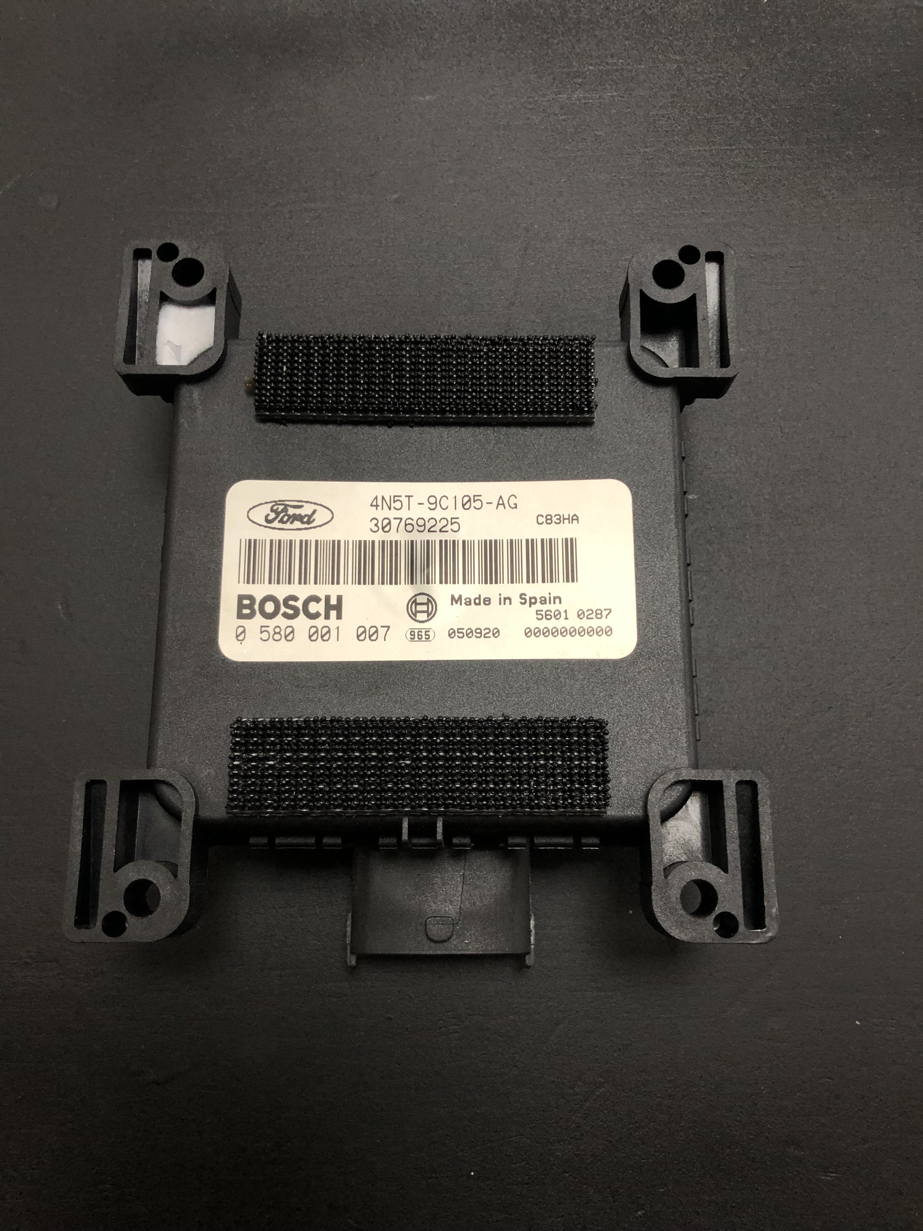

I have 3 rows of seats - I removed the entire 2nd row very easily - I didn’t have to touch the 3rd row. Carpet came right up easily.
The PEM was directly underneath the passenger side 2nd row seat.
The outward appearance of the PEM looks very good, which I know doesn’t necessarily mean anything. It has 180k+ on it at this point and given the issues I’ve been having I’m gonna try a used one to see if that fixes the problem as suggested here.

I pulled out the PEM - it’s a Ford part??
The part number 30769225 matches what I googled for Volvo but I have a hard time believing this is the factory installed PEM??
Am I missing something?
I have pretty meticulous service records and no mention of the PEM ever being replaced or relocated.
Any thoughts?

You can open it up and check for heat sink damage.

The PEMs over the years are essentially the same.
I posted the info in this thread...
https://www.matthewsvolvosite.com/forum ... hp?t=87748
PS: On ebay, look for PEMs with recent mfg date and low mileage.
About $45-$60...
Or visit a local junk yard and get a used PEM.
New is about $300 at Vovlo dealers...
PS: If this proves to be a bad PEM, once you have a new unit in, I'd get another good PEM, test it, then put in the trunk as spare. Never know you are stranded far away from home...
