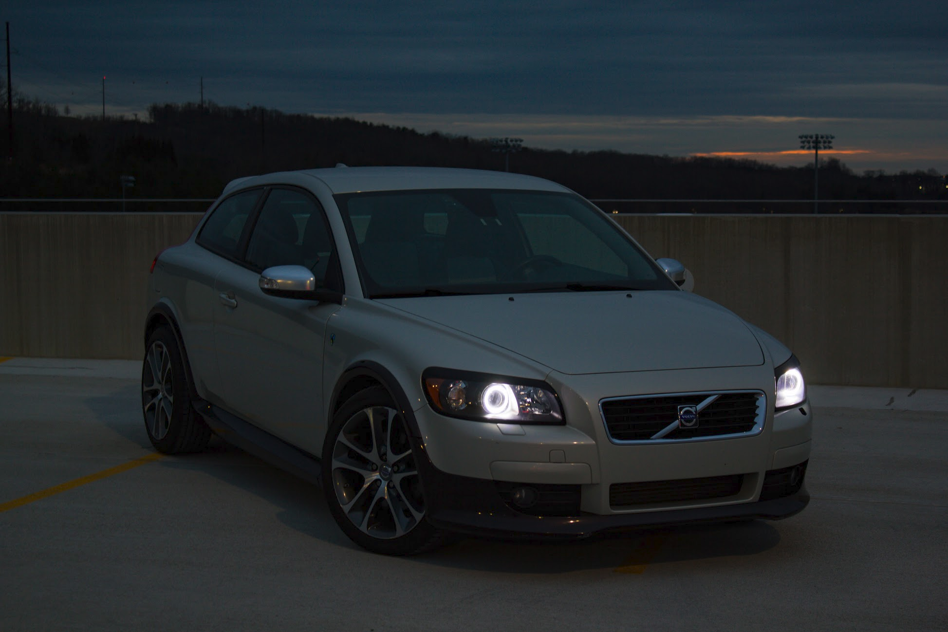

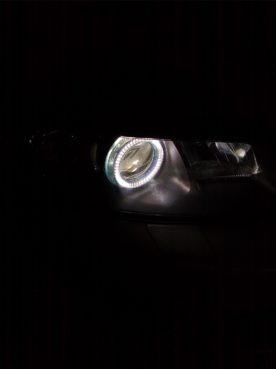

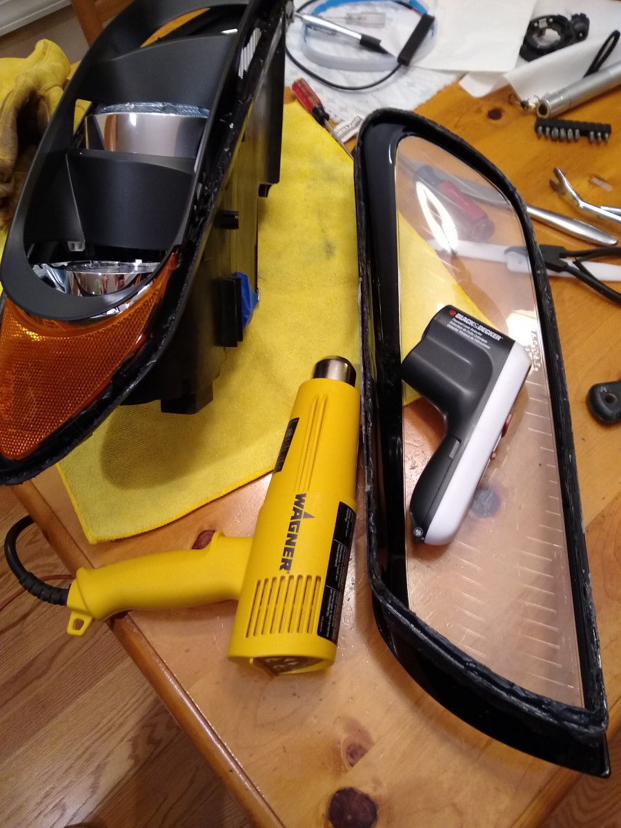

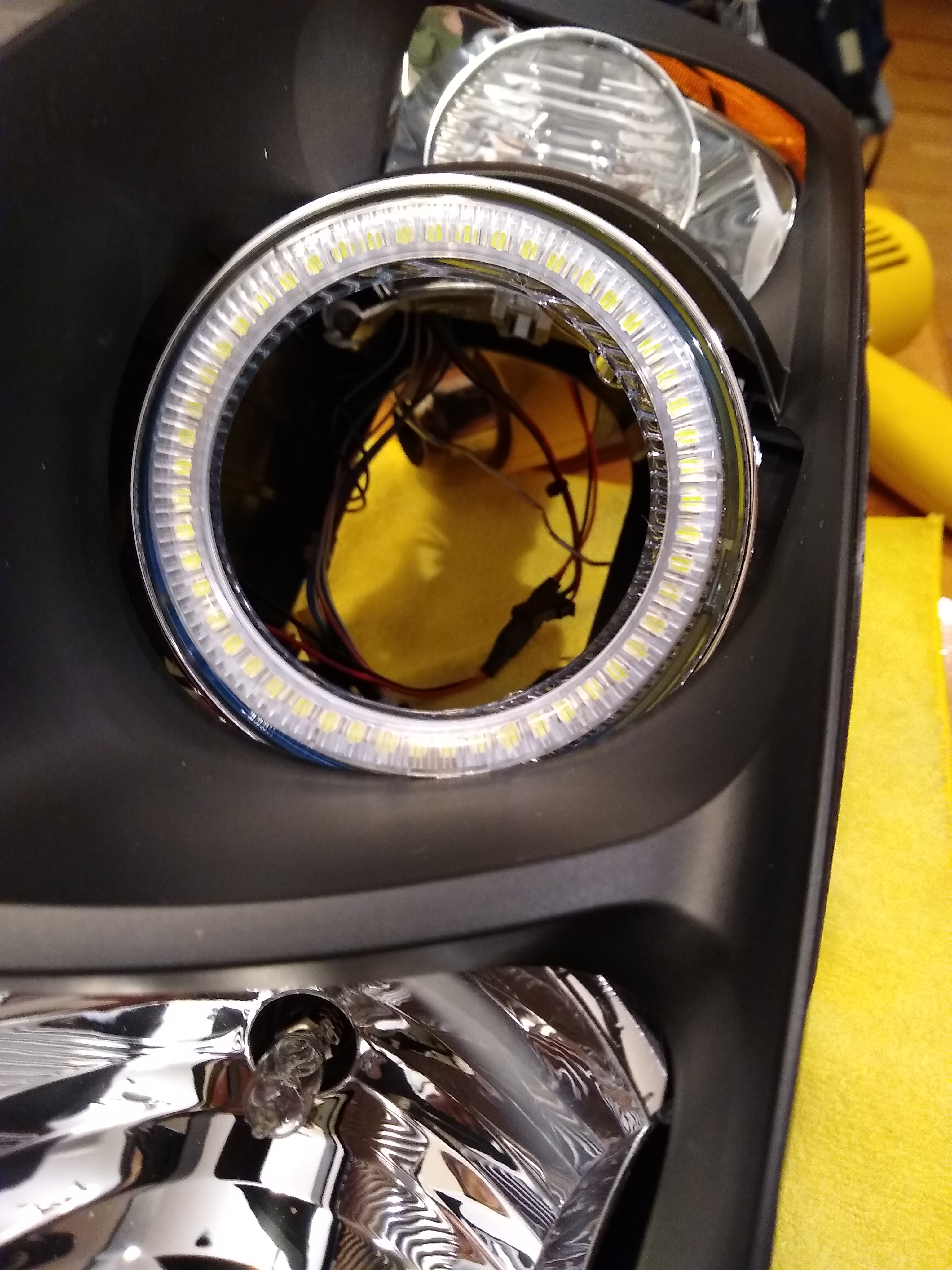

The one you are showing is a HID. Here are pics of Son and I removing the lens on his 08 C30, cleaning and installing Halos / Angel Eyes in front of the Low Beam HID round lens. The HID will have a large round lens whereas the Halogen High (C30) or Low Beam just has reflectors.
