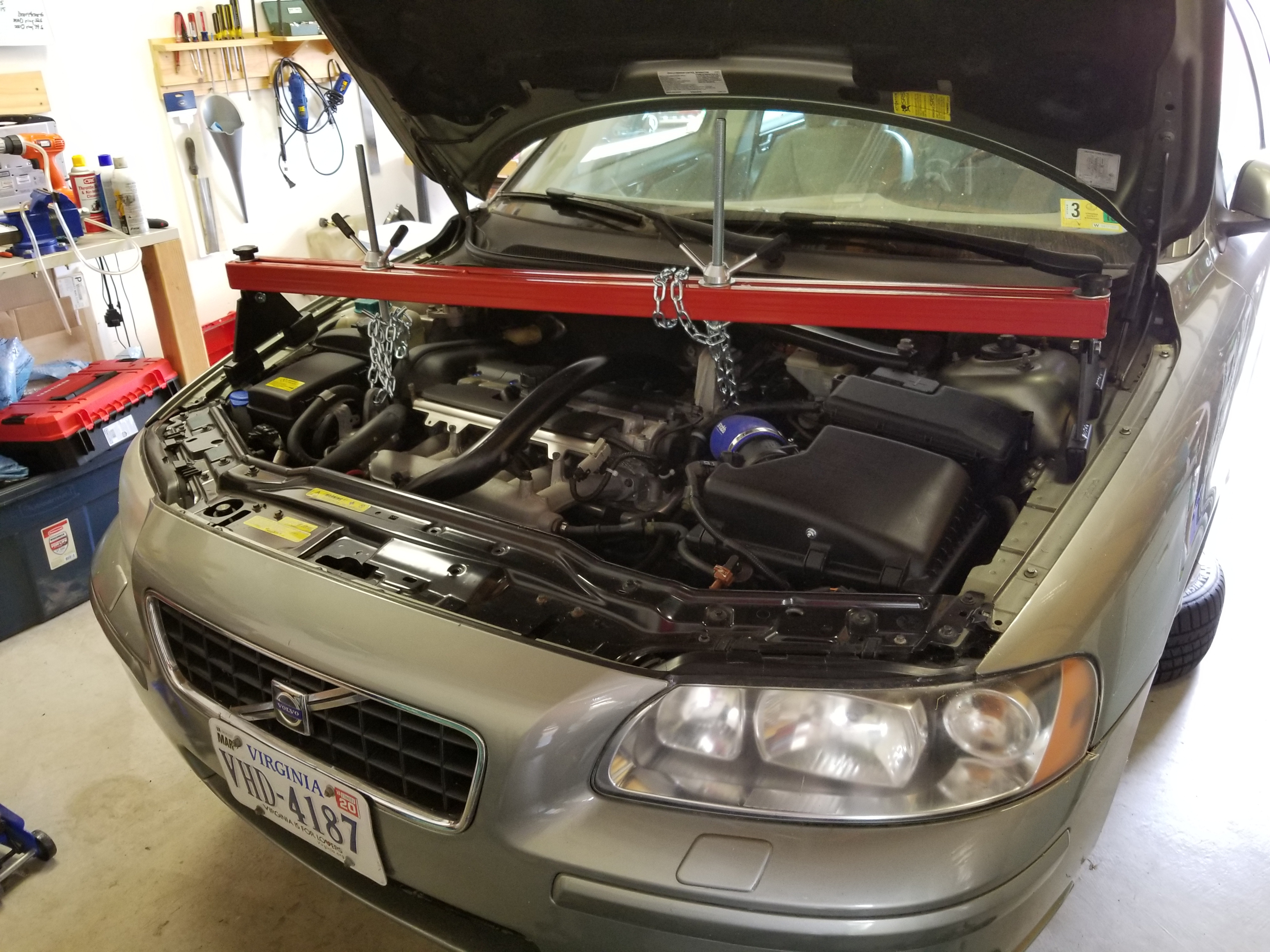

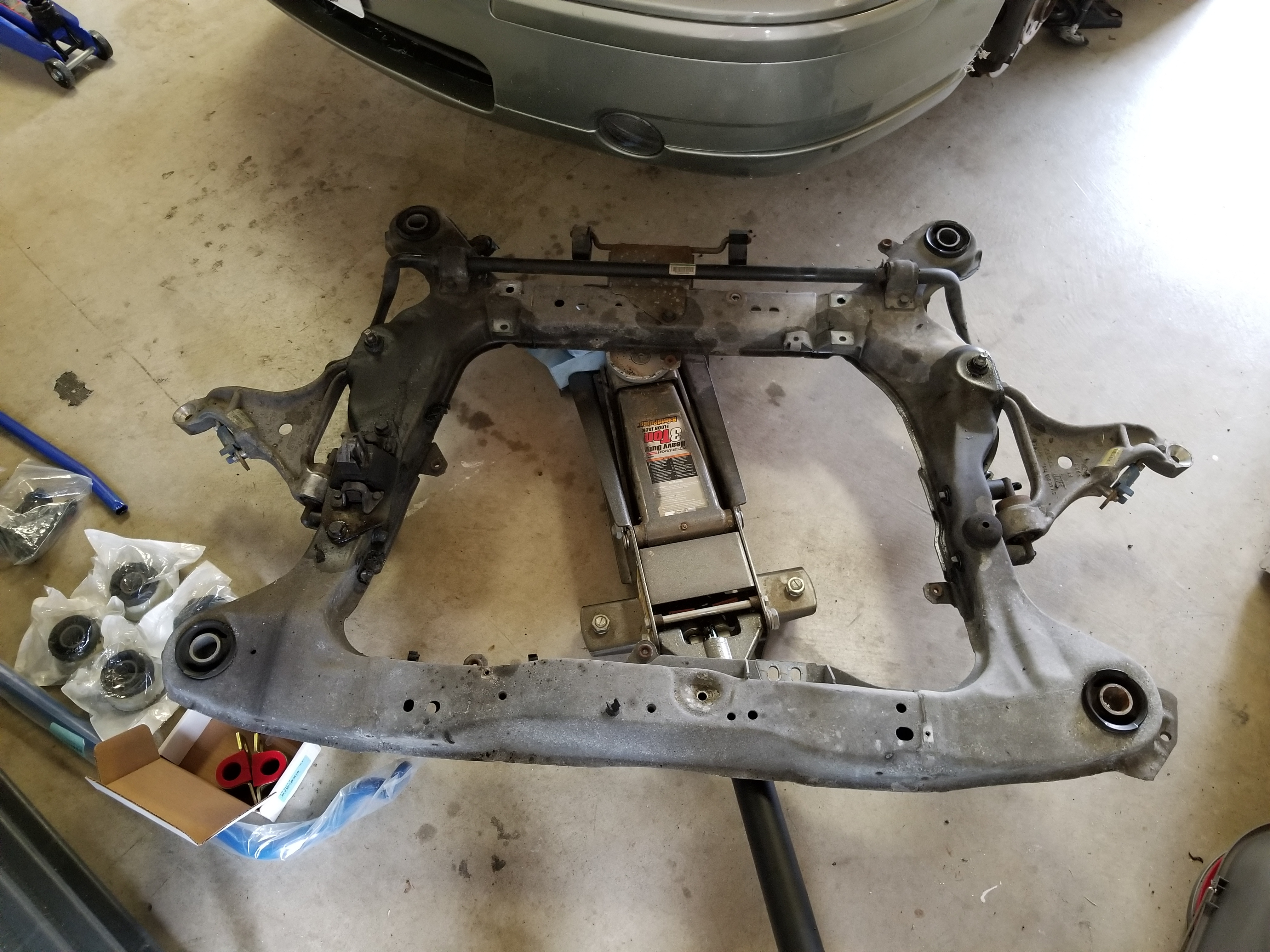

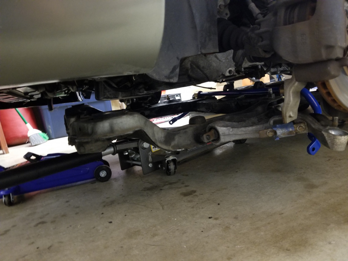

This is by no means gospel, or even recommended, but it is what I did when I replaced the front subframe on my '06 S60 (it had a large dent). I used the HF engine support bar, and for jacking points, I was able to use a spot just barely aft of the the subframe support brackets (the brackets are where I, and I think most people normally support the car on jacks). I gave it a thorough tip-test and had multiple backups in place (jacks, wheels, ramps, additional jackstands, etc.) before I got under it, and kept them in place until I was ready to actually drop the subframe, which didn't require me to be under the car (I lowered it on two jacks and then wheeled it out). It probably made it take a lot longer but better safe than squished. If in doubt, just don't go under the car.
A better method might be to remove those rear brackets first and use the standard locations. I don't recall exactly why I didn't do that, but it probably had to do with not wanting to relocate the jacks - this way I just left them in place, removed the brackets, dropped the frame, and reinstalled the brackets while keeping the jacks in place static. But it's probably better to remove them and just use the standard support points.
I think I have some pics of the setup, including the jack stand locations when I dropped the subframe... let me check... yep, here:
I'm sure this could be improved upon in other ways, as well, so if anyone wants to weigh in or point out anything they think is unsafe, go right ahead. Better to have the discussion and use the pics to point things out so we can more safely (and maybe more efficiently) wrench on these cars.
