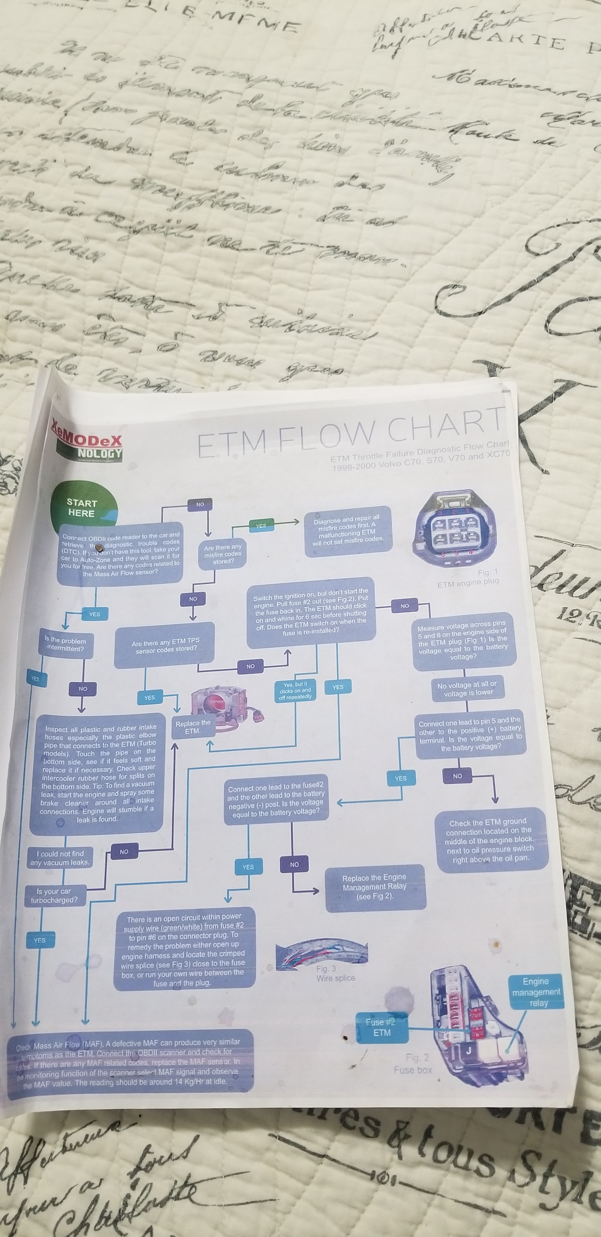

I found an old Xemodex diagnostic flow chart, I know it is for the ETM issues but might help me some Because when the key is turned on the ETM dash check light does not come on before starting it like it should ( unless the ignition related fuse is pulled then reinserted) as mentioned earlier. The ETM is supposed to make a high pitched tone or whine for 6 seconds and make a clicking sound from the butterfly opening when the key is turned on before starting, well if I pull the fuse first everything functions properly, if I do not pull the fuse the ETM will click but the high pitch tone is constant, not just for 6 seconds, so if it is the ECM or a bad 2/76 relay ground or whatever I have been trying to figure this out for quite some time. Yes you are correct HPT 2.3 with M56 5 speed. If taking it to Volvo was an option I would but I do not have a Volvo dealer unless I drive over 400 miles 1 way.
