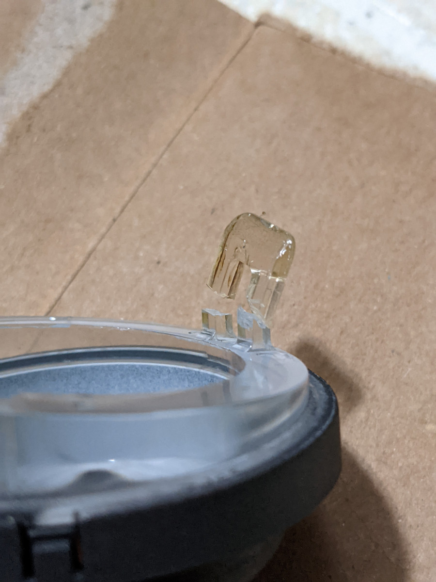

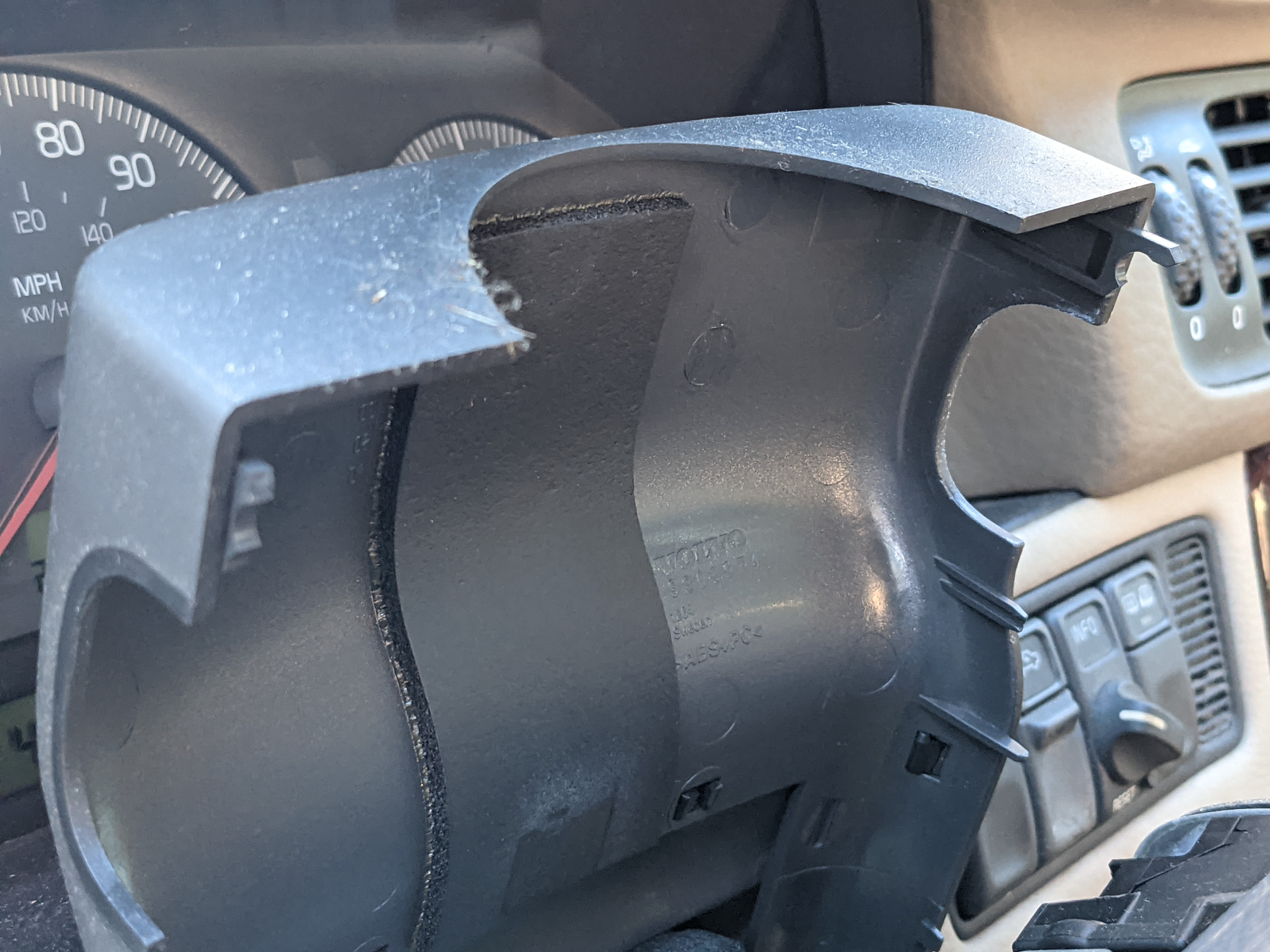

I was able to swap a 1999 V70 immobilizer ring into my 2000 V70 and it worked fine. As always, I'm skeptical about 1998 or older in a 1999-2000. They're inexpensive to buy new and easy to pull from a junkyard.
When installing, be careful when you separate the top and bottom plastic halves of your steering column shaft. There are plastic clips on the top half which hold pins on the bottom half. Those clips may be brittle and break as mine did.
Also, the immobilizer ring has a tiny clip on it which is fragile if not already broken. The ring stays in place with the clip broken, but taking care when removing it would keep it intact, making it more stable.

You can tape the immobiliser ring in place once it is in place if the tab breaks. The column shroud will then hold it in place. As it just senses the chip in the key the accuracy of position is not too critical other than to see where the key is positioned.
