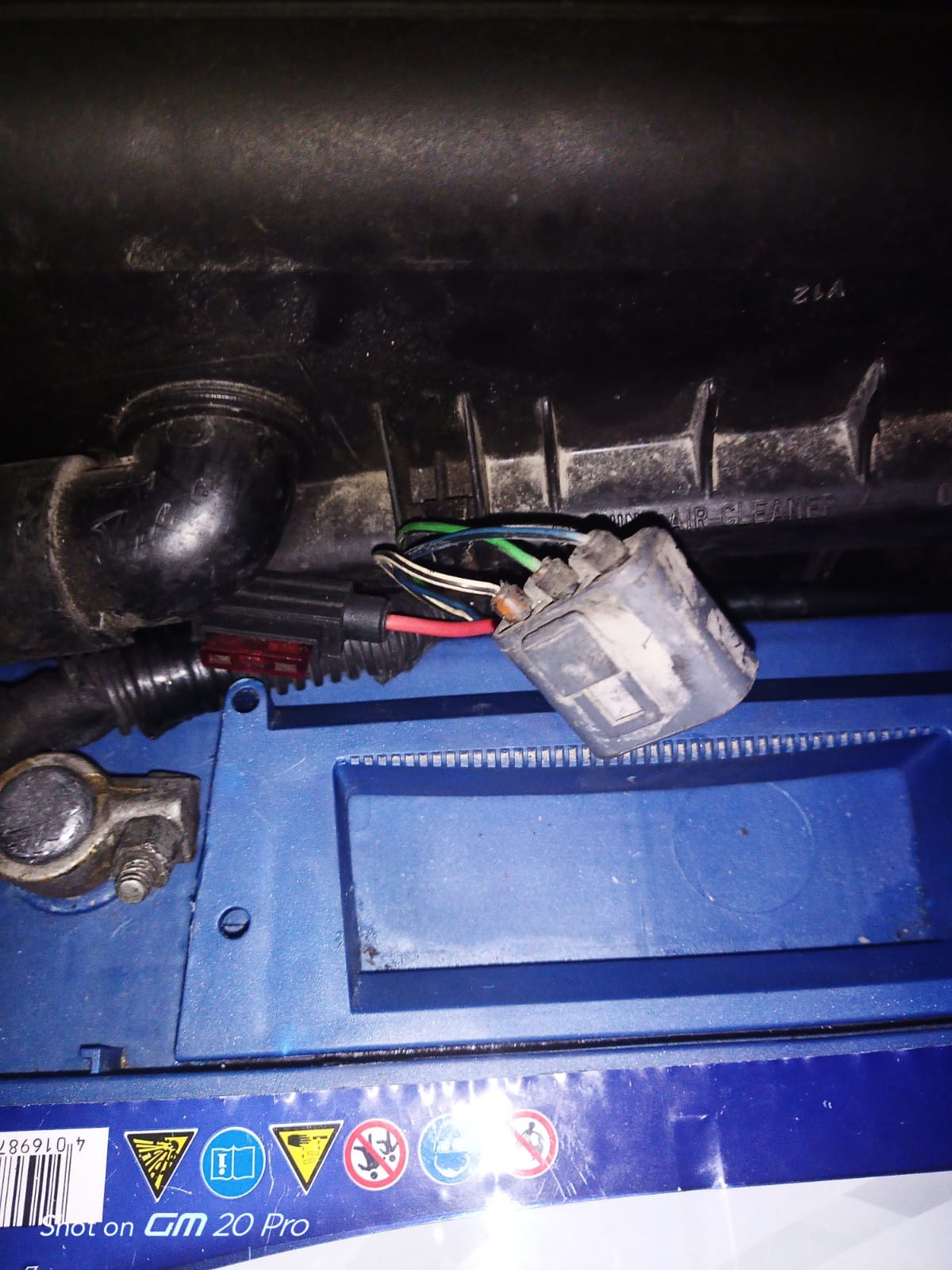

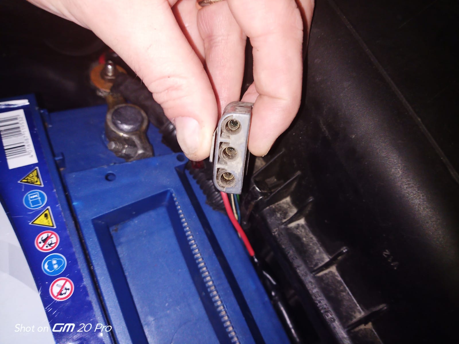

Hello, I didn't know if I should open a new topic or continue here, but every day I see a new free socket in my vehicle, it bothers me, actually I have a cable guide, but I couldn't find some sockets, for example, this three-pin socket that came out from the bottom when I disconnected the battery for charging the other day. It looks like it's coming from the channel of the positive cable, but what is the line?
