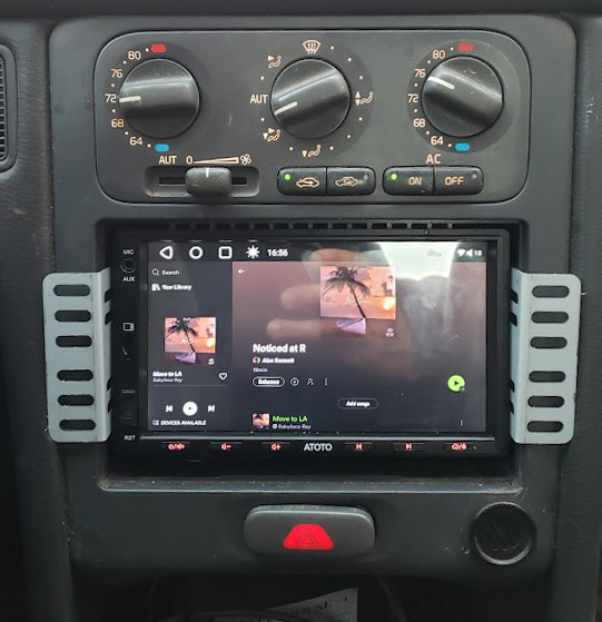

It's not so much the trim I'm worried about, I'll work that out possibly by laser cutting something. Just trying to figure out how to secure it without those brackets.

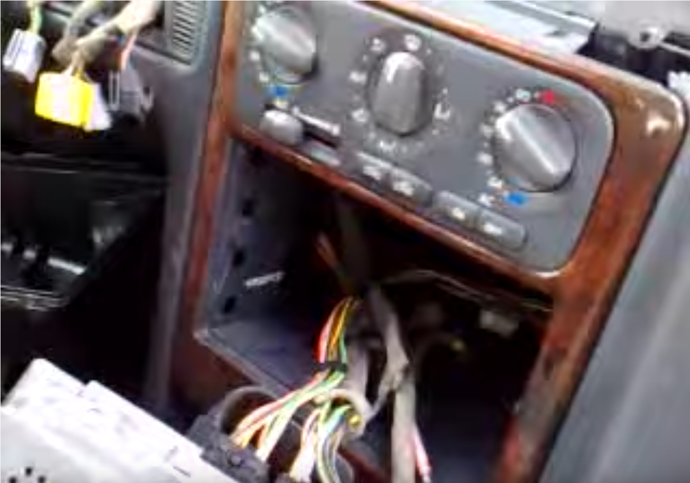

Does anyone know if the trim around the stereo is removable? In this pic that's the trim that surrounds the hazard lights button for example.

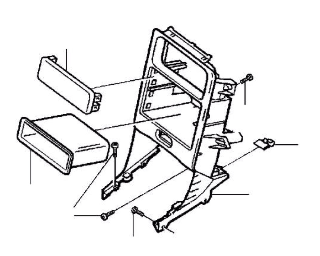

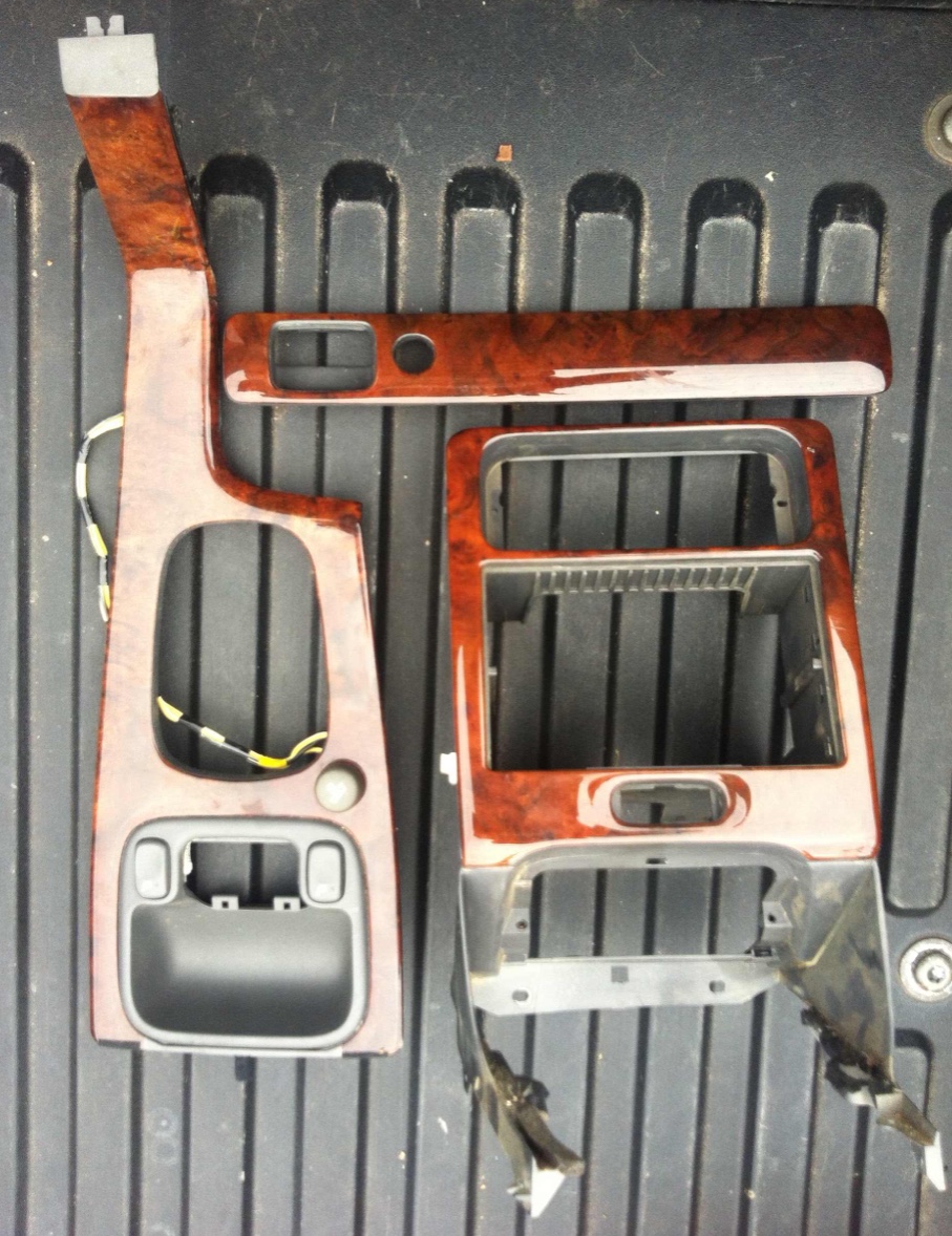

Maybe that’s a Toyota dash you’re remembering?
The Volvo center trim doesn’t come free without a fight.
There are three pieces of dash trim in a 70 series dash.
The glove box - Very easy.
The lower center console between the seats - A bit more effort.
And the upper center trim for Climate Control, radio and ash/coin tray.
These are installed at the factory from the back of the dash and
are not a simple job to remove and replace. There are a number
of fasteners that are driven from the “back” of the dash and were
never intended to be reached by mere mortals... From a build
standpoint, it makes a lot of sense. They assemble the entire
dash on a bench and the bolt the whole thing in at once -Done.
Unfortunately, it impedes removal by end users.
Looks like this:

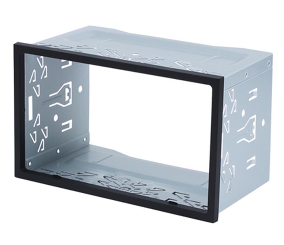

Your best option would probably be to find a universal sleeve
and trim ring and modify them to suit. Then it just mounts like
the OEM HU and everything is easily reversible for the next guy.

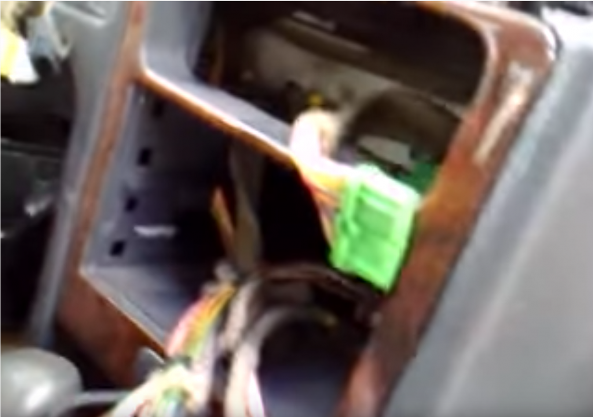

Looks like you can access the top after removing the Climate Control Panel. Also looks like the bottom of the stereo cavity is large and flat. Secure the existing bracket on the inside for the stereo to sit on. You can use soft moldings, weather seal or small hoses (all at Lowe's or Home Depot) to wedge the side of the stereo or even larger hoses cut in half. Use this to space the unit properly for the gaps around the edges. Though it's seated on the brackets some cushioning for the space below the units wouldn't hurt.
From the top you can use some shallow screws to attach the unit to the upper brackets. You can also purchase Simpson Plates and bend for brackets if you don't have enough. After that you can get creative to cover the gaps on the face plate.

Those square holes already on the left and right walls of the radio cavity are great for holding the triangular tabs of the sleeve which BEJinFbk posted. There has got to be a sleeve for this radio.

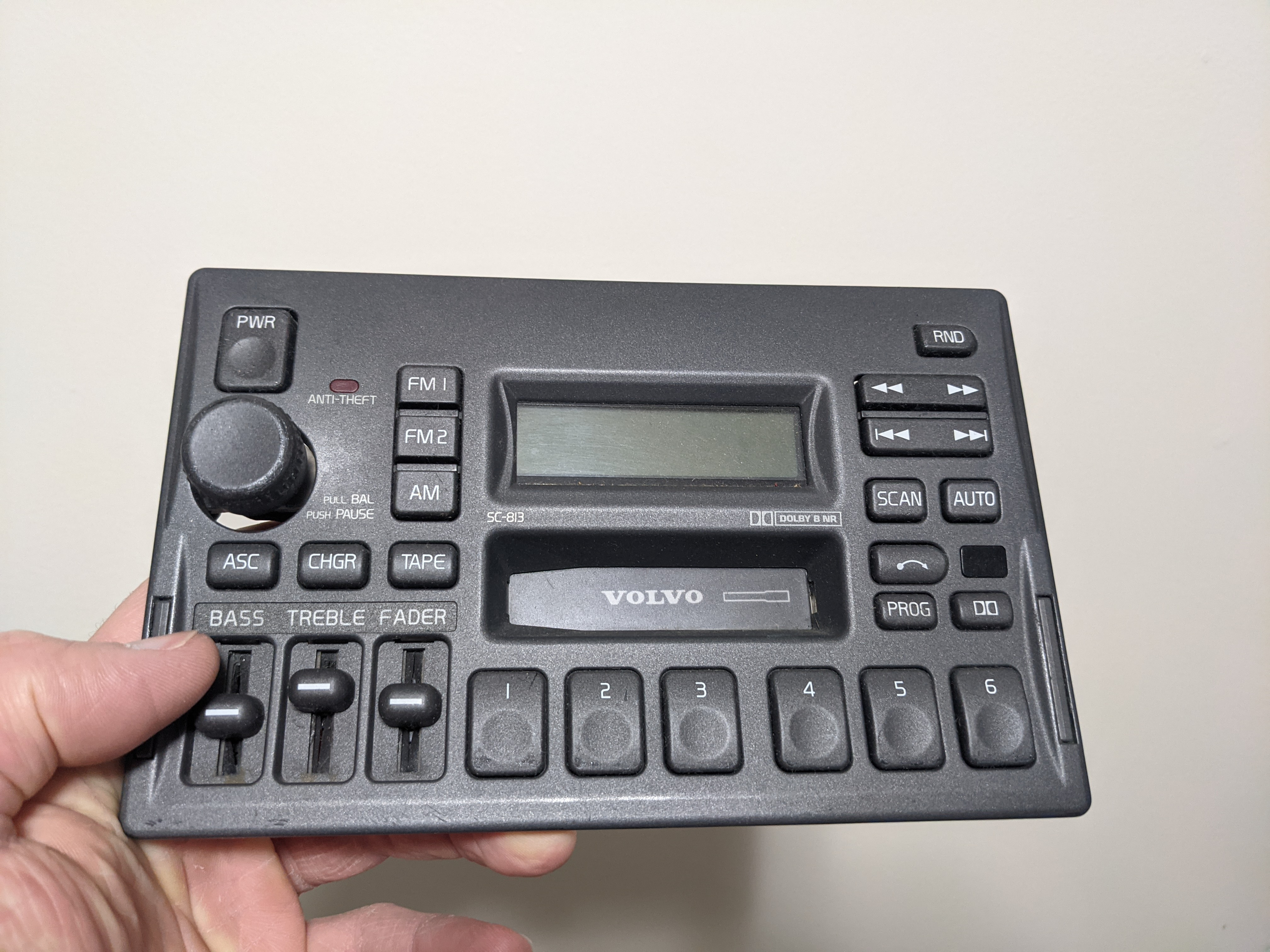

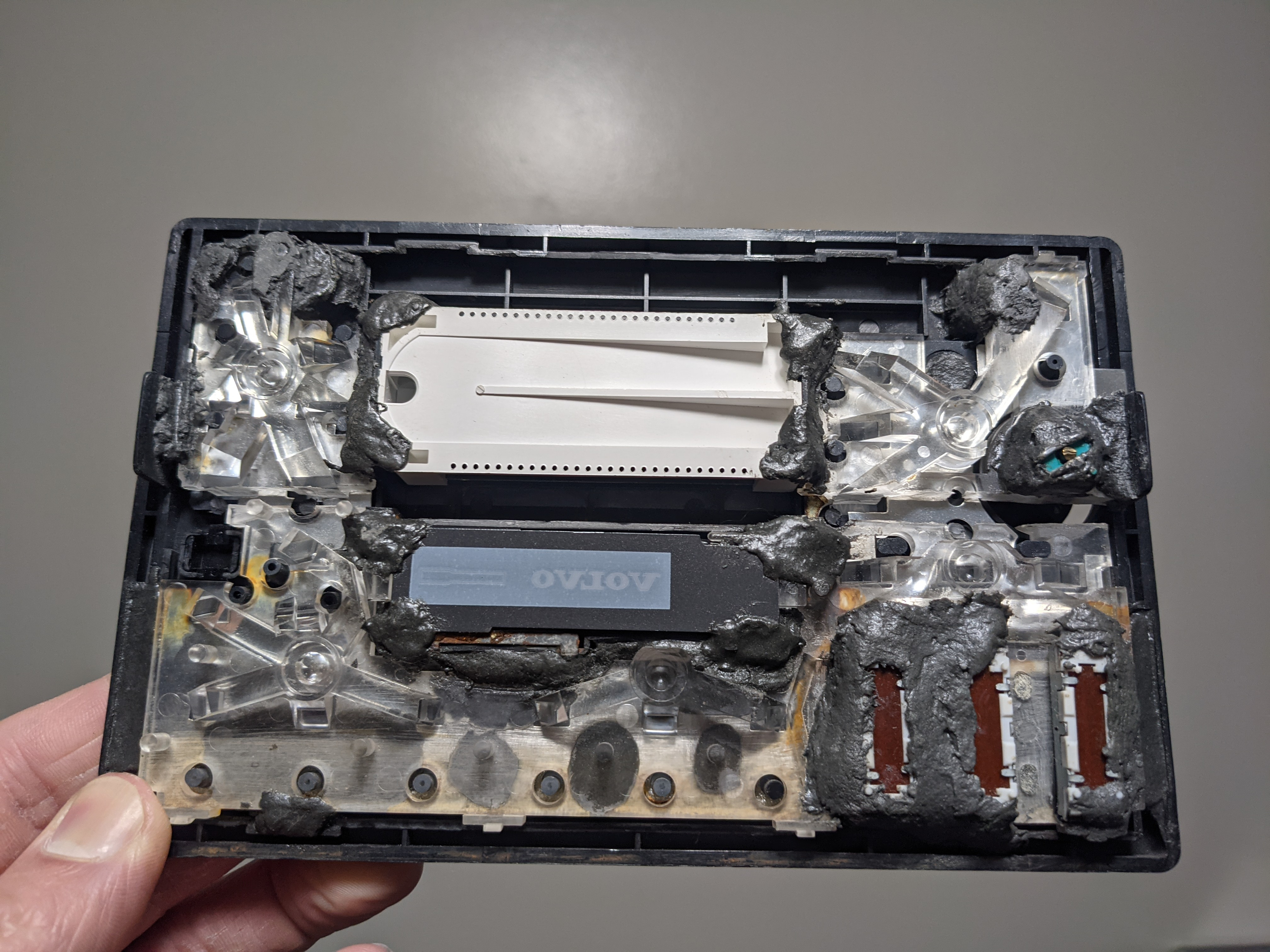

I love your idea of the "fake faceplate" from an old radio. I did the same thing 20 years ago when I replaced my radio (with two single DIN units). I got the Volvo headunit with no CD so it looked even less desirable. I recall that I couldn't simply remove and reuse the face because many of the parts were separate (tape cover, screen, etc). So I did an epic Dremel cutting and epoxy job on the parts to hold everything together. Because I enjoy overdoing things, I ensured that all the buttons, sliders, and knob still moved.

And hilarious about the face plate, exactly the same idea. Except I stripped out all the stuff from the back and went the easy route with hot glue to attach the knobs. Though mine don't move of course...
And I hot glued some fabric on the back of it to protect my touchscreen. Unfortunately I lost the fader knob, but I don't think the crackheads will notice.

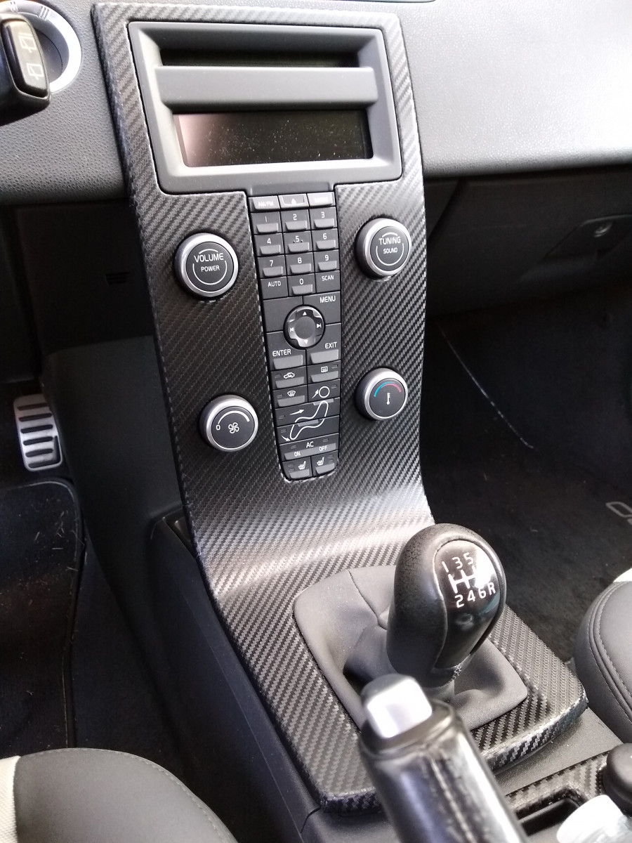

Creative wrybread! Hot glue has been a friend when installing fake carbon. Just a dab to keep it from coming undone around the back corners.

Nice on the carbon trim. Has it held up longterm? I have very mixed feelings about hot glue on anything other than fabric. It always seems to fail, especially in a hot car.
