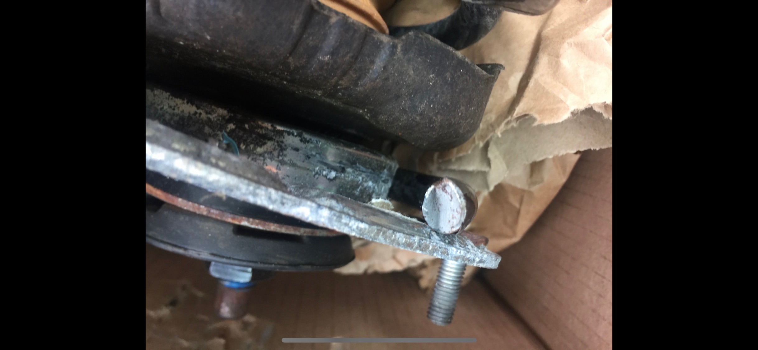

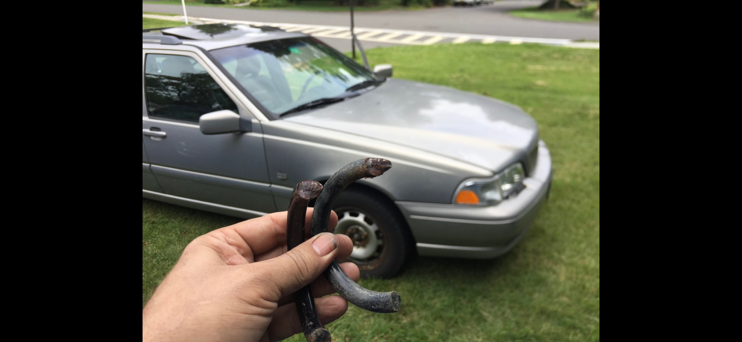

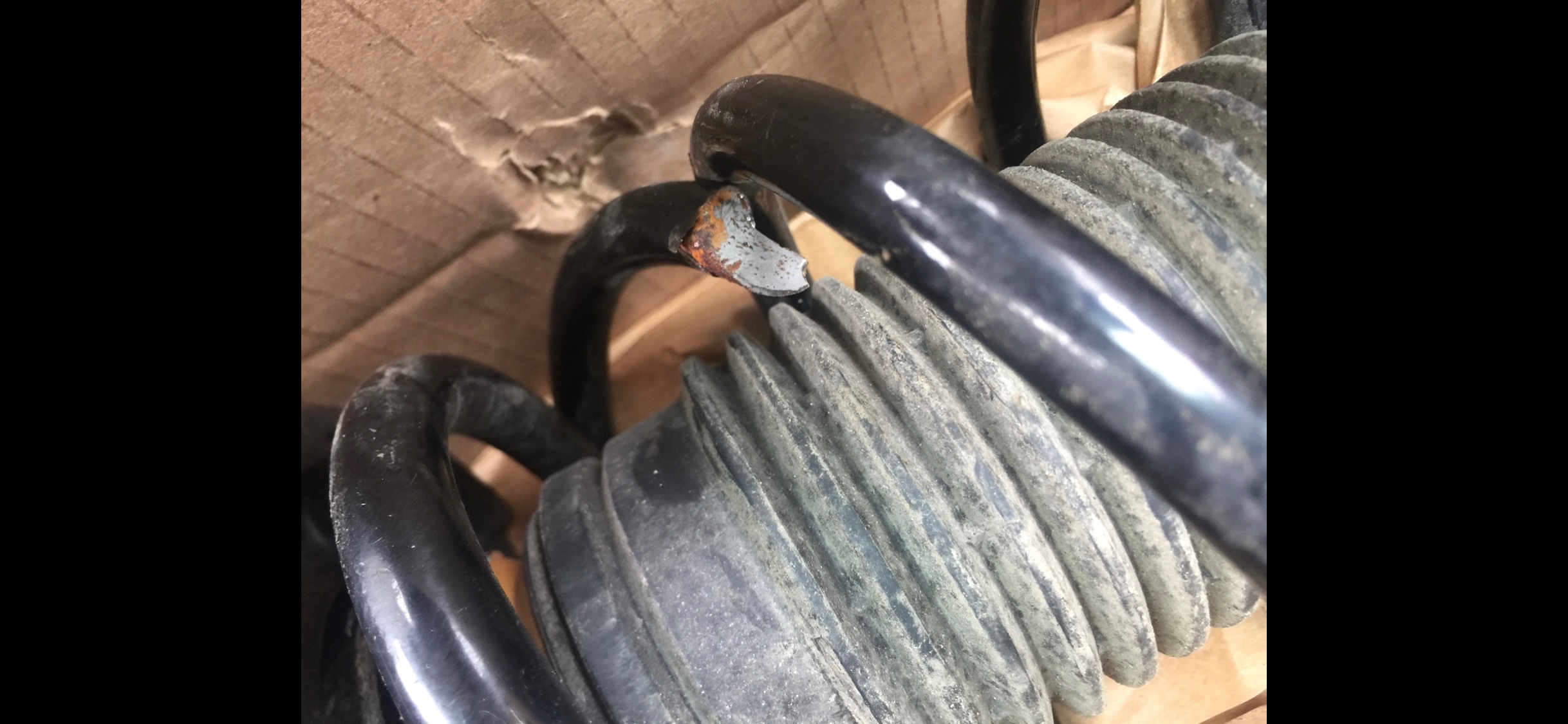

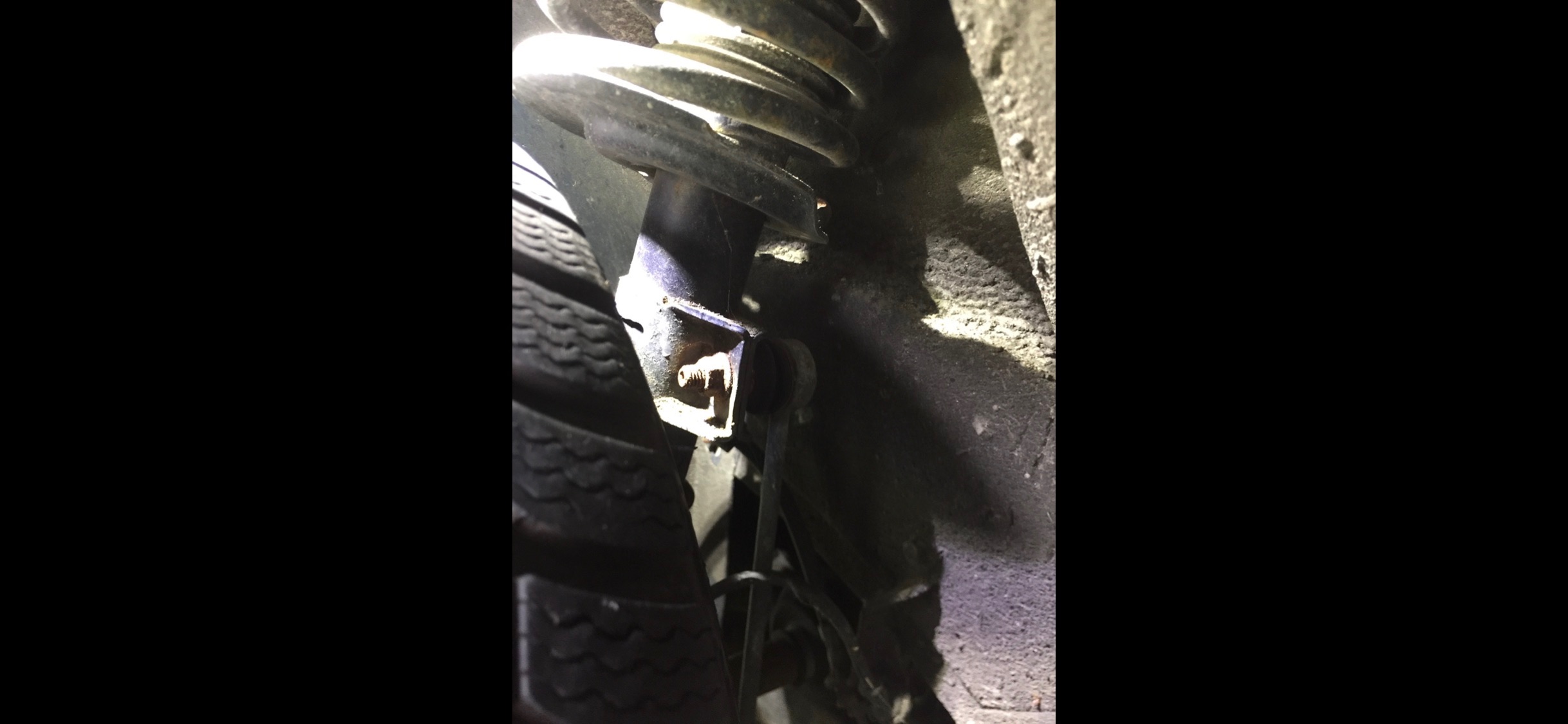

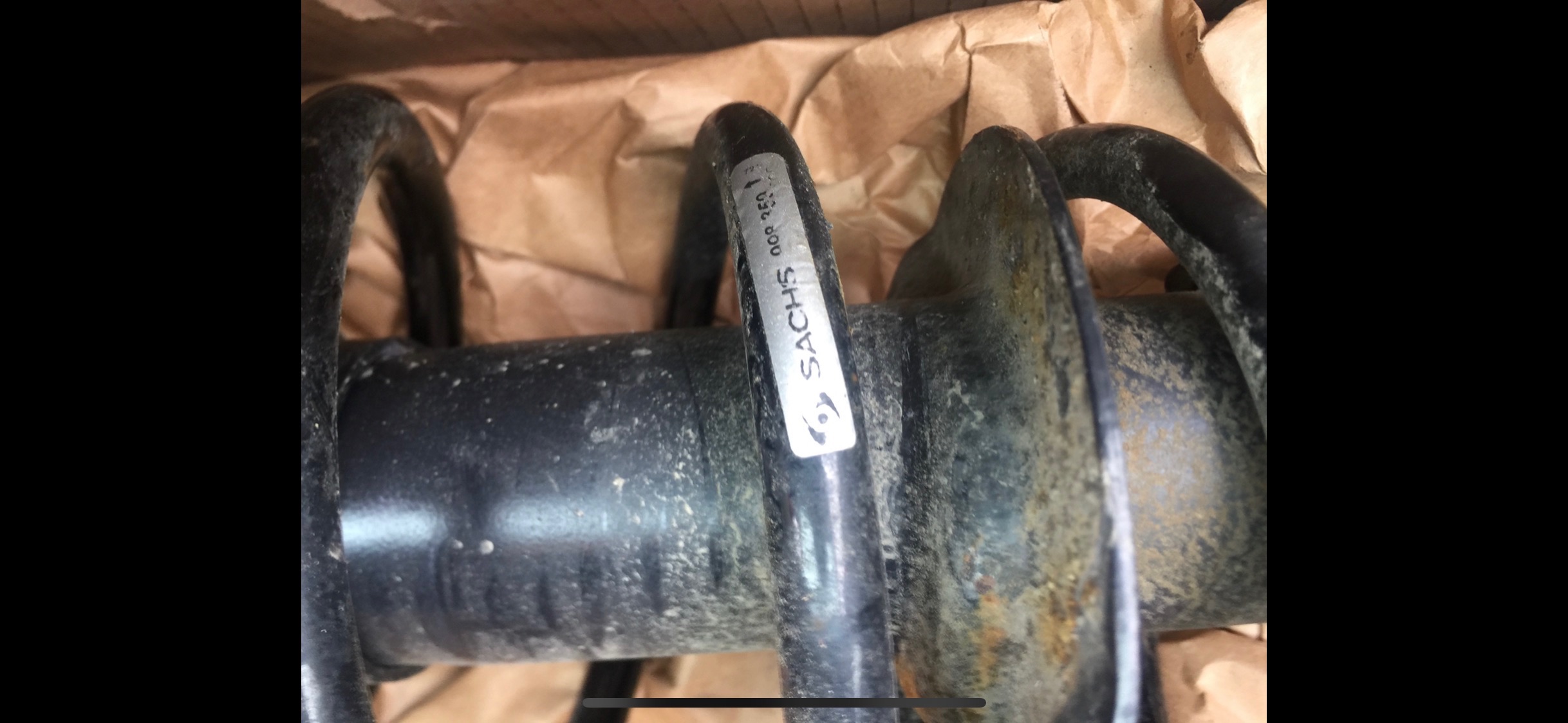

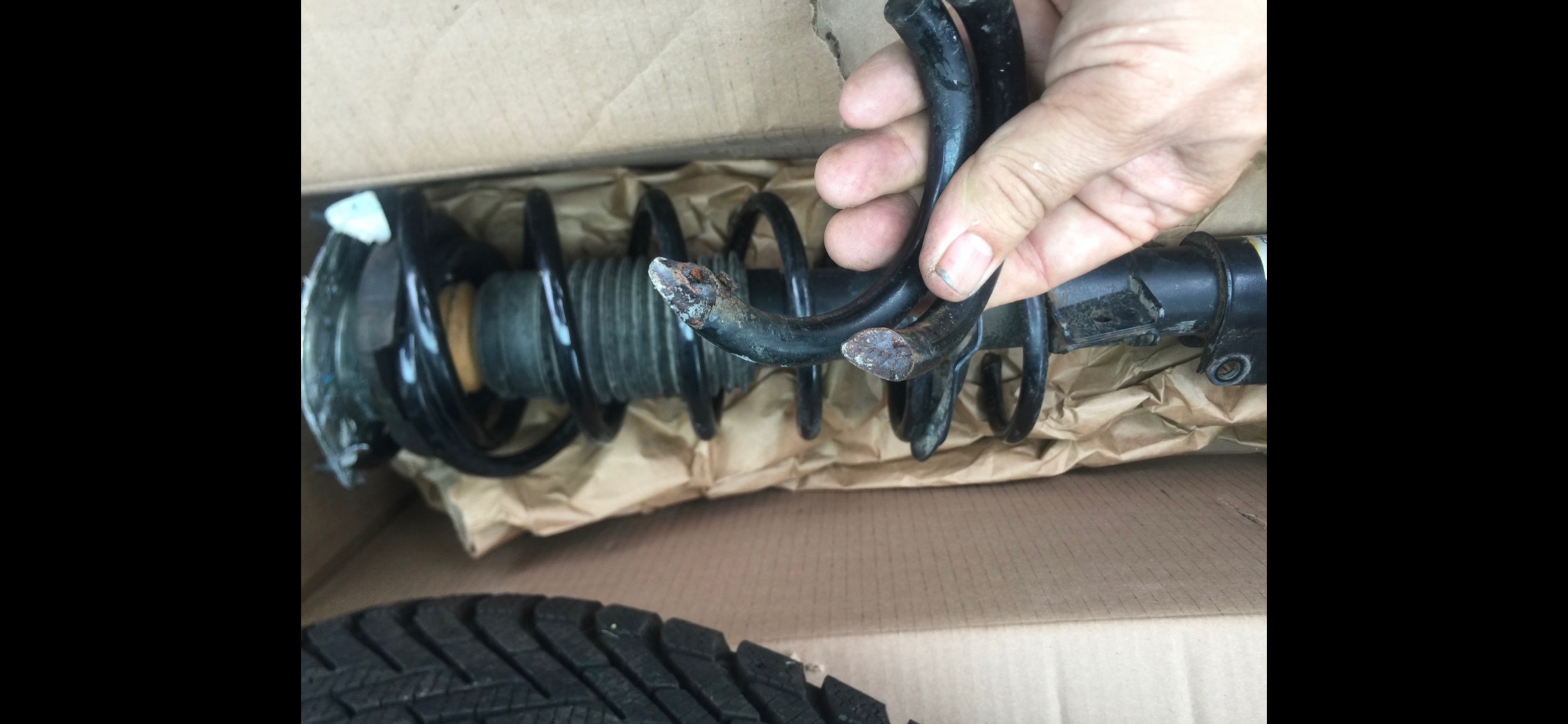

6 month old Sachs quick struts. Both sides went off like cannon fire a week apart
Wiped out a wheel and tire, too.

- Abscate, did you file a complaint with FCPEuro (or wherever you bought it from)?
Maybe it was a bad pot hole???
- Maybe this is the reason they removed Sachs Quick Struts from the shelf.
I am back to rebuilding it myself.
- OTOH, my 2004 V70 Sachs quick struts are still OK 3yrs/24K miles later (installed 2019).
PS: the reviews of Quick Struts on FCPEuro are very good FWIW...

Exactly what I was saying in my previous post.
Being it's weeks apart and from the pics it looks like bad forging from the rust embedded in the middle of the spring. Sach has third parties build it and they source the springs also. Time and chance, hit and miss so that's the LOT.

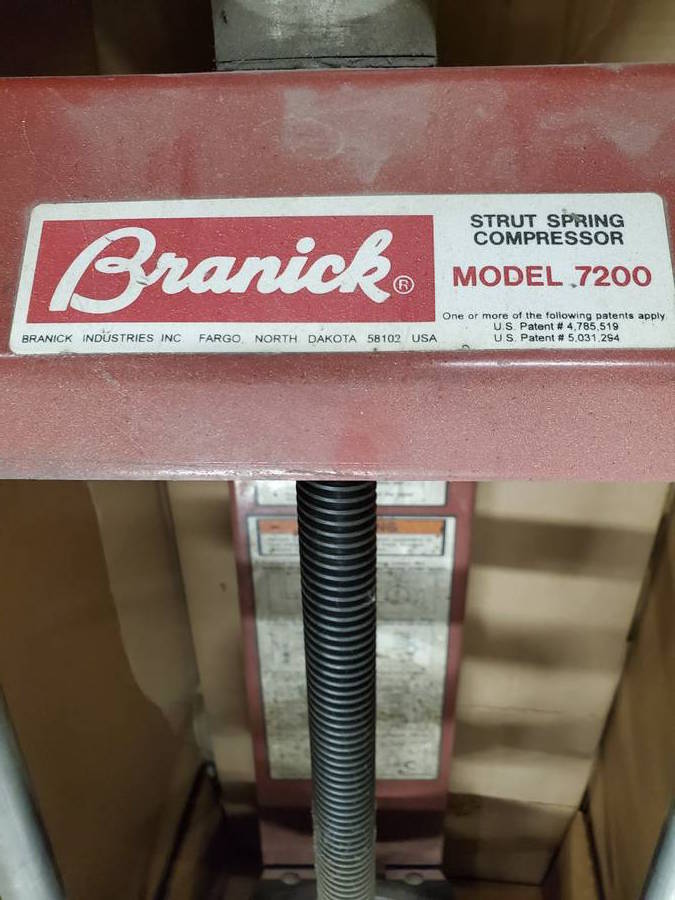

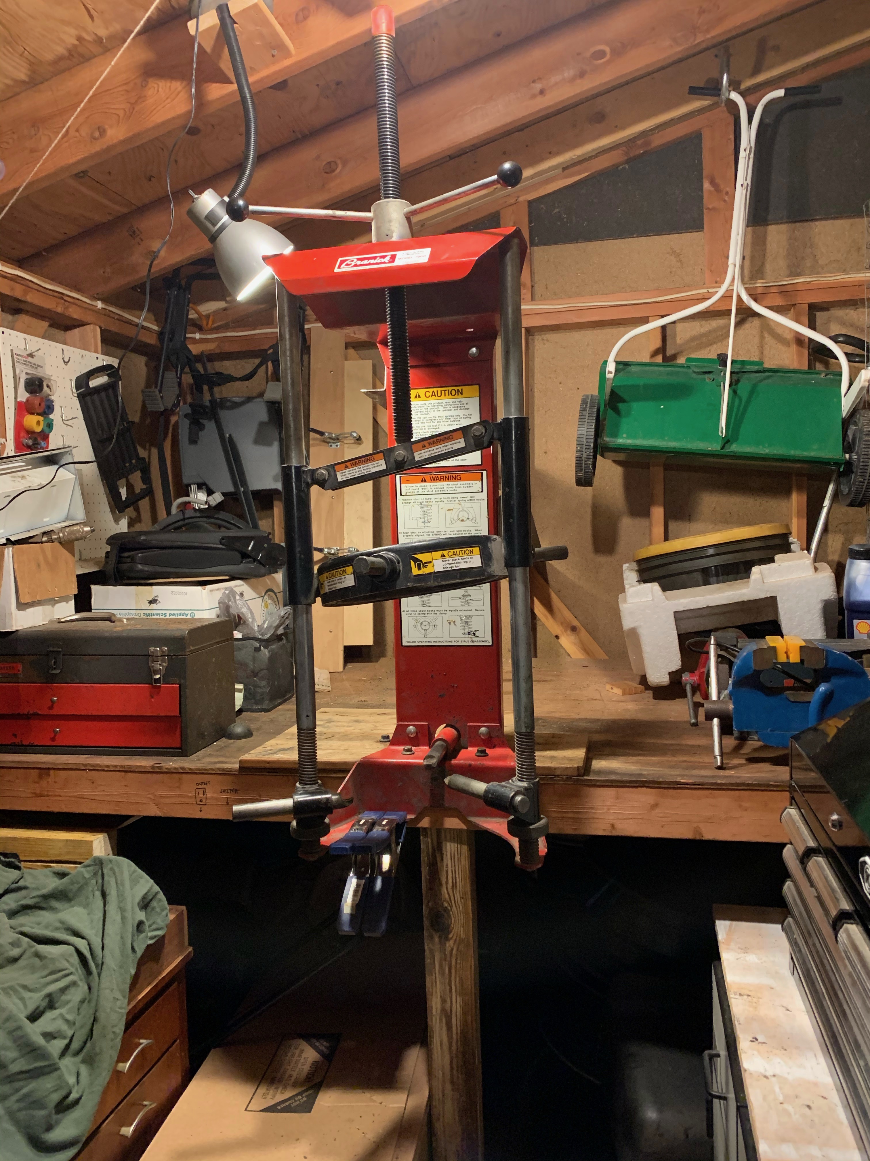

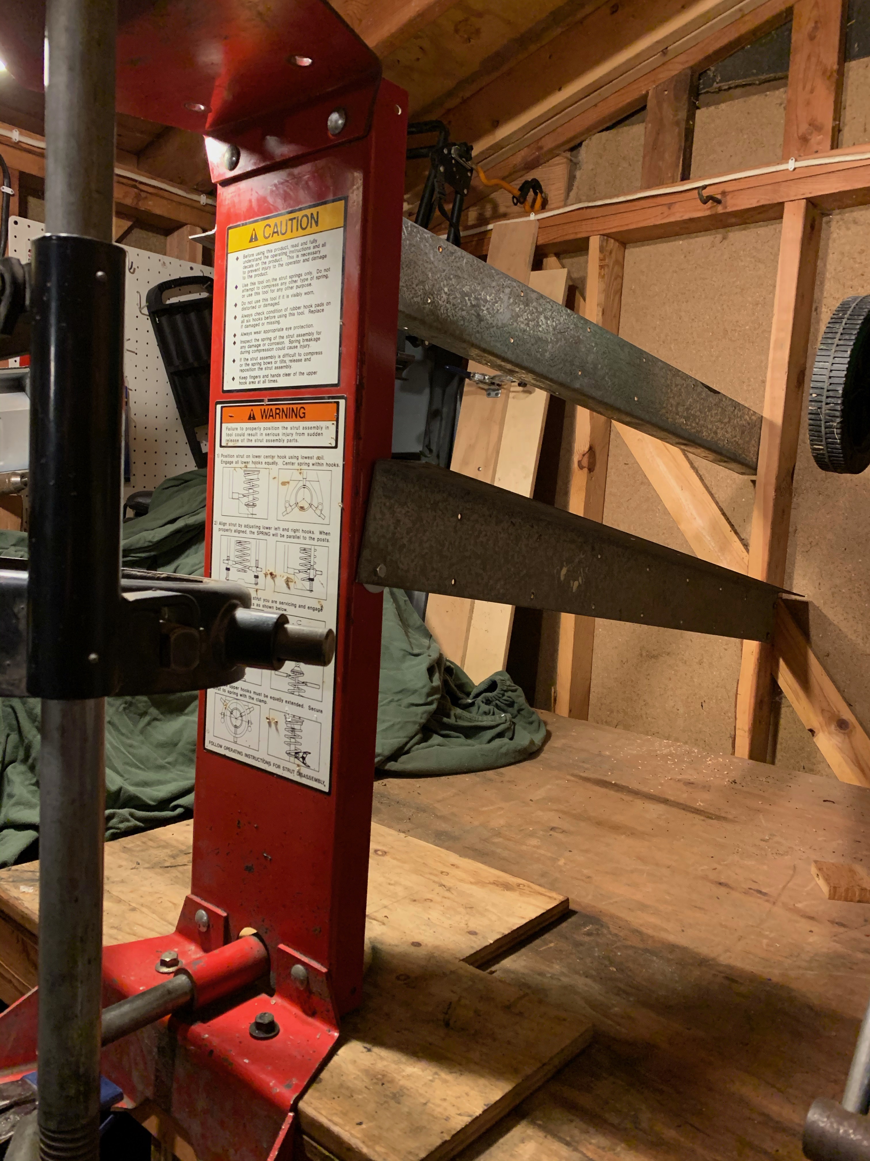

My remedy for quick-struts, picked it up cheap from a body shop that upgraded:
I've done three sets since I bought it a year ago, has paid itself off as far as I'm concerned.
