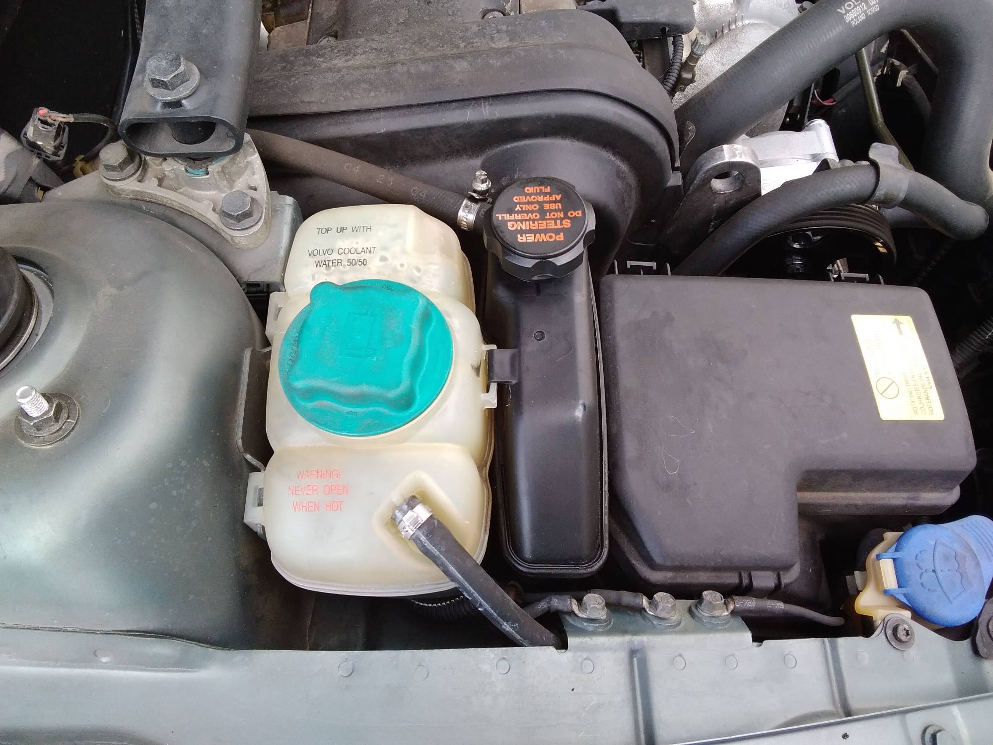

This appears to be my problem as well. Oil drenched engine front and half the oil pan. (Leaked fluid is green)
Pump has been recently replaced. Reservoir and supply hose look suspect.i washed it off with Super Clean. I'll see how it does tomorrow.

On two different 2000 V70s, I noticed that newly installed reservoirs swelled quite quickly after install. The system is pressurized and that causes the expansion. It's a common problem that expansion for 10+ years causes leaking at the horizontal seam. I'm saying that swelling is common immediately thus not an indication of failure in itself. As you did, it's best to clean the tank and check for leaking at the seam.
I've also experienced leaking at worm gear clamps because I failed to tighten them enough. Fluid drips down on to the seam making it look like the seam is leaking. Be sure to tighten the clamps firmly.
