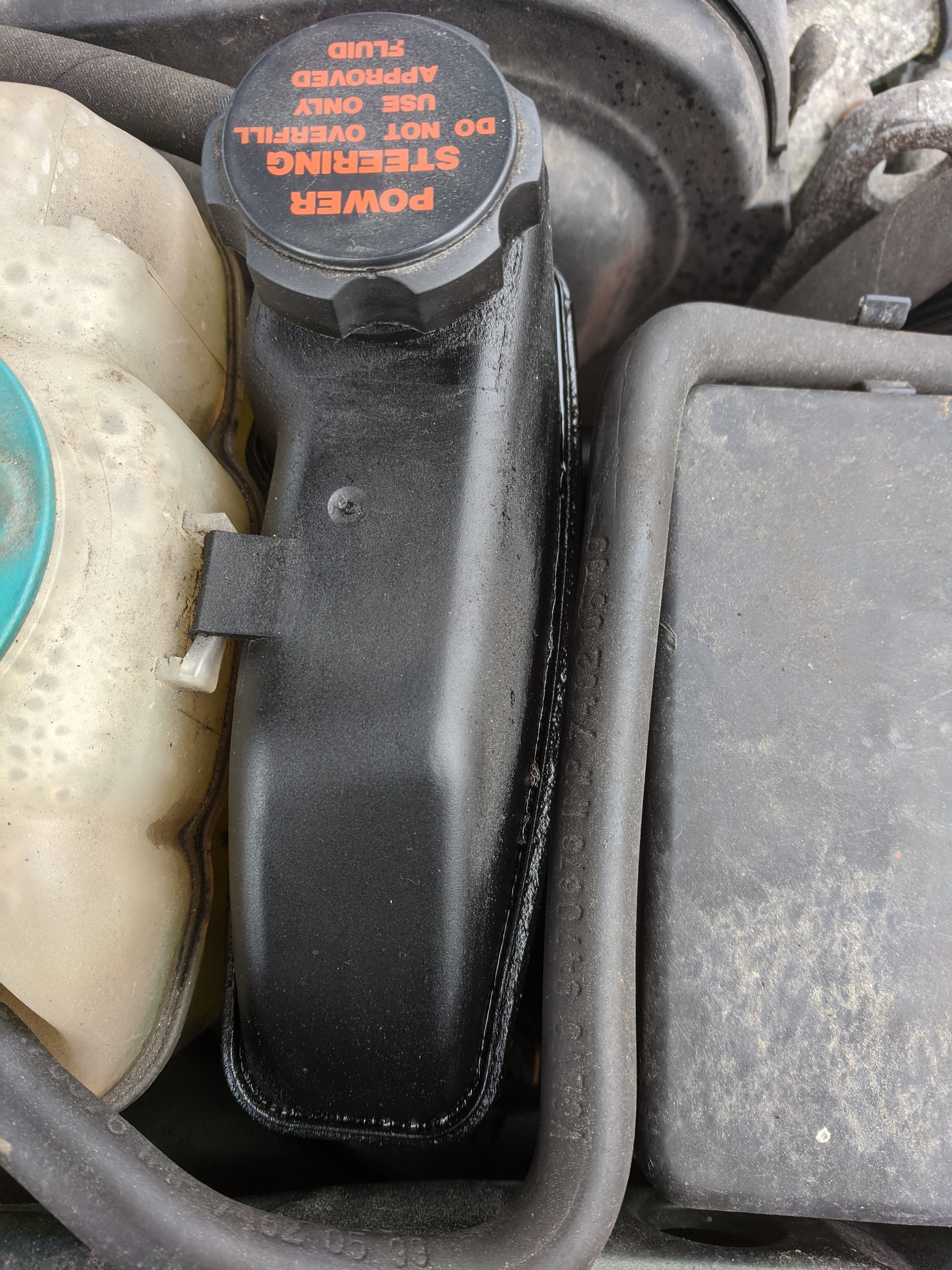

New to me 99 V70 T5 ~175k miles. Had it about 3 months now only put maybe 100 miles since I have owned it. Pretty much brought it straight home and started taking it apart to address known problems and Stage 0 it. Well I discovered a power steering fluid leak. So much so the bottom of the engine was wet on the right side. Upon further investigations, the low pressure hose was soaked. Ordered a new one and a high pressure line O ring. Haven't replaced either of those yet.
Well, while I am currently digging into the PCV service I found the HUG mess in the attached pic. Looks like this thing has been blowing out PS fluid for a long time.
My question is, could just the leak there at the low pressure hose cause this much of a mess? Or do these leak where it looks like the pump can be split with those 4 bolts and that's what could have made the mess? Or both? If the pump can be split, is there some sort of gasket kit?

The usual leaks are the pipe and their crimps or the header tank seams which get sweaty over the years.
Certainly looks like the pipe to the left in the picture is not sealing correctly. I would clean all the oil off and then see what comes back.
I had to replace my header tank to pump hose as it was starting to leak at the pump end. The replacement was an OE part but found I had to shorten it a slightly to get it to fit without rubbing on the serpentine belt.
There may be a kit by the manufacturer of the pump but not seen one from Volvo that I recall.

Awesome thanks. I’ve cleaned it up and will replace the hose. Looks like the pump isn’t to bad to remove when the intake manifold is still in place so I’ll just keep a close eye on it once I have the car back together. Thanks again

The worm gear hose clamp in the lower left of that picture is the high quality original Norma brand with the rolled outer edges to prevent cutting into the hose. Keep that, and if you want stupidly high quality, get Norma Torro or ABA rolled edge worm gear hose clamps for every one that you replace. I got Breeze stainless worm gear clamps from McMaster for low pressure, less important seals.

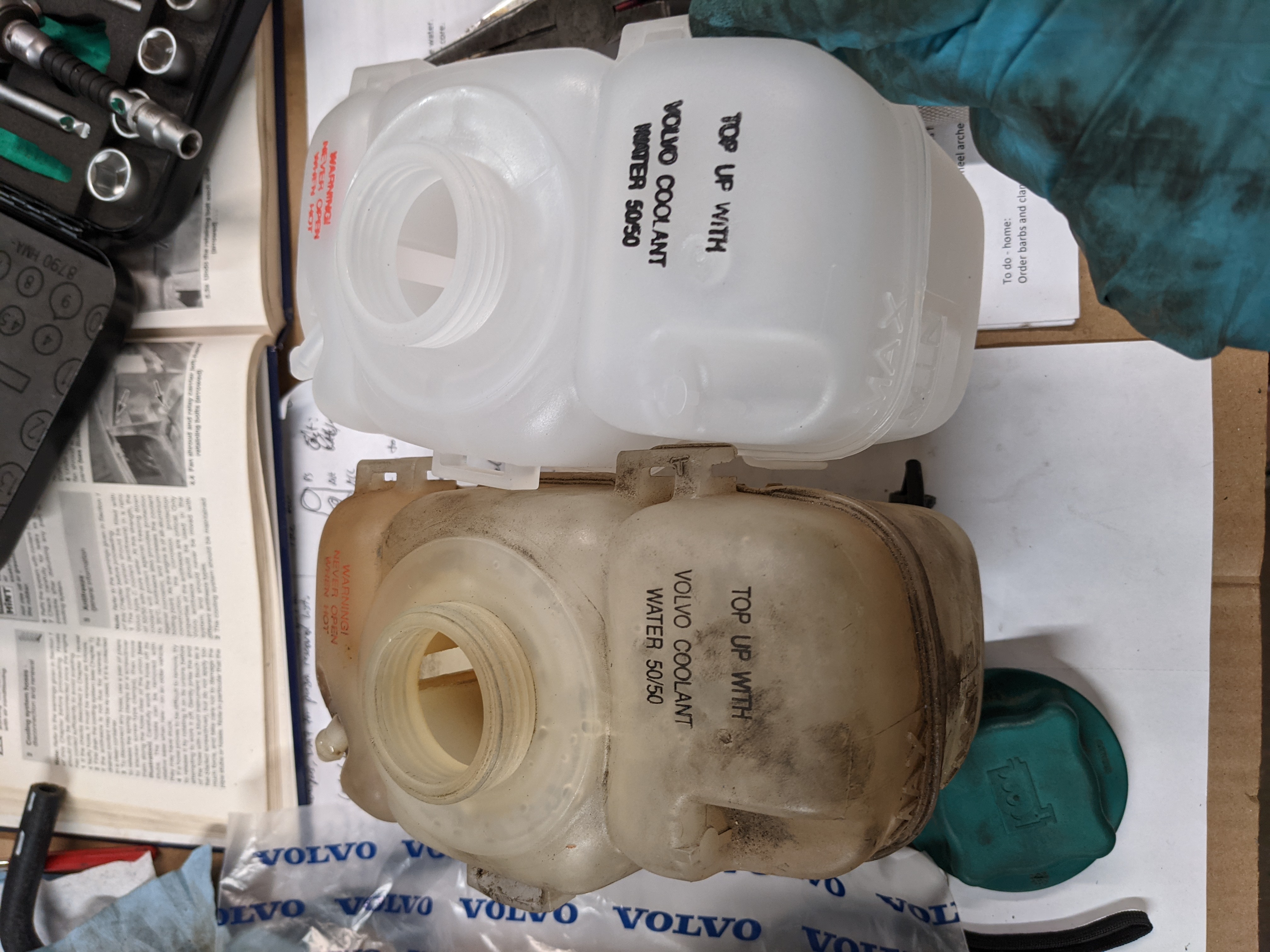

The primary source of power steering leak is the fluid reservoir. Over the years, pressure causes it to swell outward, busting its horizontal seam between the top and bottom. See the attached picture; those sides should be straight. Replace the tank with a Volvo original to prevent fluid from getting on your belts. It will be difficult to separate it from the coolant tank because it's so swollen so you might need to cut off the top clip on the old PS tank to preserve the clip on the coolant tank.
I would consider replacing the coolant tank as well, especially if it has spider web cracks around the front hose port, evidence of weeping around its horizontal seam, leaks elsewhere, or discoloration from old coolant. And maybe the coolant hoses if they appear bulged and weeping. And use the good rolled edge worm gear clamps. How far you want to go with it depends on how much you love the car.
