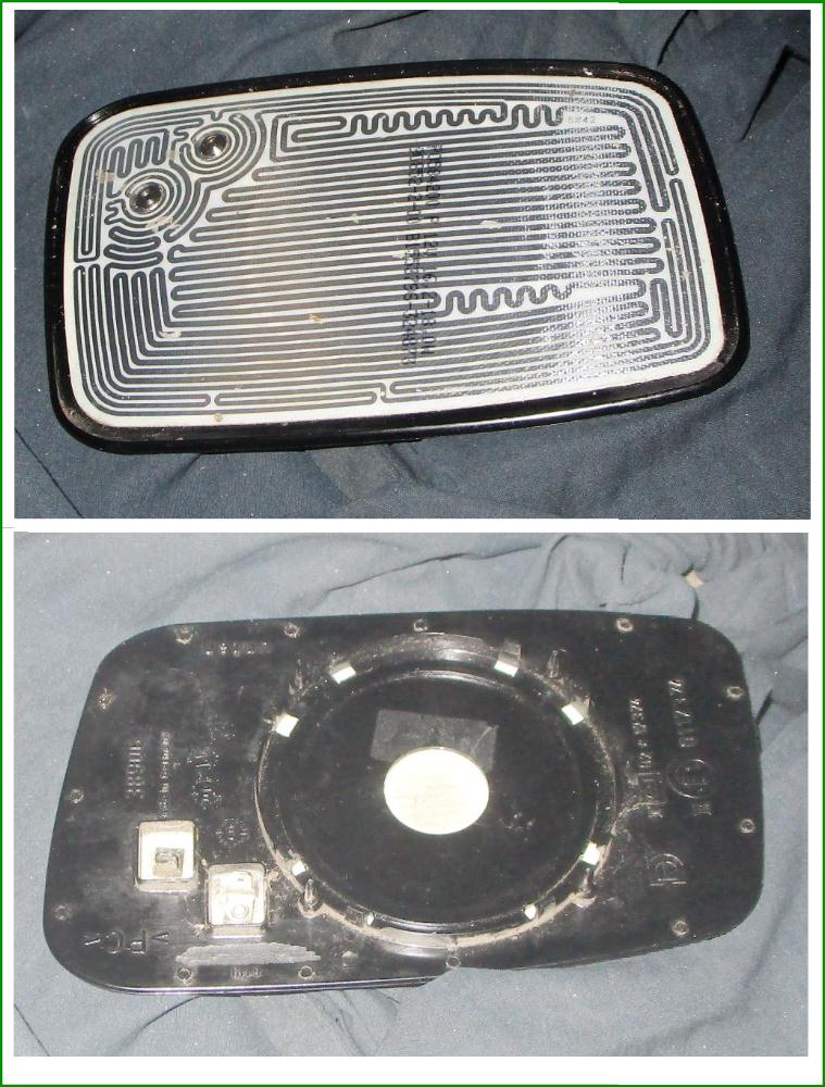

June wrote: 15 Mar 2022, 14:27 My Service Advisor popped the old ones off and the new ones on right on the Service drive. It took him all of a minute to do. The plastic just popped off, then the new one went on with a snapping sound. He's not a mechanic, so it must be easy. June
Hi June,
I included a pic of the plastic part both sides.
Thanks for the info i got it off now.
The pic hows the side where the glue goes and it has a bunch of metal paths on it as you can see. That means it is heated and that was a bit of a surprise to me i did not know they were heated. The two indents show there the connetion posts are mounted.
The back of the plastic just looks like it has some catch posts that go into the mirror when it is reinstalled. The two terminals are clearly visible.
The circuit traces measure 8.7 Ohms.
