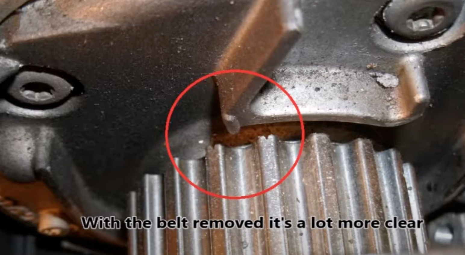

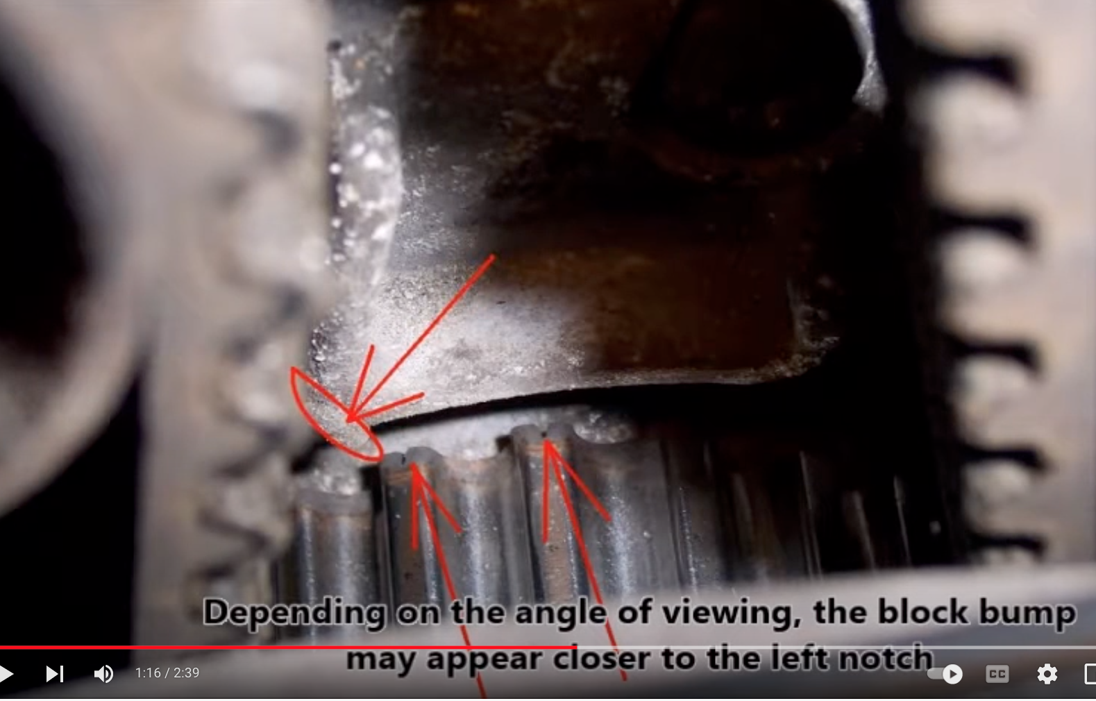

The problem is I can not tell if it is correct because it is hard to see the marks with the belt and belt tensioner on, and the angle i am viewing it at makes it seem not aligned.You’re super close, just get that crank exactly right
this video:
says this
"When you're lining up marks moving 1 tooth on the large sprocket is not the same as moving on tooth on the small sprocket."
I dont understand why it is not the same. Since the groovs on the belt match the grooves on the sprockets, when the crank moves one tooth compared to the alignment, the cam must also move one tooth right?
Im confused...

I understand that, but why is this important other than that it means I have to turn the crank twice for the cams to turn once... Or was that the point you were trying to get across?cbova wrote: 14 Mar 2022, 18:36
yes, BUT 1 tooth is not that same rotation amount for each sprocket. One tooth of a 360 tooth sprocket is 1 degree, 1 tooth on a 180 tooth sprocket is 2 degrees.
Suppose that cams and the crank were in time with each other. If the crank was positioned so that it is 1 tooth/groove to the left of the timing mark, then the cams would also have to be 1 tooth to the left of the timing markings right? The problem I have is that if the cams are on the timing mark, the crank looks like it is half a tooth away from the timing mark. I don't understand how this would happen, so I think the timing is fine, and it is just the viewing angle that makes it look like that, but I was not sure, so I asked the question here.

I turned the engine over again, and aligned it better (I never took the belt) it all looks aligned now. Did you just mean everything was off by one? Or do you know for sure that the cam and crank are one groove off from eachother.

The half-tooth-off phenomenon comes from a stretched belt (old belt) or uneven tension on na new, installed belt. The teeth will all be in phase once you get new pieces installed.
