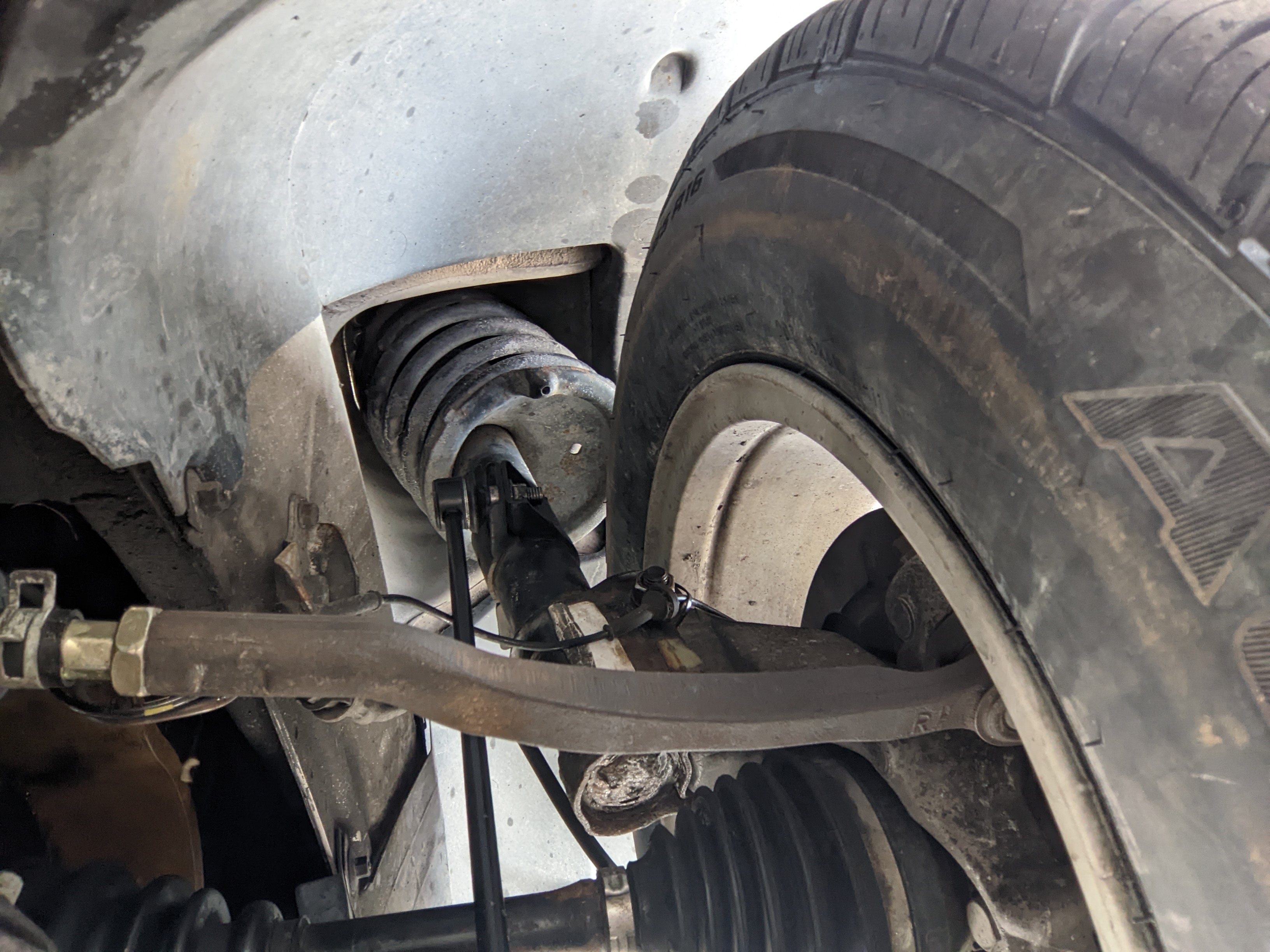

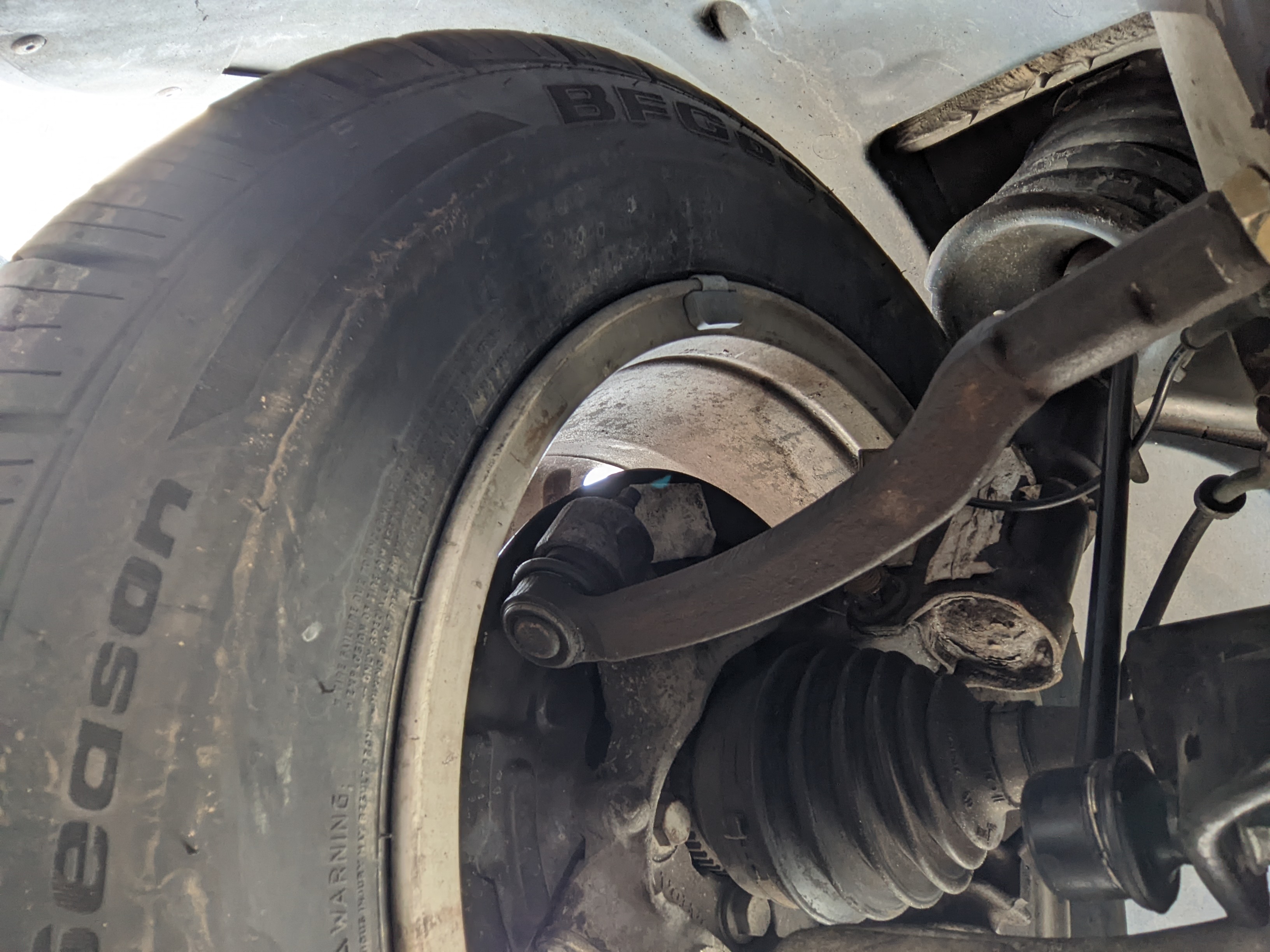

01' V70 XC do these outer tie rod ends look correct?
Post by lawrencium265 »
I did a ton of work to this and have an alignment scheduled for Friday, I used a digital level to get camber set and the string method to adjust toe.
The toe adjustments are bottomed out on both sides just to get it in.
I replaced inner tie rod ends but kept outers since they still felt pretty tight when I took them out. I'm looking at pictures on rock auto and the correct parts seem like they have less of a curve and less threaded area where the inner tie rod end goes into it. These were on the car when I bought it, but the previous owner or their mechanic needed to put the tools down and back away.

There are two different racks available for those cars, ( ZF and SMI) I suspect you have the wrong ones. Also aftermarket parts may not be exact replicas of the originals, my first try at tie rod ends necessitated sawing off about 3mm of the tie rod end so it wouldn't bottom out and I could get the appropriate adjustment. I drove it like this for a few months and then bought OEM Volvo inners and outers for piece of mind. Those look like aftermarket tie rod ends on yours so I suspect this is your problem.

Blacklab467 wrote: 01 Mar 2022, 11:03 There are two different racks available for those cars, ( ZF and SMI) I suspect you have the wrong ones. Also aftermarket parts may not be exact replicas of the originals, my first try at tie rod ends necessitated sawing off about 3mm of the tie rod end so it wouldn't bottom out and I could get the appropriate adjustment. I drove it like this for a few months and then bought OEM Volvo inners and outers for piece of mind. Those look like aftermarket tie rod ends on yours so I suspect this is your problem.
I went ahead and just ordered some Moog branded tie rod ends off of Amazon so that I can compare them side by side, if it isn't the case then they have a generous return policy.
