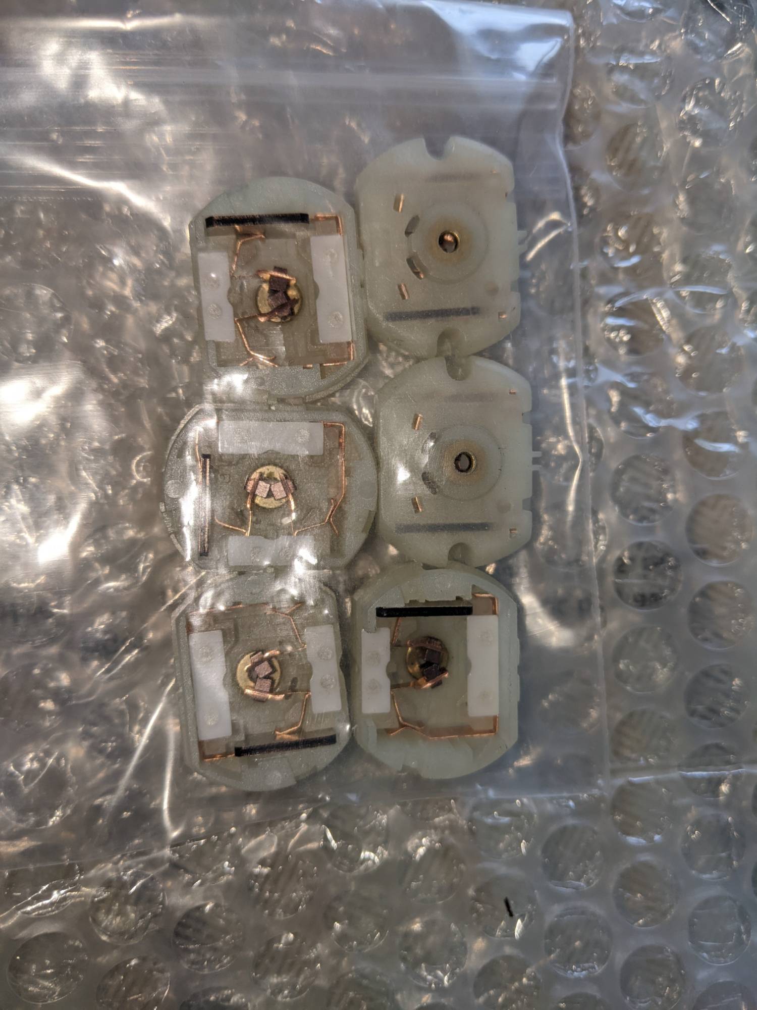

Well today the first package arrived with the end plates that have the front bearings, motor contacts and the little thermo-resistor tile.
I will have to try fitting one of these to a motor at some point and then try and check they work. I have 2 used motors kicking around so I might take those apart and see if these fit or at least install the thermo-tile and see if the motors will work ok.
I would see if the whole end cap works but not sure if the worm gear comes off the motors.
I'll update when/is this happens. I also wonder if the tiles will work on the headlight wipers for those of us who use them?
