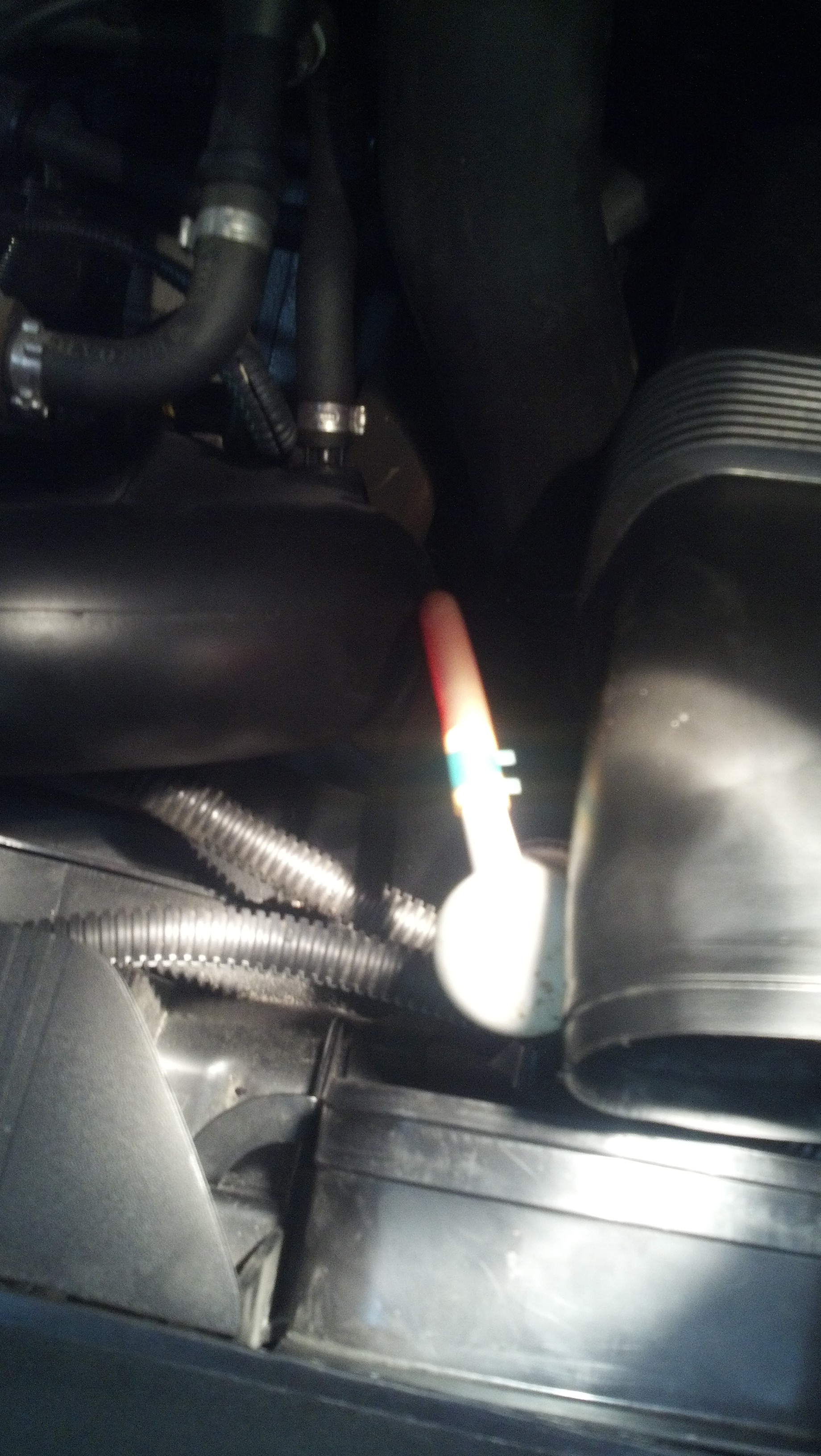

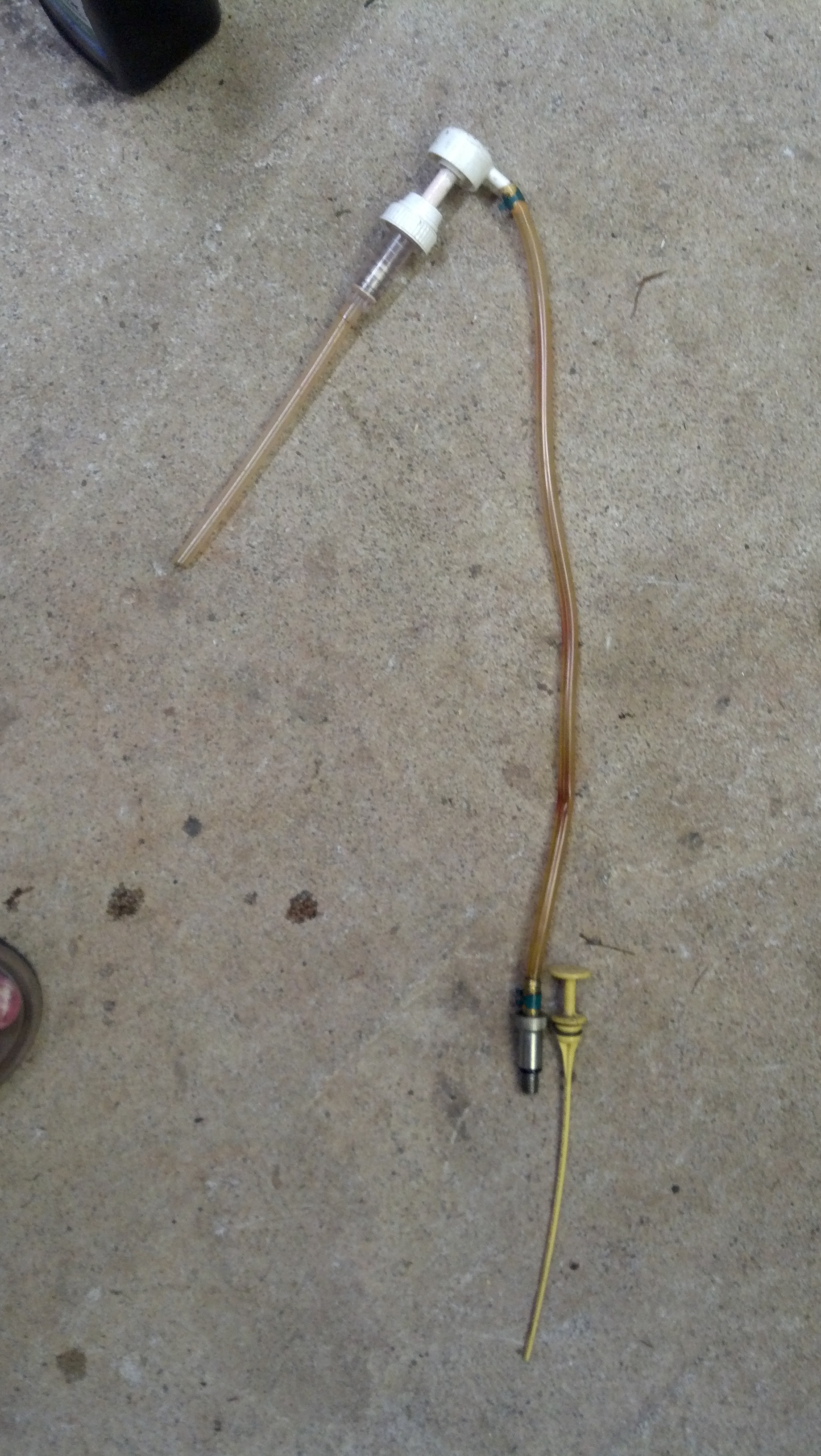

Here's a nifty little tool/trick I used to fill my C70 transmission. I have a boat with an outdrive unit that I have changed the lower unit oil on. I use a lower unit oil pump that screws into the bottom hole and pumps nicely out of a 1 quart container. I decided to try it on my tranny.
As you can see, the pump has a screw-in connector on the end and that connector actually fits perfectly into the dipstick hole and was even held in place by the dipstick locking tab. Then I screwed the pump pickup end into a quart of transmission fluid and pumped it into the tranny. Piece of cake. You set the quart container down alongside the air intake and it sits there perfectly while you pump. Didn't spill a drop and didn't have to hold a funnel and pour the fluid in very slowly like you do without the pump. You can buy one at a marina for about $10.
