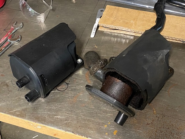

***UPDATE*** That was fun
...Installed a new PCV (lots of gunk) and it made quite a difference in performance, also cleaned the PTC. Have negative pressure (sucks glove in) on the oil filler cap. Still have an oil leak, drivers side/rear of engine, which started a few months ago when it backfired. Thought a new PCV would help. Need to get under it to see where its coming from, checked both cam seals to rule out blown seals.

Best photo of this repair...blew the top off the oil trap.
![Image]()
- IMG_7092.jpg (142.12 KiB) Viewed 1785 times
- Posts: 36148
Boom!
- Posts: 6357
- Joined: 30 Dec 2014, 10:45
- Has thanked: 316 times
- Been thanked: 531 times
That happened on its own or did you pull it apart? Wow!

The top was loose as I was unscrewing the hose clamp, you can see oil residue all around the lower half. The other hose snapped right off plastic and all.
