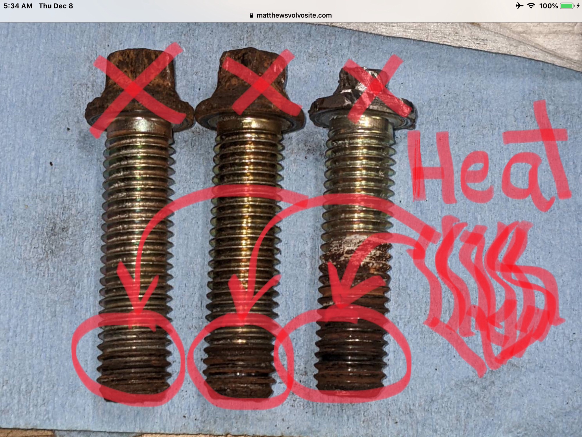

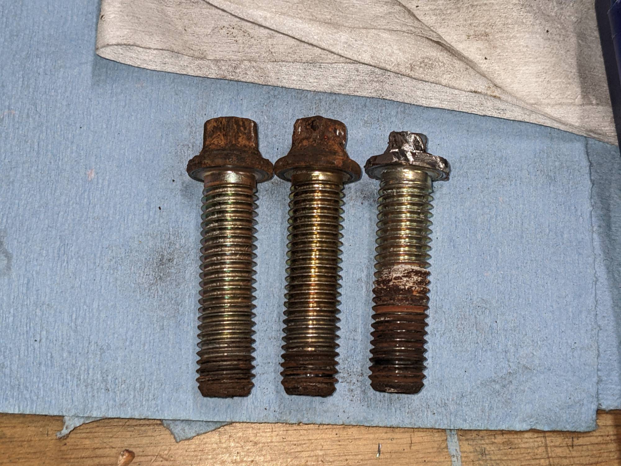

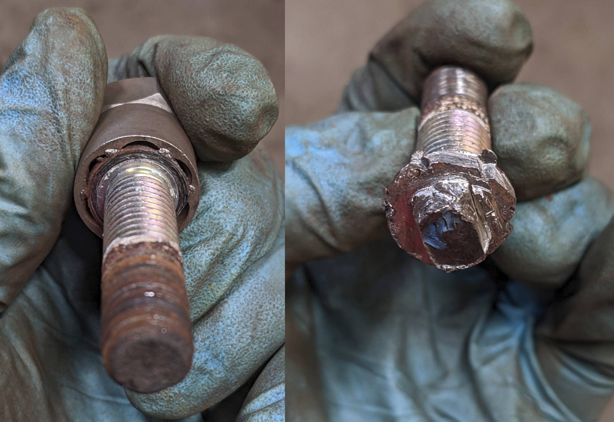

I finally removed the stuck front wheel hub bolt and changed the hub. It took me a smooth 7.5 hours on this trip and 5 hours on the first time I tried but failed. To remove the bolt, I used an Irwin bolt extractor but not on the external Torx head (which would quickly crumble to a point, I've learned). I used a larger one to reach over the head and grab the flange. It was a tight fit so I hammered it on to the flange, digging grooves for the extractor metal to sink in to. Perhaps it helped that I used a blow torch earlier and lightly tapped on the head and body around the threads. Nah, I'll give credit to the extractors.
The stuck bolt was on the right caliper, the bottom front one. Perhaps that takes on more salt than others. See the picture for comparison between three bolts on the same wheel.
Every DIY person should have Irwin 394001 and Irwin 394002 bolt extractors.

I never even knew there were extractors like that until you showed them, and you found a great application for them. I'm surprised the rusty threads on the bolt aren't drenched with penetrating oil, which would help get through the threaded hole in the knuckle.
Mine weren't very rusty when I did that job, glad I anti-seized them!

An old-school truck mechanic I knew believed in a couple heat cycles, then once the fastener budged a bit, he hit it with the magic juice ( he was a Kroil kind of guy; I have some but it's a bit spendy .)
Good thing you don't actually like that car.
- Posts: 36153
- Been thanked: 4069 times
Th extractors are also consumable. I’ve found after some bad boys they do strip out and end up replacing them,
Important on those wheel bearing hub bolts, and heat cycles, three minimum , are the key to getting things loose, not mechanical force.
