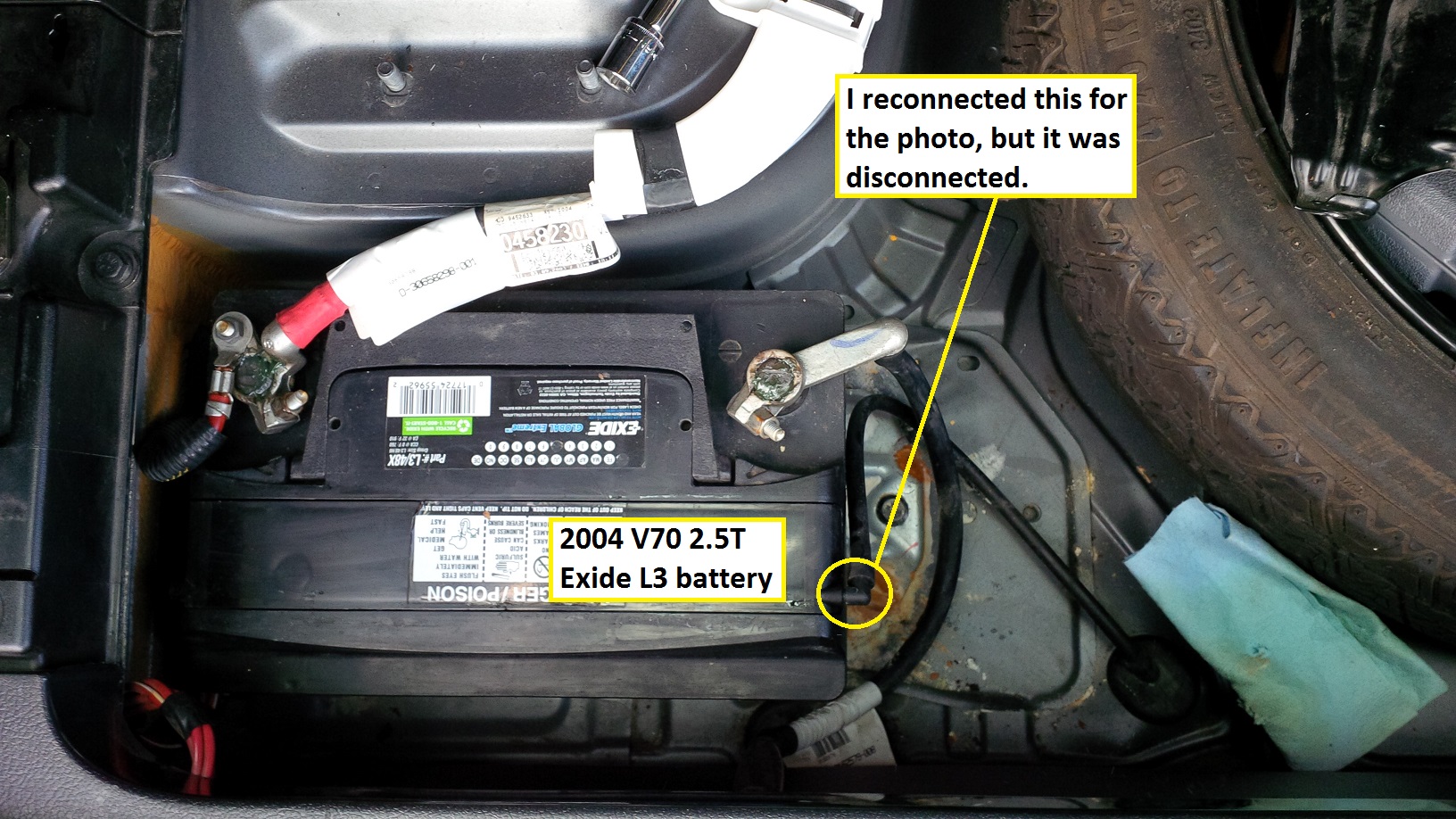

In my 2004 V70, I was stuck in a small town with the only battery being 24F, it worked but too tall, lifting the trunk floor up. I made it worked, but people should avoid 24F battery for 2004 V70, XC90, if you can. In a pinch 24F works to get you home but the trunk floor of V70 was raised a bit. I had to modify the metal bracket a bit. XC90 might be more forgiving for 24F in terms of height.
So, ignore my 2004 V70 saga...

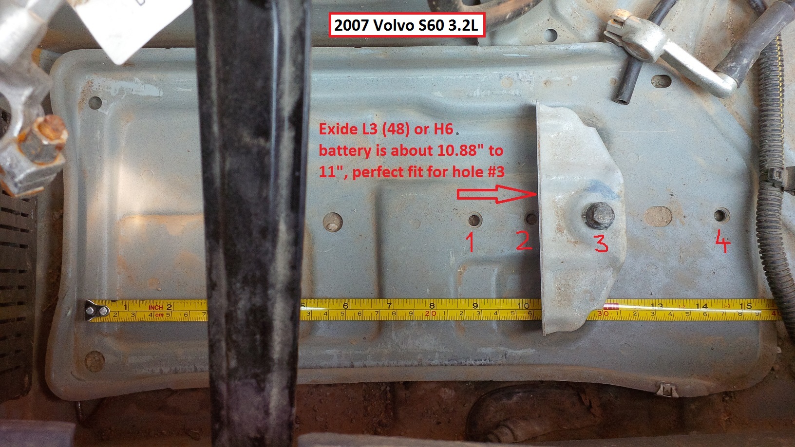

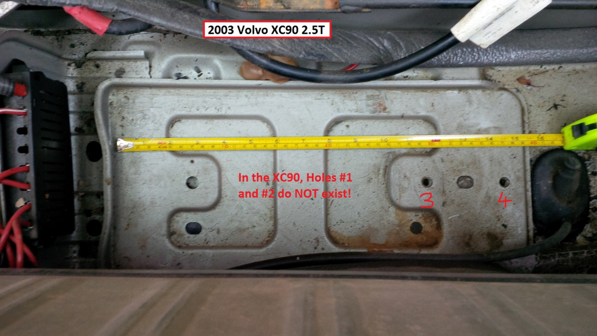

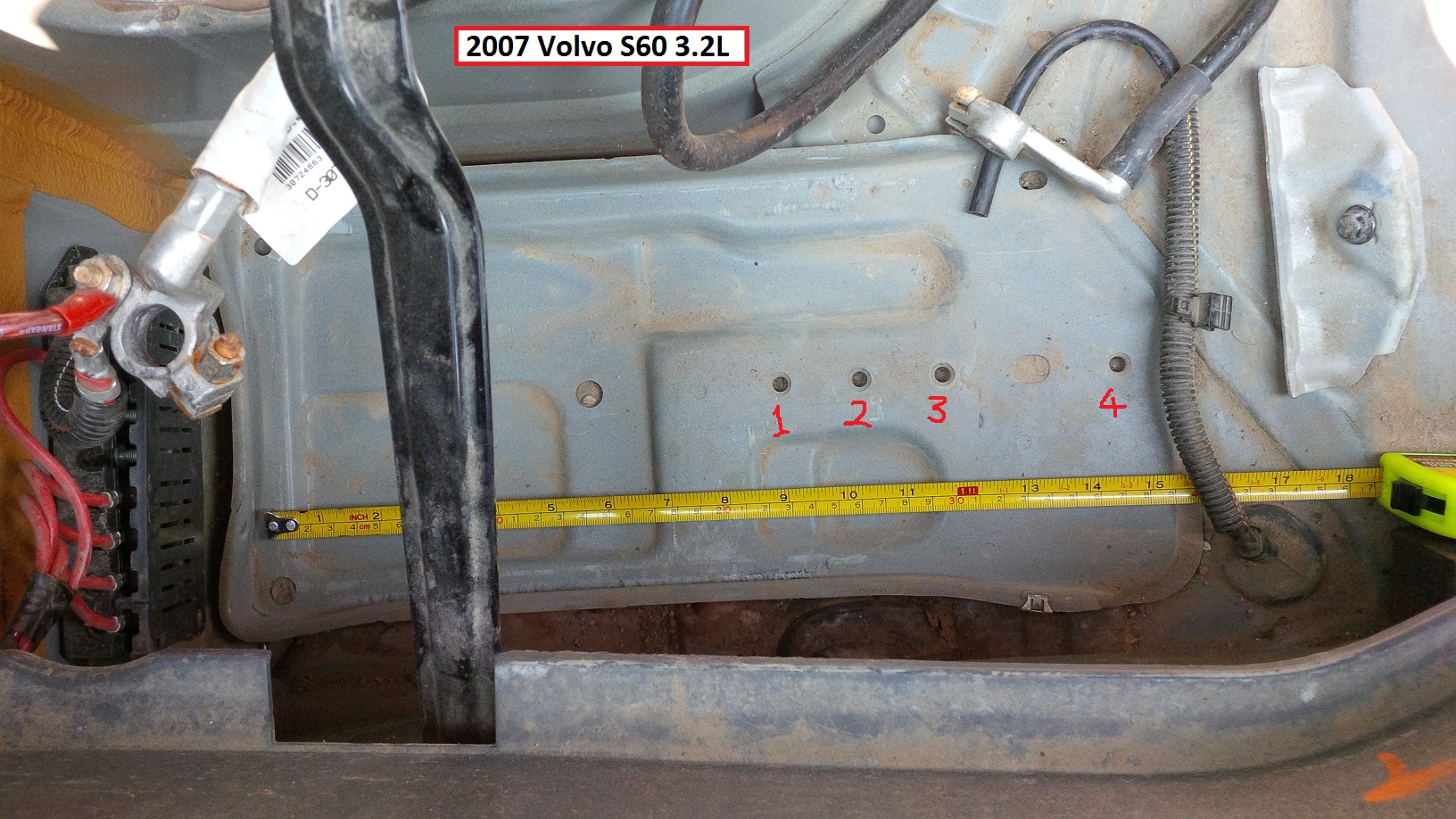

I decided to take some photos of P2 (S60 and XC90) and put together info for others to benefit from.

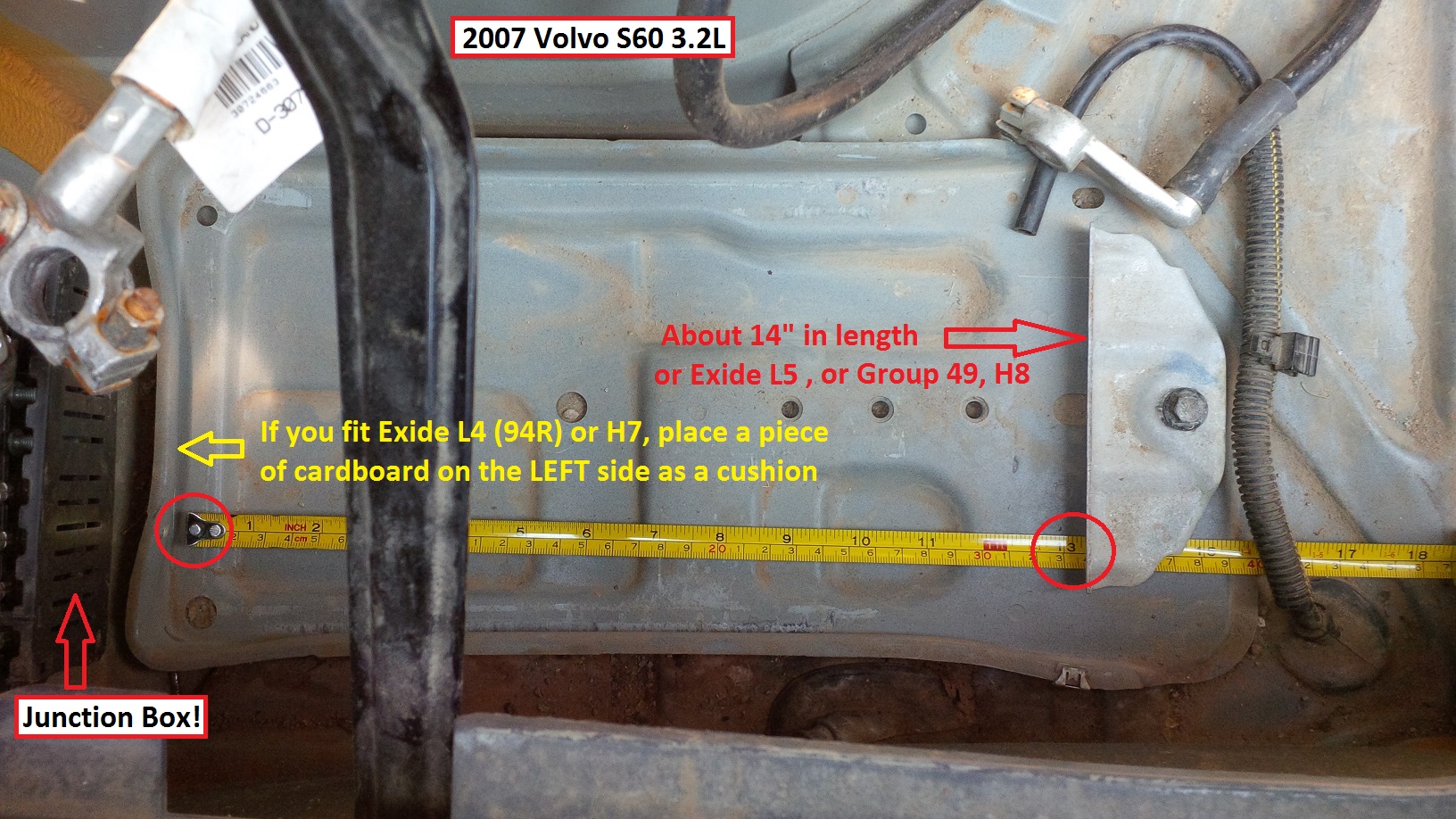

The bottom line: the XC90 came from the factory for 2 increments: L3 (H6) and L5 (H8).
The L4 (H7 or 94R) will work but you need to place a piece of cardboard or wood (about 1.5") on the left side so it fits nicely.
All info is in the photos below.

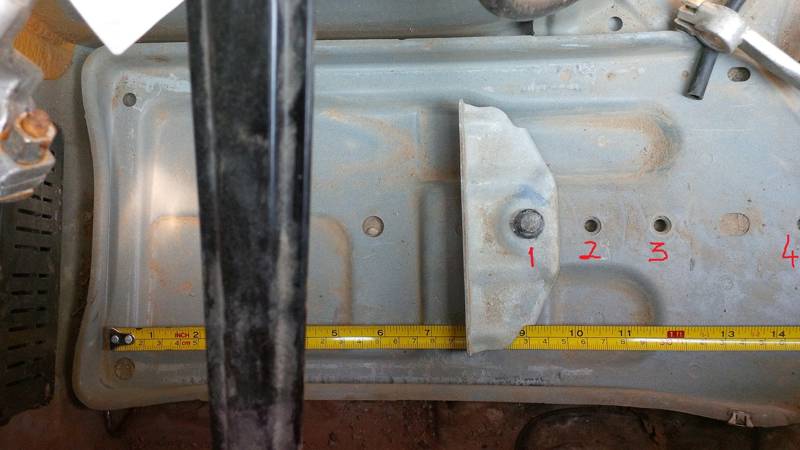

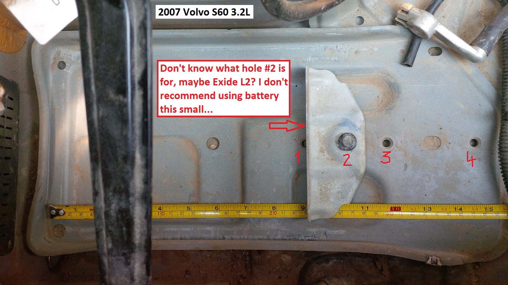

Pay attention to photo saying S60 vs XC90, minor minor differences but in XC90, holes #1 and #2 do NOT exist.
Even for S60, V70, you can ignore holes #1 and #2 anyway bc these holes are for tiny tiny batteries, which should be avoided.
Most of the time, for S60, V70 and XC90 you are dealing with holes #3 and #4 for batteries L3 (H6), L5 (H8); and L4 (H7 or 94R).

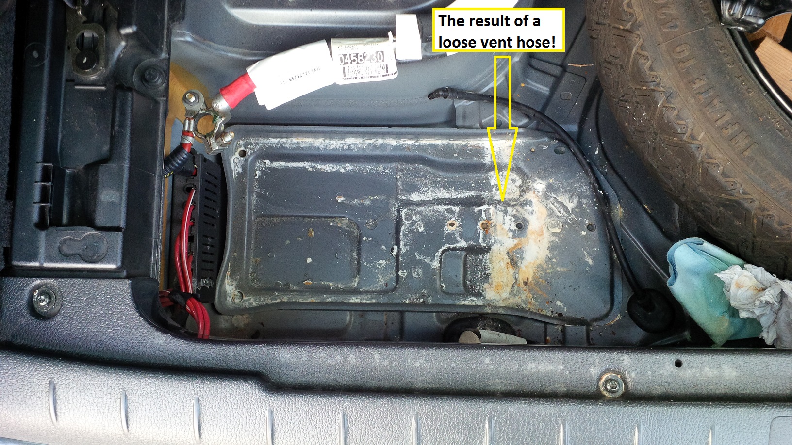

* 2004 V70 with acid vapor corrosion from a vacuum line that got disconnected accidentally because of too loose fitting.
From now on, for all my cars, I use masking tape to secure the vent barb fitting.
* Differences between S60 vs XC90 are very minor.

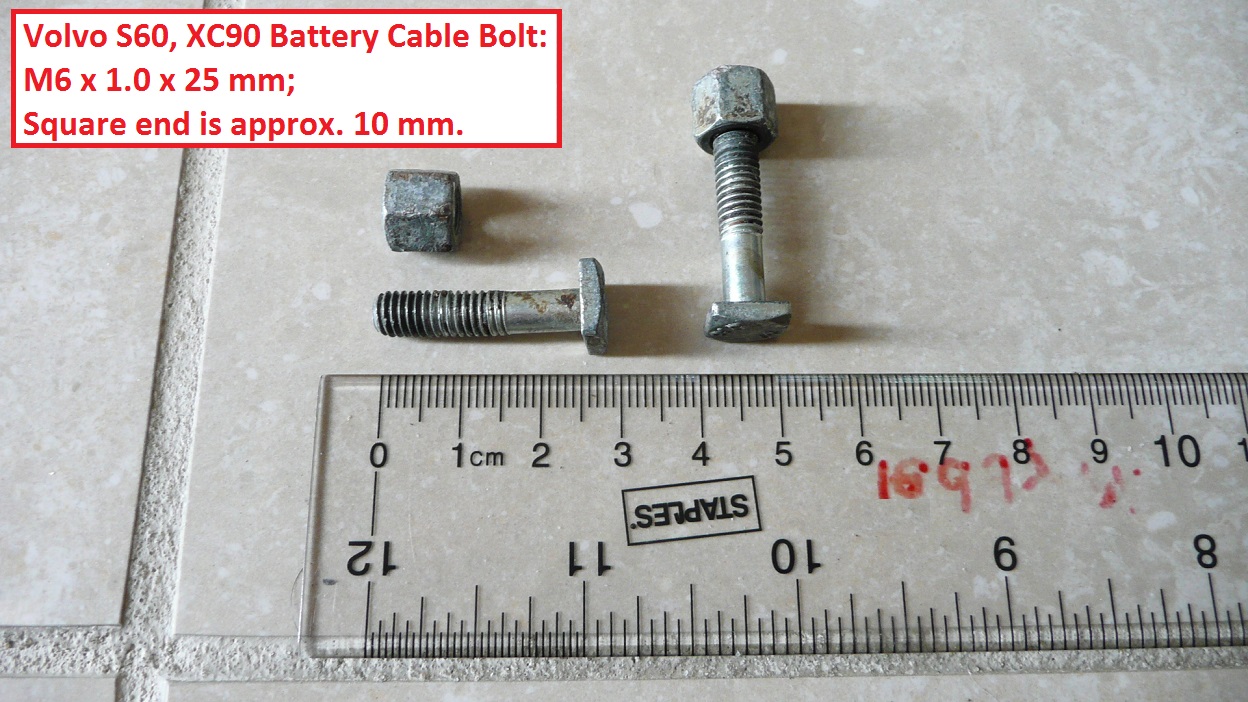

* Battery Cable bolts measurements are included. Volvo only sells the nut, not the bolt, for P2; the nut
is 987529. So use the bolt from P80 (987526): 1993-1997 850 or 1998-2000 S70 etc.
Or hardware bolts/nuts that are M6 as shown.
