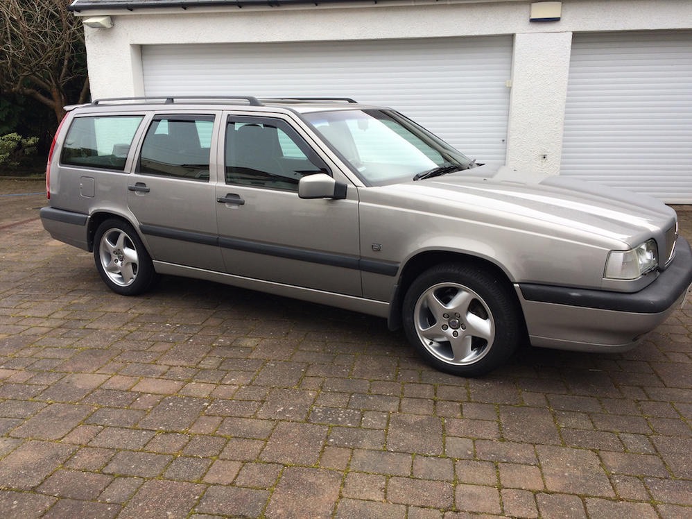

We call them side repeaters, the previous owner of my car changed the orange lenses for smoke grey which looked cheap so I managed to find orange lenses and changed them back to original.
The switch for the OBD reset is to accommodate different models, apparently they have different systems and the switch needs to be moved depending on what car it is in. I usually use my Sykes Pickavant reset tool but decided to try the Draper this year. Both work fine so might be time to move one on…

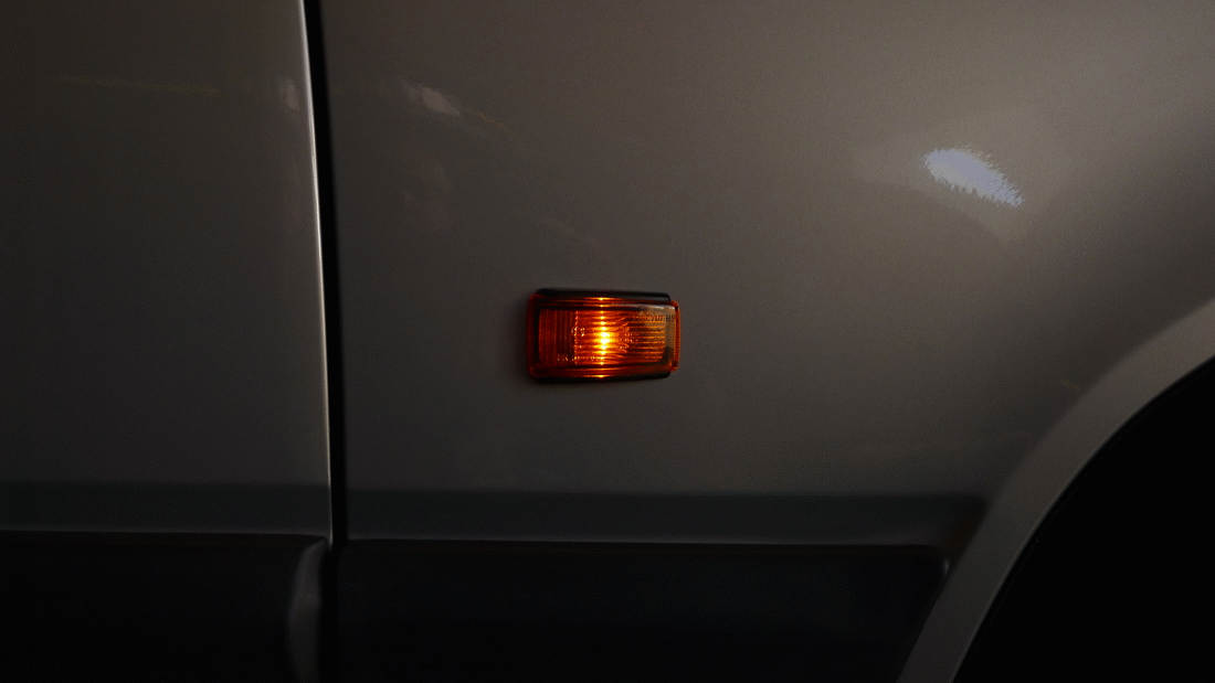

Aftermarket smoke side repeaters
NW2 copy.jpg (188.59 KiB) Viewed 5105 times
Original amber side repeaters
1997 850 GLT website

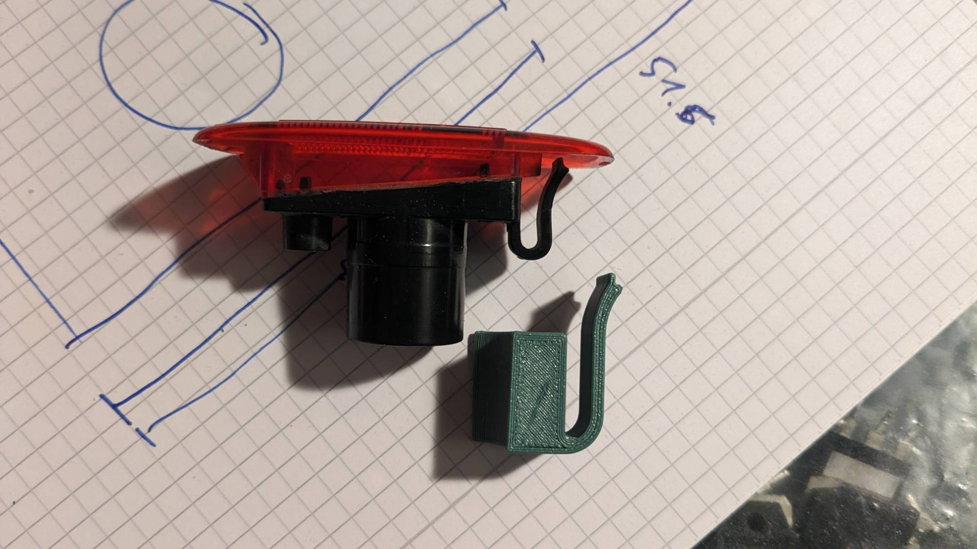

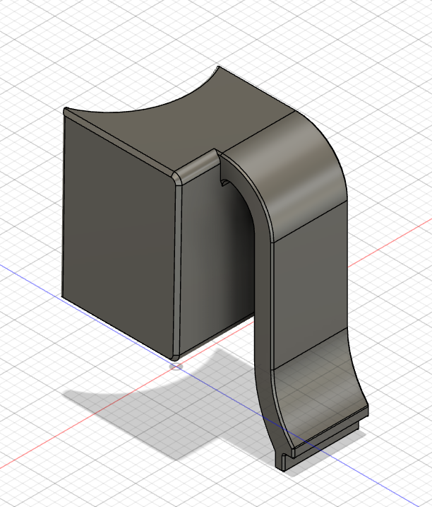

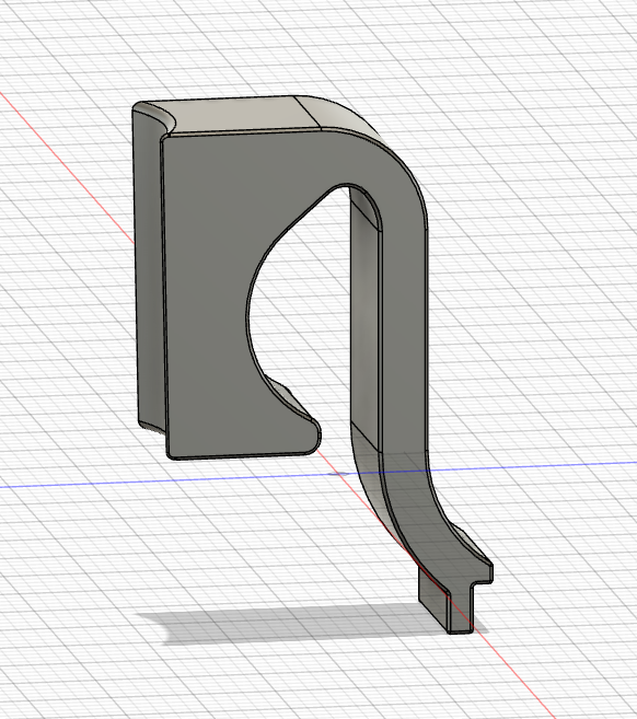

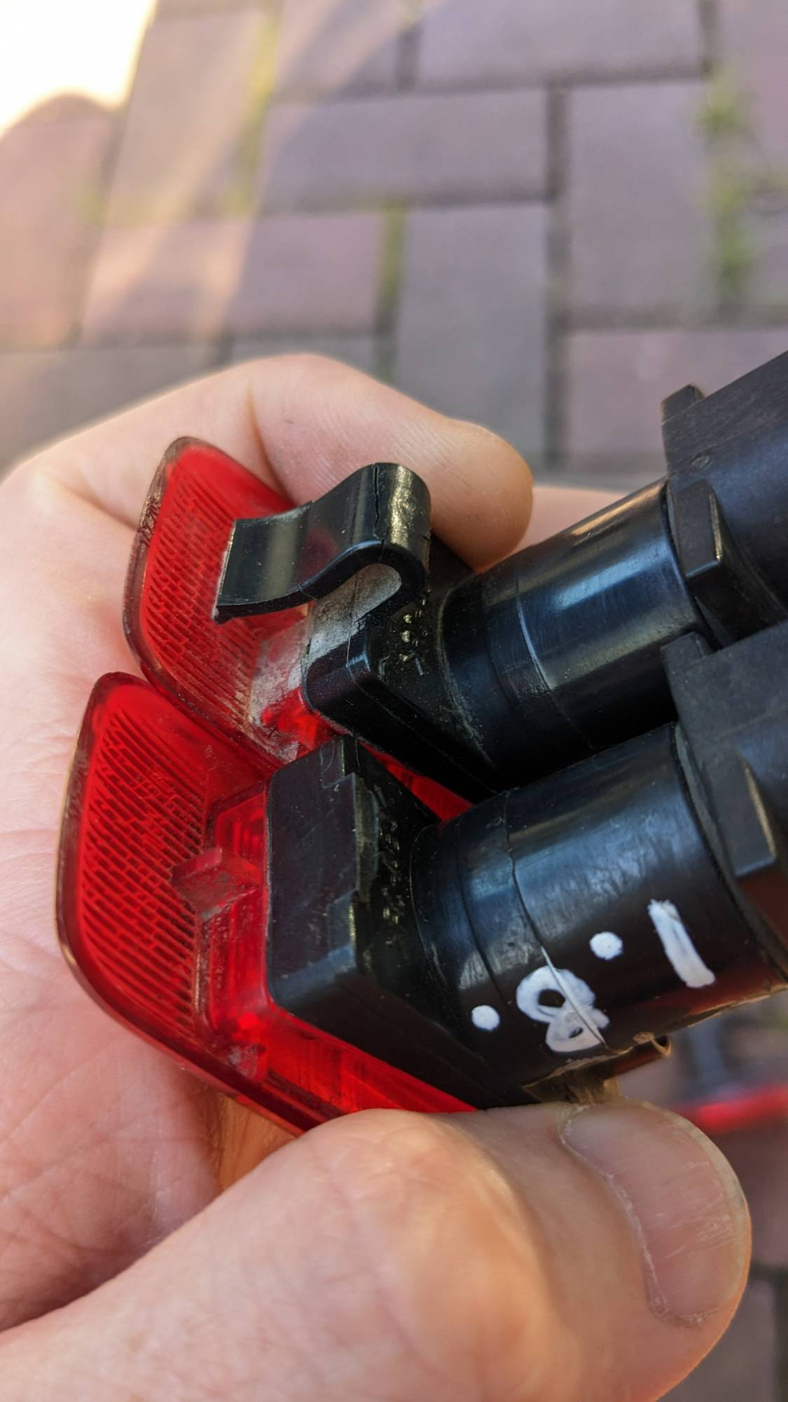

Both door marker lights in my V70 I were broken (well, one was missing entirely), so I bought two new used ones (very inexpensively) which are not broken.. However today I found out that they are in fact broken as well, the clip is broken off on one and cracked on the other one...
This is another perfect opportunity for the 3D printer! A quick sketch in Fusion 360 and less than 15min later this little piece spawned on the build surface of the 3D printer. You can see the reason why the part is asymmetrical: The cantilever sits on the build plate in this configuration to avoid support structures. I wanted to keep the other side a bit more bulky though to make it easier to align. The repair piece will be glued onto the original light.
Screenshot 2024-04-08 002627.png (170.84 KiB) Viewed 5077 times
I'm somewhat impressed that I was able to replicate the original shape so well. As you can see, the cantilever is much longer and (hopefully) therefore less prone to failure. A prototype will have to tell how the properties are (as in: does it sit tight enough but not too tight).
Of course, when this project is done and tested, I'll publish the files on Printables as well.

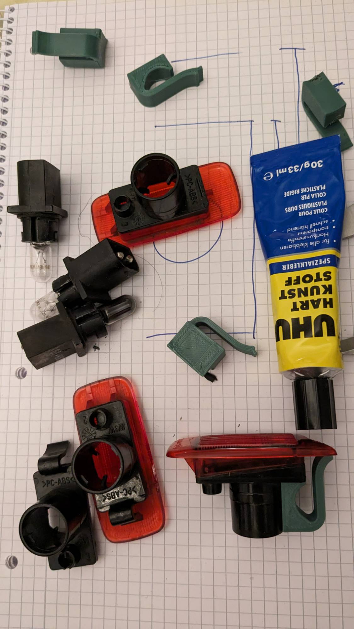

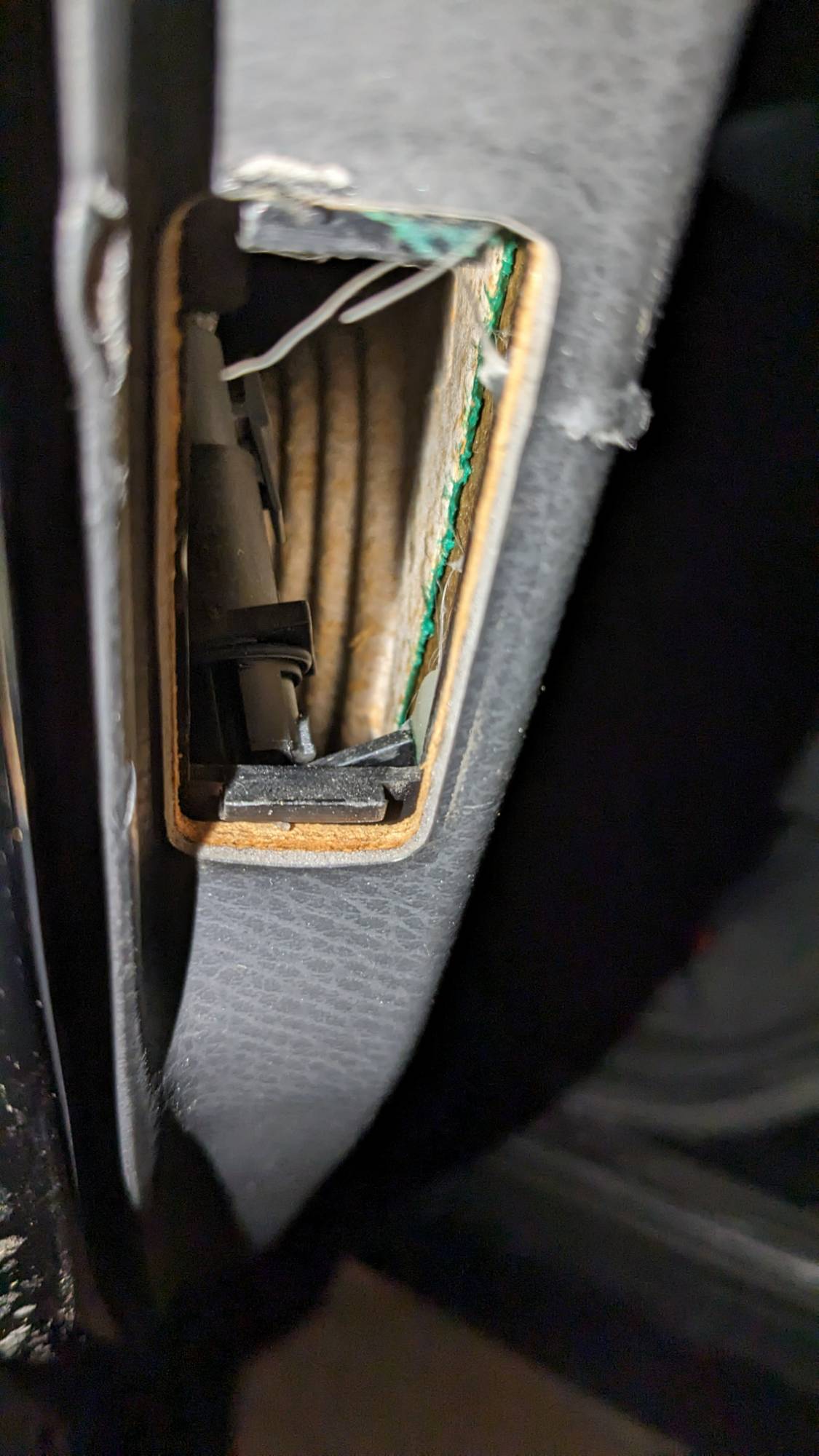

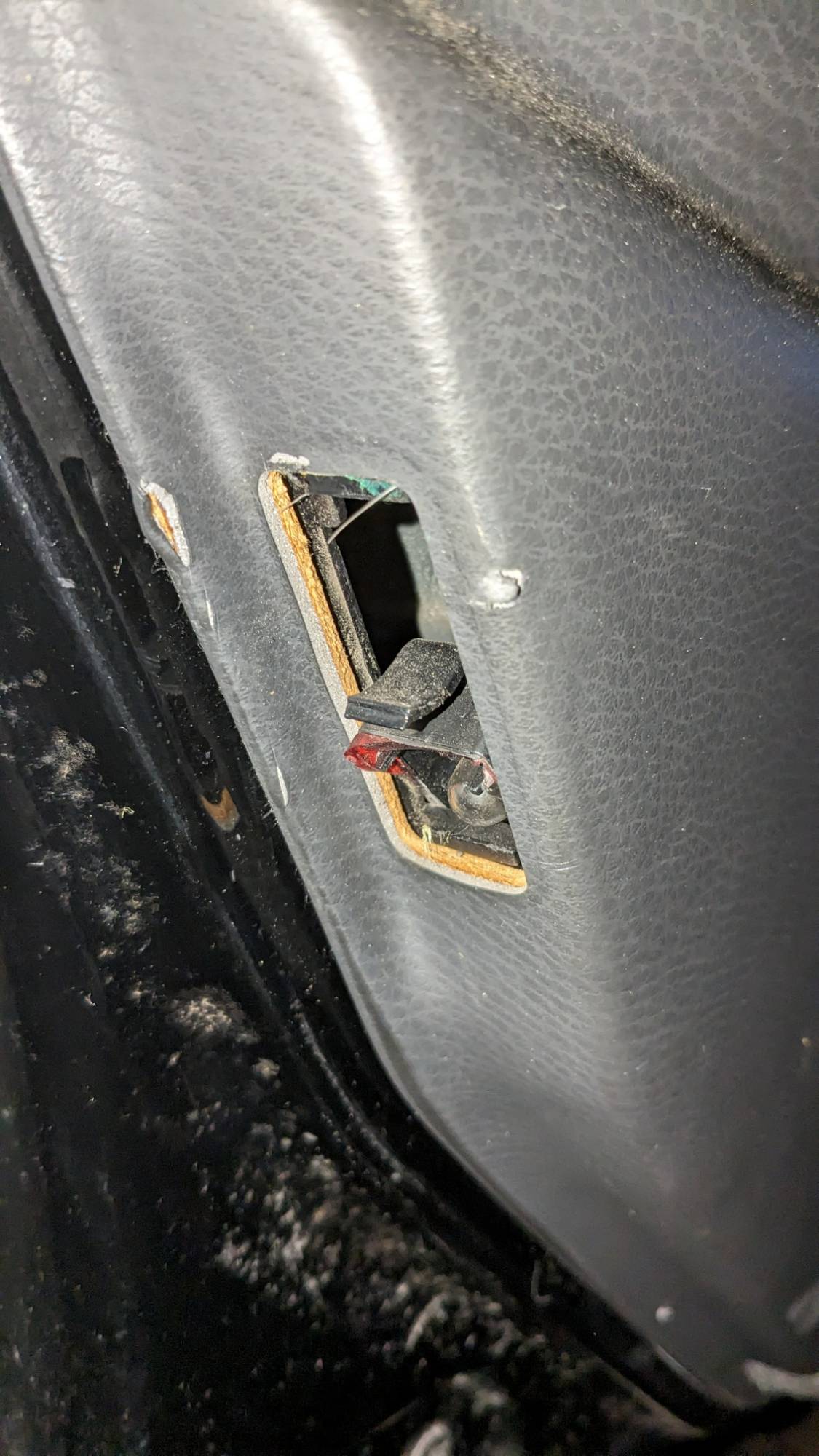

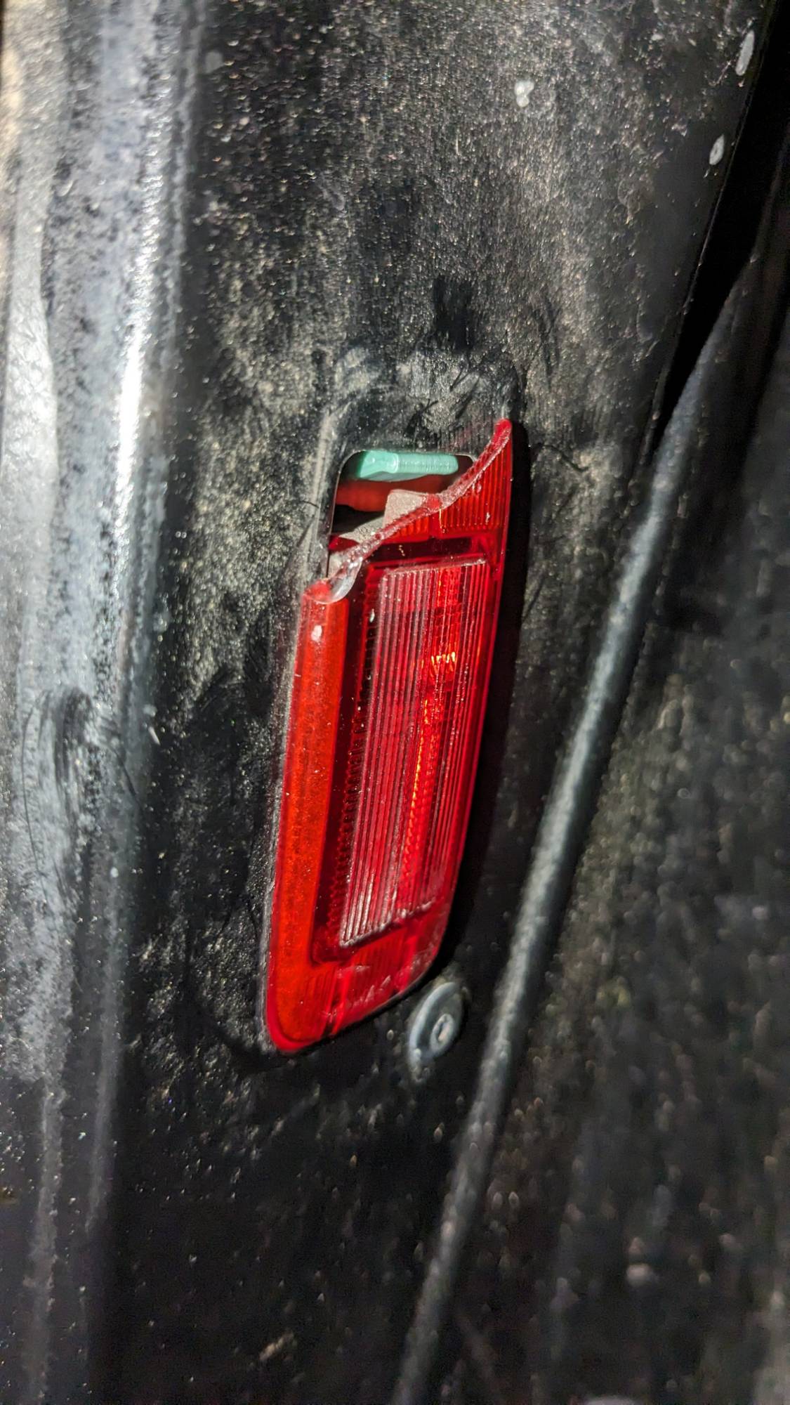

Funny, now that you said "all four", I realized that the rear has these lights as well... :shock:
One side is in perfect condition, but the other side was smashed to pieces :shock:
Unfortunately the inner plastic part that is supposed to hold the light has been detached from the door panel, so I might have to take the door panel off to glue it back on. This escalated quickly...

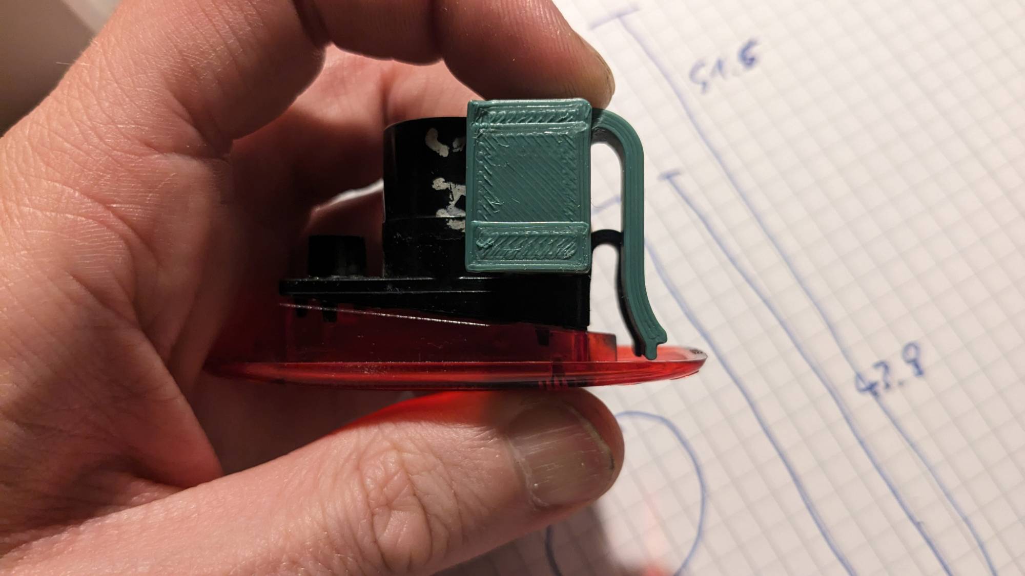

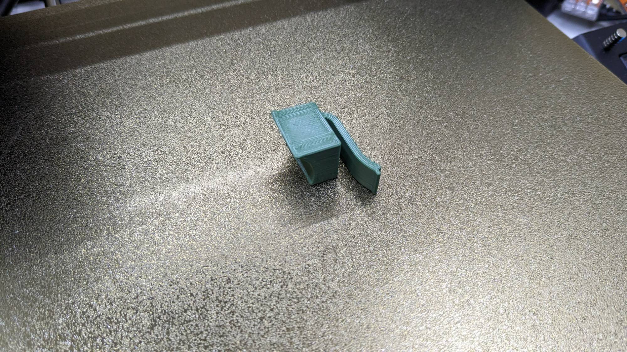

One way or another, I did a test fit (actually two test fits with another one pending) and it did fit quite well the first try but I optimized the shape and added more preload. It wasn't really snug.
And the repair piece got a sexy waist, which makes holding it in place while the glue dries a lot easier (and it looks good... which was the main reason I added it).
By the way: This is how "a small side project" starts to look like eventually :D

I made a short video before work. As you can see, it snaps in quite nicely and you can get it out again, but it won't fall out on it's own. It might take a few days until I publish everything on Printables.
