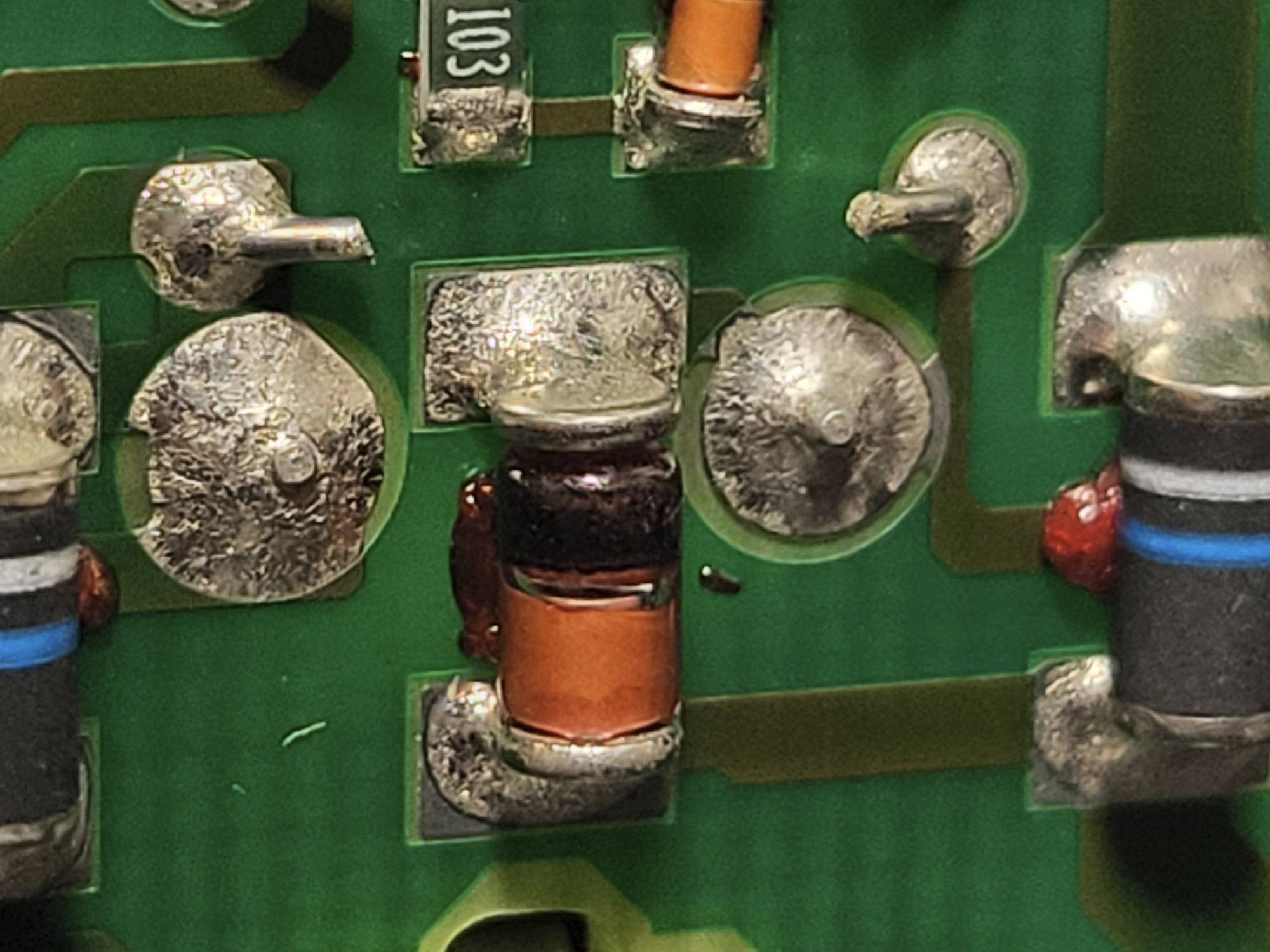

I been using Brembos and they not had this kind of issue (and i am not any light user of handbrake).. feels bad see these to happen :|
After sitting engine stalls and feels not run fine so i measured with sacrificial tire pressure measurement only 1 bar of fuel pressure so i ordered new fuel filter.. then i took out fuel pump relay and yeah its crusty solders.

Are you planning to reflow the solder joints?

Absolutely. And replace the old capacitor. There is nothing else to go wrong really else than contacts.
