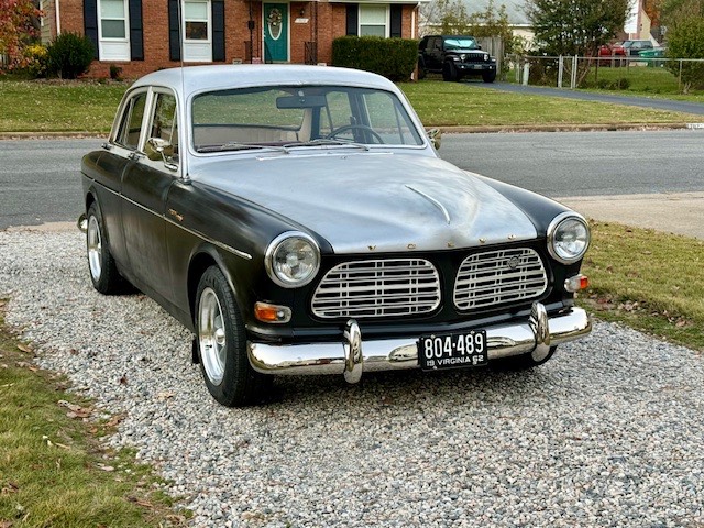

The doors might be off one of the several donors that passed though his life. The left front fender is a replacement, obviously.
While I used the term 'rattle can', he could just as well have bought quarts and sprayed it. He did say "Rustoleum" out loud though.
The matte finish is all the rage these days, so it looks cutting edge-y.
That trunk handle looks mighty tasty.
I guess I’m going to call him “Leo”

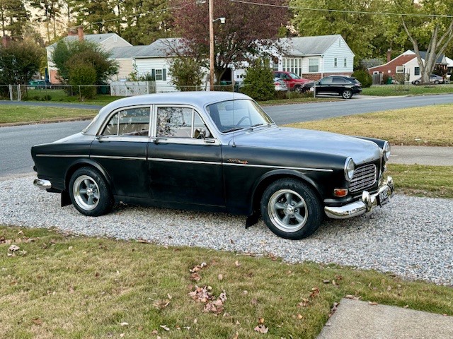

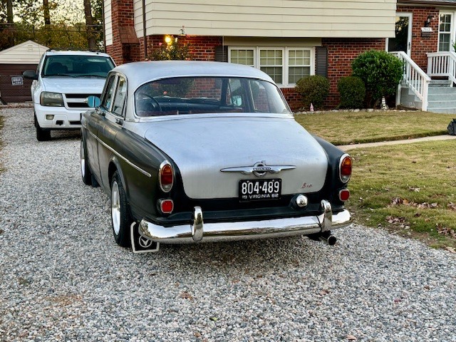

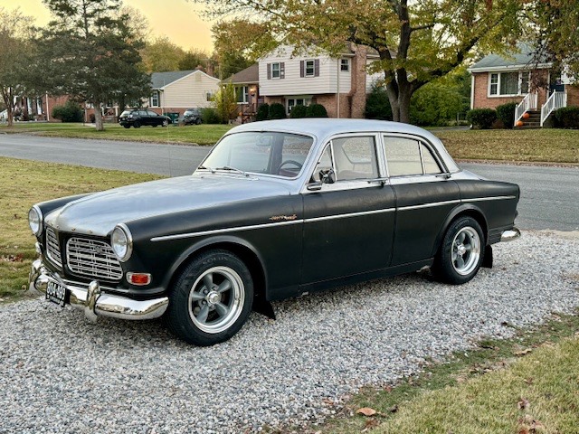

I just put some Torque Thrust II’s and and tires on last weekend and took some pictures. I also added a few more shiny things. Leo is running great. I picked up some good spare parts from a fellow Volvo guy in VA a month ago. I got a bunch of little things, plus a nice dash pad, a set of 3 bolt HS6 carbs, and a combo one piece intake/exhaust manifold w/ two outlets. I swapped out the front carb base w/ the one I got and my throttle plate doesn’t hang in that one, so it fixed my high idle issue. I swapped out the grills for the ‘67 and later version until I can find the inner grill surround trim to complete the original ‘62 look. Kinda funny, the new wheels make the old paint job look better.

I’ve called that paint job an “old Bentley, Rolls Royce paint job” and haven’t really liked it that much. But, those wheels make the paint job make more sense, if that makes sense. I went over to a new friends house yesterday to show him the wheels and to look at his P1800 that he’s putting together and he said “are you sure you want to paint it all black?” Well, those wheels are making me think twice about it. I told him that I’m not sure I’m going to do that now. I think I’m going to live with it until the spring and see. I can fix the body flutters and just re-spot spray it with Rustoleum gloss back and knock back the gloss w/ 800 grit to keep the same look. That’s what I did when I fixed the right front fender and I can’t tell the difference between old and new. I’ll get it ready for paint that way. Leo’s black and silver paint scheme may live on.scot850 wrote: 11 Nov 2023, 22:44 Like those wheels! You are right, they do make the car look better.

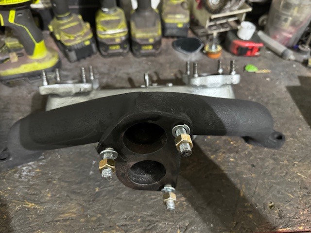

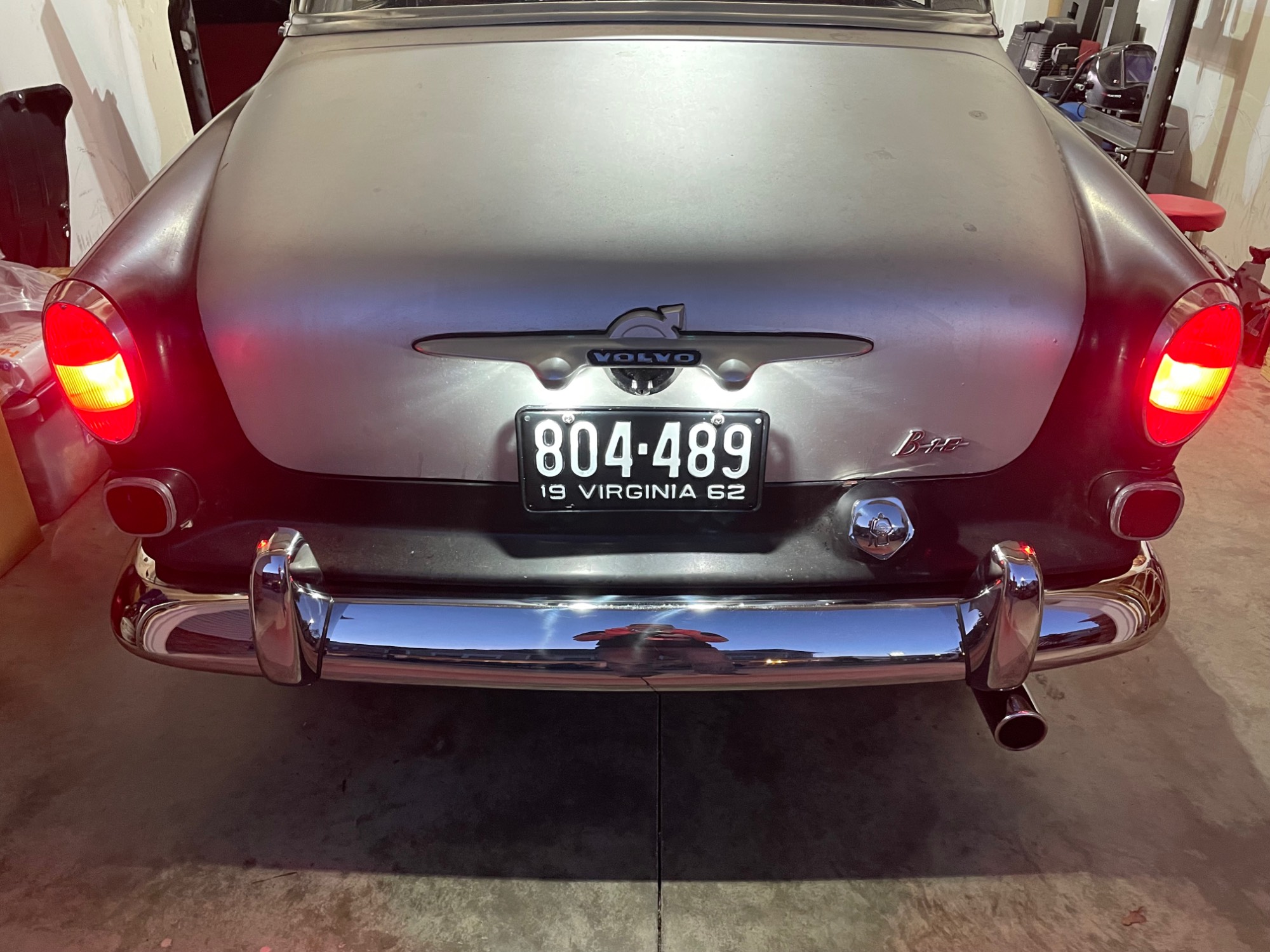

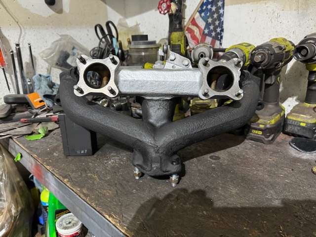

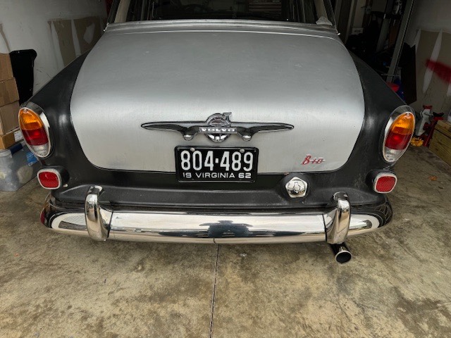

I’ve been doing a lot of little things the last couple of months. New door seals, trunk seal, replaced both vent window seals, window scrapers, door handles, re-keyed door and trunk locks to the same key, installed a windshield washer bottle and etc. I found and bought a NOS ‘62 vintage chrome airplane trunk handle in perfect condition and a not so new chrome one that is on the car now. My friend that is putting back together his late father’s P1800 gave me a post ‘71 M41 with J Type OD that I’m starting to refresh now. The car is still running great and I’ve been scooting it around every chance I get. One thing I noticed the other day is with the new seals, I can actually hear the clicking sound of the turn signal relay.
I also refreshed a later version one piece intake/exhaust manifold w/ two O/P’s and changed the exhaust to be compatible.

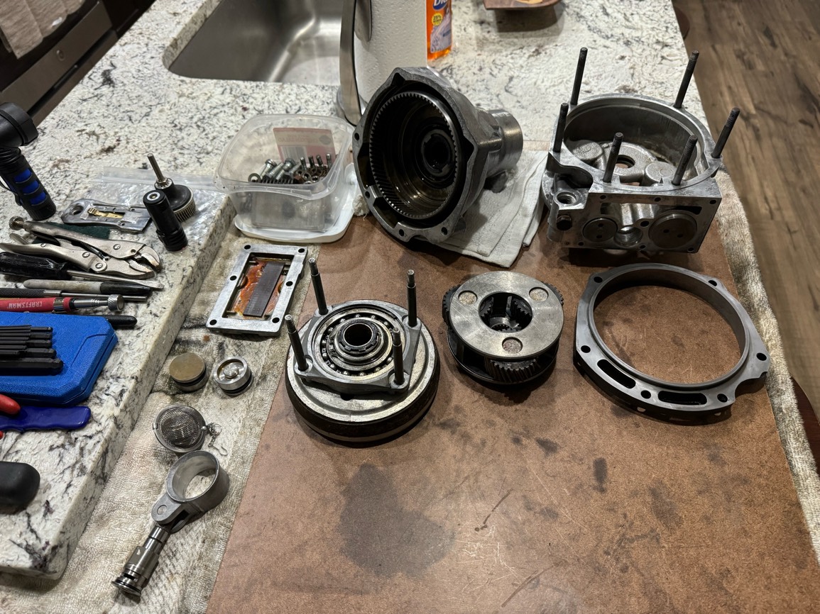

I can’t wait to get the M41 w/ OD installed. Highway driving is really a no go w/ the M40 or really not fun taching out over 4k just to do 65-70mph. I’ve got the OD disassembled and I just placed my VP order. They don’t need much. Just seals, o-rings, springs, counter shaft and an input shaft bearing for the M41.scot850 wrote: 20 Jan 2024, 16:59 Wow that is one heck of a lot of work, but it is all really worth all that effort!

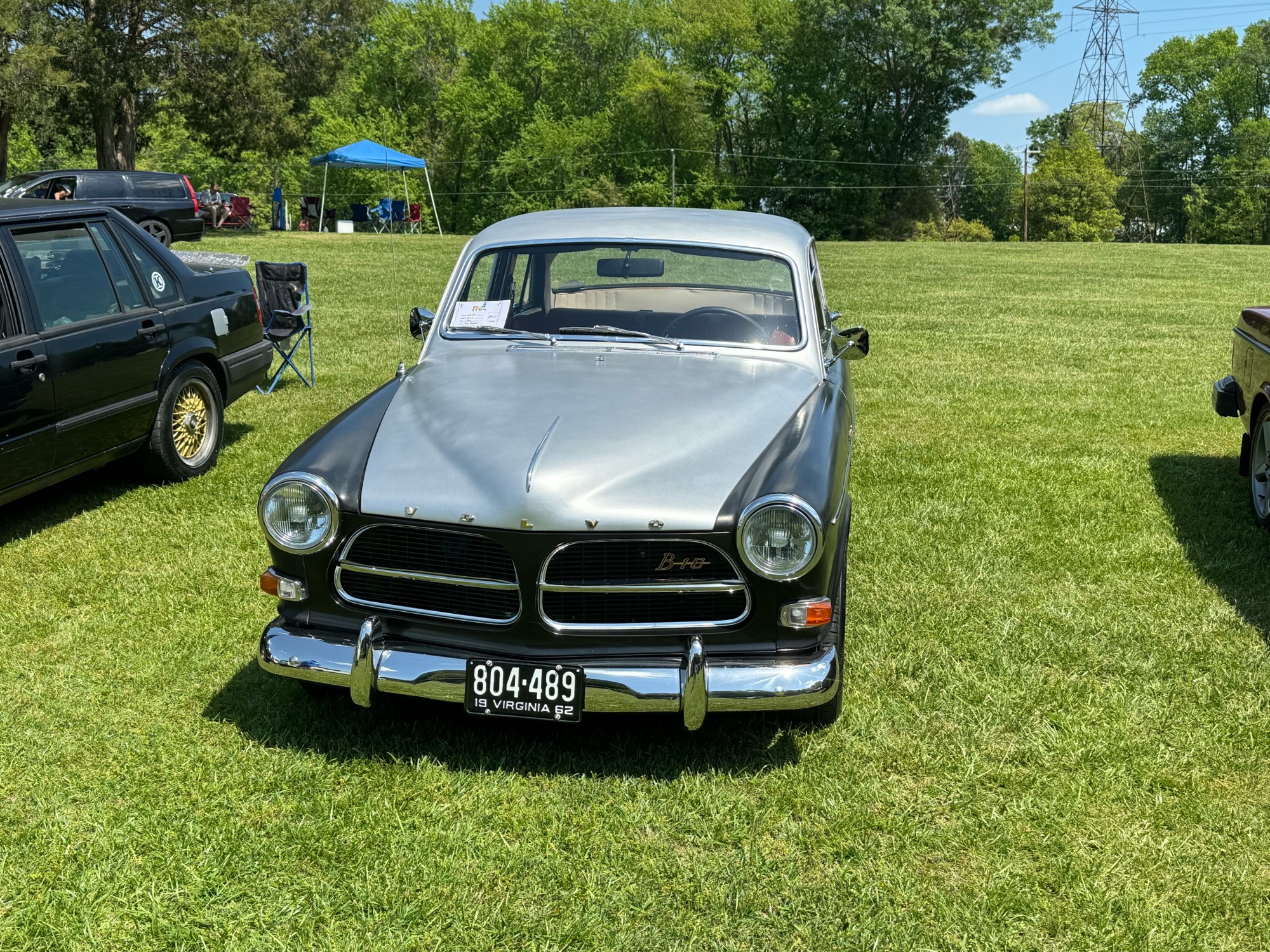

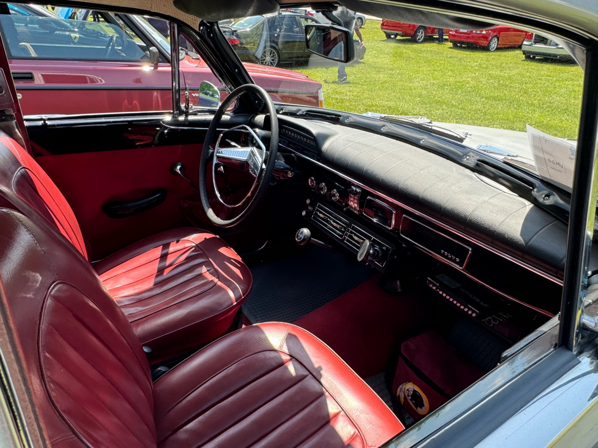

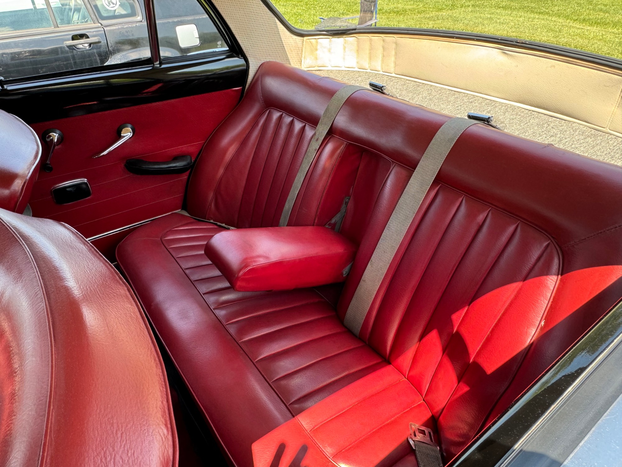

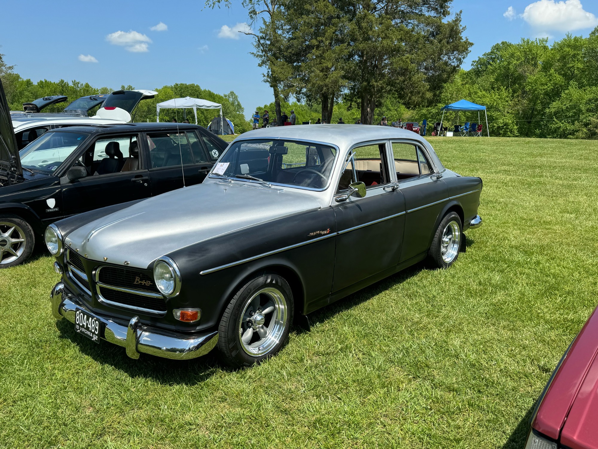

I installed the M41 three weeks ago and installed a new dash amongst a bunch of small things. The trans is shifting great and the J Type OD is kicking in and out smooth. I took old Leo to the Richmond VA Swedes (RVASwedes) car show today and he got awarded the Fan Favorite award and tied for best interior, but a recount will happen. Lol
