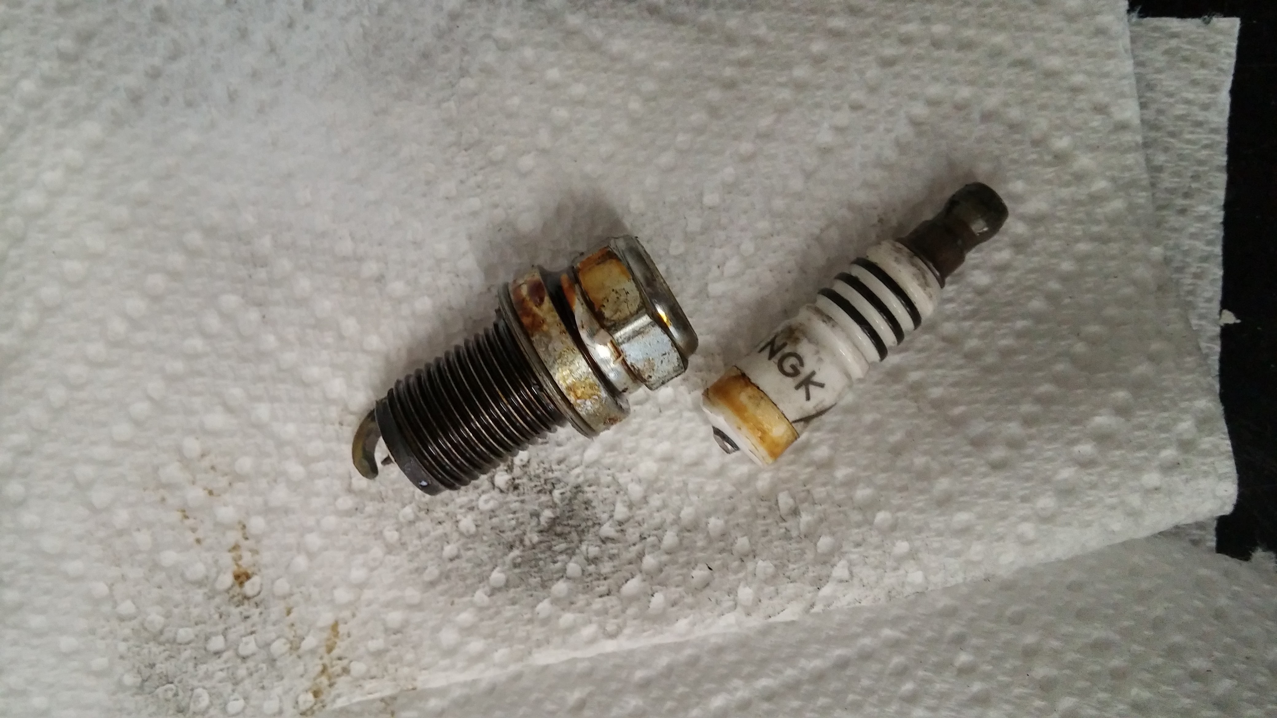

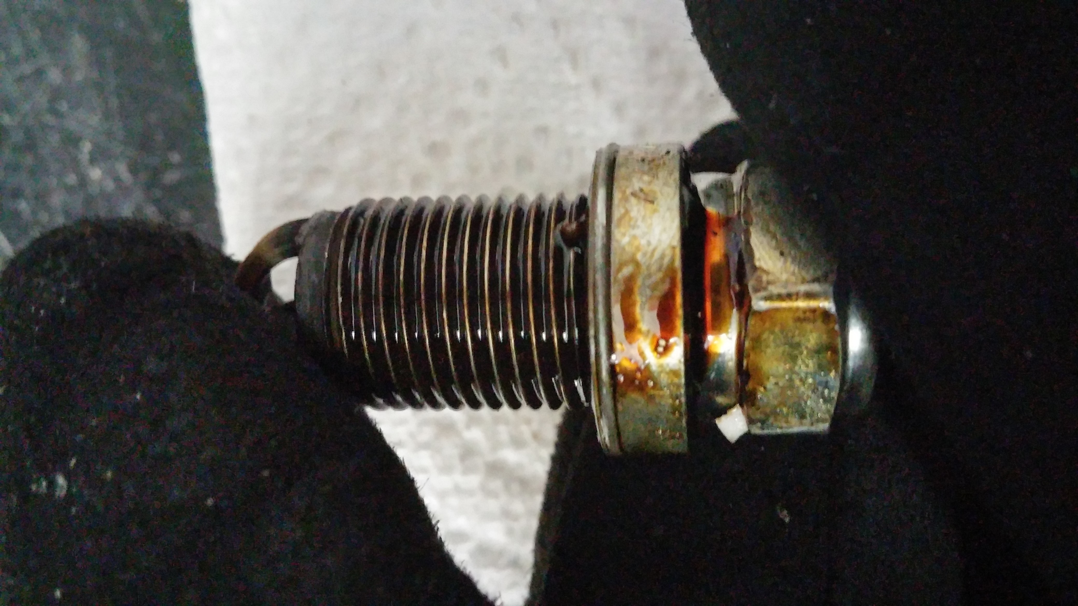

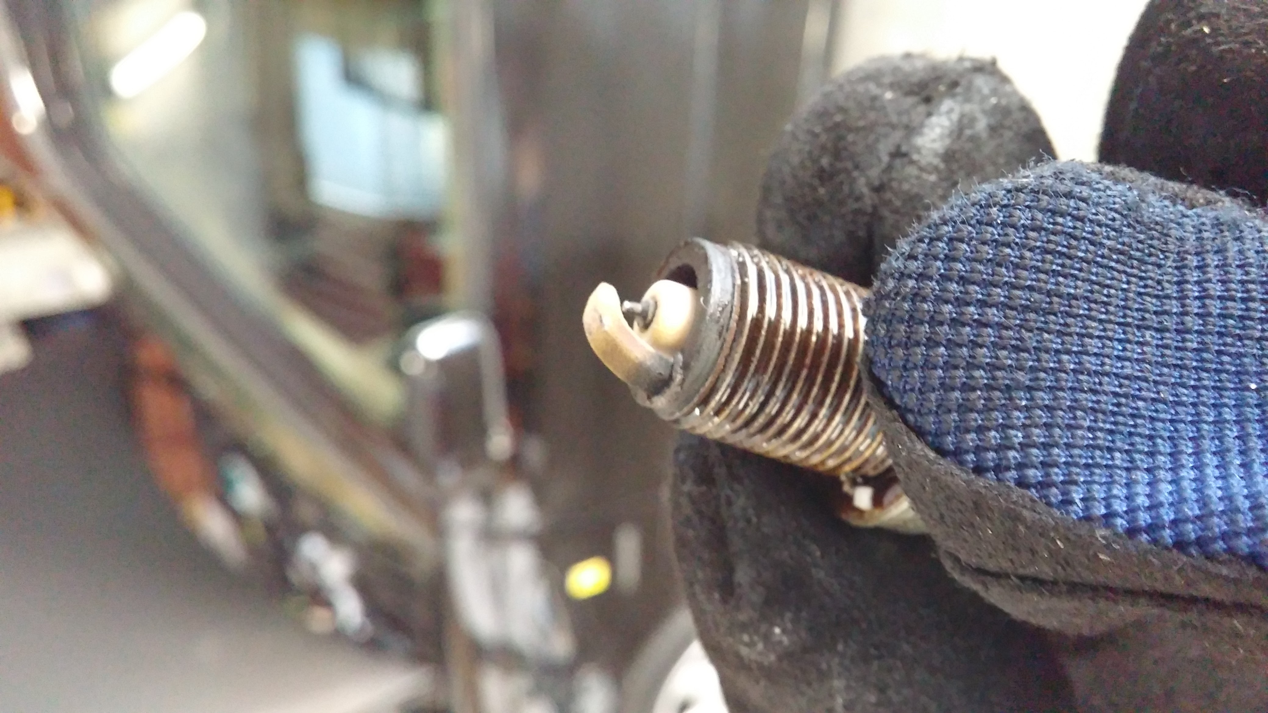

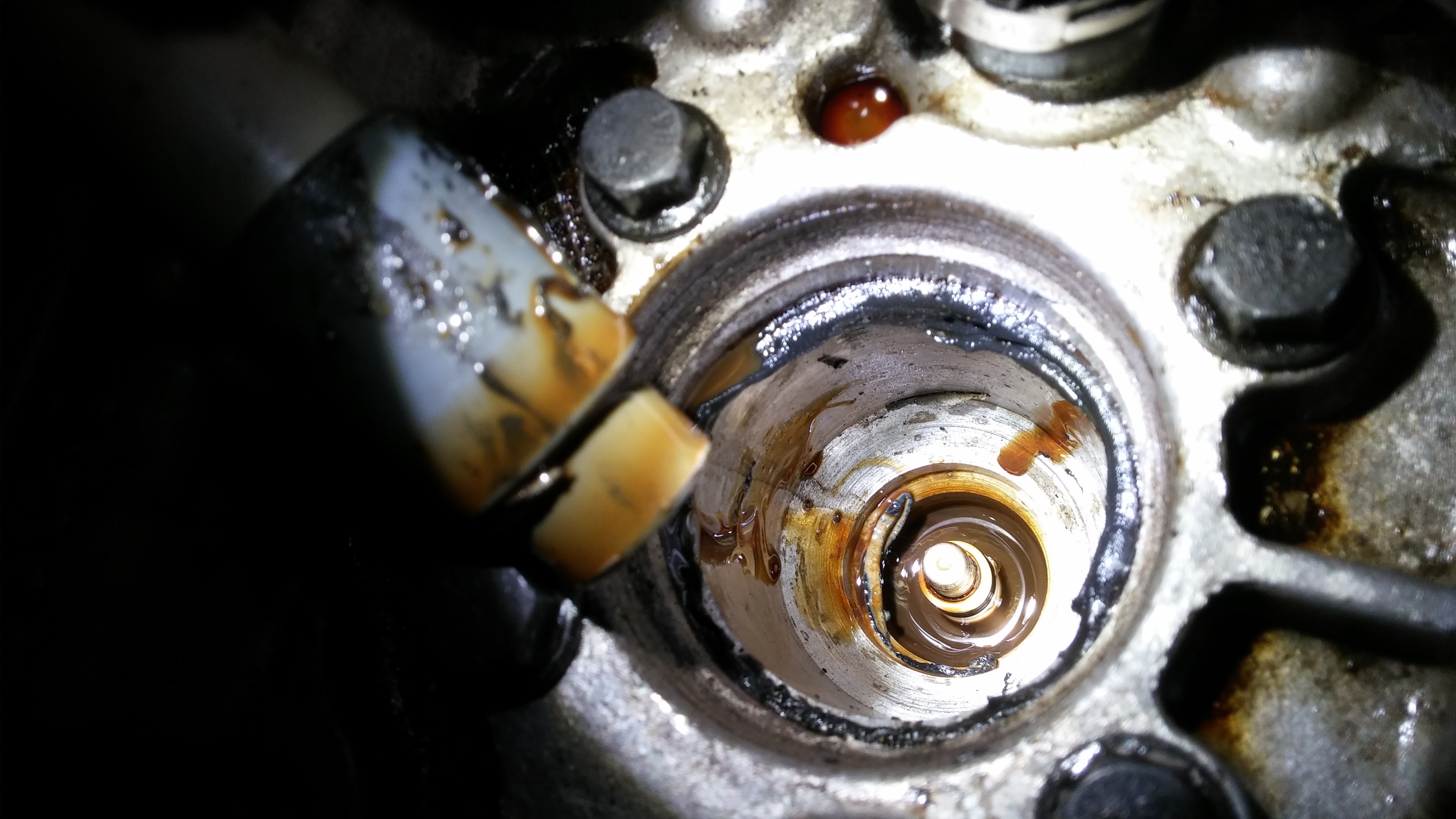

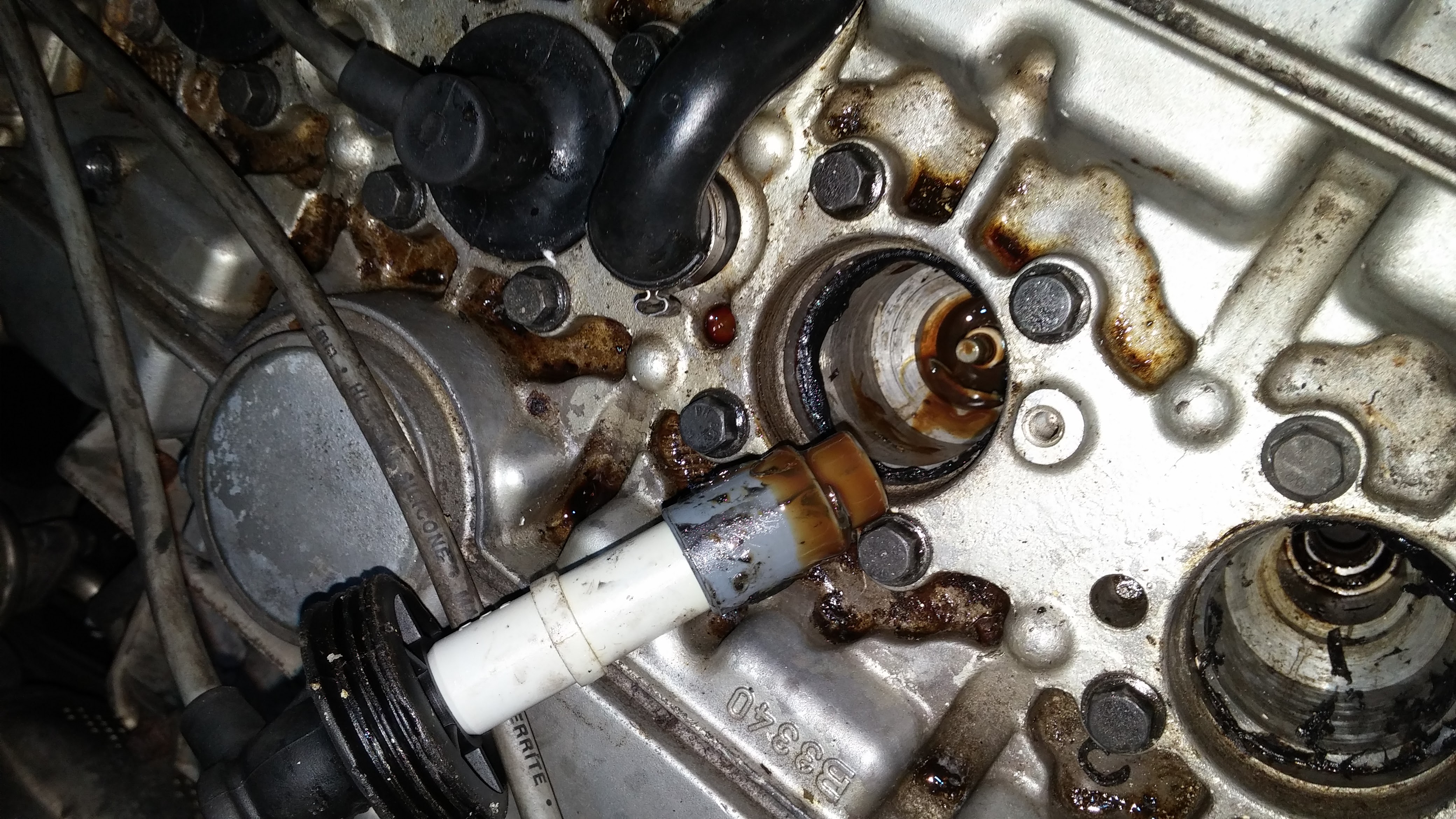

Did a little more work today, mainly trying to get that rotted motor mount bushing out (I've been hitting that thing for 3 days now, and that plastic sleeve will not move! I cut it a little bit, and now I'm soaking it in WD40 and PB blaster). I then decided to take a look at my spark plugs, since I have new ones and want to replace them. Pull out plug #1, oil on it. It was a little hard to break loose, and when I pulled it out, it broke in half. Once I got it out all the way, I noticed how much oil was actually on it. Mostly on the thread, though.

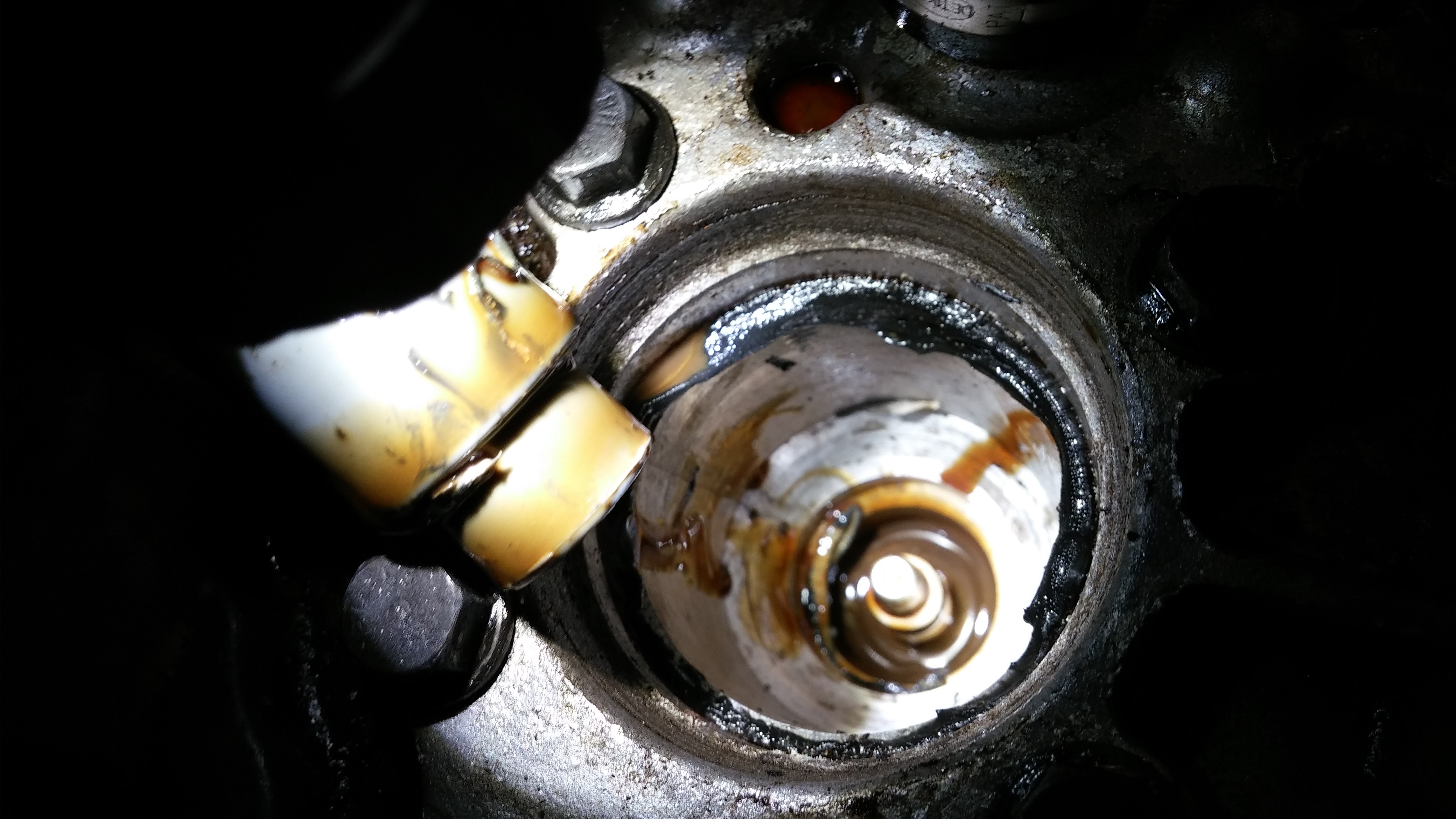

Then, I go to look at cylinder 2 (going from the left). The spark plug well was full of oil, including the boot. I'm going to assume this is a combination of the PCV and the oil cap seal. I just replaced the oil cap seal today, but after reading around, I'd like to get the PCV parts before running the car, just to avoid blowing out the rear main seal.

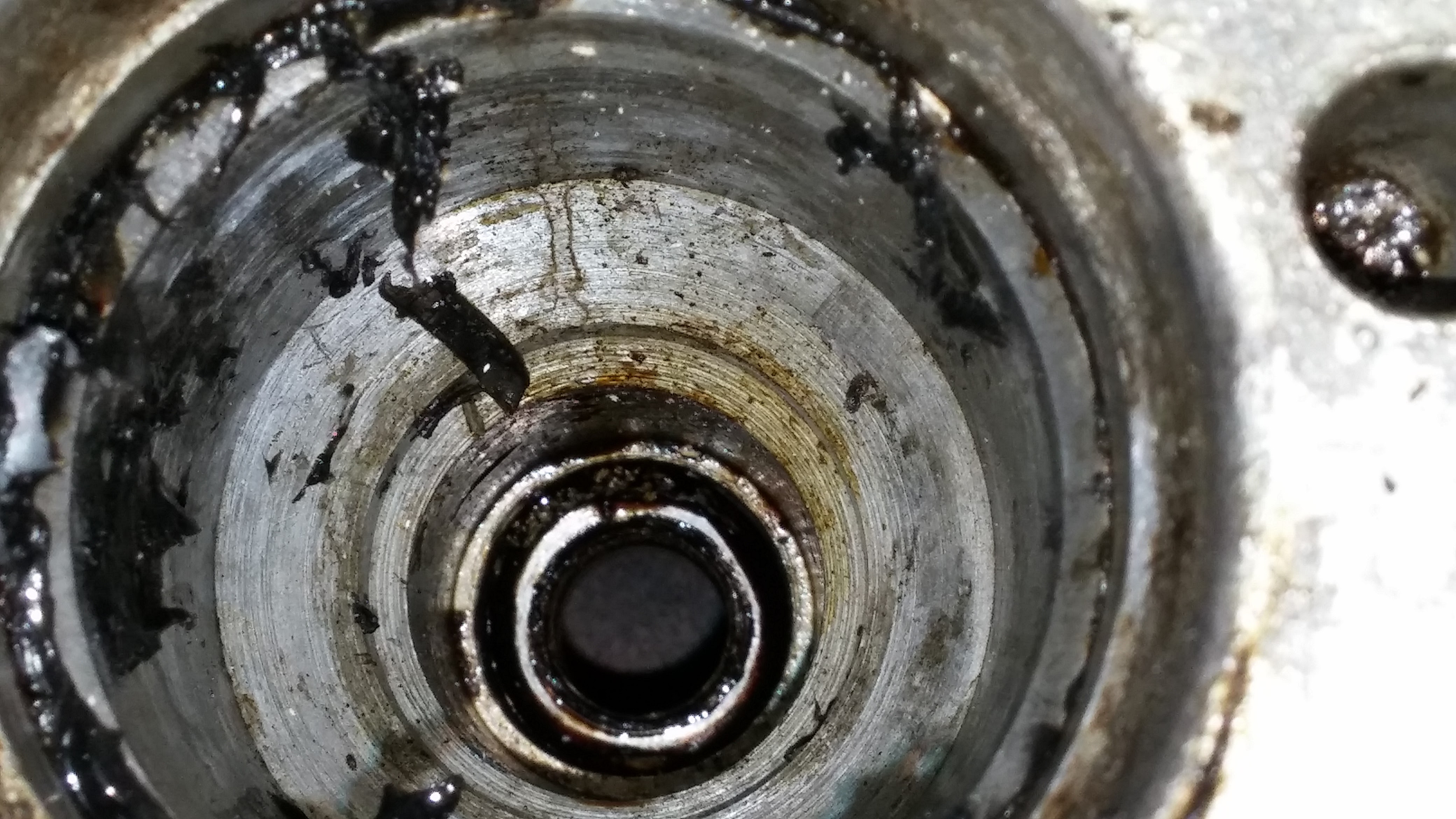

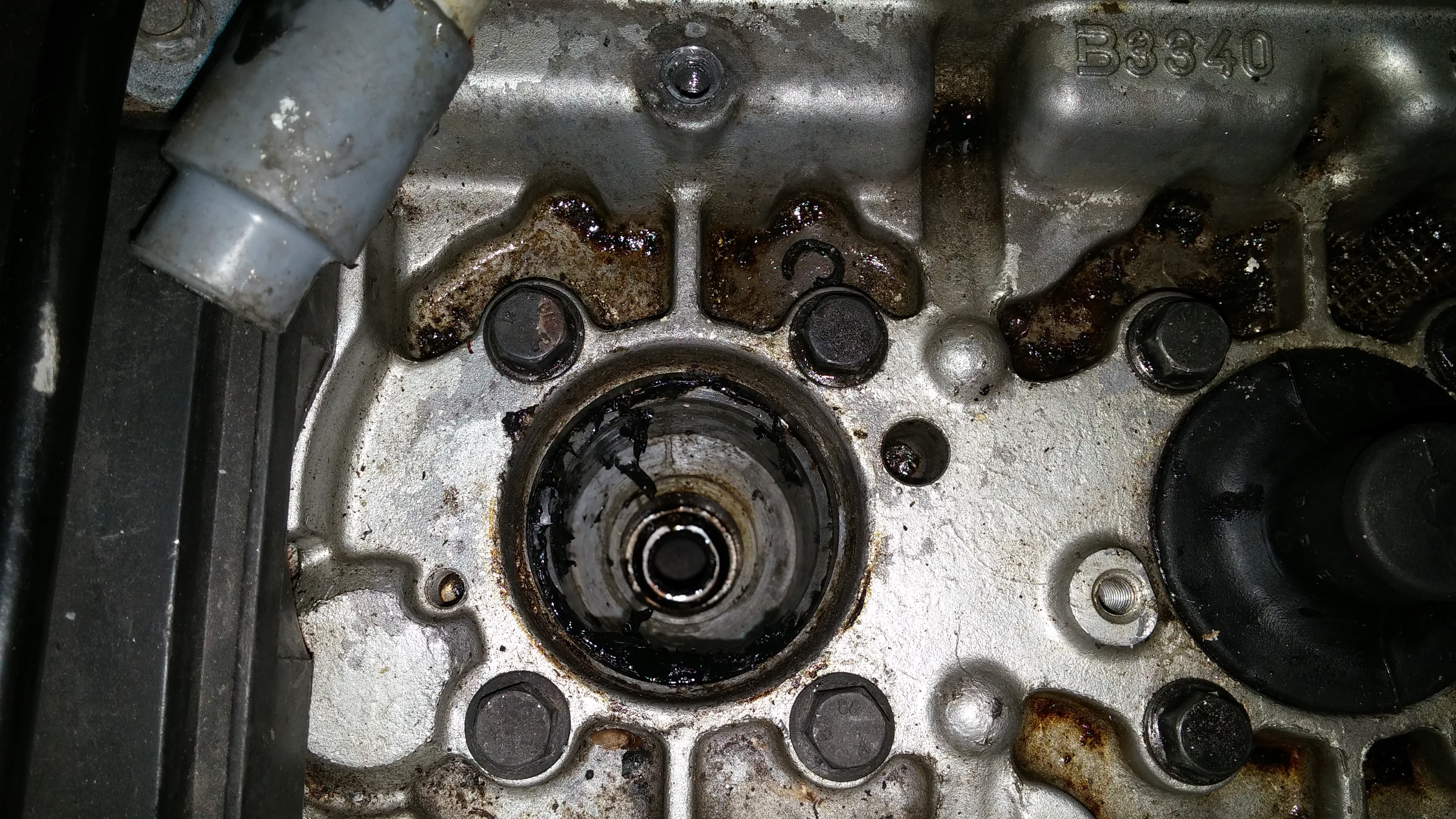

I didn't check cylinders 3-5, but I really don't like the color of that oil. I also don't like the fact that there's RTV (I assume that's what this guy used) on the boot. I'm really hoping that's just what spilled in from the oil cap or PCV hose.

- Posts: 36142
You can JB Weld that back together and then you only have to buy 4 new ones....
- Posts: 6357
- Joined: 30 Dec 2014, 10:45
- Has thanked: 316 times
- Been thanked: 531 times
Haha, that would fit nicely with all of the other half-a**ed repairs from the PO!abscate wrote:You can JB Weld that back together and then you only have to buy 4 new ones....
