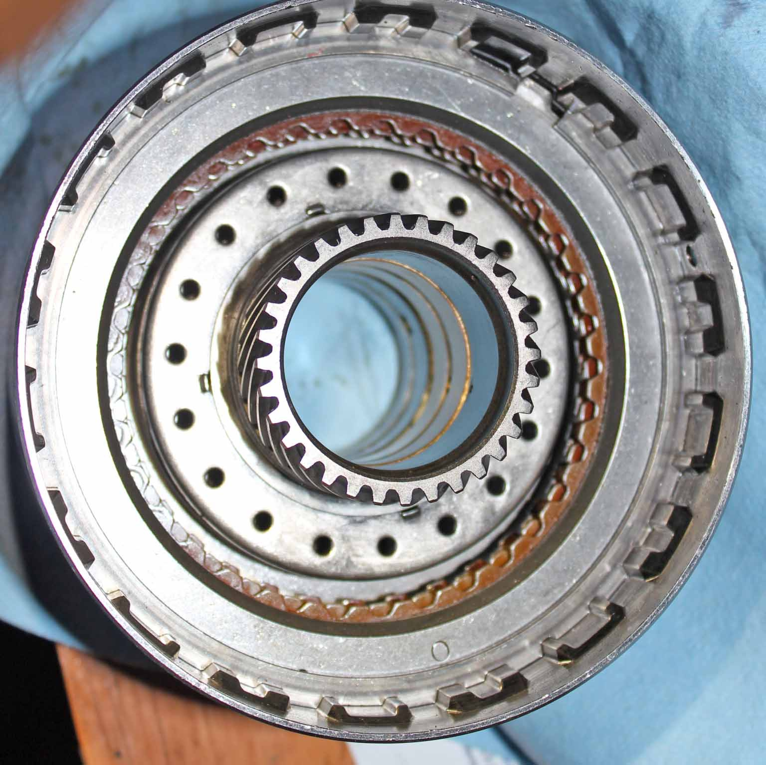

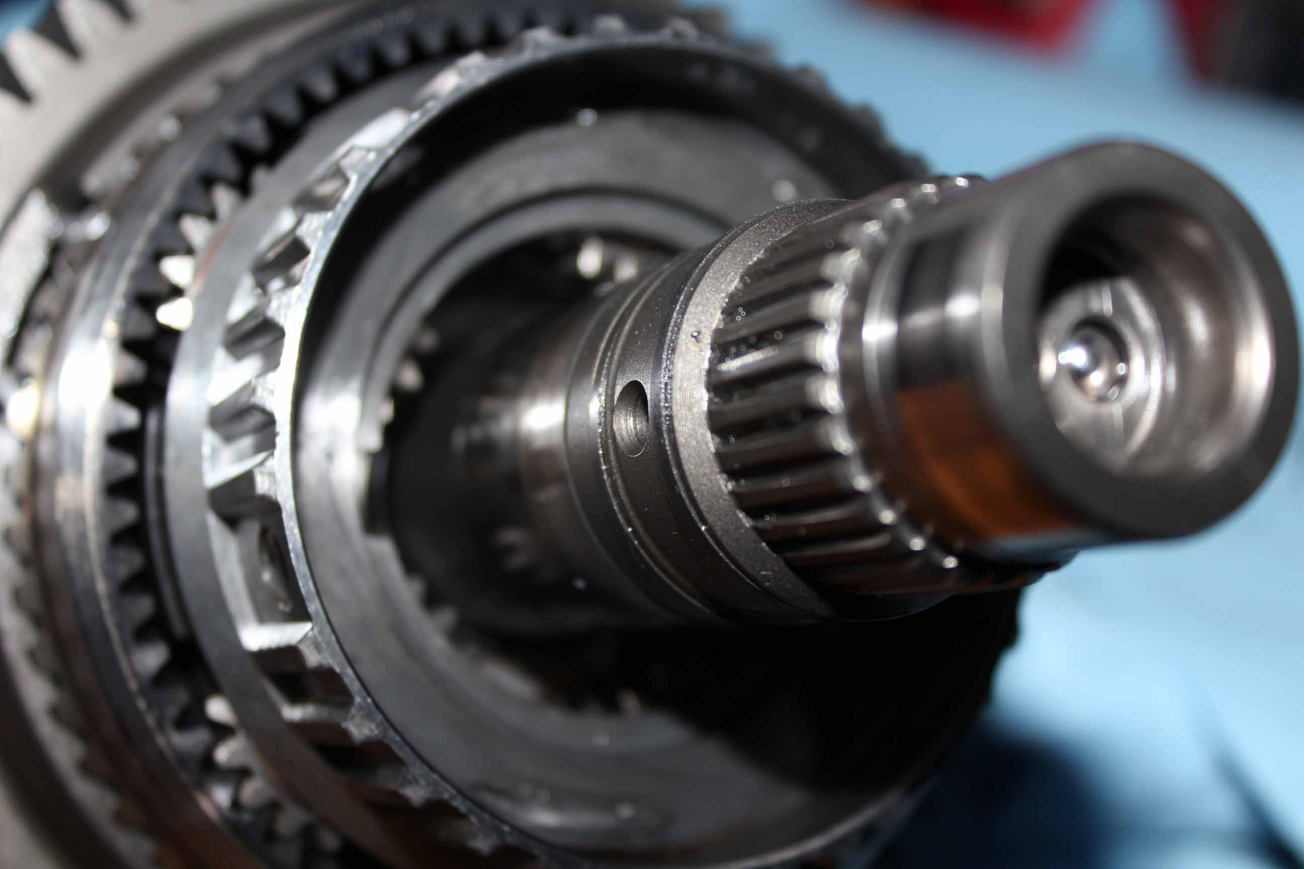

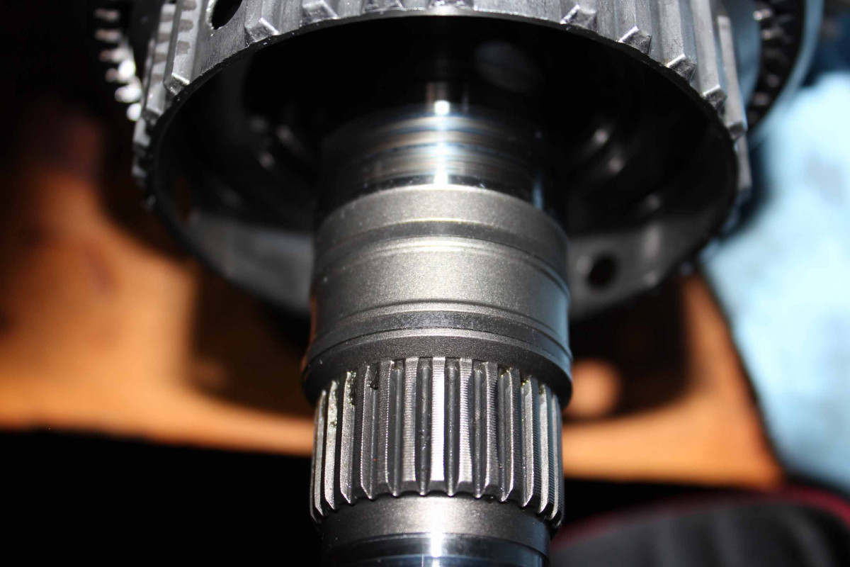

If you're planning on doing all the work yourself and replacing your current transmission with a good used one I will say you have the skills to split open the case of the transmission and replace many of the parts that are likely causing your 3-4 flare. I suspect it's worn 4-5 clutch frictions or a pressure drop due to a leak in the 4-5 apply fluid circuit which includes 3 sealing rings. For the 4-5 clutch apply the fluid enters through the end of the transfer shaft with a sealing ring on the end of the shaft. The fluid then exits through the shaft into the 4-5 drum and there's two more sealing between the drum and the shaft. The sealing rings are hard nylon/teflon type rings and used in different places within transmission. If any of these seals were leaking then there will be a drop in the clutch apply pressure. They're easy to replace when the transmission is apart.greffel wrote: 08 Jun 2021, 09:43 If think I will stop chasing this problem.... next step would be a good used gearbox from the yard.
To get to the possible internal leak is not for a normal skilled home mechanic ?
The friction plates are not difficult to replace either. Replacing the seals for the apply pistons is a little more involved because you have compress the springs to get the retaining rings off and pistons out. Replacing shafts bushings is a little tricky if required but doable. There's also possible case wear which would require machining and an insert.
The challenge with a used transmission is finding a known good one and one that's compatible, which depends on the final drive ratio and if it's a FWD or AWD, plus there are changes to the wiring harness connections from 2005 on I believe. If you can find a good used one it's definitely does save time and labor over rebuilding one but if the used the transmission isn't a good one or isn't compatible for some reason and you have do it all over again then I think it's more work than repairing your current transmission.
These two seals are for the 4-5 fluid apply pressure. There's a sealing ring in the case for the end of the shaft (not shown) where the fluid enters the shaft for 4-5 apply 4-5 drum with clutch that's applied for the 3-4 shift, applied in 4th and 5th gear
