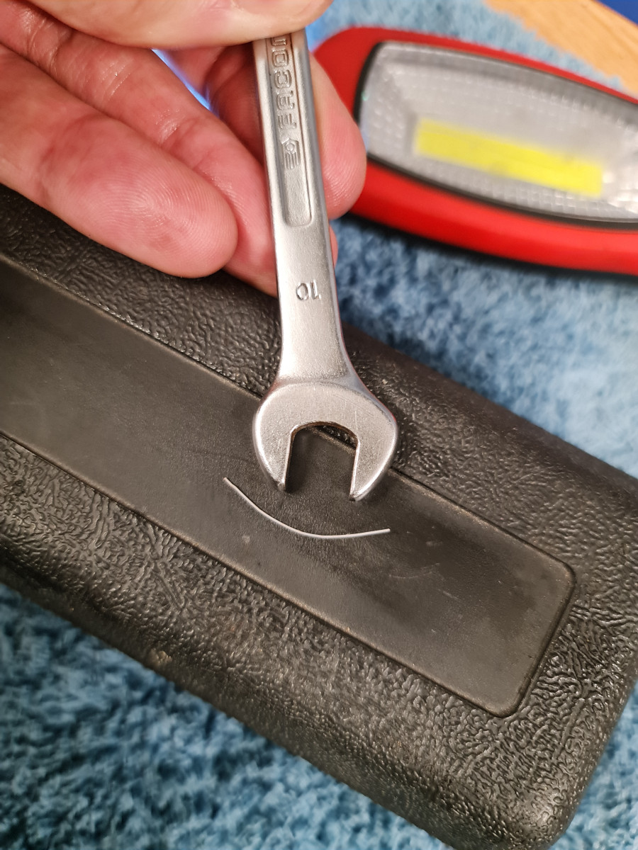

When I examined the bushings with my finger I found this ??
Som kind of thread ?
I would be fun to rebuild the hole gearbox. But I my self would never pay/buy a rebuilt gearbox from som random person, so I think the investment i parts is useless. If only friction and steel plates where needed then I would sell it cheap. :)

The thread is an interesting find, not sure where that came from.
I don't know what the rest of the transmission looks like but the 4-5 inner hub/planetary is definitely damaged and the metal pieces from the worn out frictions can't be good for other parts of the transmission.
