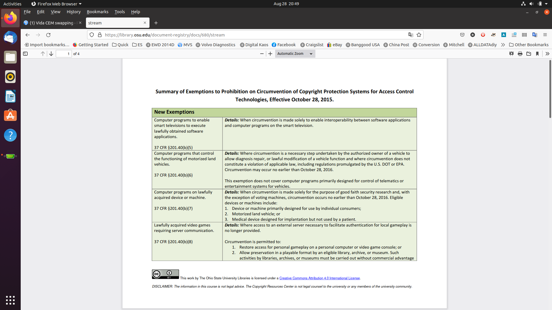

That changed October 28, 2016. Upheld in the 2018 DMCA Exemptions.vtl wrote: 28 Aug 2021, 15:57 It is just illegal or stinks very much like it is illegal in US under DMCA law
2015 DMCA Exemptions.
1. Motion pictures (including television shows and videos)
2. Literary works, distributed electronically, protected by TPM interfering with assistive technologies
3. Computer programs that enable devices to connect to a wireless network (“unlocking”)
4. Computer programs on smartphones and all-purpose mobile computing devices (“jailbreaking”)
5. Computer programs on smart TVs (“jailbreaking”)
6. Vehicle software to enable diagnosis, repair, or modification.
7. Computer programs to enable good faith research of security flaws
8. Video games requiring server communication
9. Software to limit feedstock of 3D printers
10 Patient data from implanted networked medical devices
"Computer programs that control
the functioning of motorized land
vehicles.
37 CFR §201.40(b)(6)
Details: Where circumvention is a necessary step undertaken by the authorized owner of a vehicle to
allow diagnosis repair, or lawful modification of a vehicle function and where circumvention does not
constitute a violation of applicable law, including regulations promulgated by the U.S. DOT or EPA.
Circumvention may occur no earlier than October 28, 2016. "
( No screwing around with safety ( DOT ) and environmental protection (EPA ).
This exemption does not cover computer programs primarily designed for control of telematics or
entertainment systems for vehicles. ( No hacking services such as Satellite radio and vehicle tracking )

Good to know that our lawmakers are less insane than they were before October 28, 2015.
Anyways, I don't own "rights" for that known P3 CEM pin finding algo. Also the P3 cracker would make more sense in existing as a standalone software for DiCE, which virtually every DIY Volvo owner has. Means, it probably should be written for Windows, which means I'm out =)

It is out of the hands of the lawmakers. The Copyright Office makes the rules from now on. Bureaucrats don't need to appease political donors because they are not elected. Bureaucrats don't make changes all willy-nilly because rule change is a labor intense process. Once a CFR ( Code of Federal Regulations ) is changed, the change is pretty stable.vtl wrote: 28 Aug 2021, 21:27 Good to know that our lawmakers are less insane than they were before October 28, 2015.
The whole idea of a regulatory agency is to bring about sanity because it is impossible to legislate for every consistency.
