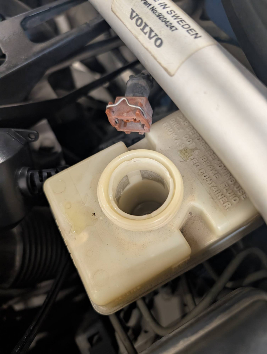

Replaced the broken ECT connector and swapped the 17" back on for inspection tomorrow. About 20min worth of work on the P80

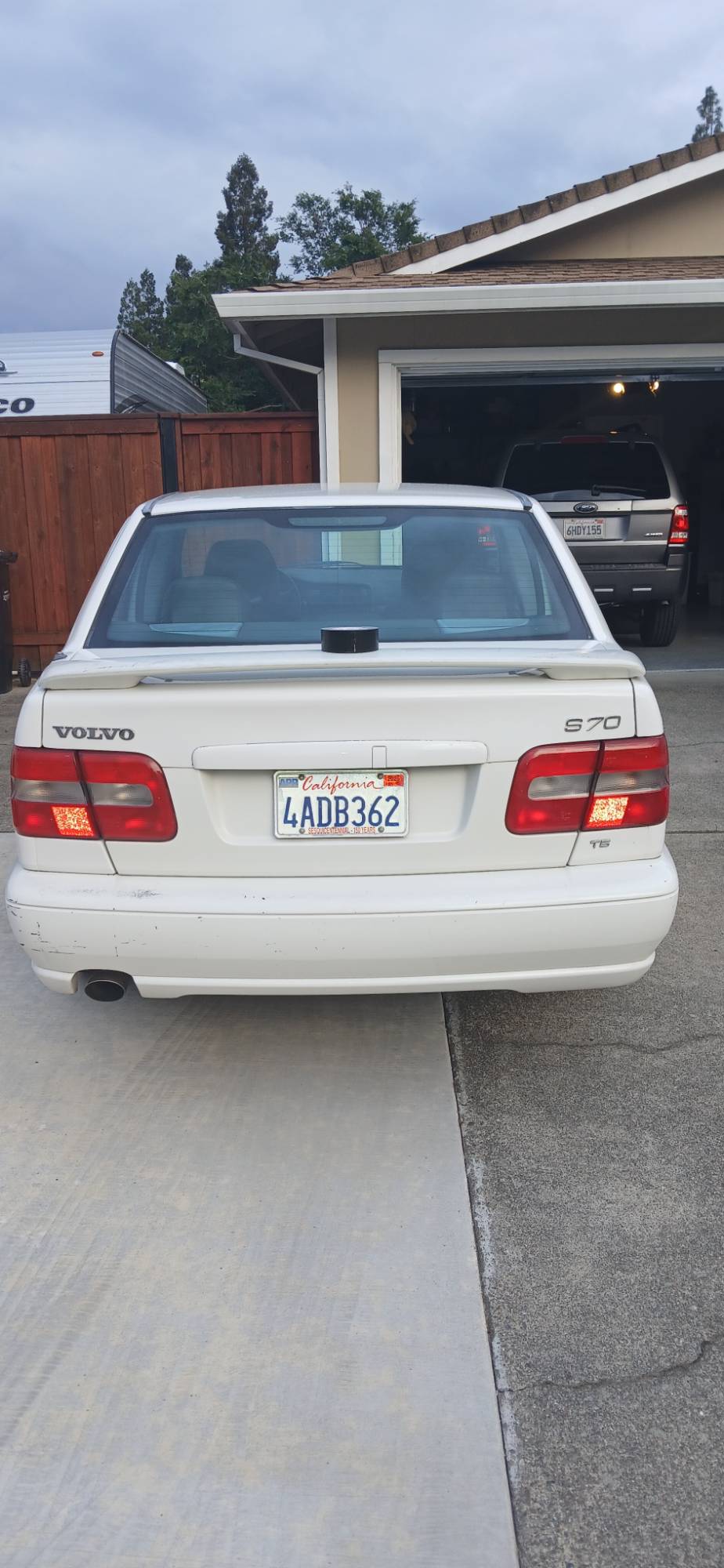

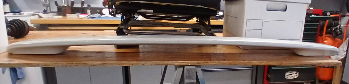

Scored '98 spoiler from junkyard. My little saw for cutting away the tape broke. Used wire from other cars to saw through it. Took two hours! Sadly someone already got the brackets.

Check with Robert, he usually has a couple sets with him. I think he's in Chicago at the moment, but can ship on the road.rudsaki wrote: 27 Apr 2025, 09:55 Scored '98 spoiler from junkyard. My little saw for cutting away the tape broke. Used wire from other cars to saw through it. Took two hours! Sadly someone already got the brackets.20250426_164150.jpg20250426_185518.jpg
His cell number is on his website and in the 'more' part of the videos.
- Posts: 15511
- Has thanked: 2215 times
- Been thanked: 1853 times
There is a company out there that is selling new rear spoiler mounts for both wagons and sedans. If you have no luck locally, let me know as I have a few sedan sets.

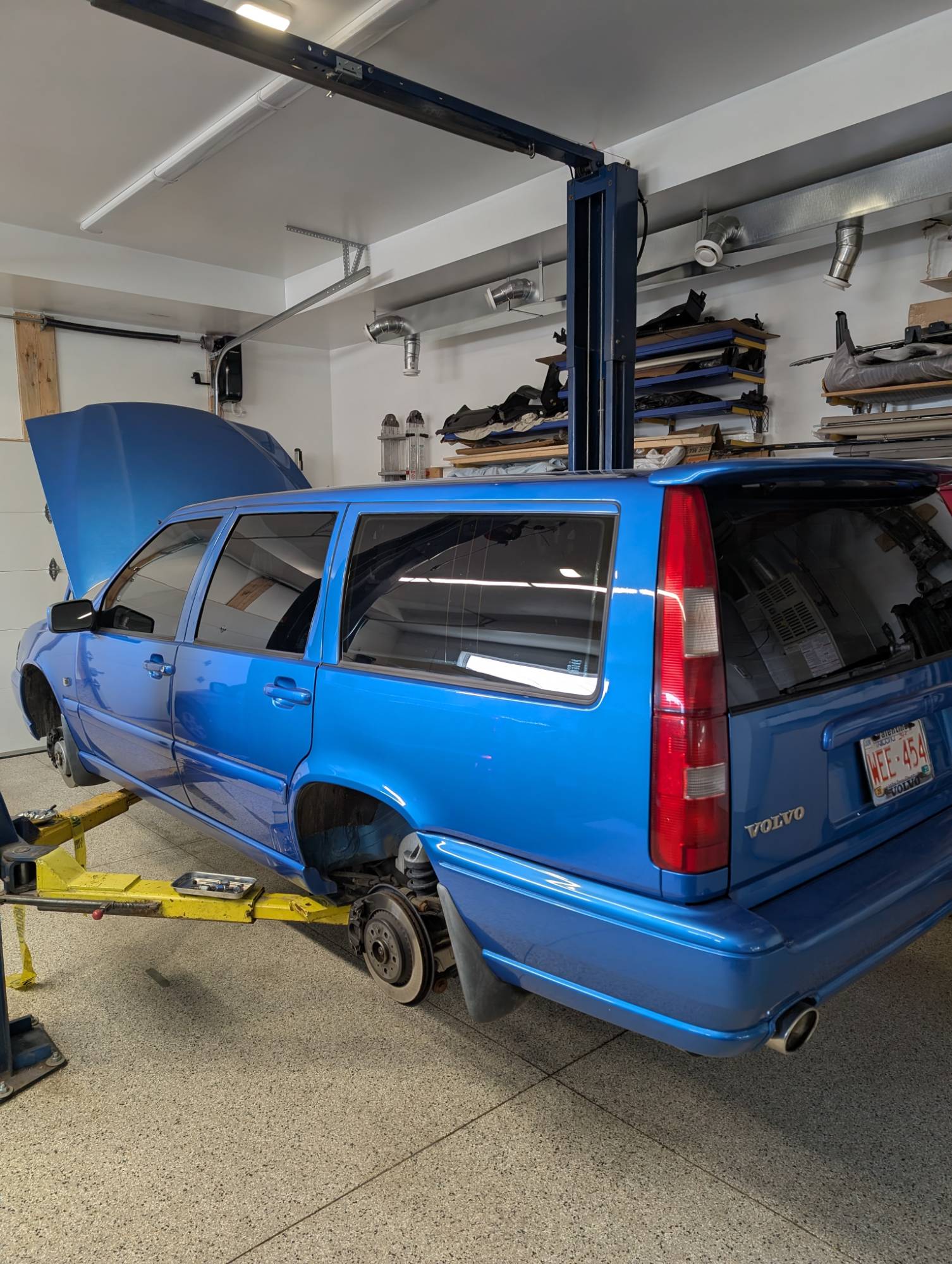

Well the R adopted the normal position over the last couple of days:
In it's defense, this was so that I could catch up on some fluid maintenance and swap on the new summer Conti's. These I went down a size in width to see if it will stop the inner fender rubbing that started after the dealer changed the sub-frame bushes. So now going to run 215/45/17 v's 225/45/17".

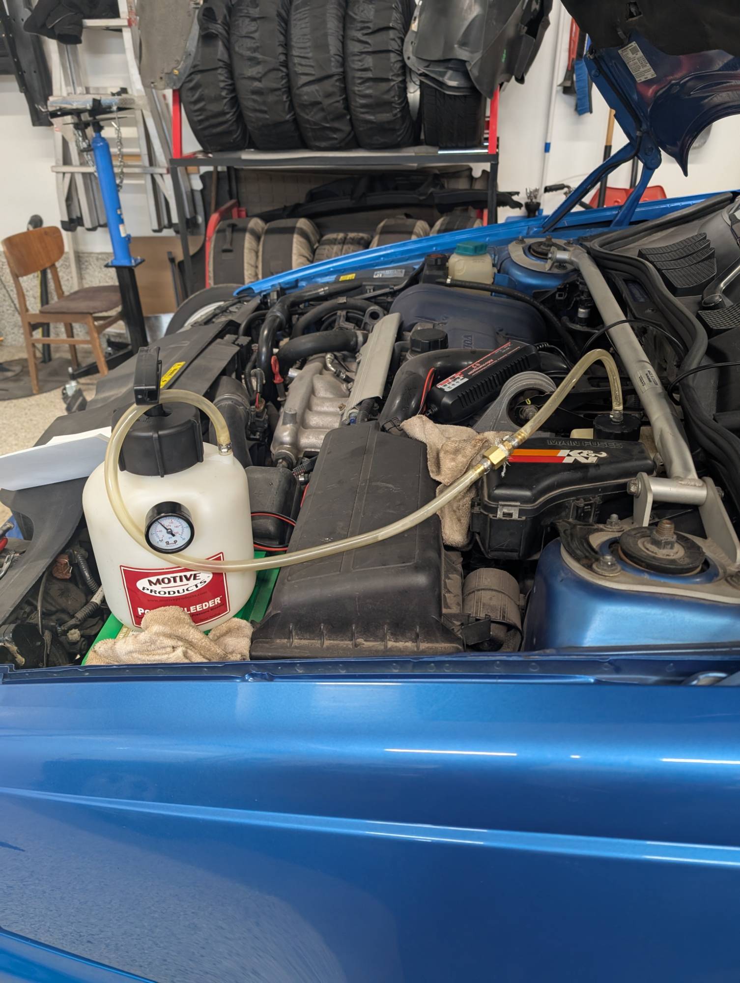

I have only used my new to me brake fluid pressure bleeder. I have only used it once before but with not a great success. I got some advice from my ex-Volvo mechanic buddy on using it and with his help it was a much greater success this time around.
I first used my turkey baster and sucked all the old fluid out the reservoir, then refilled it (approx. 250 ml). I then added the remaining fluid and about the same again from a second 1 liter can. What I have learned is I can't estimate how much fluid I have flushed through the system. It turns out in total it was only 1 liter I actually used. In future I will mark my drain bottle with levels so I get a better idea.

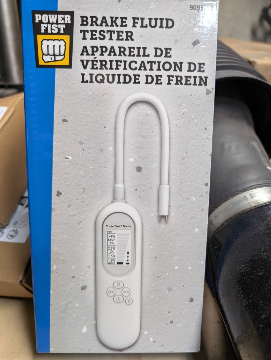

I discovered, after someone mentioned this tool, that my dim memory was correct and I have one as well. I tried it on both out Volvos and it said both had <1% of moisture which means it was ok. However, based on time and you are only measuring the reservoir contents I decided to swap it anyway. Next time I am going to aim at the 1.5-2 liter with more being used on the rear Right brake as it is the longest pipe run.
Fortunately the brake bleeders worked ok, but next time I may swap them as I think they may be partially blocked and aging with rust.
