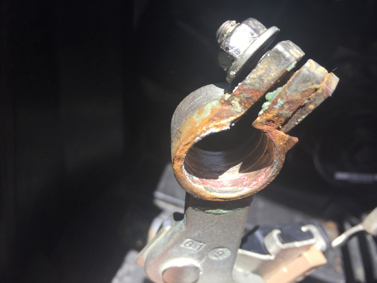

The battery on my S80 died suddenly. No warning was given. My Son drove it home and parked in the driveway and I went out an hour later to move it and it wouldn't start. I tried to recharge the battery but it didn't have enough capacity to even get the starter to click. Its a standard wet cell type battery, I did check to make sure that it still had electrolyte in all 6 cells and it did.

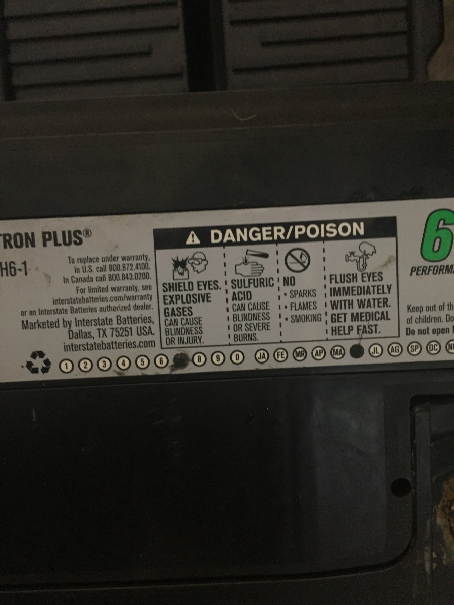

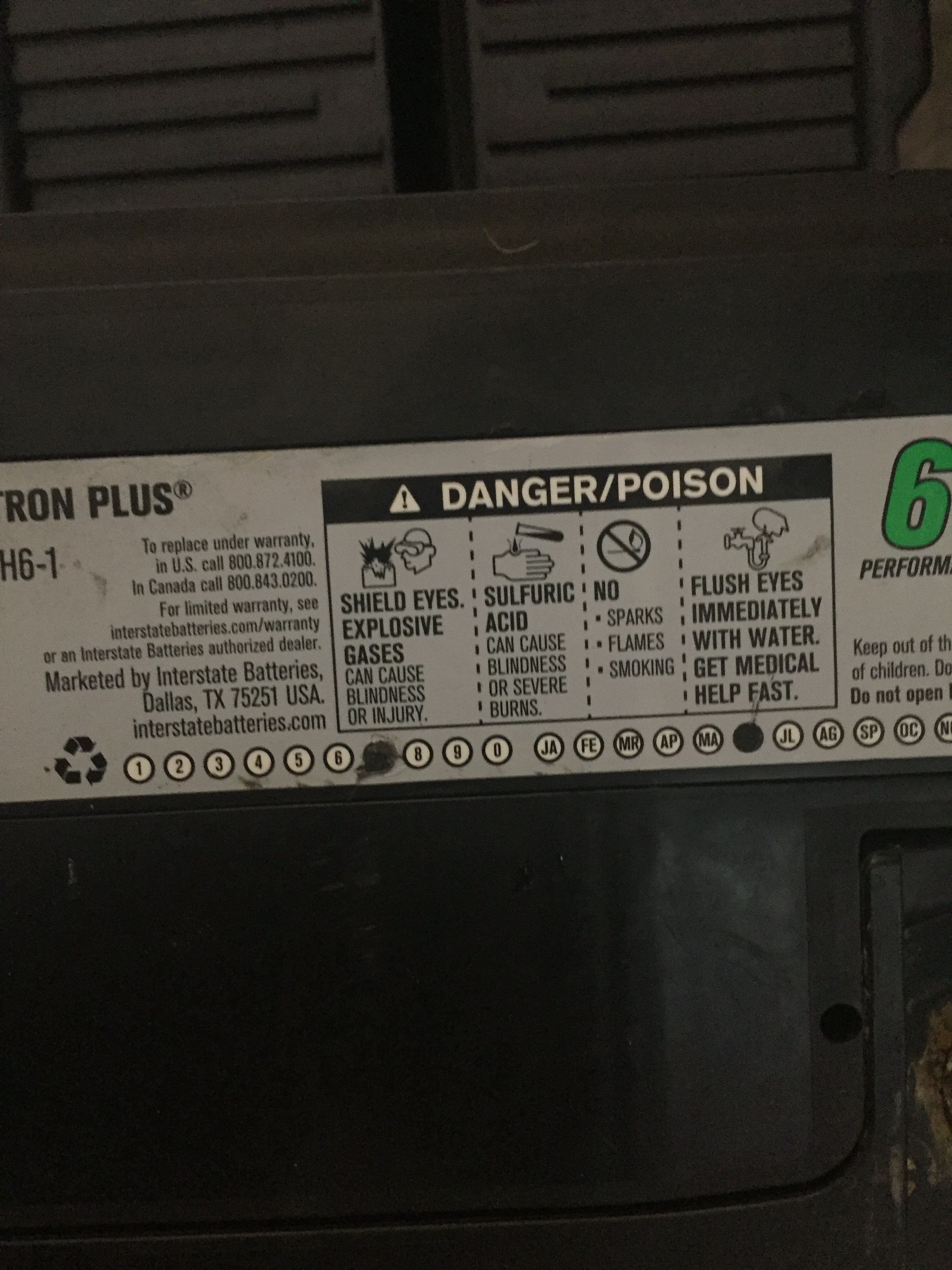

Based on the marking on the battery it was purchased in June of 2017 and it was supposed to be a 6 year battery. Not by my math more like four years and three weeks. The battery came with the car when I bought it so no warranty for me.
I was planning on changing it at some point. (Not today but someday soon)

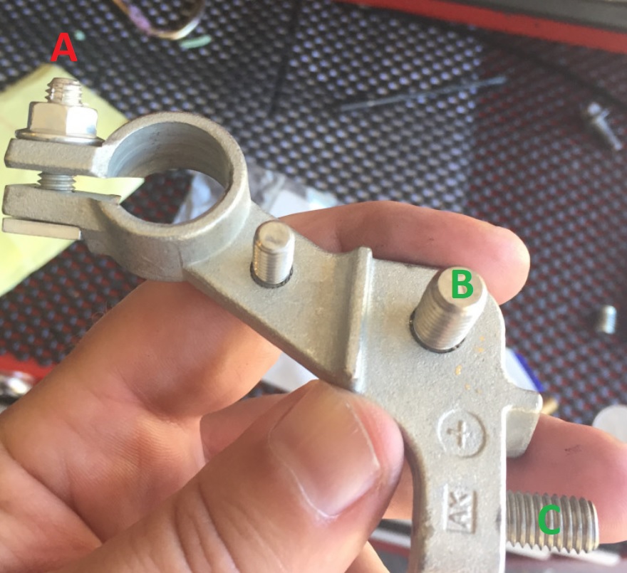

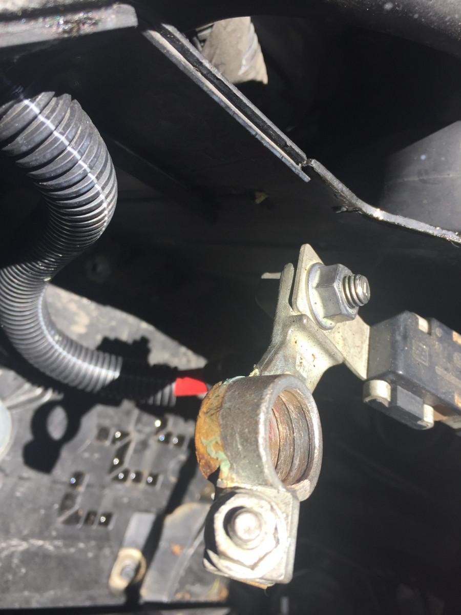

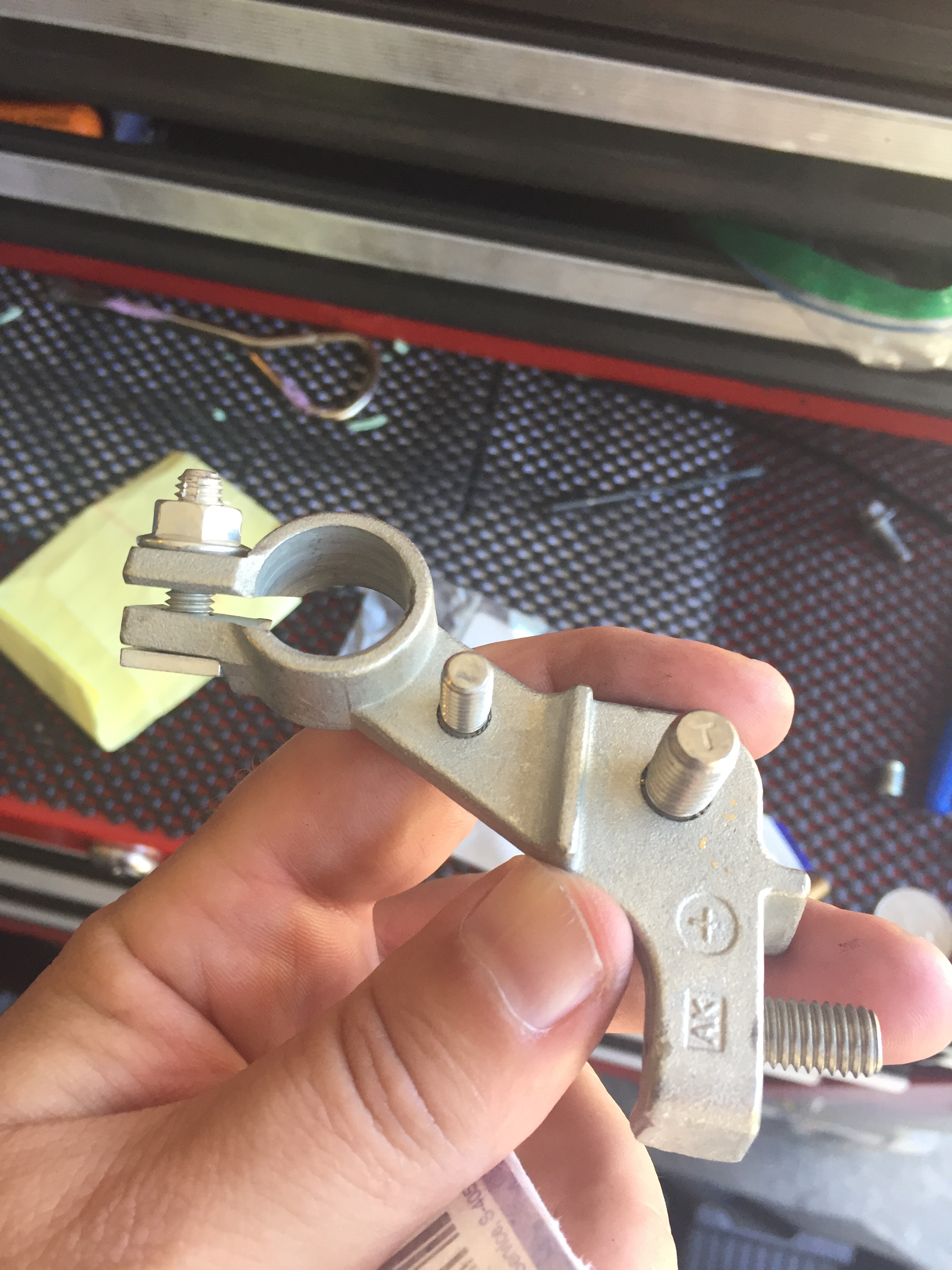

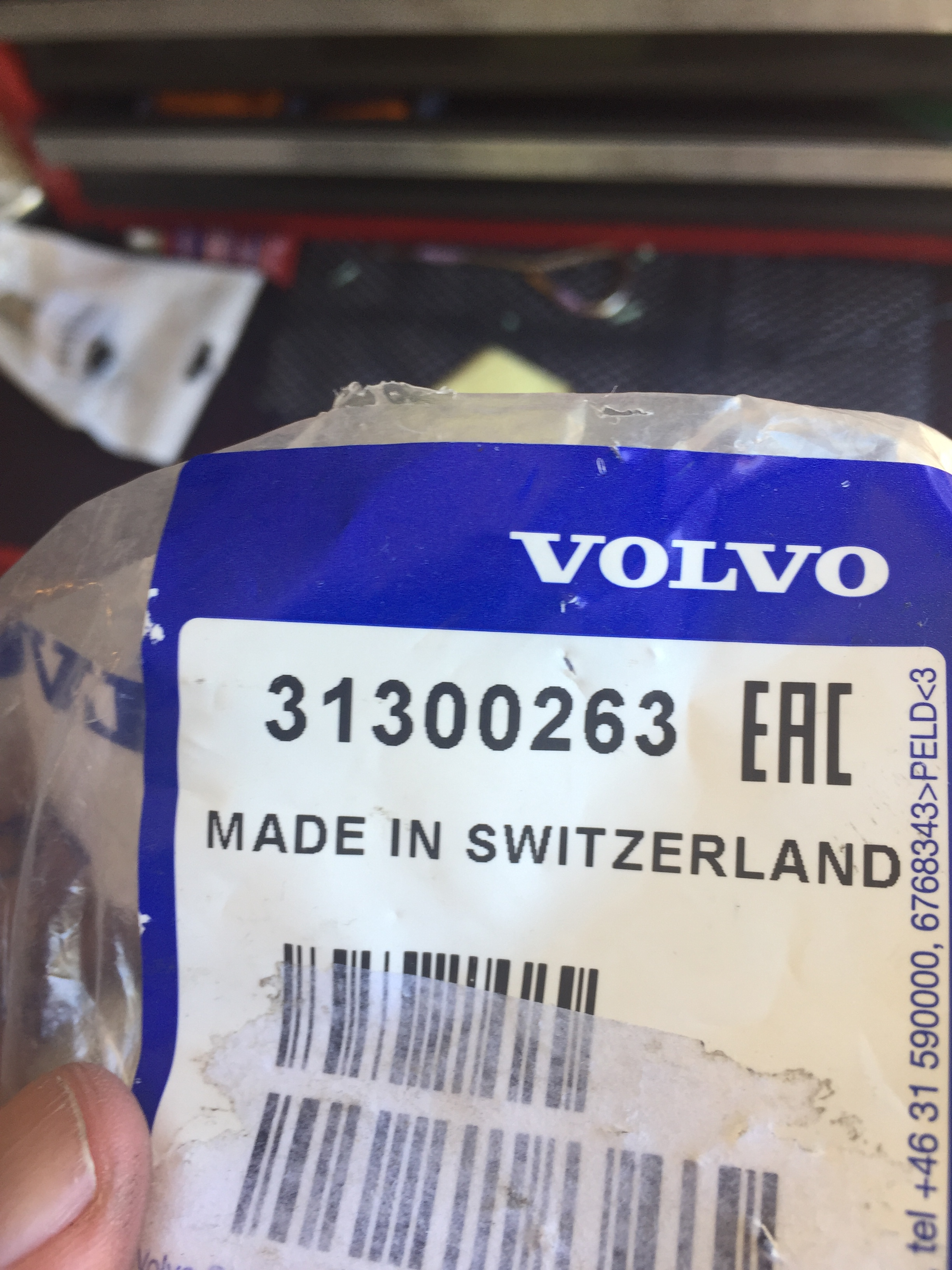

I did notice a while ago that the Positive terminal clamp was corroded, so I bought one a few weeks back with the intension of replacing it with the battery.
Because the battery in my LR2 is also old I actually put the new battery in the LR2 and I am using a slightly too large H7 in place of the original H6 battery for the S80. (the battery cover won't latch with the H7)
Some pictures
For the 13 mm hex nuts I torqued them to 17 newton meters or 12.5 Ft * LBS if you prefer
This is the torque needed to remove the nuts.
If someone knows the actual specification let me know and I will tighten them to the proper spec.

There are too many variable to use a torque spec for a battery clamp.
I tighten them while gently twisting the clamp, when I can no longer twist it, I give it 1/12 nip more (1/2 of a hex flat) to freeze it in place.

Agreed thanks
That answers location A
Does anyone know the torque spec for location B or C? (see below for an alternate solution)
If the answer is essentially what ABSCATE wrote for the terminal that is fine as well.
To paraphrase: Don't worry about the exact torque just confirm the cable terminal has a positive clamping force by gently moving it while tightening and when it is secure add just a little more.
This is good advice. Thanks ABSCATE!!!
Thanks
Paul
