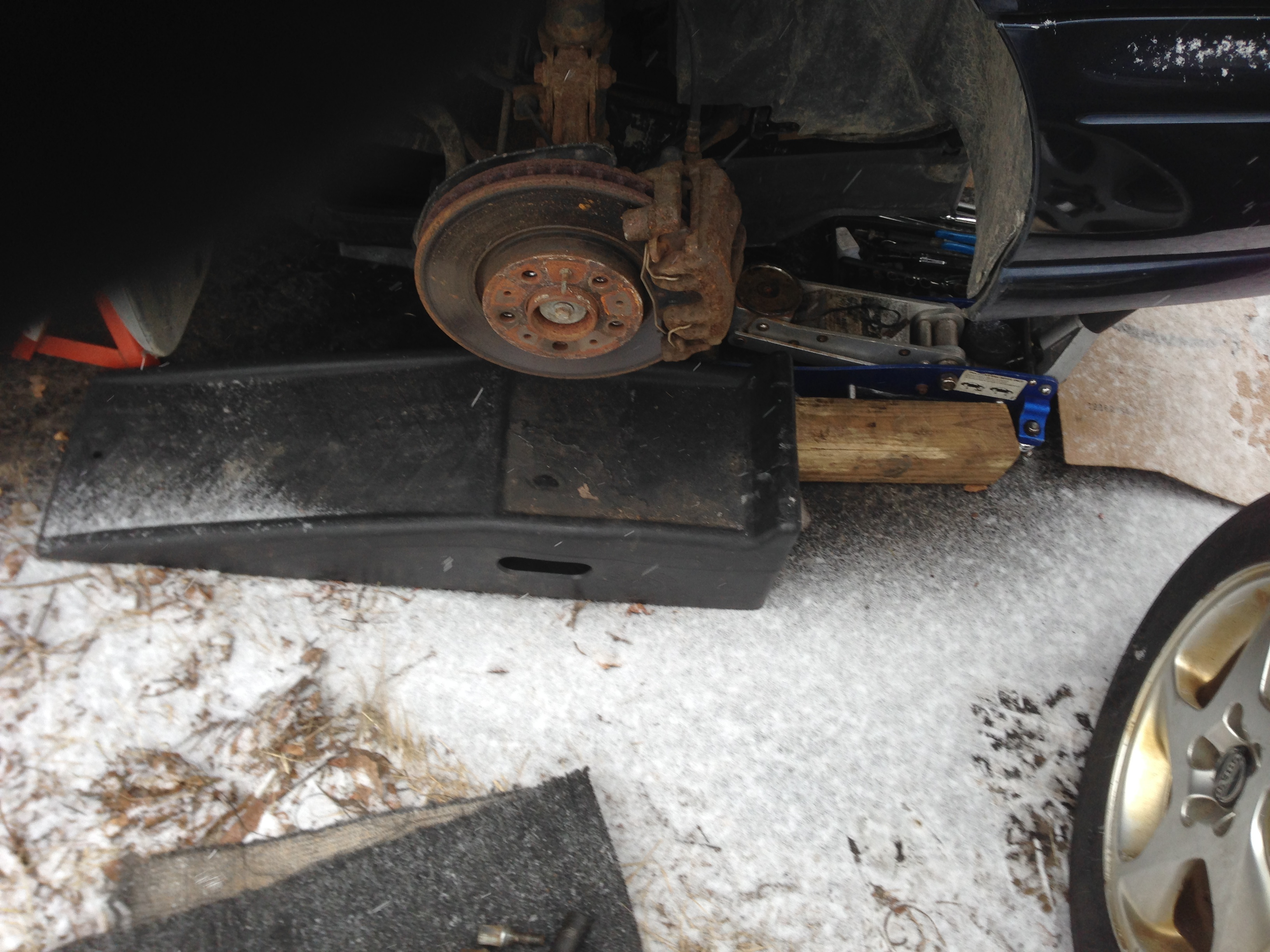

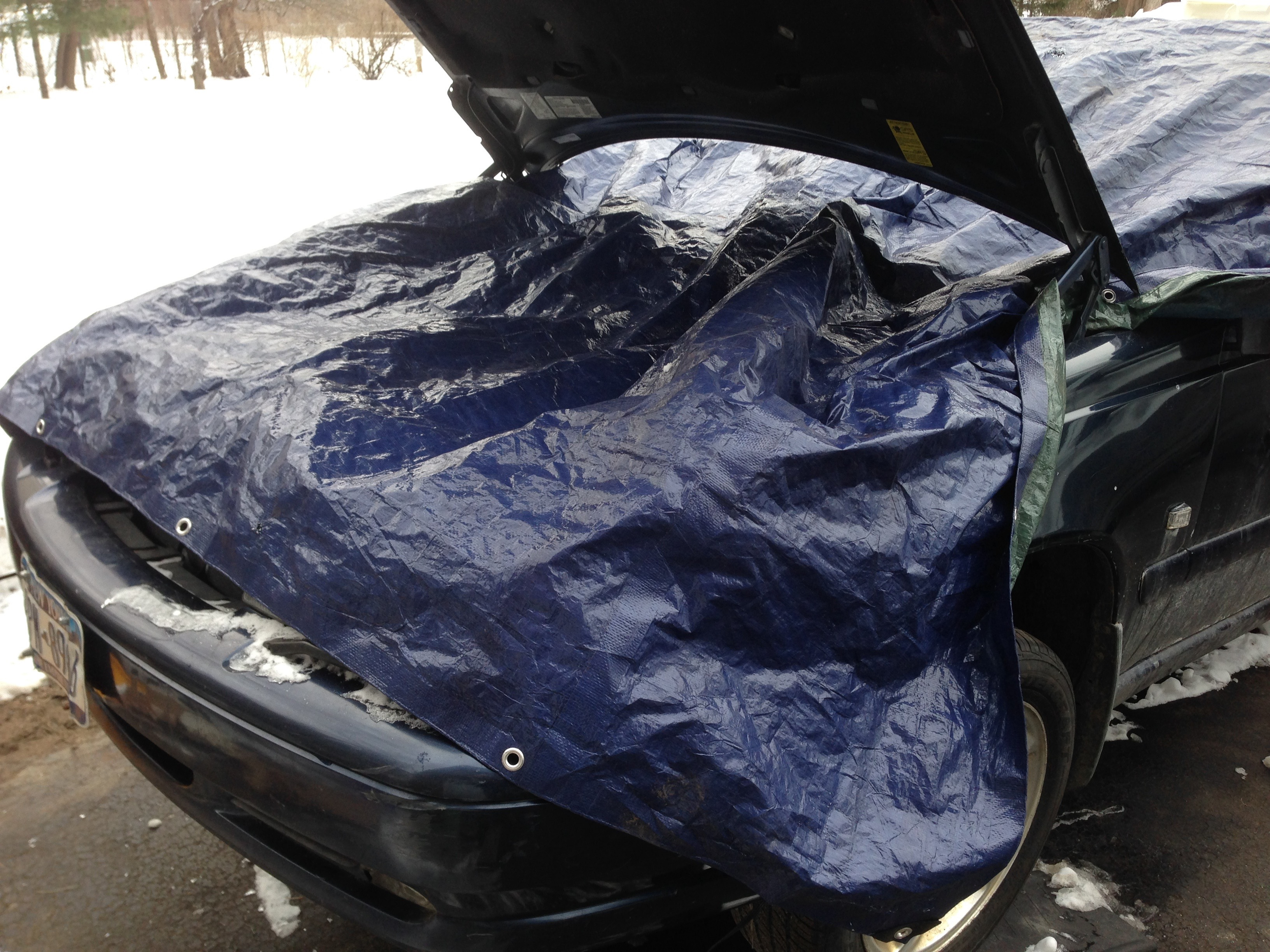

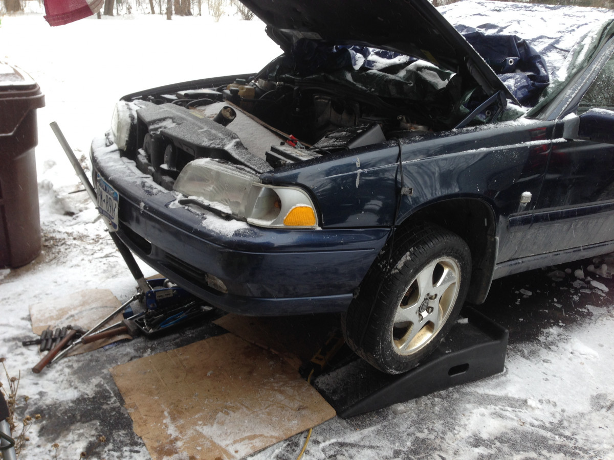

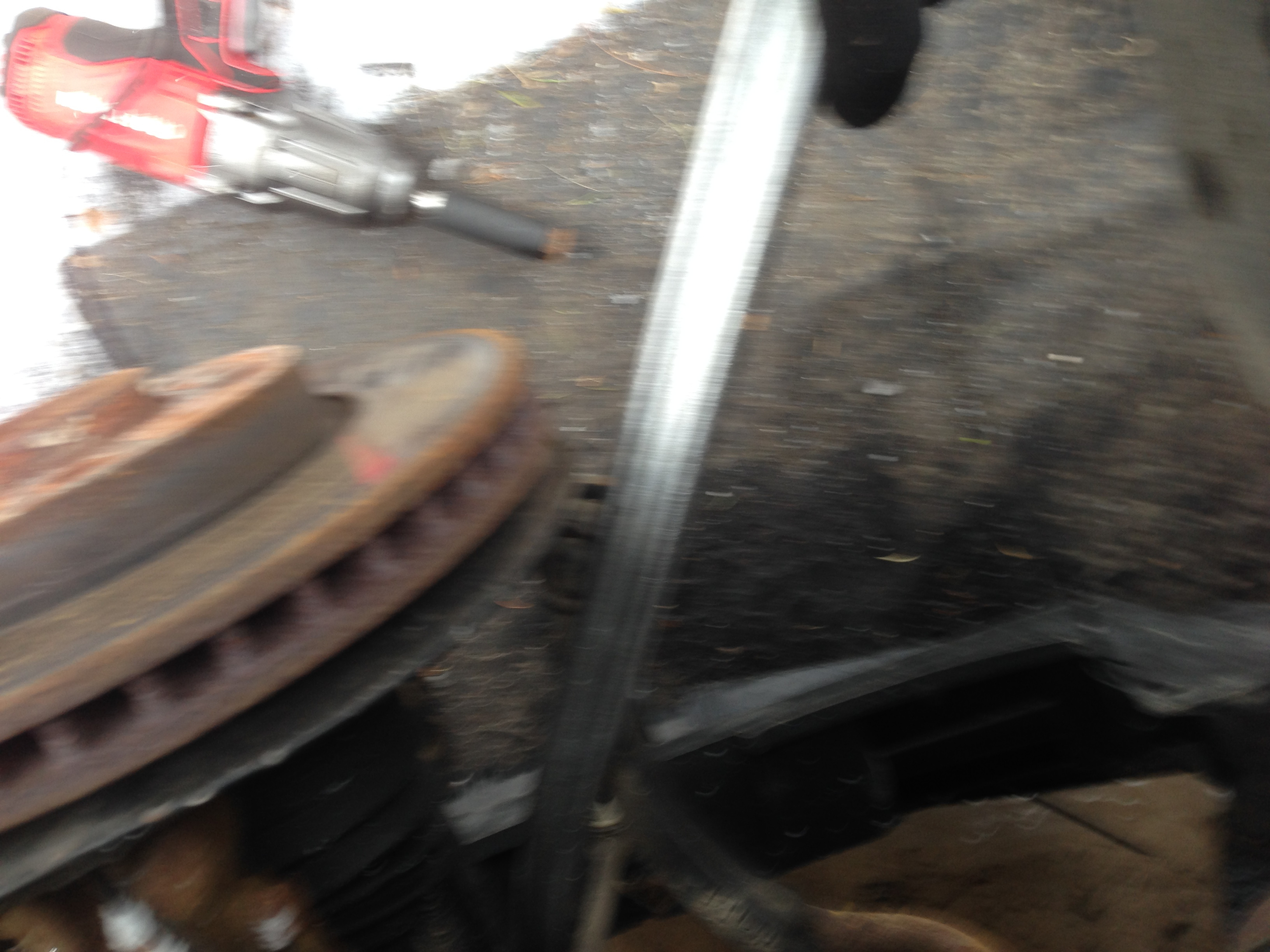

Worked on the rack today
15 mm nuts came off the bottom of the rack with the small impact
18mm Tie rod ends with the big impact, used the HF tire iron trick to tension the right one when the tie rod end started spinning
The 14mm rack to mount bolt is still tight - put some heat and PBB on it to return
Also heated the two PS line flare fittings in anticipation of cracking those off soon.
Released the wire clip and the steering shaft fitting - 10mm hex head bolt into a 13mm hex head nut
After one hour both my propane and sharpie froze - signs I should be inside - another Sharpie showed up though

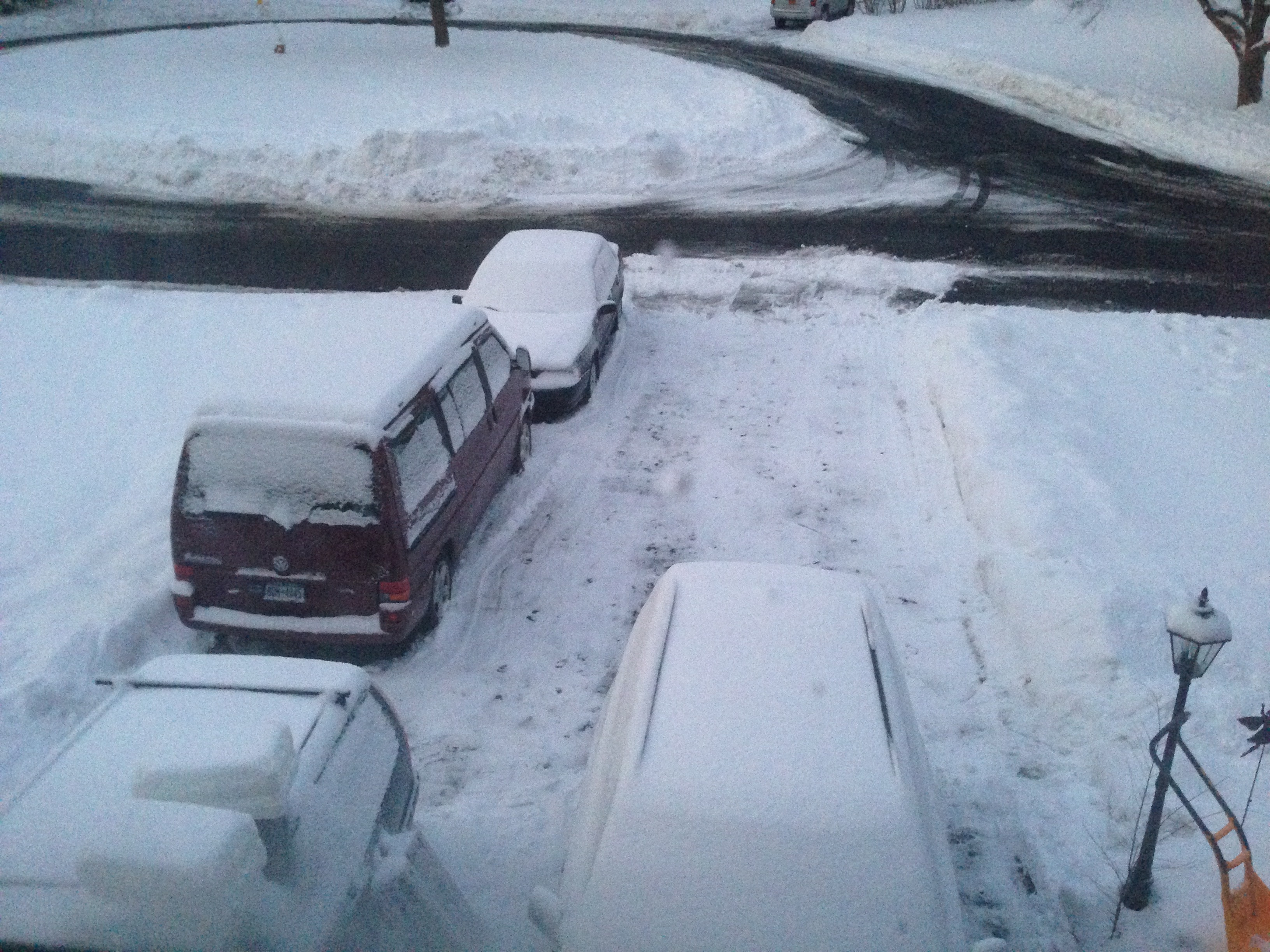

Weather nice today
Couldn’t get power steering lines moving from unions
Do not have rack separated from column yet
Hung engine on frame, removed rear subframe screws and brackets, removed two m8 from engine mount, front torque rod
Dropped subframe in rear about 3 inches
Good access at unions , should come off easily
Rack is free on left side of car, still feels tight on right side
One hour
One hour

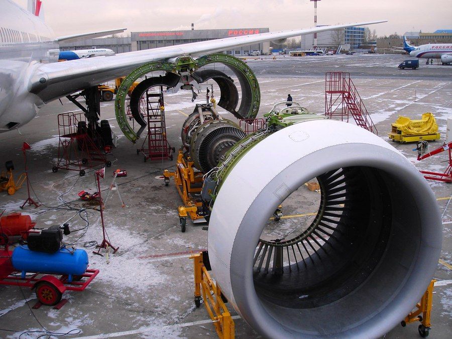

Similar to our own Abscate, they also replace troublesome 777 engines out in the snow.....
- Posts: 6357
- Joined: 30 Dec 2014, 10:45
- Has thanked: 317 times
- Been thanked: 531 times
That looks like fun!BlackBart wrote: 22 Feb 2021, 18:09 Similar to our own Abscate, they also replace troublesome 777 engines out in the snow.....
