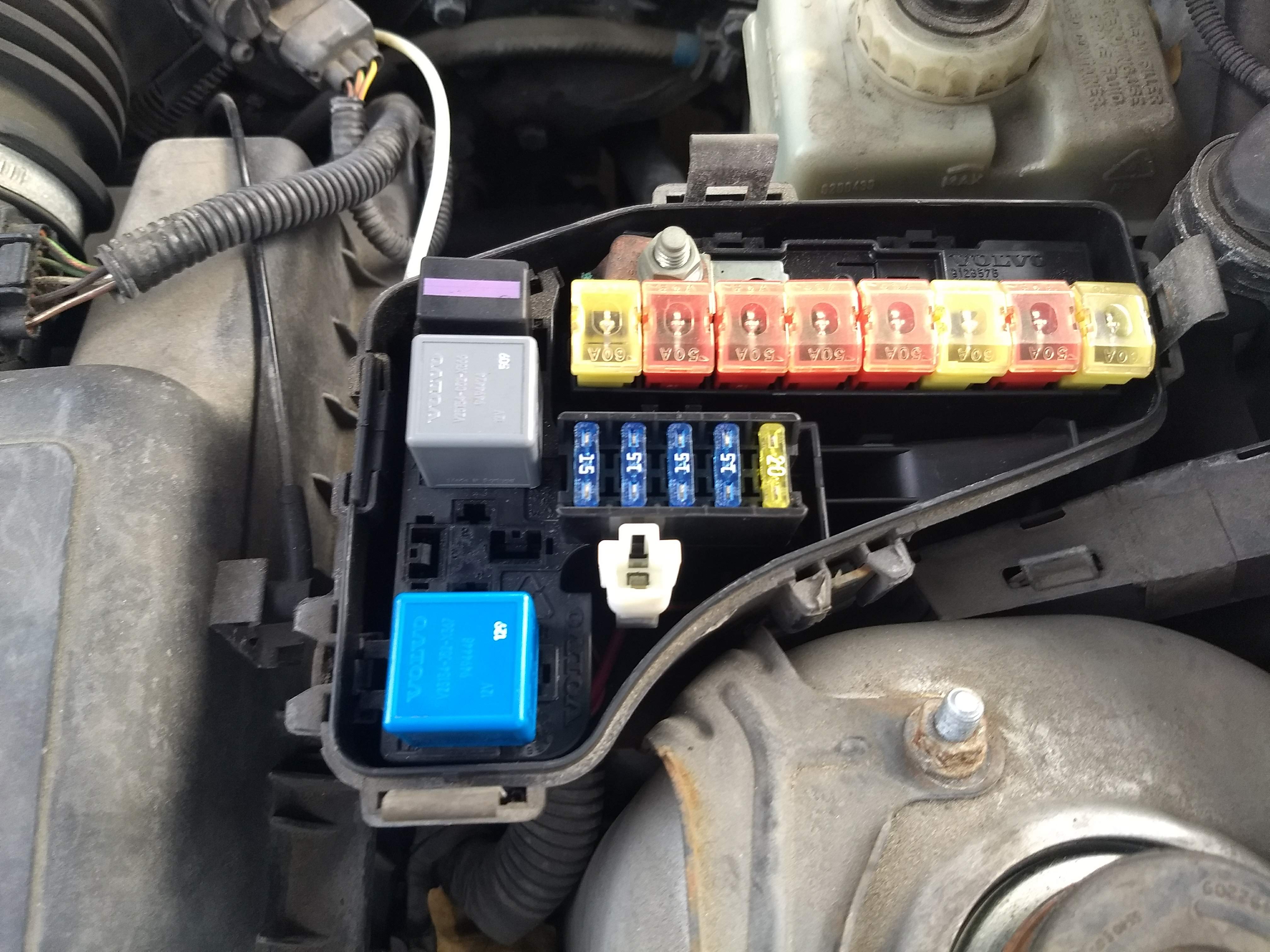

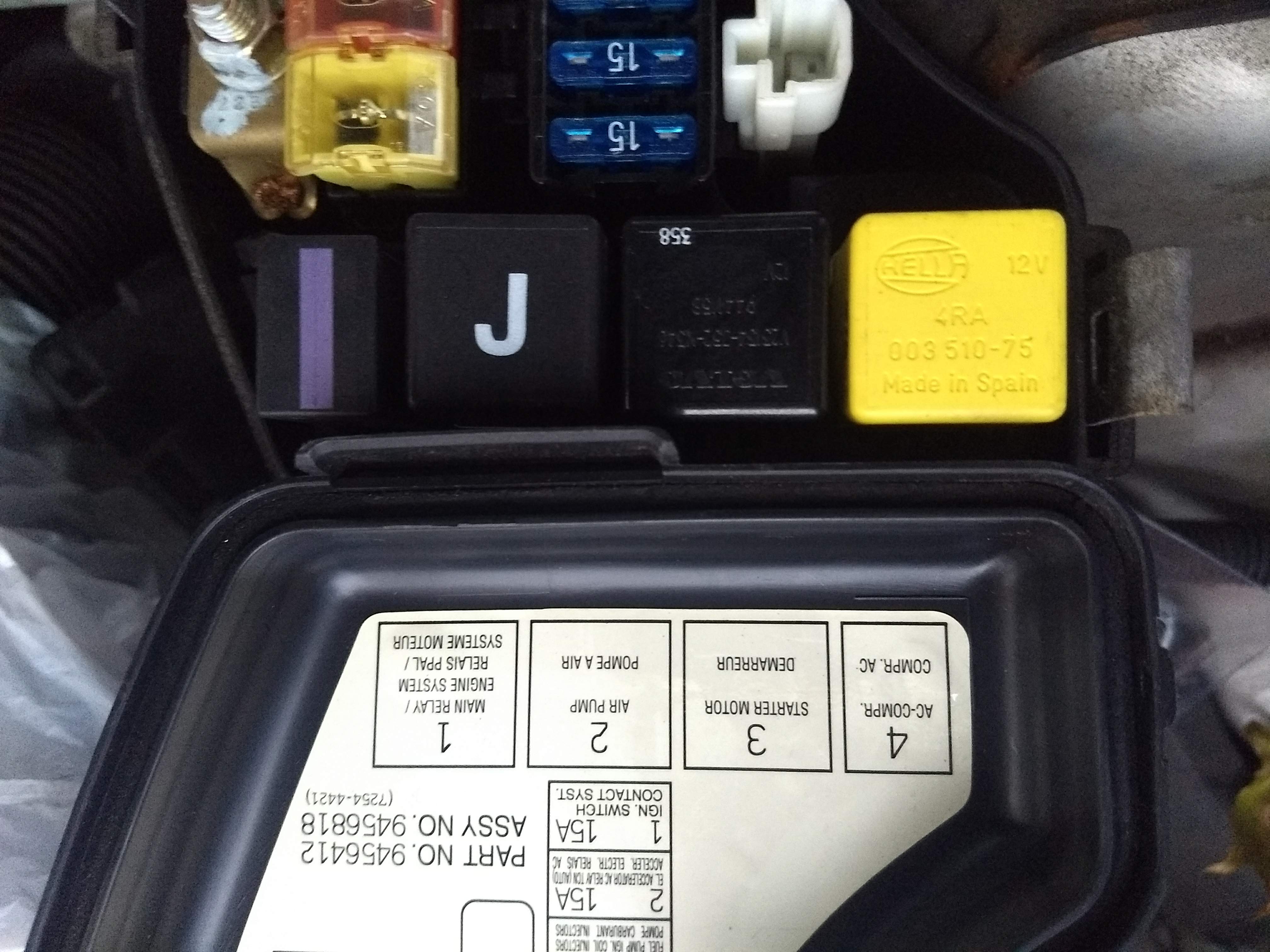

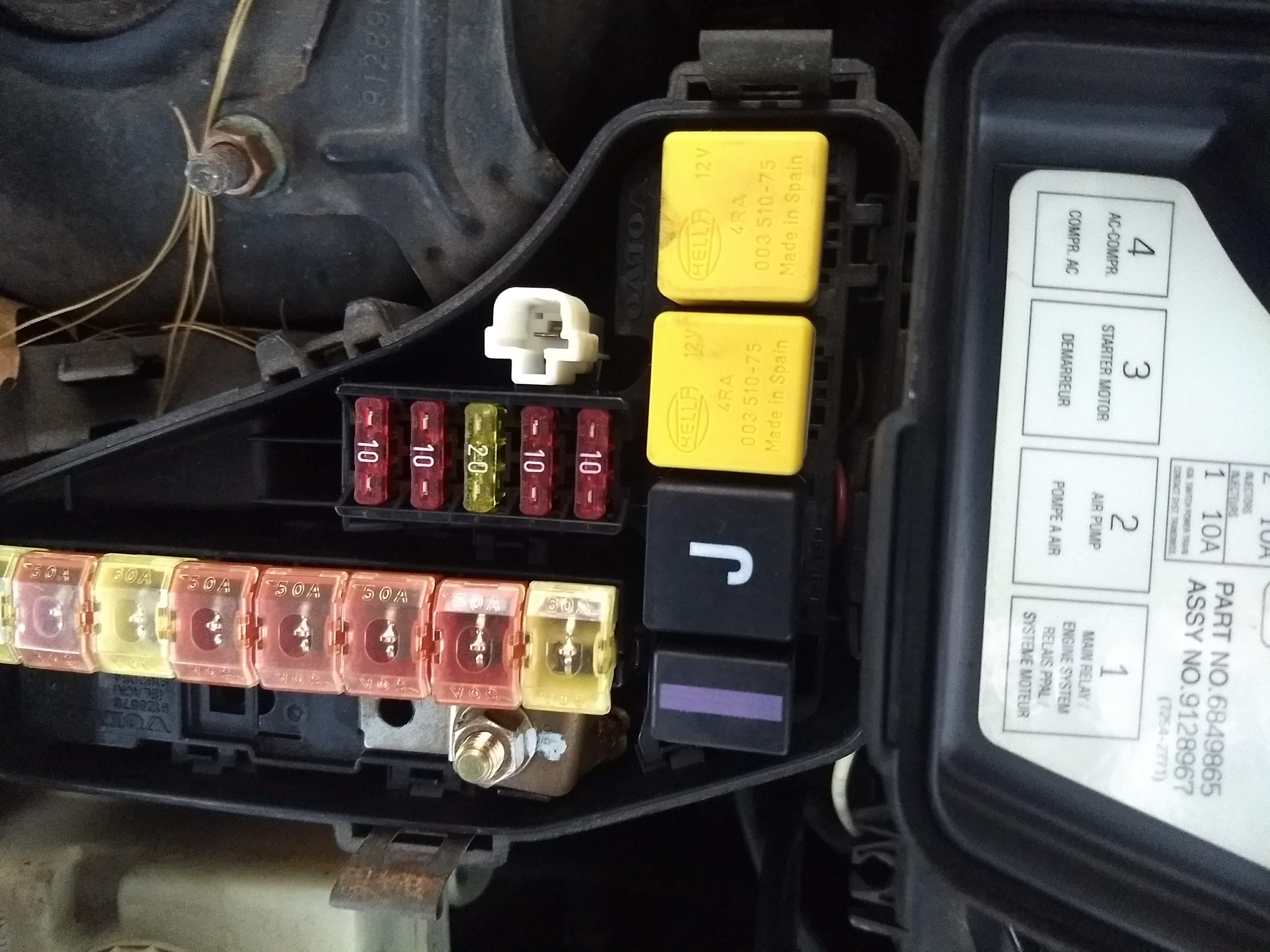

Thanks, gents! The remote starter wire has ~12.6V, central locking fuse looks OK, and the rear hatch wires appear intact. I was looking at this thread, which suggests checking the PNP switch next: viewtopic.php?f=1&t=86888&start=10bmdubya1198 wrote: 01 Dec 2018, 07:44I would definitely recommend at least checking that wiring anyway. I didn't have anything more than a funky trunk lock (wouldn't disable the alarm if I unlocked with the key) on my GLT and I had multiple cut wires back there.abscate wrote: 01 Dec 2018, 01:30 Bruno...completely forgot to point you to the rear hatch wires as a potential cause for a no crank. Check Fuse number 6 ( maybe?) for central locking and see if it's blown. Tha one goes when the wires in the hatch hinge break on driver side, and will lead to a no crank.
Also, I looked at the '99 V70XC and the '98 V70 relays and discovered that they were different part numbers. When I looked at the '00 V70, I found that it had no relay in the starter position — and yet it starts like it's brand new. What gives!?

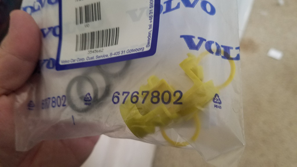

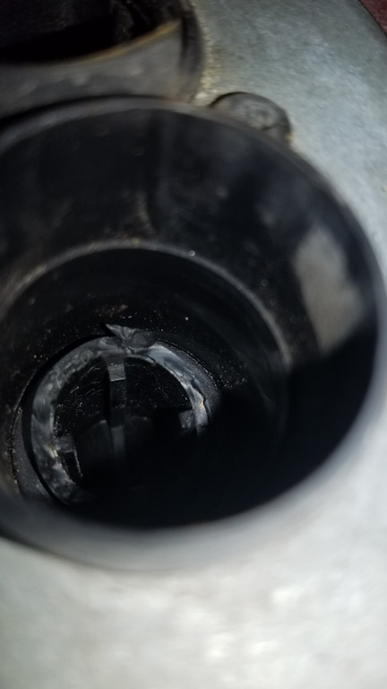

Finally got some time to undo my heater core bypass and get some heat back with the whole winter thing happening. However I ran into a snag. My buddy bypassed the heater core some time ago and all he could tell me was that the clips disintegrated. I bought new clips and found that the lower port will not "snap" in place no matter how hard I push. I took a picture with my phone and I don't believe I see any "sleeve" with slots for the clips to snap into. The top port does have the sleeve so I think maybe it came out with the clip when he removed the hoses. Can some confirm this?
