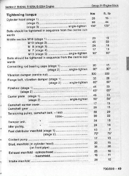

Greetings! I will be installing the camshaft cover today and have come across two different sets of numbers for torquing the camshaft bolts - 5.1 foot pounds and 13 ft lbs. Which is correct or is there yet a different number? (Most references are in inch pounds, but with the conversion - 12 inch pounds to 1 foot pound - the result was one or the other number above.)

All data says for my 1999 torque from inside out at 17 Nm...thats closer to the 13 foot pounds but maybe the 1999 is different? ( I don't think the mechanicals are)

I recall 7nm or 5.16 ft/lbs for the cover bolts. Less is more. The correct anaerobic sealant does a lot of the work here too. 42 of them have a huge combined force.

Here is another reference, for 850 turbos that recommends 13 ft lbs.
http://www.volvotips.com/index.php/850- ... ce-manual/
Same motor as in the '98 V70, correct?

Let's get someone to pull the number from VIDA
5rivers...I think the important thing is to remember to work from the inside out so that the cover is flattened as you tighten
13 ft lbs is light torque..indeed the sealer is doing the work here.

Got something more definitive from the Volvo 960 pocket book (a factory resource for basically the same whiteblock engine)
It is indeed 17nM or 13 ft/lbs
