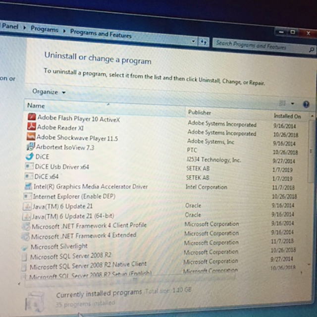

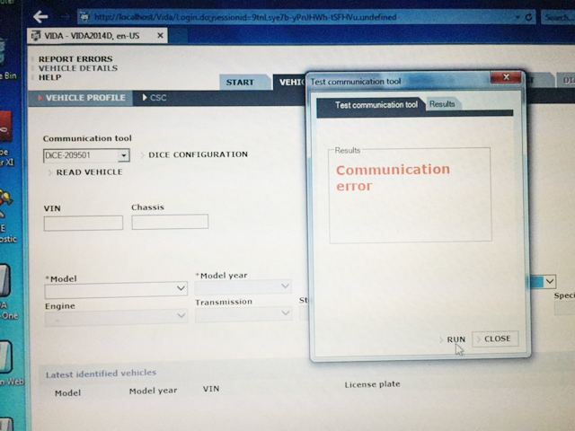

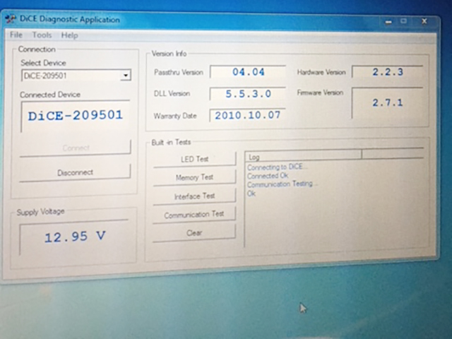

Thank you Rick. I'll give it a try.RickHaleParker wrote: 29 Dec 2018, 08:41Rerun the DiCE install X:\3PP\Products\DiCE\xHeart wrote: 28 Dec 2018, 17:22 However, DiCE connects fine over USB using DiCE admin tool. I'm suspecting, the VIDA/DiCE conduit is lost during the update -- it will take debugging.

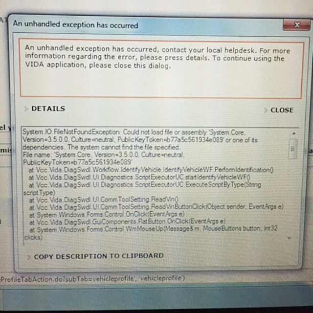

Ran DiCE Setup. Unsuccessful with VIDA/DiCE communication. READ VEHICLE fails too "An unhandled exception has occurred"...RickHaleParker wrote: 29 Dec 2018, 08:41Rerun the DiCE install X:\3PP\Products\DiCE\xHeart wrote: 28 Dec 2018, 17:22 However, DiCE connects fine over USB using DiCE admin tool. I'm suspecting, the VIDA/DiCE conduit is lost during the update -- it will take debugging.

Does this "Unhandled exception..." requires removal of .Net Framework 4.0 and installing of .Net Framework 3.5?
