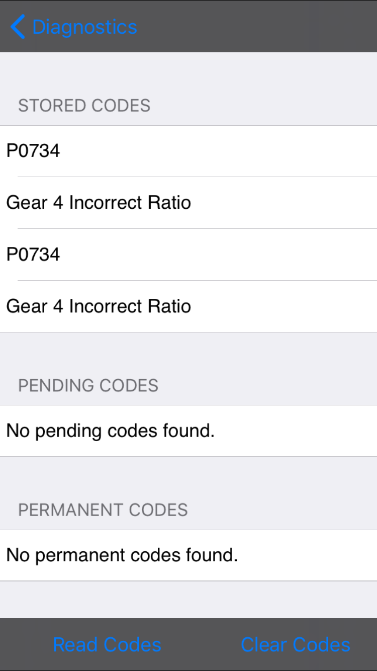

This is what my filter looked like. Also had the classical whining pump noise from being starved.
Worth to mention though is that this was caused by broken hard parts that caused one clutch pack to burn up.

It took a long time before any codes showed up.

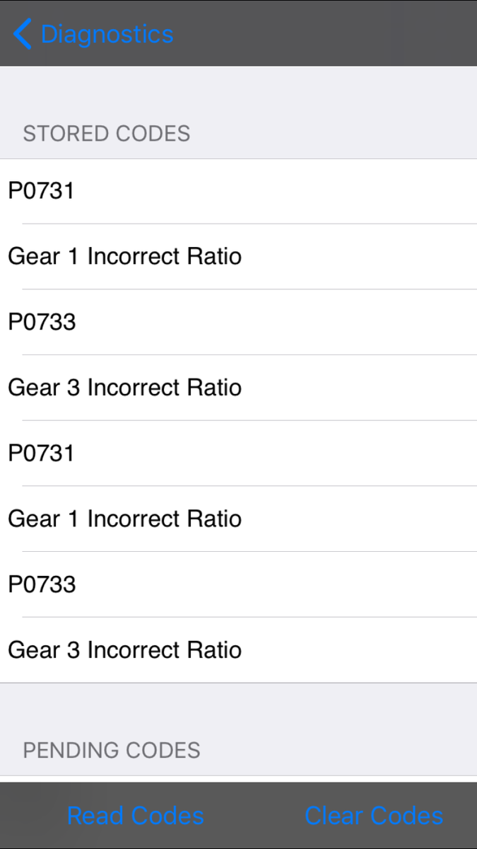

Well now it's not working again but at least it moves. I got 60 miles of driving with it. But now it's stuck in 2nd gear and transmission errors P0731 and P0733 and P0734 1st, 3rd and 4th gear range errors.
I recently purchased an actual full flow inline transmission filter that I will put in line with the transmission cooler. And then I'll also try another drain and flush and perhaps punch even more holes in the internal filter.

Personally, I would find a used transmission or sell the car. No amount of fluid is going to fix the hardware damage. Why put more money into it.vt9000cse wrote: 10 Nov 2017, 07:58 Well now it's not working again but at least it moves. I got 60 miles of driving with it. But now it's stuck in 2nd gear and transmission errors P0731 and P0733 and P0734 1st, 3rd and 4th gear range errors.
