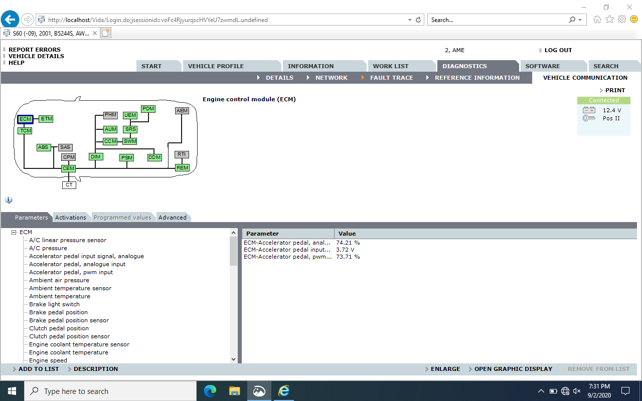

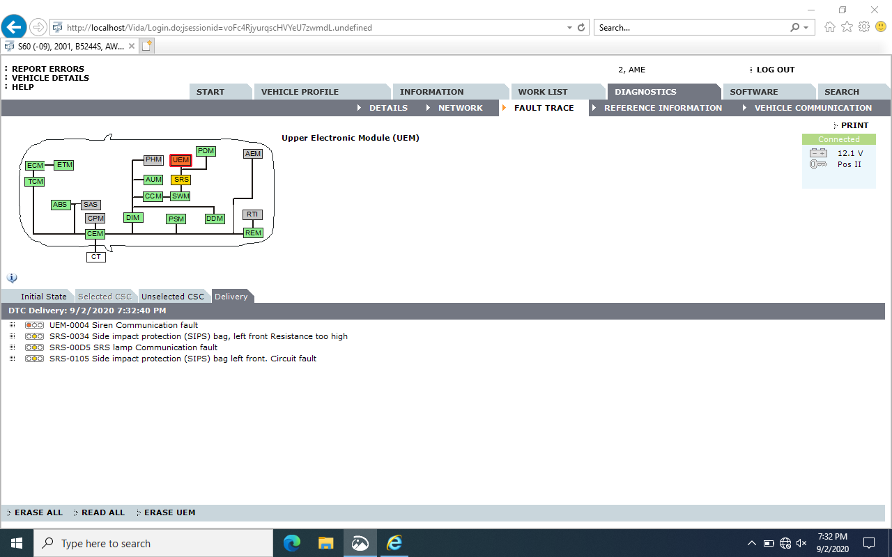

Here's some more screenshots, that may or may not be helpful. I had to press the gas pedal to the floor as hard as I could to get the numbers shown in the screenshot above.

Just looking at those, I think your gas pedal may be a problem. Only 74% floored? That's not right.
That would explain the seemingly good ETM test, as well as the log you posted before with the graph all over the place. I think it's a pretty safe bet to replace the gas pedal.

Is there a contactless rebuild kit available for the gas pedal?
I'll try to check the numbers again when the car is running, and see if the numbers jump around on their own while watching the throttle angle value to see if there's any kind of similarities.
I've been emailing back and forth with Joshua Dunning (a really nice guy), from XeMODeX, who is trying to help point me in the right direction to fix the car also. He thinks it's either an air leak at the intake, or an electrical issue, but that was before I did the pedal test, out of curiosity, and sent it to him to look at, plus some other questions he asked me that I answered. I should hear back from him tomorrow.
