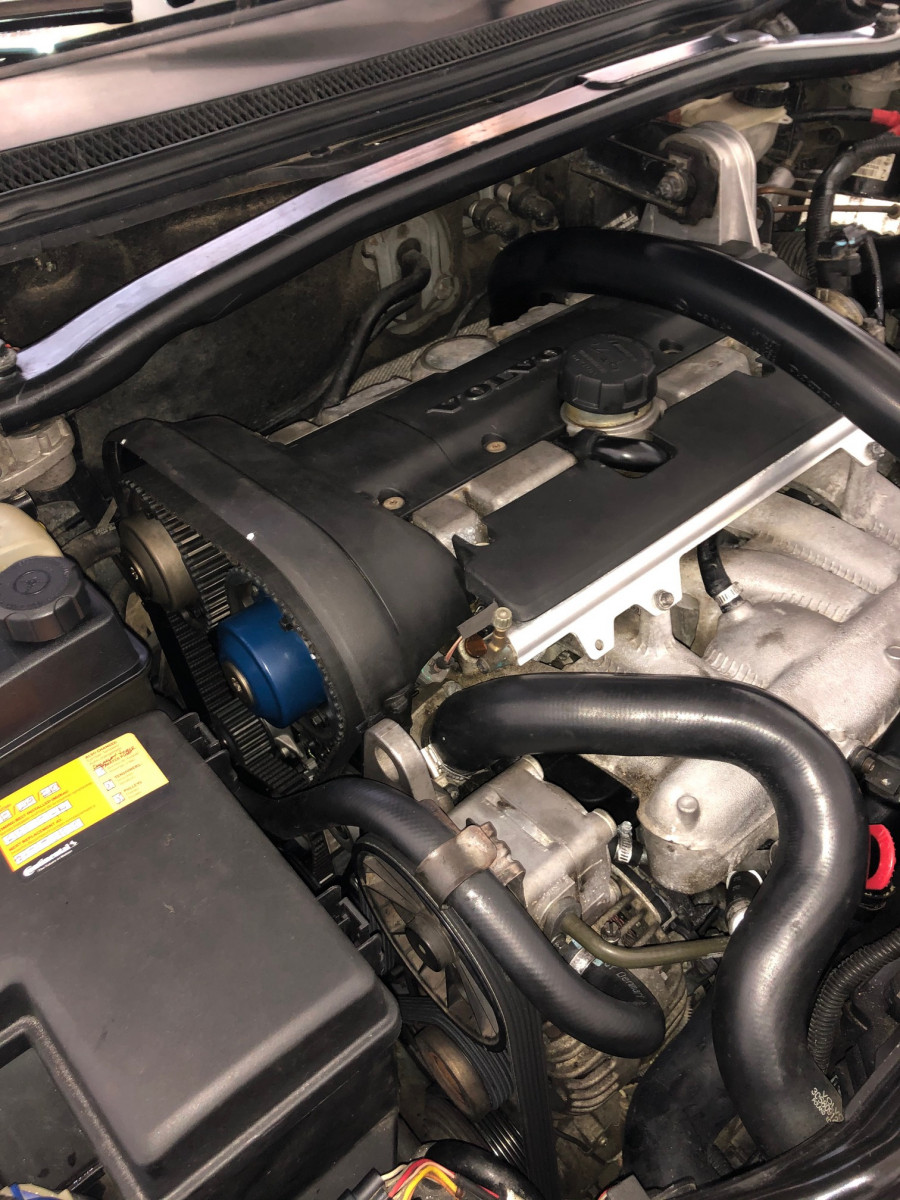

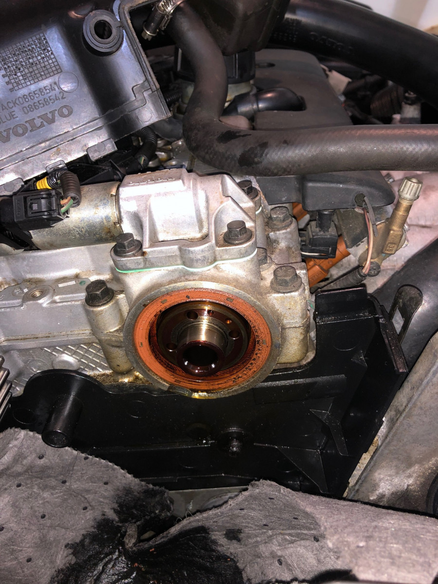

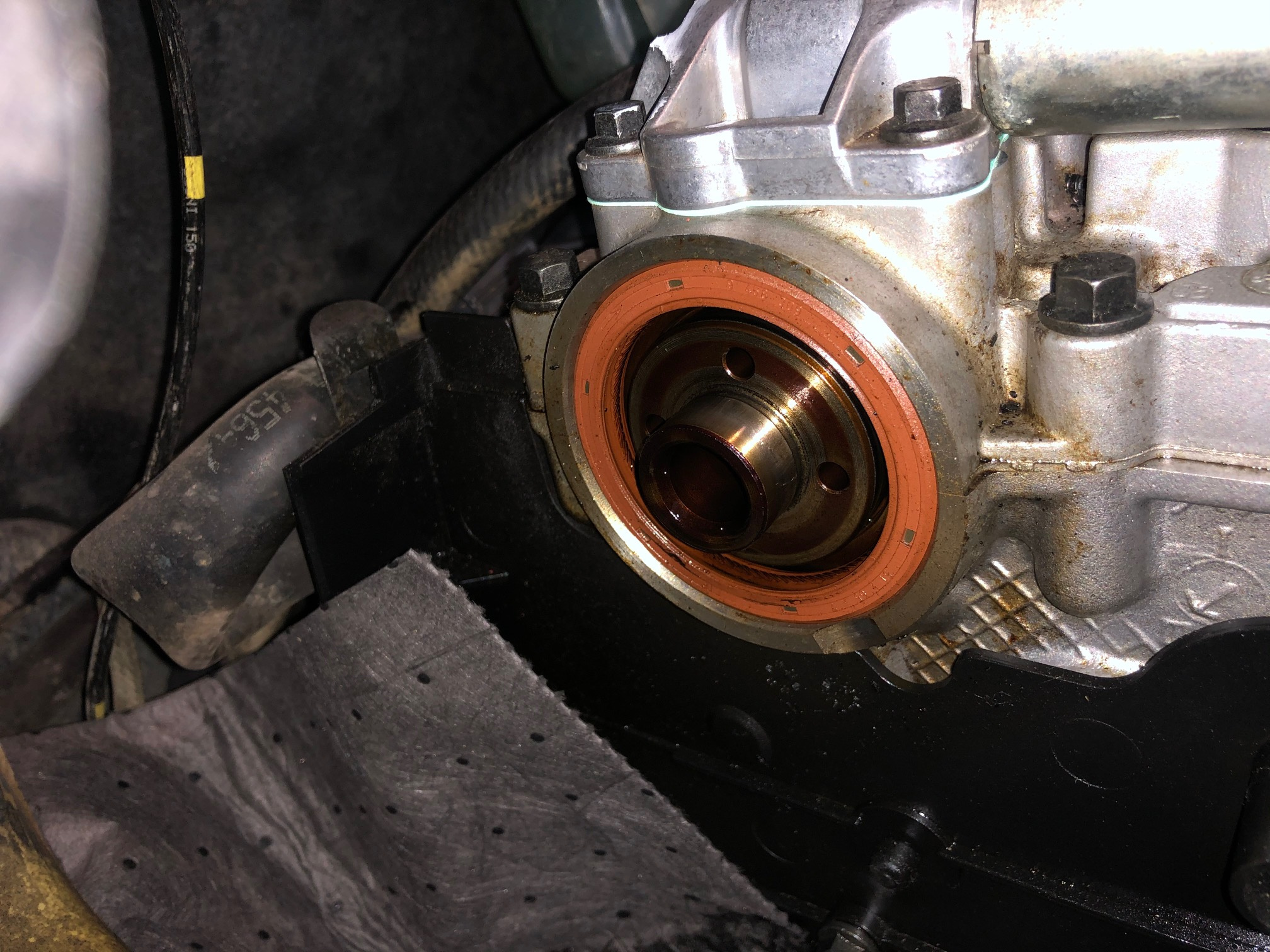

Everything went smooth yesterday. I referenced the great information here and the instructions on my Vida. The replacement “previously owned” hubs were already setup correctly. So basically going through the setup I ended up in the same position with the hub slides in relation to the gears. My exhaust hub had 3mm of axial play and just felt sloppy, so I replaced it as expected. I replaced the intake hub as well mainly because I spent the time to clean up the donor before starting this. I put new gaskets on the hubs which I got from FCP. Installation of the Cam seals were straight forward made easy with the tool. They go back into proper position, no worries there. I will say the old seals were a pain to get out with the tight space. You don’t have a lot of room to drill a hole in them and installing a screw. I just pried them out with a panel popping tool. I do use a Cam locking tool I got from FCP, as a matter of fact in the 5 months owning it I’ve used it a bunch tracking down my leaks and doing maintenance. Well worth the 100 bucks plus piece of mind. Time your crank, lock your cam’s = a happy day. Moving on, it appears my Cam seals were leaking. I’ll add some pics. Everything is back together, no leaks, no codes. Well, I do have two codes I created, an aftermarket stereo and I disabled the headlight washers. Time to move on to those leaking power steering crossover tubes.
