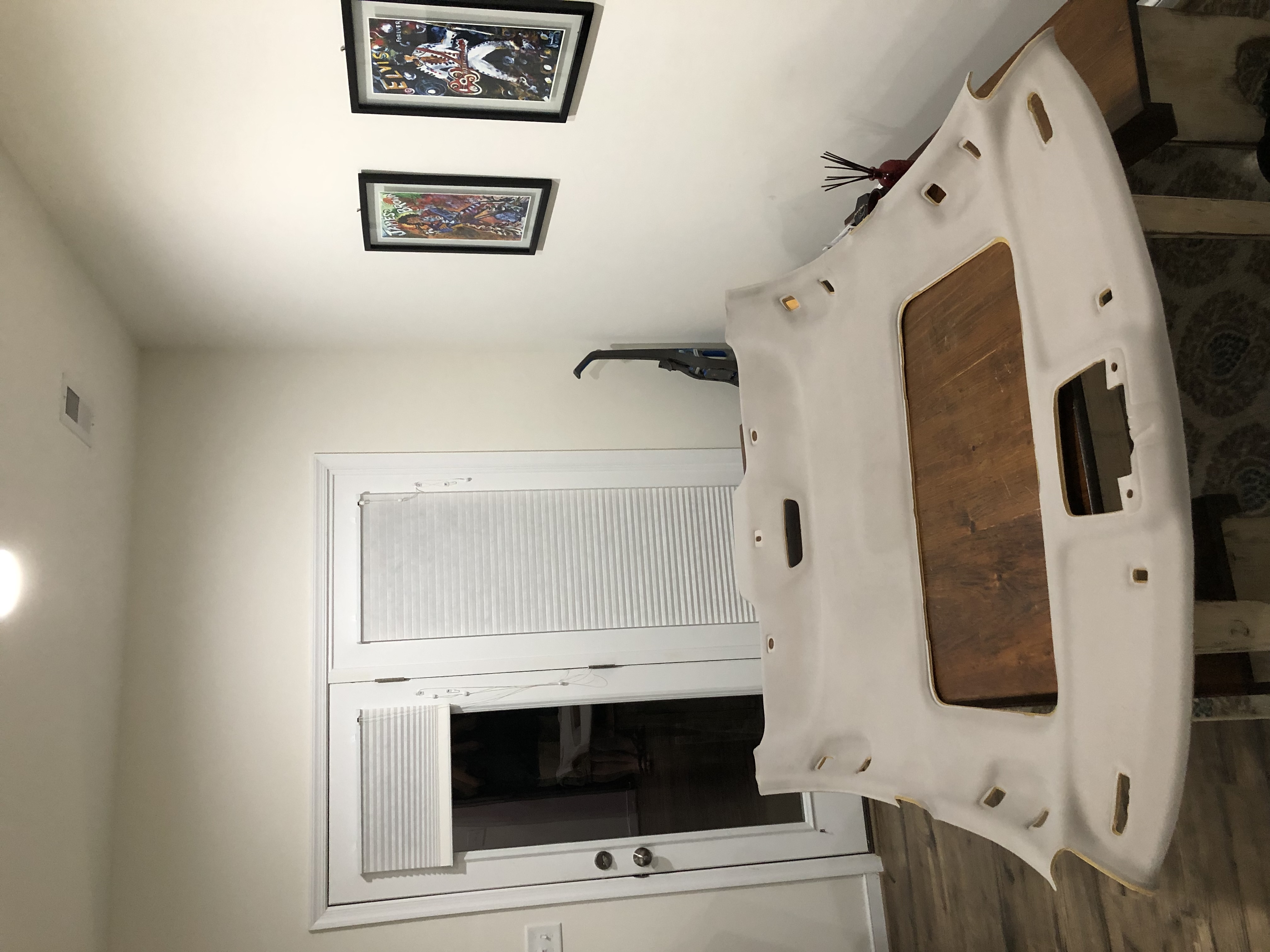

Finished work a little early and went by the pick a part to check out a new arrival. 2002 S60. I wasn’t dressed for a junk yard adventure, but I ended up grabbing a headliner in real good condition. It just needed some cleaning which I just did. $10.99. Mine is coming out this weekend.
