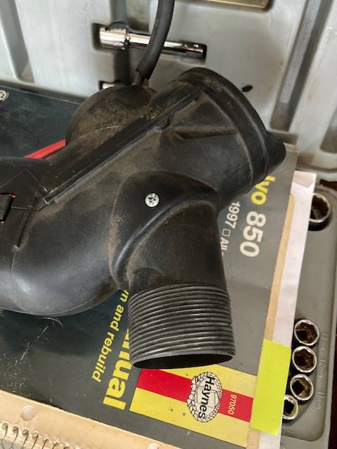

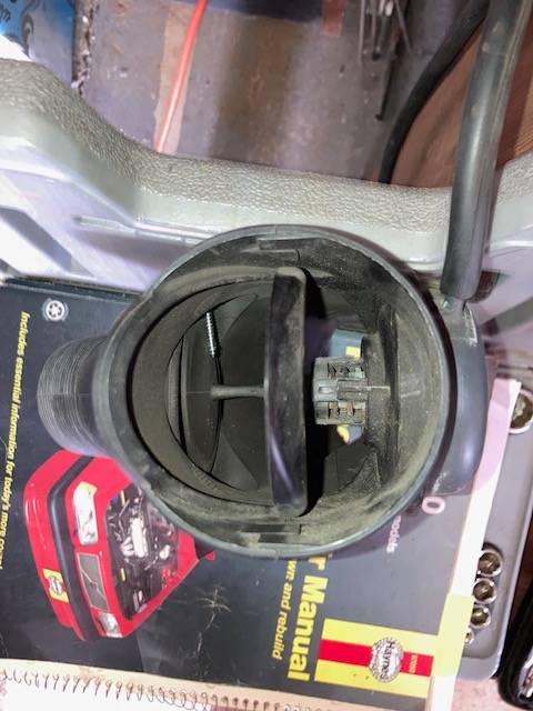

Thanks to all for this thread. Modified it to cold air only on daughters daily driver 850 GLT non-turbo. Drilled pilot hole in case and threaded screw in to hold hot flap closed. Note: just read mileage from ECU and its at 300,250. Goal was to reach 300K. Everything is gravy from here on!
