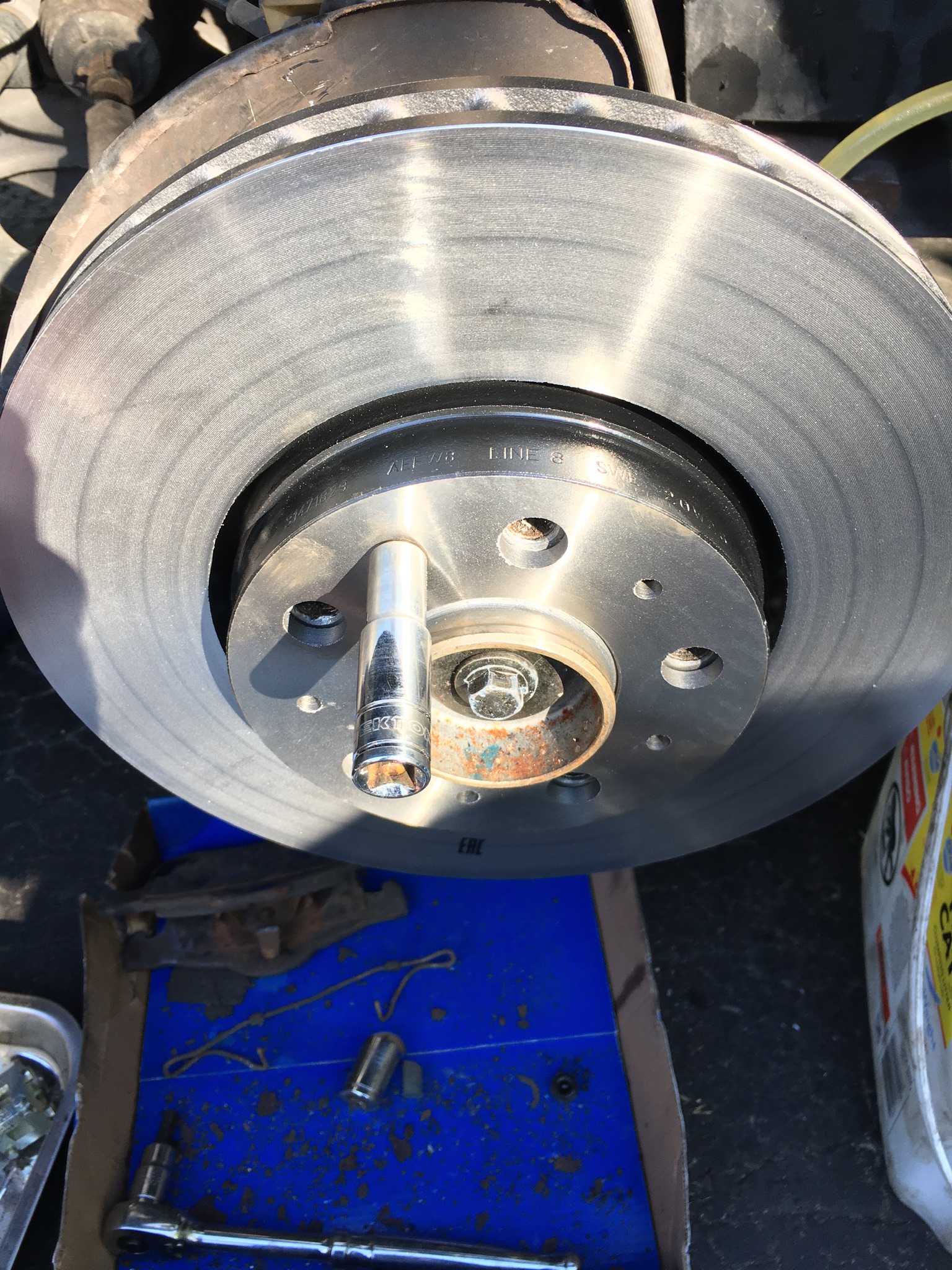

Posts: 35282
Has thanked: 1500 times
Been thanked: 3812 times

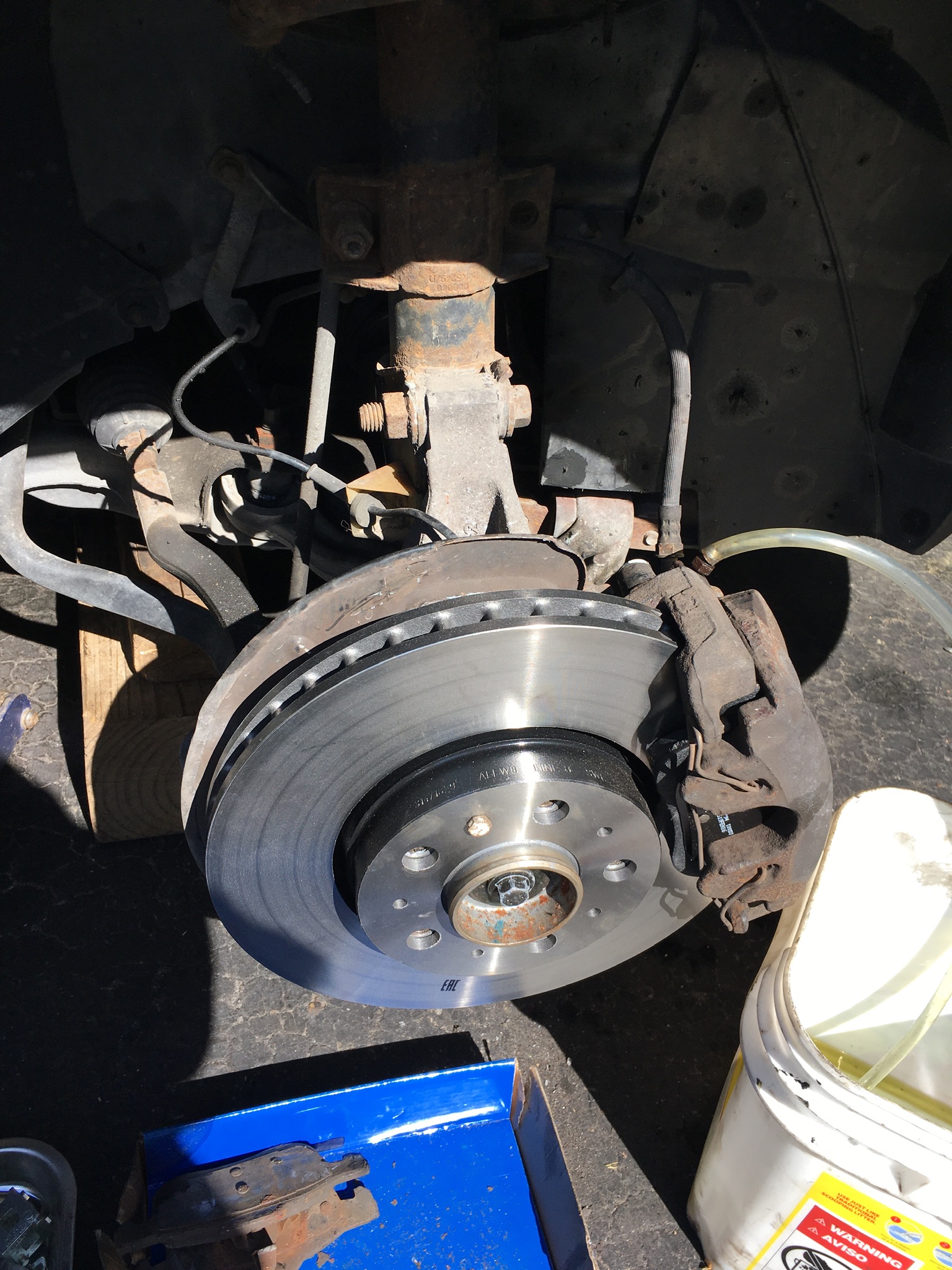

Ripped off a quick front brake job on Catherine the P2
50,000 on these. It looks like the right front caliper is sticking, will have to watch it
Control arm bushings shot. , need new ones

Post by kcodyjr »

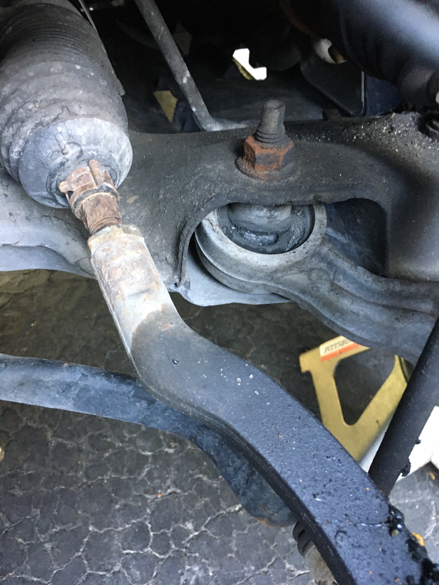

Both front control arms.
What a PITA that is on a 2006 S60... Done without removing the knuckle. Used a jack to lift the knuckle so as to not overstretch the new control arm bushing when getting that ball joint stud through the hole.
Still, a royal PITA. Next time I'll do it by taking out the knuckle, even if the tie rod end ball-joint bolt does look as rusty as the Titanic...
Had the brake dust shields out for that, so they got a nice spray-down with brake cleaner, and then installing new rotors was as easy as a new fuse after all that. Still waiting for rebuilt calipers to complete the reassembly.

kcodyjr wrote: 17 May 2021, 22:20 Both front control arms.
I was able to reseat the balljoint stud in the control arm by removing the large upper knuckle to strut clamp bolt, then loosen the lower bolt so the knuckle can pivot. Ratchet strap pulled the control arm down as far as possible.

That’s clever. You can even c clamp it closed again when done.

jonesg wrote: 19 May 2021, 09:22 I was able to reseat the balljoint stud in the control arm by removing the large upper knuckle to strut clamp bolt, then loosen the lower bolt so the knuckle can pivot. Ratchet strap pulled the control arm down as far as possible.
I like it. That way, the axle bolt doesn't have to come out.
Next up, I get to R/R all four brake hoses. I don't suppose there's any bookies around here that wanna take bets on whether that goes smoothly?
