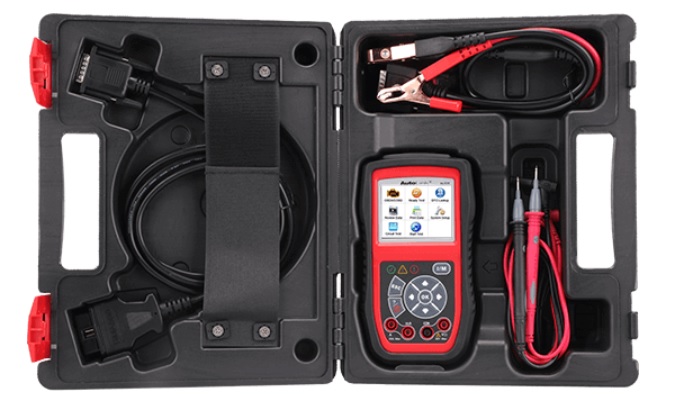

MVS Readers,
I bought my S80 a Christmas gift (actually it will work for all of my vehicles but don't tell the S80)
Autel 539B Diagnostic tool
This tool has a lot of capability
I purchase it because of the Mode $06 data, and I don't currently have any tool that will show me this data.
Here is an example (actual data from my S80)
Misfire counter
EWMA = Exponential Weight Moving Average (This is effectively the average for the last 10 times you started the engine)
Last = The most recent time you used the engine (if you check the data before you start the engine it is the number of misfires from the last time you started the engine and it resets to zero as soon as you start the engine)
Here is my data for the S80 that I collected before starting the engine
Cylinder..........EWMA (counts)..........Last (counts)..........
Cylinder #1..............1.........................0..........
Cylinder #2..............0.........................0..........
Cylinder #3..............1.........................0.........
Cylinder #4..............0.........................0..........
Cylinder #5..............0.........................1..........
Cylinder #6..............1.........................1.........
These are obviously very low misfire counts.
Full disclosure you have to go thru the menu for each cylinder and select the EWMA and then go back and select the Last.
For a home mechanic that wants to check to see if things are working optimally this tool is amazing.
If you are repairing cars full time this tool isn't going to give you access to the data the way a $5K took would.
But for the price this tool is amazing
Go to 3:00 minutes in this Video to see how the tool works
Take care
Paul
PS when the tool asks if you want to delete old data say No

- Posts: 35284
- Has thanked: 1502 times
- Been thanked: 3817 times
Link to Amazon via the MVS BUTTON
https://www.amazon.com/Autel-AL539B-Sca ... 165&sr=8-3
does that model Also support ABS and SRS module reading and clearing?

ABSCATE,
The is an excellent question.
My understanding is no it won't do that.
When I did my research I was looking for a tool that would use the ABS pump to bleed the brakes and I did find an Autel tool that would do that but the cost was higher and it didn't include a lot of the features that the AL539B has. Notably the Battery checking tool and the Starter checking tool.
I will post some information about the Starter checking function. (Short summary: my S80 starts in 0.6 seconds and my LR2 starts in 1.2 seconds, I think this is because the Land Rover doesn't pre-charge the fuel system like the S80 does, the negative effect of this is the shorter life of the starter, my LR2 starter died after 10 years and I couldn't find examples of Volvo 3.2 starters that failed in this time frame, there are many LR2 examples)
Thanks for the question
Paul

MVS Readers,
I hooked up my Autel AL539B to the Volvo today to measure how long it takes to warm up the Engine to 40C.
2010 S80 3.2 time to warm from 11C to 40C
----------2 Minutes and 56 Seconds----------
2008 LR2 3.2 time to warm from 12C to 40C (the Land Rover was in the sun)
----------2 Minutes and 35 Seconds----------
So basically the same.
The 40C is relevant because the Engine Control System behaves differently below 40C.
The important take away is that if your 3.2 or 3.0T can't do this then replace the Thermostat.
I've replaced the Thermostat on both of my 3.2's
While I was in there checking the time to warmup I noticed that I had a pending code on the S80.
Read the next post to find out more about the pending code...

The scanner that I bought is so nice, as soon as I connected it it gave me a yellow warning. (Which is why I decided to do this today)
