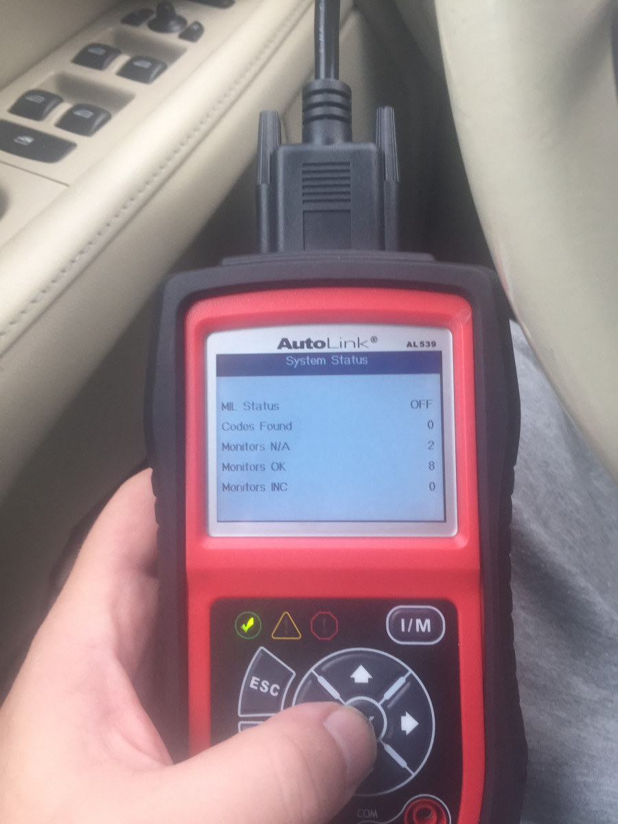

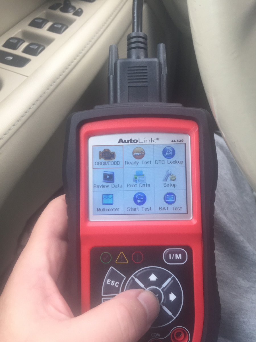

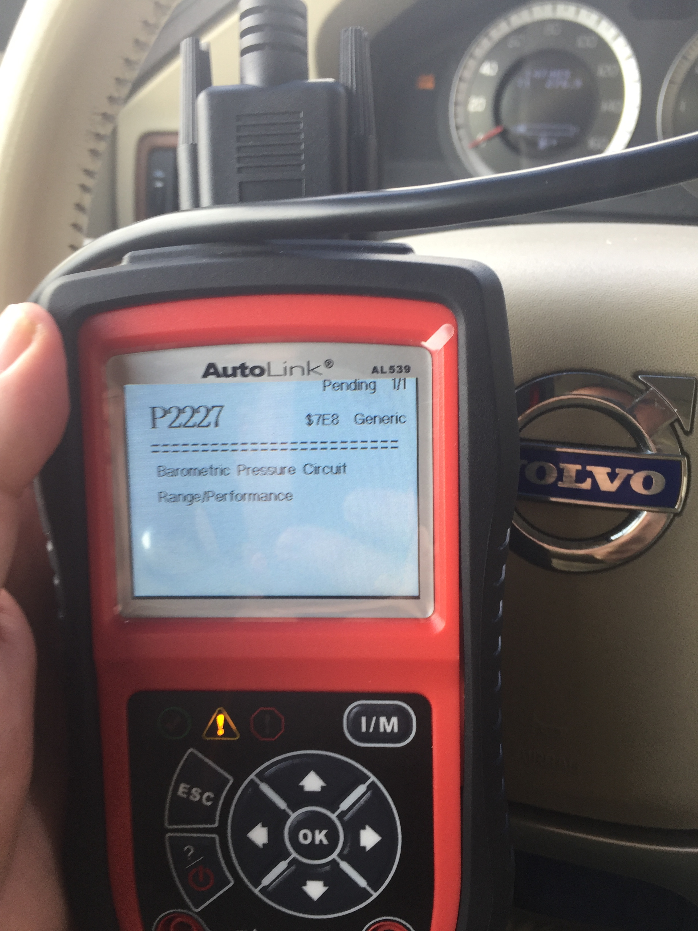

MVS Readers,
I wasn’t fast enough to show the Warning LED on my Autel AL539B. The pending code is gone after just a few engine starts.
What I can show you is the Green check mark that says everything is good now.
GREEN. - no codes
YELLOW- pending codes MIL IS OFF
Red - codes set MIL IS ON
Here is the home screen and you have to press OK to get to the next screen
Now you can see the GREEN CHECK MARK
Thanks
Paul

Don’t take those code reader descriptions literally until you fact check them. They are the Fox News of auto diagnostics.
Someone just writes some text in the PROM that they think sounds good.

MVS Readers,
The point that ABSCATE is making is valid.
The Generic Code Reader like the one I purchased will show a code that can help point you in the right direction but I agree with the recommendation to do some research and don't just point the parts cannon at the engine bay.
Having said that I recommend the following
1. If you know that something is broken or suspect it is and you get a code for a component related to the anomalous condition then replace the part needed to get you back to original design intent.
----- Examples
-------------Broken connector latch (if a connectors slips off without pressing the latch)
-------------Ignition coil (if a coil smells or looks different than its friends replace it)
-------------Vacuum pump oil leak (fix it before it causes Transmission module problems)
2. The Check Engine light only has to be illuminated if the vehicle can't compensate for an anomalous condition sufficiently to guarantee that it will meet emissions requirements. This is where the factory tools (VIDA/DICE) are superior they will provide you with more information. But don't underestimate the value of a generic scan tool and motivated owner. A service technician isn't going to drive your car thousands of miles but it is very likely that you will.
3. If other P3 owners are experiencing failures I recommend that you replace things proactively. Just consider it Maintenance that Volvo forgot to add to the list. Examples: Thermostat and the small hose next to it, Radiator Fan, Cooling system hoses, Alternator Brushes, HVAC Blower, Starter Motor Solenoid, Suspension Bushings, Exhaust hangers, Throttle Body cleaning, Intake Manifold Gaskets, Leak Detection pump filter, etc...
Take care
Paul

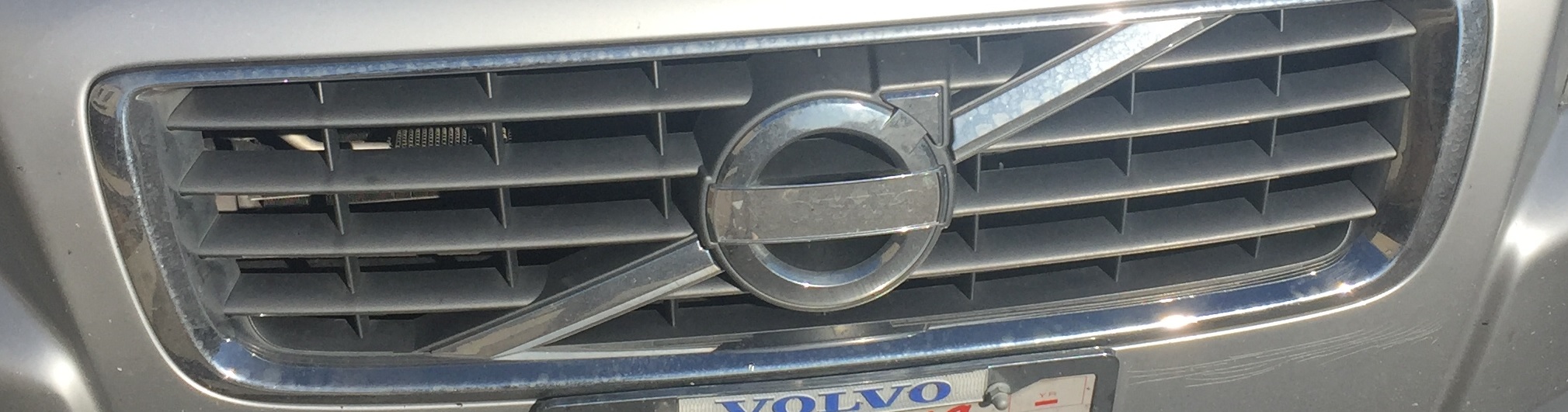

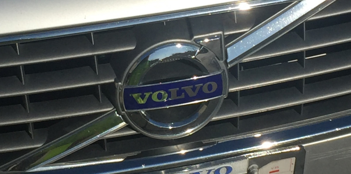

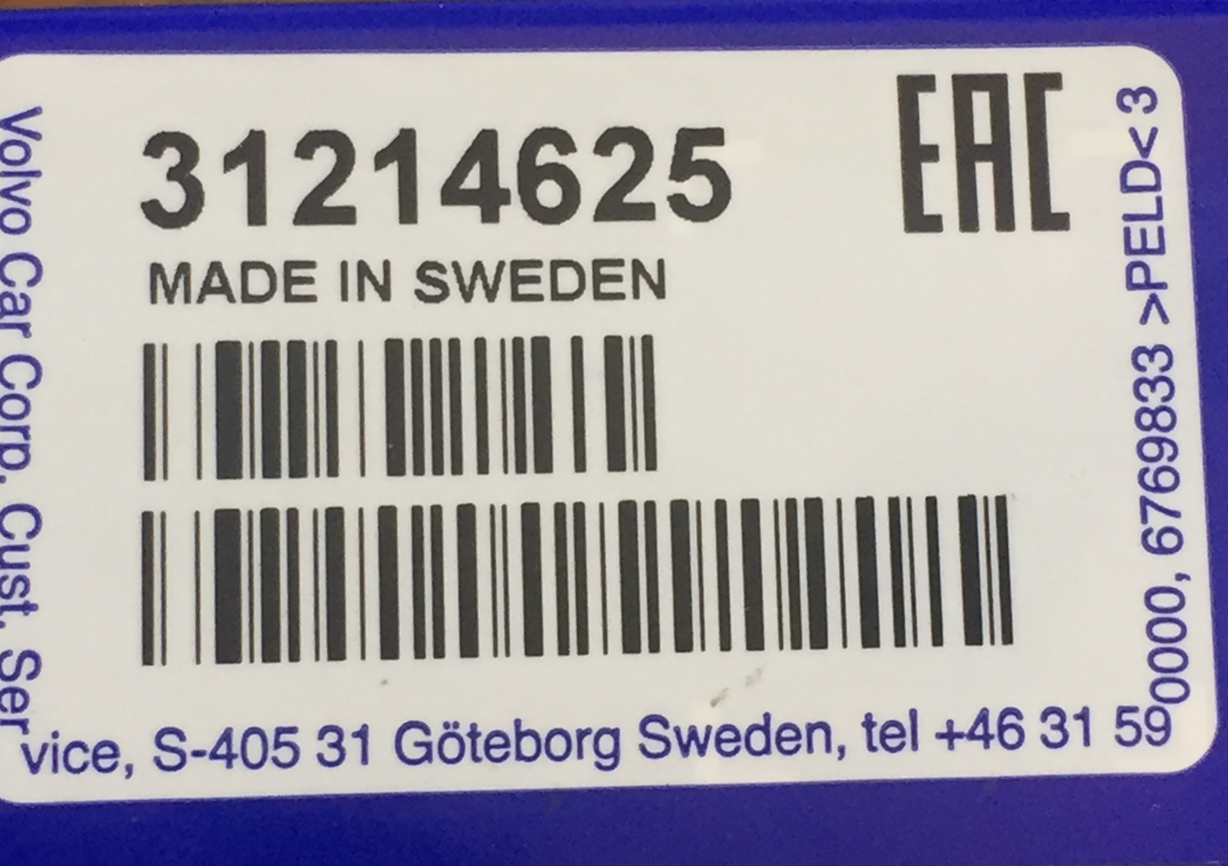

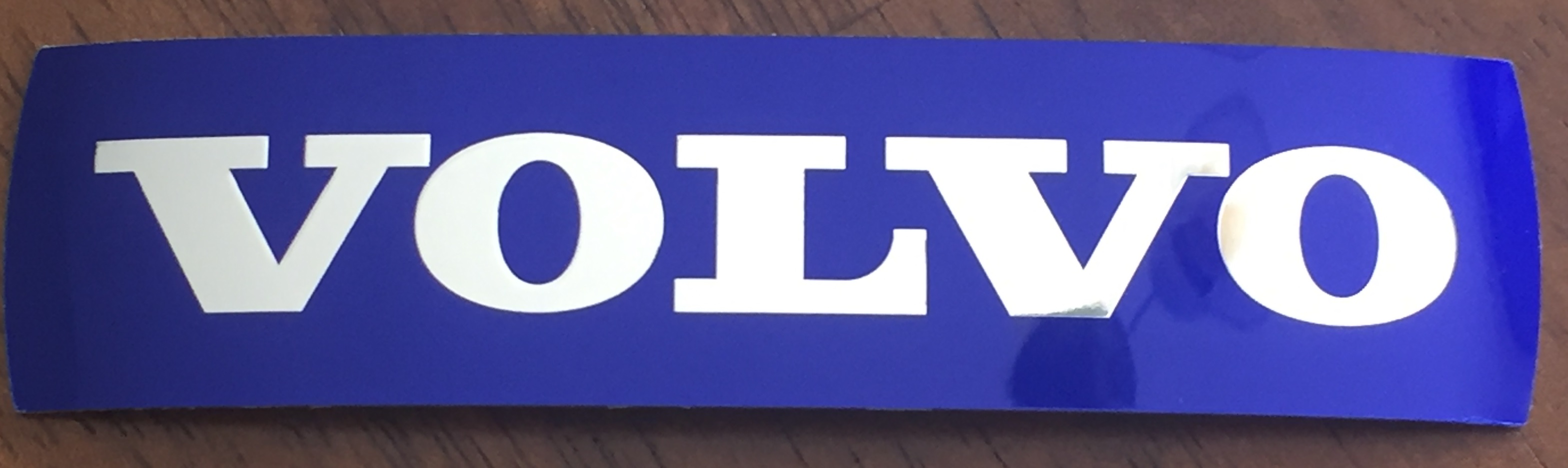

MVS readers,
It is time for the next repair on my S80.
As you can see from the picture my front Volvo Badge had lost its tranquil blue background After a little research I found the part number
And here is what is inside of the box
And for the most important part the picture after the repair.
Full disclosure I didn't follow the Volvo instructions
Here is what I did
1. Cleaned the surface of the old label (It appears to be a thin sheet of aluminum) with 91% IPA - Isopropyl Alcohol
2. Used 100 grit sand paper to roughen the surface with nice fine scratches for the 3M adhesive to bond to
3. Cleaned again with 91% IPA
4. Waited 15 minutes in direct sunlight to evaporate any residual IPA
5. Applied the new label
If you are curious what Volvo recommends then watch this video. The big difference is Volvo recommends removing the old label and using a Primer on the plastic to enhance bonding. I didn't do these steps because the Aluminum part of my old label was well adhered to the plastic.
This video shows a screen shot of the Volvo instructions.
(Note: I really enjoy watching the Videos made by this channel)
Thanks
Paul
