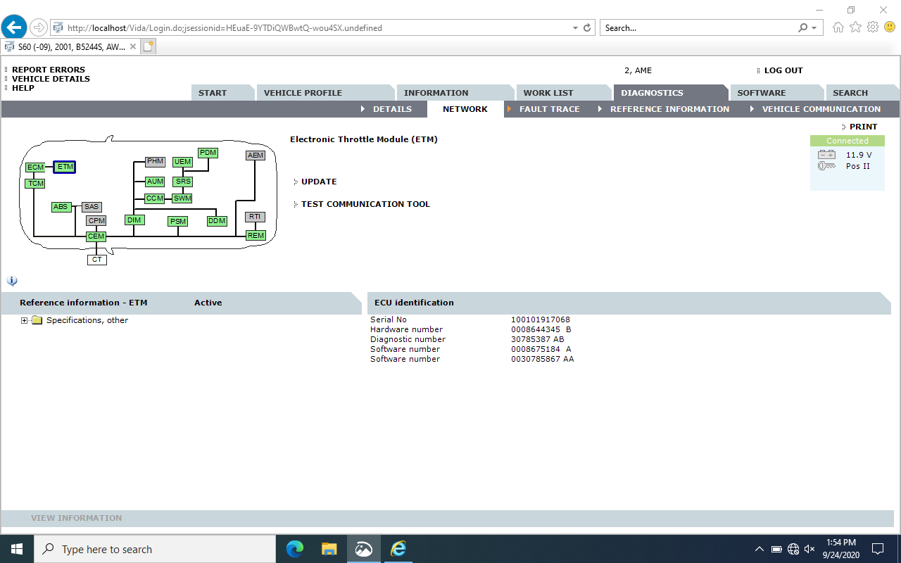

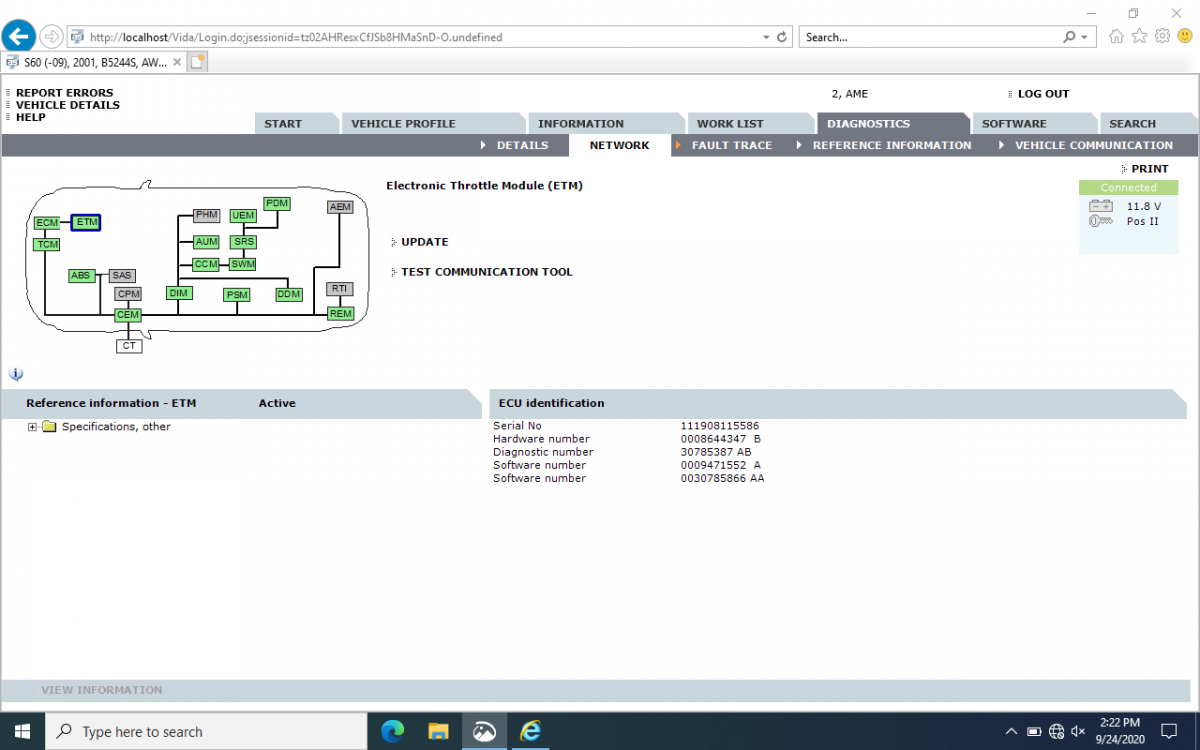

I do have a question, and I don't remember if I've asked it already or not. If the firmware is different between the XeMODeX ETM and my stock ETM who do I need to contact to get it updated, XeMODeX or Volvo? My trunk is full of the parts I've removed so I can't get a battery charger on the battery to check to see if they're the same or different with DiCE/VIDA.

How do I change the software from the XeMODeX ETM to match the software from my original ETM? Is this something a member can help me with online using DiCE/VIDA, or another program (I thought I saw a post in the ETM section about a couple of people being able to do this), or is it something that only XeMODeX can do? I'd rather not have to pay Volvo for a subscription, plus the software download cost, (assuming this can even be done since the hardware numbers are different) if there's a way to pull the software from my original ETM and install it onto the XeMODeX ETM.
Any help would be greatly appreciated.

XeMODeX wants $279, plus shipping there and back, to send them both ETM's to be programmed.
Yagger said he could program the XeMODeX from the 2000 S70 to work on my 2001 S60 online for $100, marked down from $140.
I'm trying to finish the car up this weekend, since my loaner that I've been using I won't have access to after Sunday. Is there anyone that can help me online for less than that, or take payments? I won't have the $100 until Thursday.
