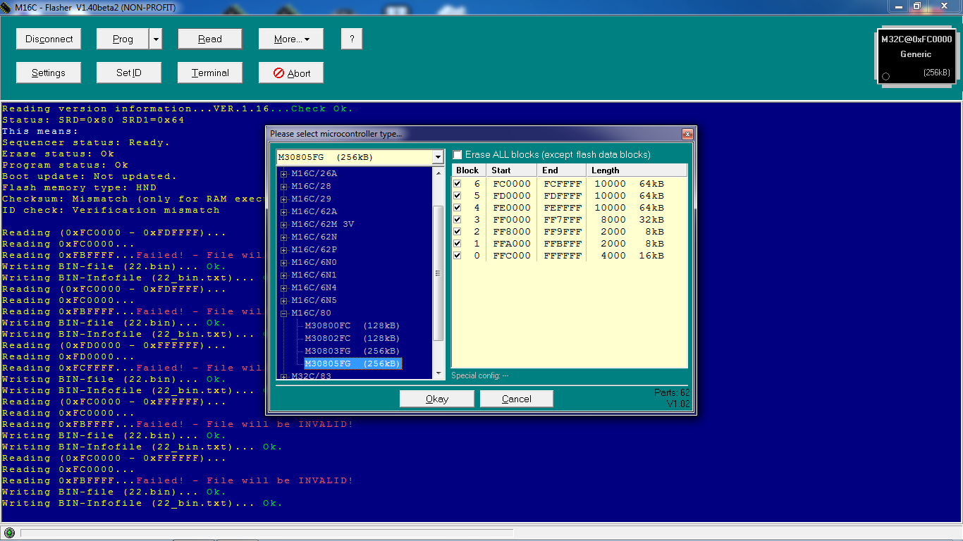

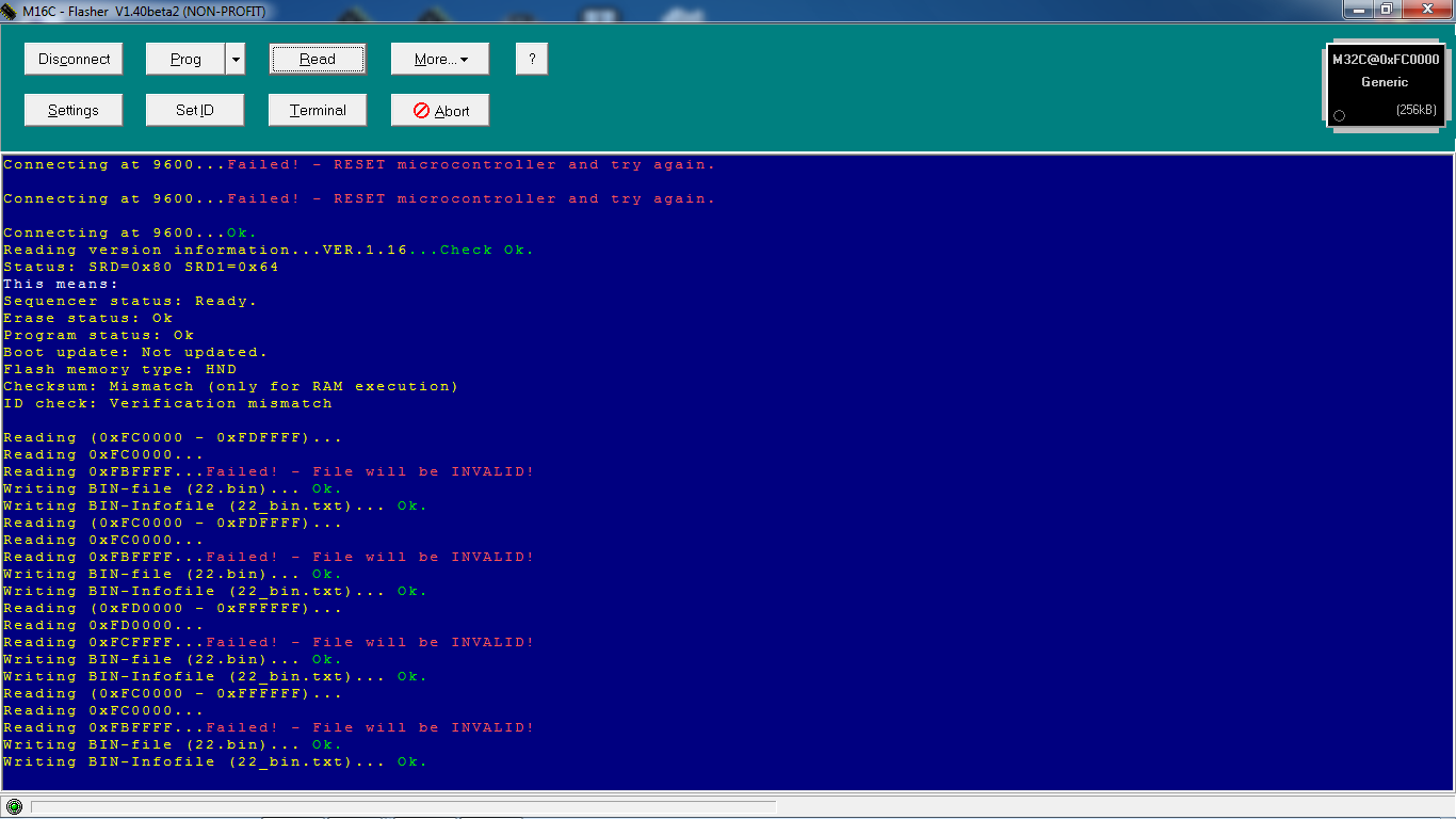

Good afternoon. Can anyone help me. I have a block cem H28024617 s/n00006139232. I'm trying to connect to it via M16C Flesher and can't read it. Can anyone suggest me how to fix the problem?
vtl
Posts: 4937
Joined: 16 Aug 2012, 13:35
Year and Model: 2005 XC70
Location: Boston
Has thanked: 130 times
Been thanked: 686 times
Post by vtl »
MAX389 wrote: 01 Apr 2022, 07:55 Good afternoon. Can anyone help me. I have a block cem H28024617 s/n00006139232. I'm trying to connect to it via M16C Flesher and can't read it. Can anyone suggest me how to fix the problem?
Fix your address map according to one in your CEM. You can find it in M32C datasheet.

Do you mean this?
