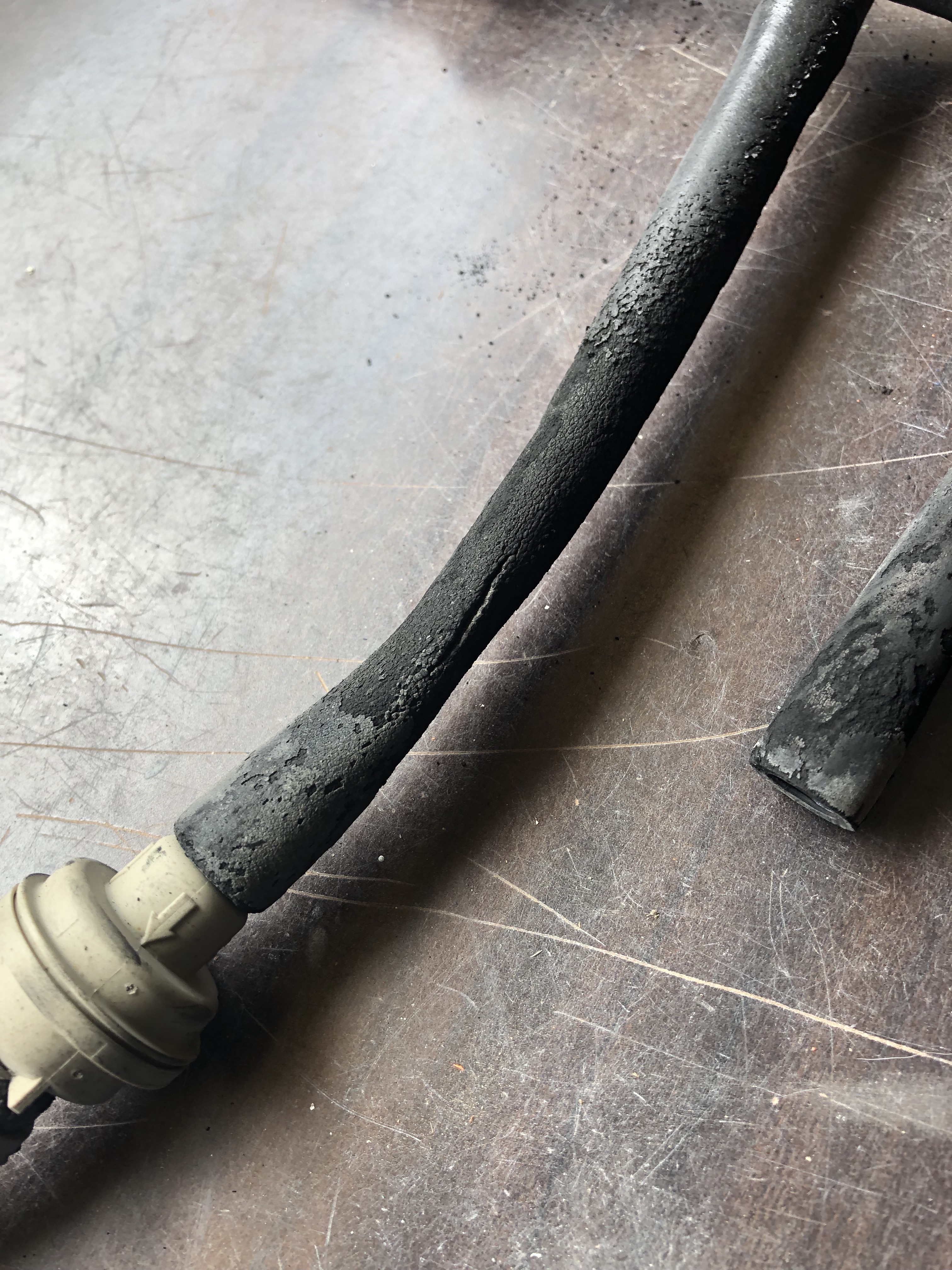

Post by Blacklab467 »
Replaced the Vacuum lines on this assembly under the intake manifold. This was going to give trouble real soon! The old lines crumbled right off the check valves.

Blacklab467 wrote: 15 Apr 2022, 15:52 Replaced the Vacuum lines on this assembly under the intake manifold. This was going to give trouble real soon! The old lines crumbled right off the check valves.
Were those the original lines?
They were in fact original! 300,000 Kms. I'm going to check the rest of the lines and hoses and be a little more proactive.

Post by scot850 »
Mmm, those are toasty looking lines. Good catch and one of those jobs that is worth doing when you catch them!
