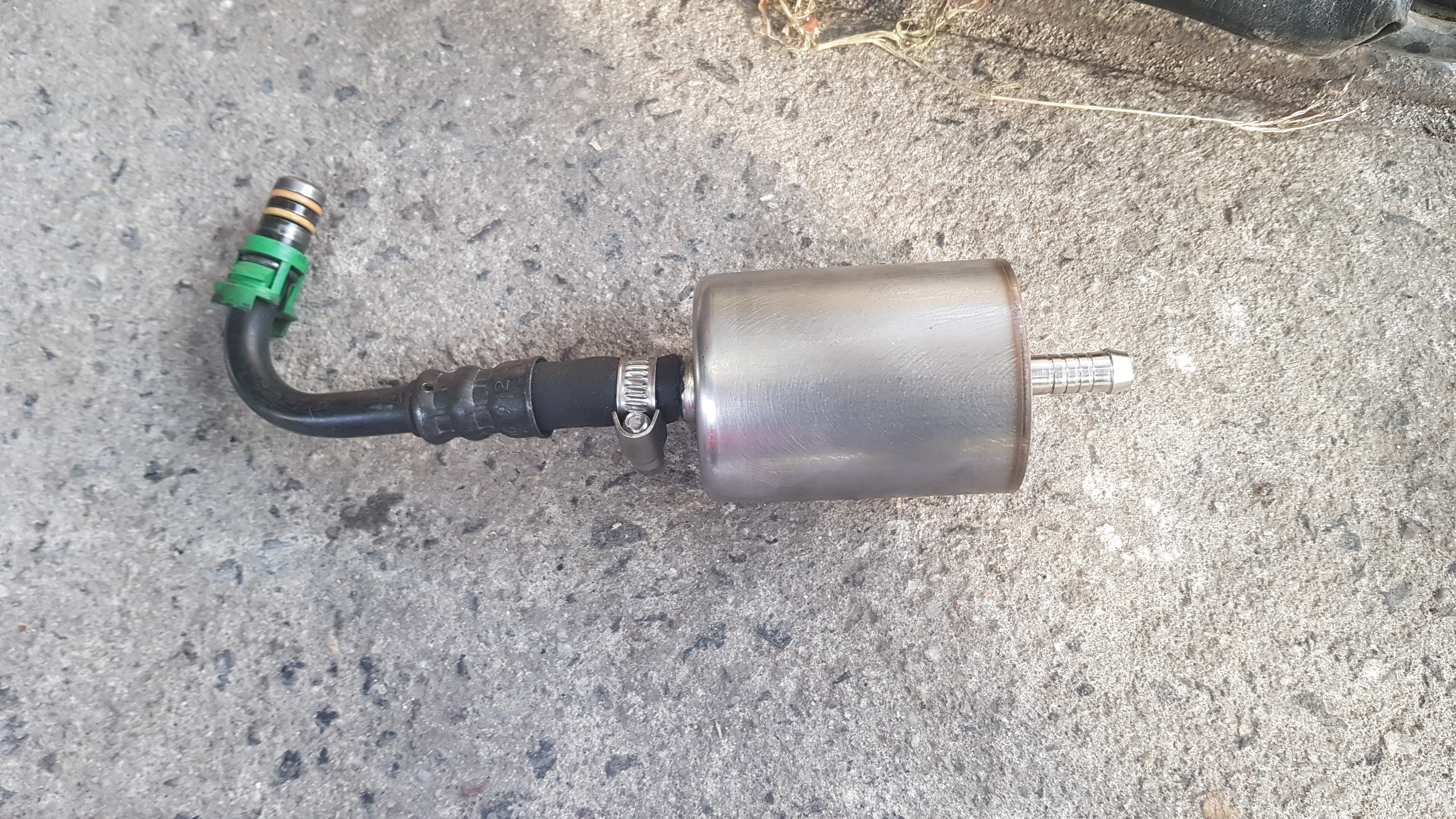

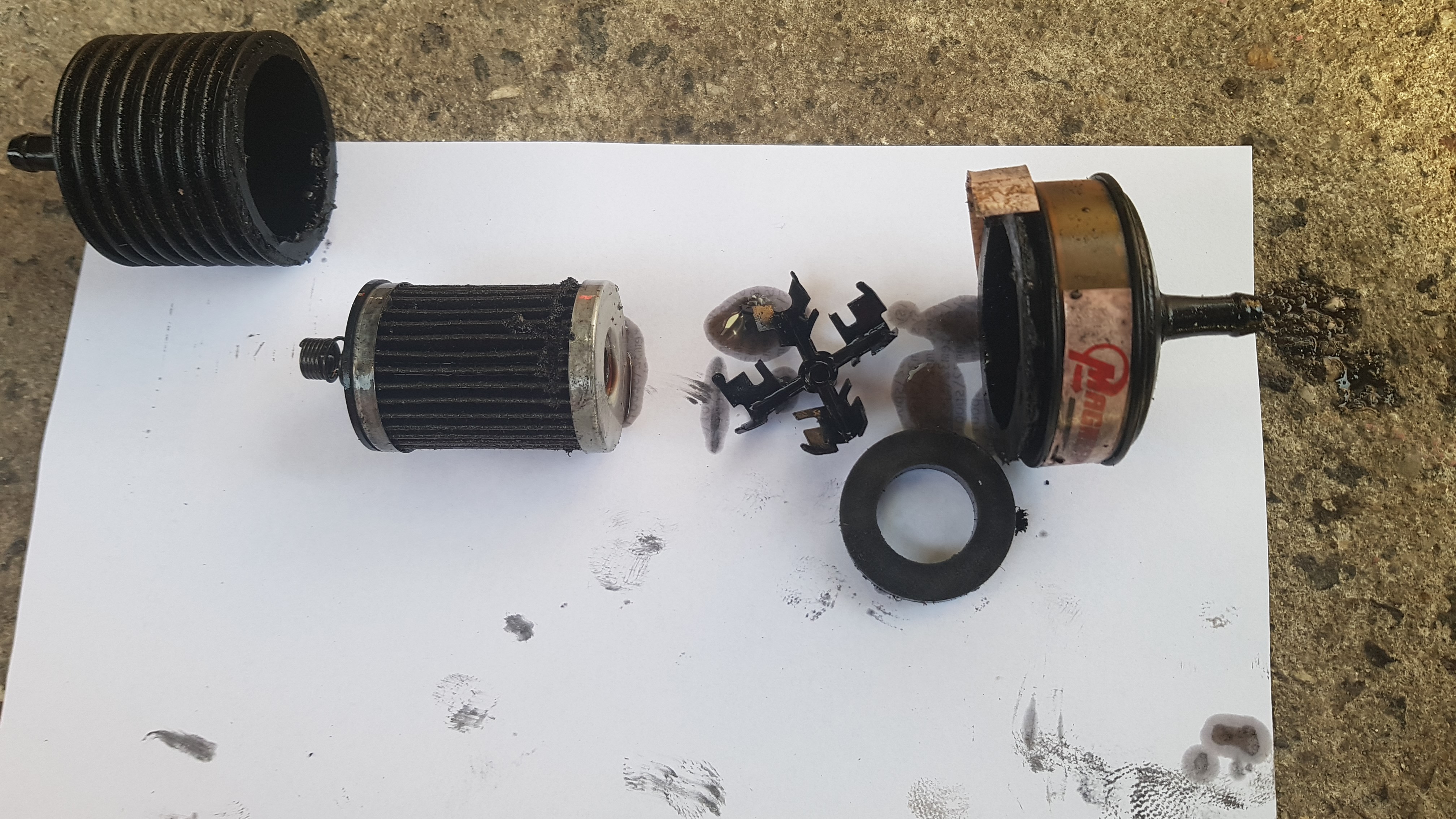

My trans played up for 2 weeks now. At first during only warmer weather and now it goes to limp mode every 1.5kms or thereabouts. Tried a new Magnefine filter today. The old one was pretty clogged.
Appendum: turns out the fluid wasn't high enough to register on the dipstick. Topped up. Test drive to follow.
