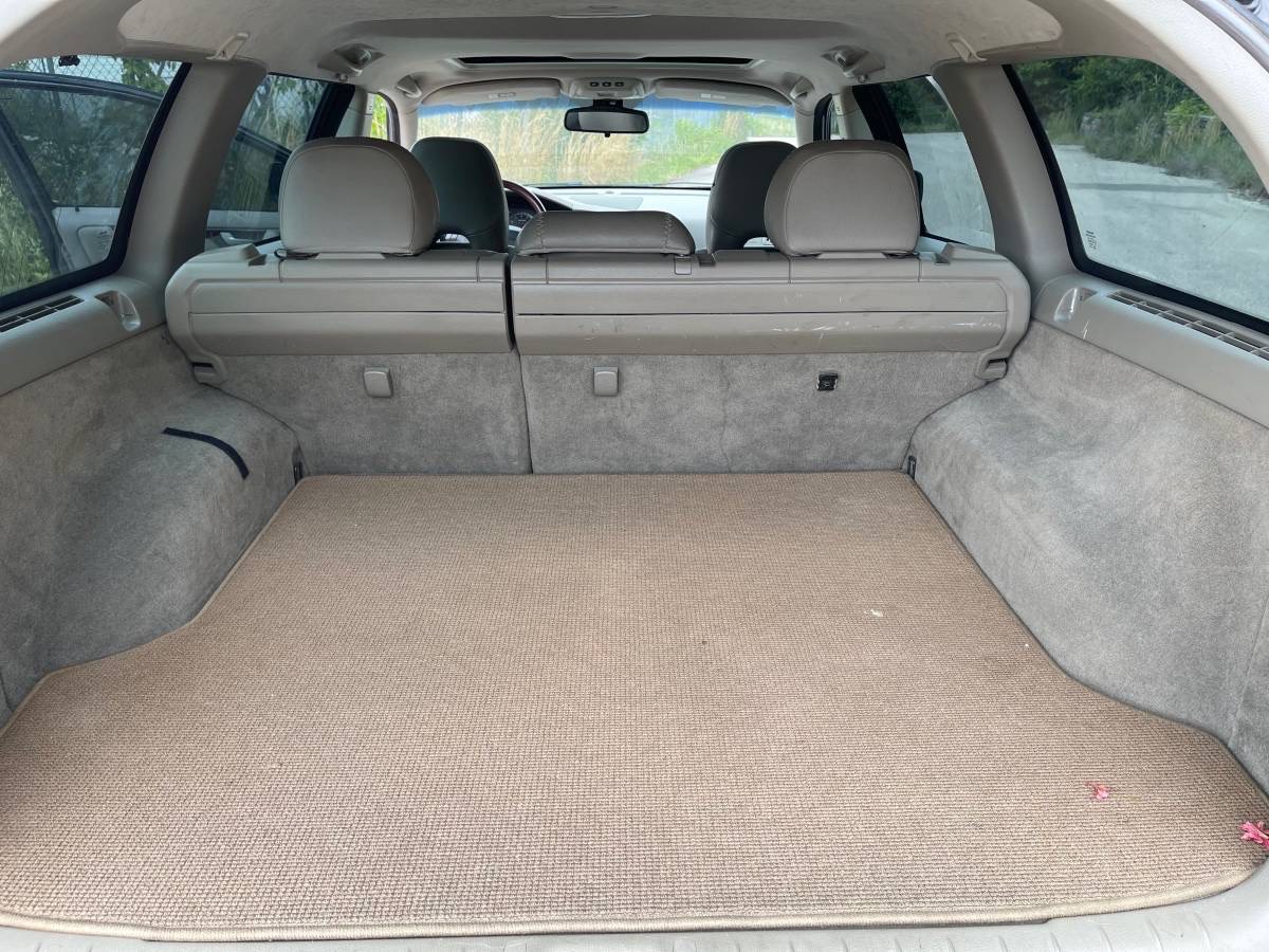

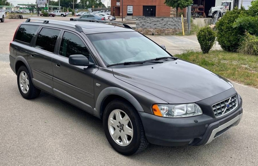

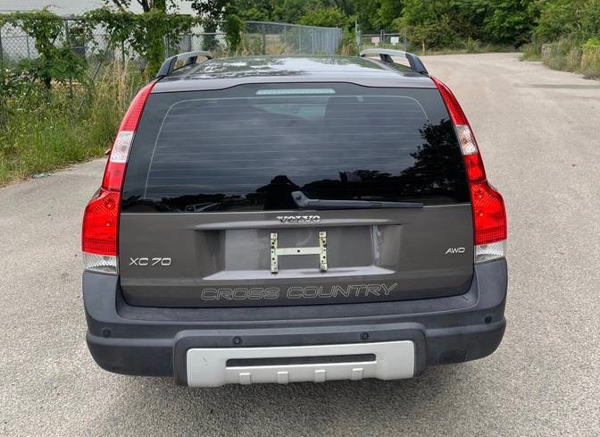

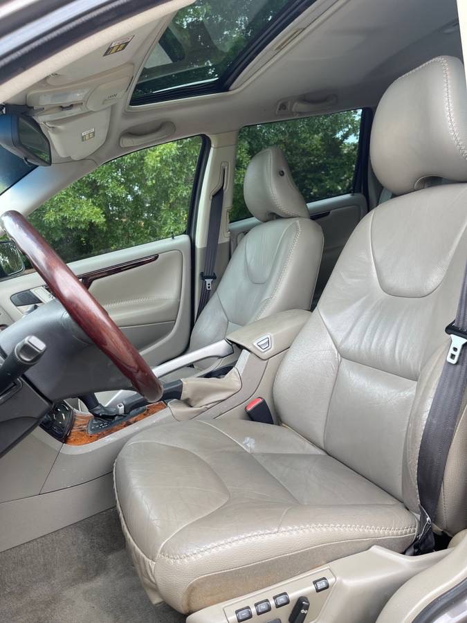

I picked up an 05 XC70 Cross Country yesterday. I couldn’t resist it. It’s a 2 owner w/ 185k and really clean. Unlike my S60 when I got it, this one has no leaks, no clogged PCV. Last timing svc at 122k. The engine runs great and the transmission shifts smooth. I scanned the codes before I bought it and it showed a bunch of nit picky ones like possibly a battery issue. I hooked it up to Vida at home to turn off the DRL feature and while I was figuring out how to do that again, I killed the battery. It went down to 8.6v. I got my neighbor to jump me and let it charge for a while. It charged at ~13.5v and started later. I cleared all the codes and I’ll see what comes back today and of course if it starts 😬. If not, project one get a battery. Lol

Nice shape, nice color.

Gorgeous and it has the faster Canadian Bus, if you ever end up North
